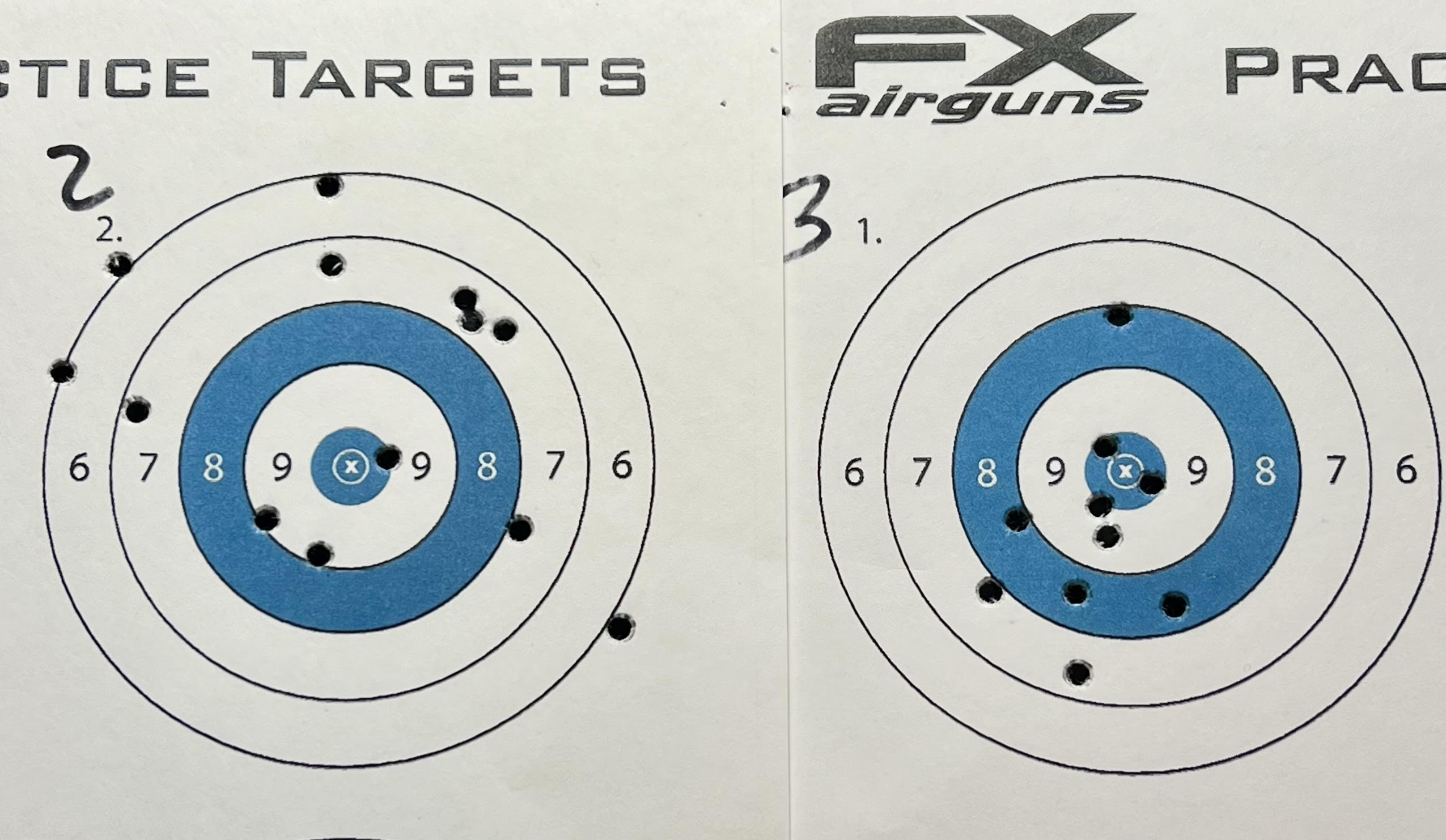

Almost every one of my FX rifles that I use in target competition lead up quickly after less than 100 shots. I clean then polish the bores, focusing on the choke, with JB bore paste. Even so, after 100-120 shots the accuracy starts to degrade. I'm talking about shooting with slugs which has a larger bearing surface between the barrel and projectile resulting in lead build up in the choke. Pellets? Not so much, but the oils and lubes used on these still will build up in the bore after a while. Those that claim that they never clean their barrels are fooling themselves.
Before and after cleaning. This was from my FX Crown MK2, .177 cal at 100 yd using JSB 13.4 gr KO slugs after 100 or so shots.
A clear difference
I will have to admit i shoot a lot more than 100 shots before i clean my FX barrel, but it could be the POI chasing i have some times done have been more than me also shooting my slugs a tad too fast.
I will have to look closely into this in the months to come, not least on dead calm days, CUZ i can easy shoot well over 1000 shots in a day.
Mind you i do also have my cleaning rod and patches at hand,,,,, ALWAYS, but i should probably use them more often.

When I shoot a 3 card 25 shot BR match, I clean between each card. I clean with a couple of patches moistened with Ballistol followed by 3 or so dry patches. After, I shoot at least 5 to 10 sighters to season the bore.
