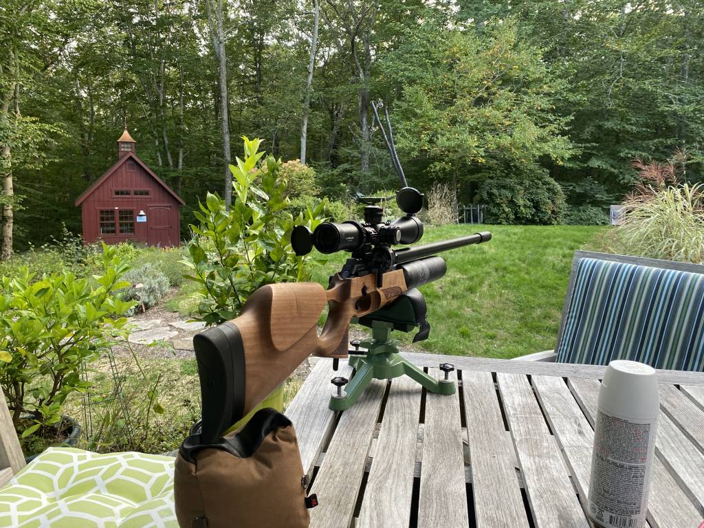

Here’s a photo of the gun at my 25 yard range.

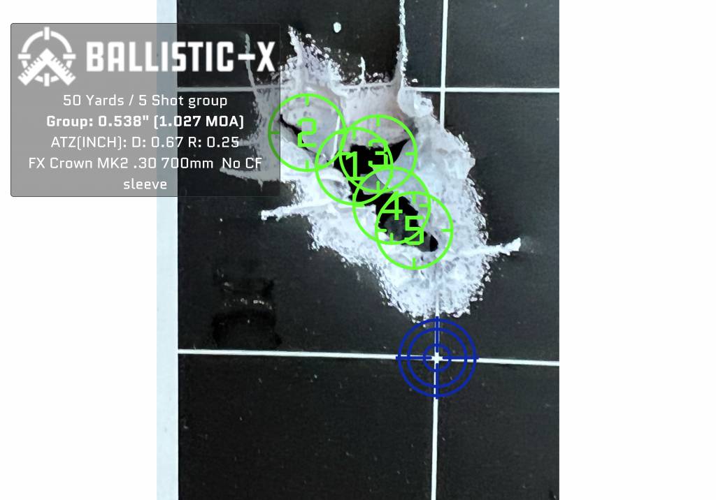

So, did I feel a difference? Absolutely not. The gun felt the same, just as I expected it would. Did it shoot any different? Well, hard to say for sure. You can judge for yourself from the groups I show below, but I can definitely say that it wasn’t worse, and may have been a little more consistent with the CF sleeve/spacer combo.
Here is the “Before” group.

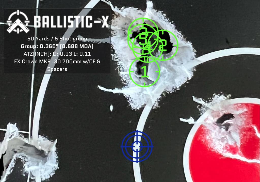

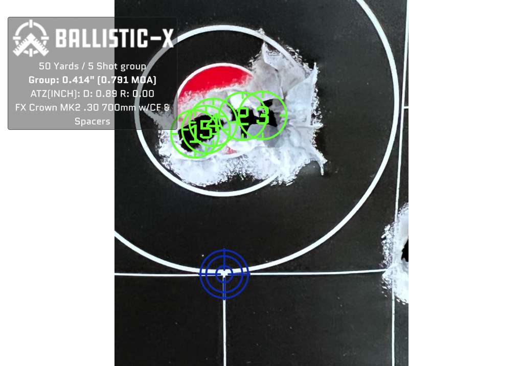

And here are the two “After” groups.
Note that I have my gun shooting above the POA so that i don’t blow my aiming point away, thereby making it difficult to shoot a good group. Also, I shoot multiple rifles at this target, so there are holes all over it.
The two groups with the CF/spacer combo are technically “better”, at least in terms of group size according to Ballistic-X. However it is obviously very close. Perhaps at 100 yards i would see more of a difference. What I can say is that i have no intention of removing them, since there is absolutely no downside and there may be some upside.
