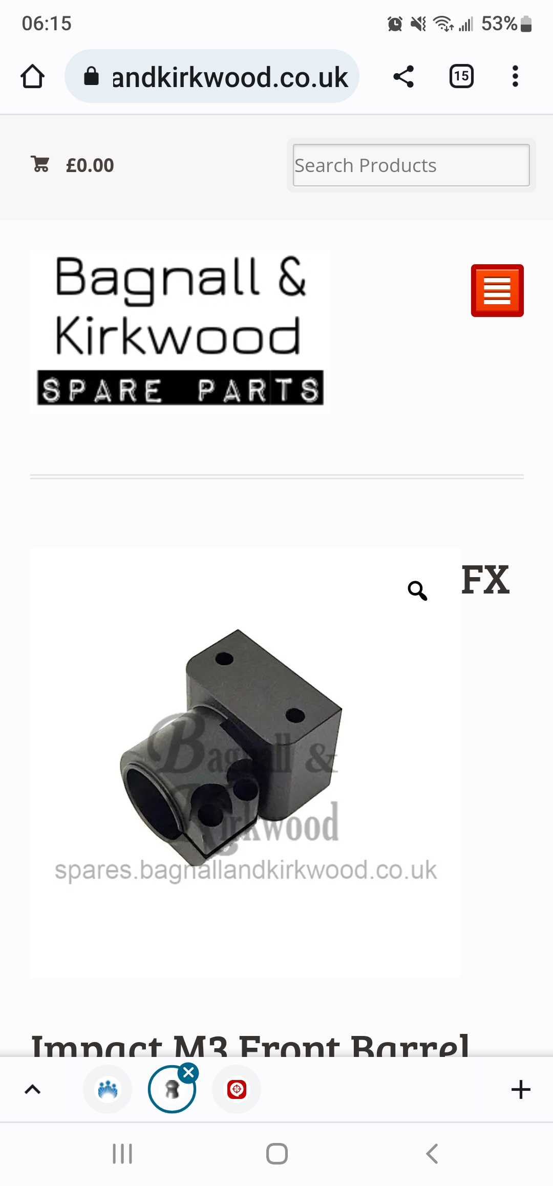

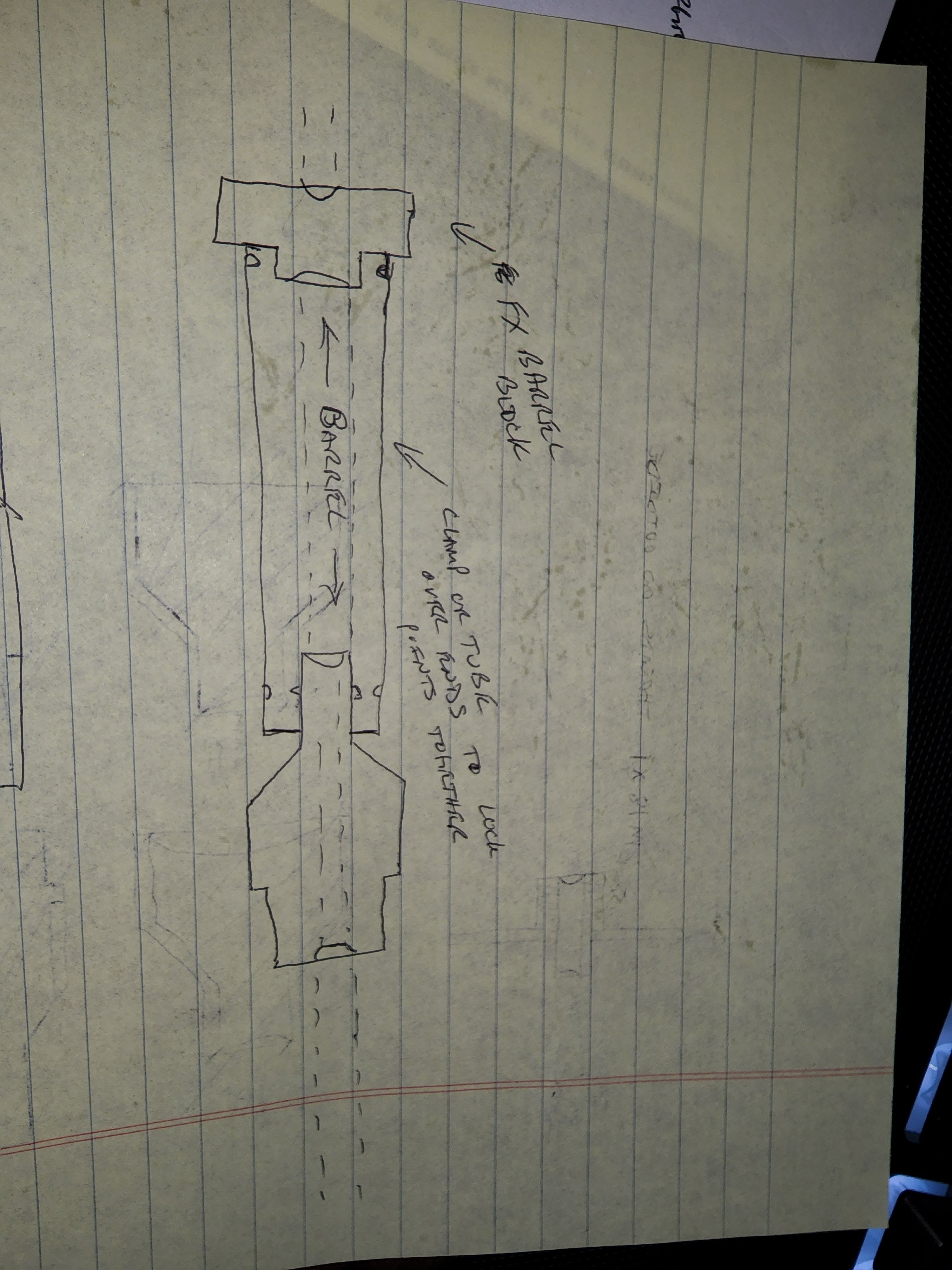

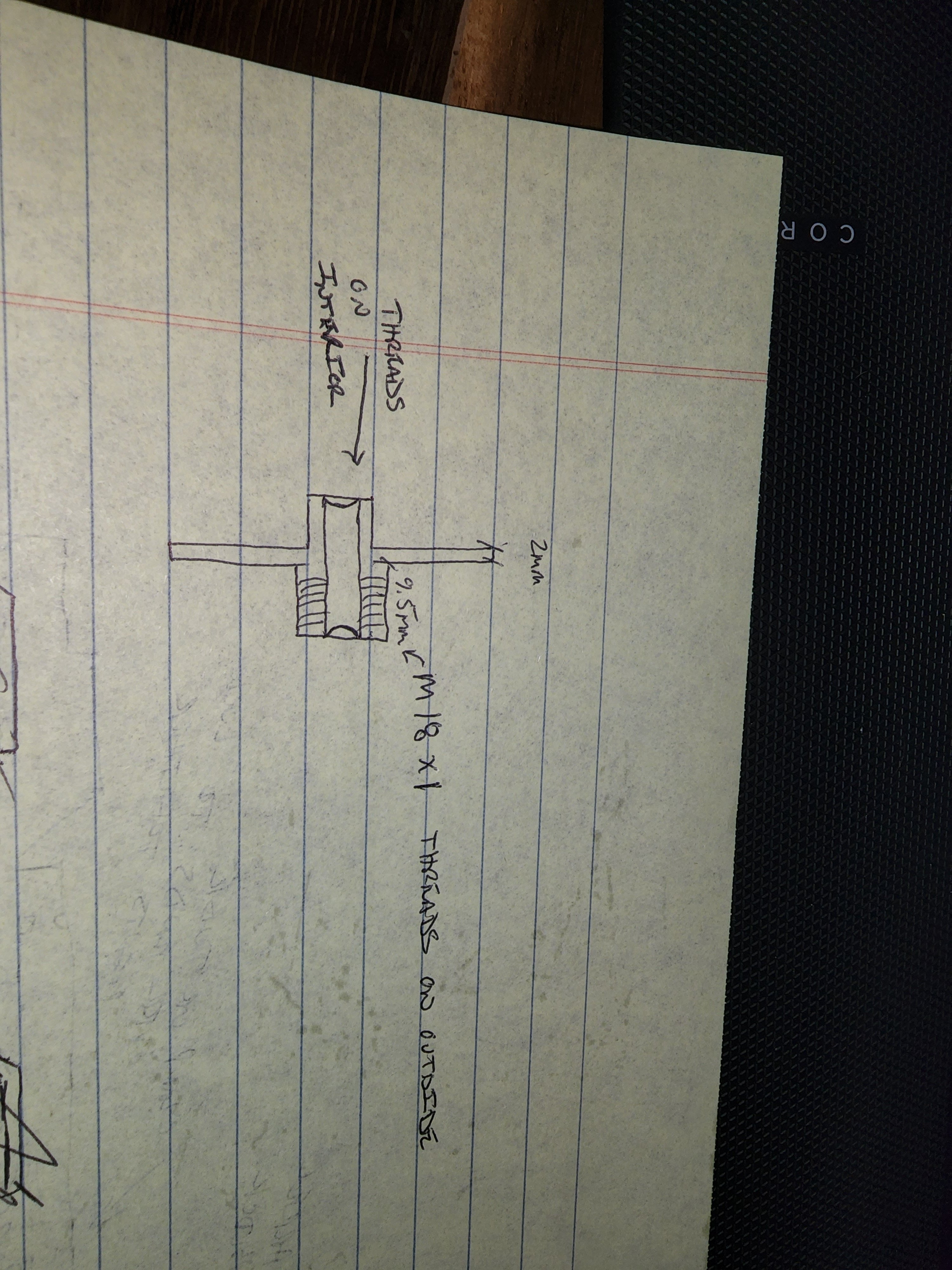

While looking at the bc version, I wondered if the tension would loosen over time and from just handling the gun. If a different style end cap, where the shroud tapers down to the carbon fiber barrel piece was used near the block, perhaps a cyclindrical aluminum c type clamp could be machined to connect the block with the shroud taper piece to more permanently hold the tension.

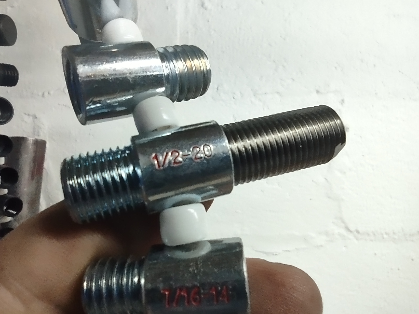

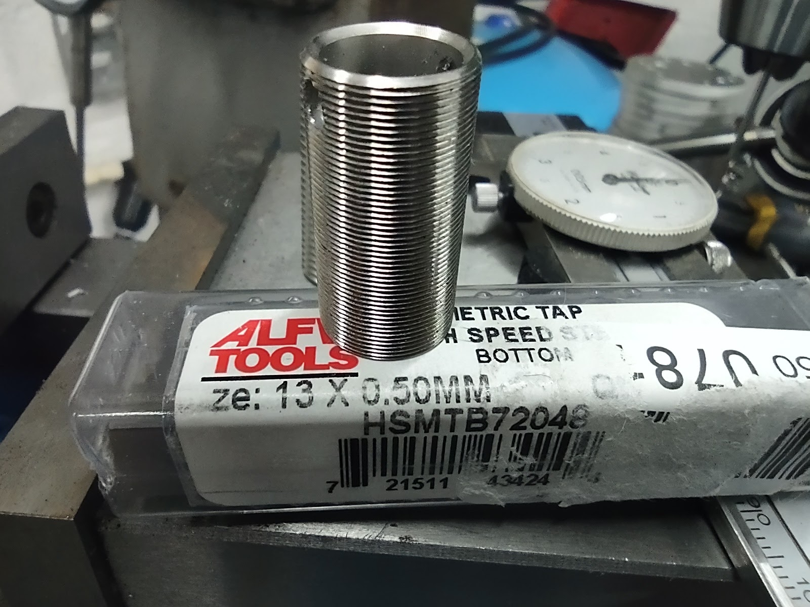

Does anyone know the various pitches on the air stripper side/ shroud points on the 35 cal?
M18 x 1mm is the shroud side I believe, but what about the other?

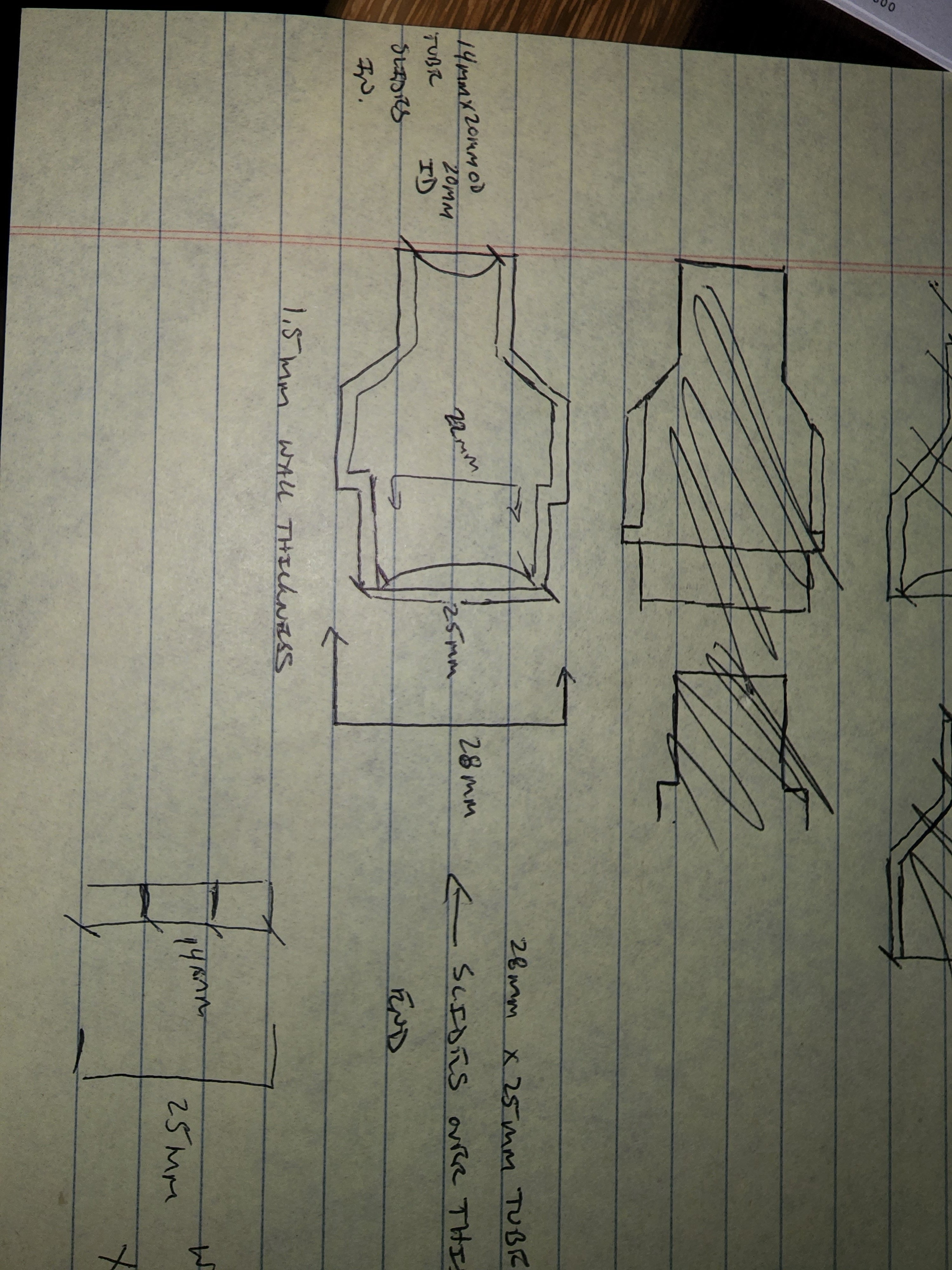

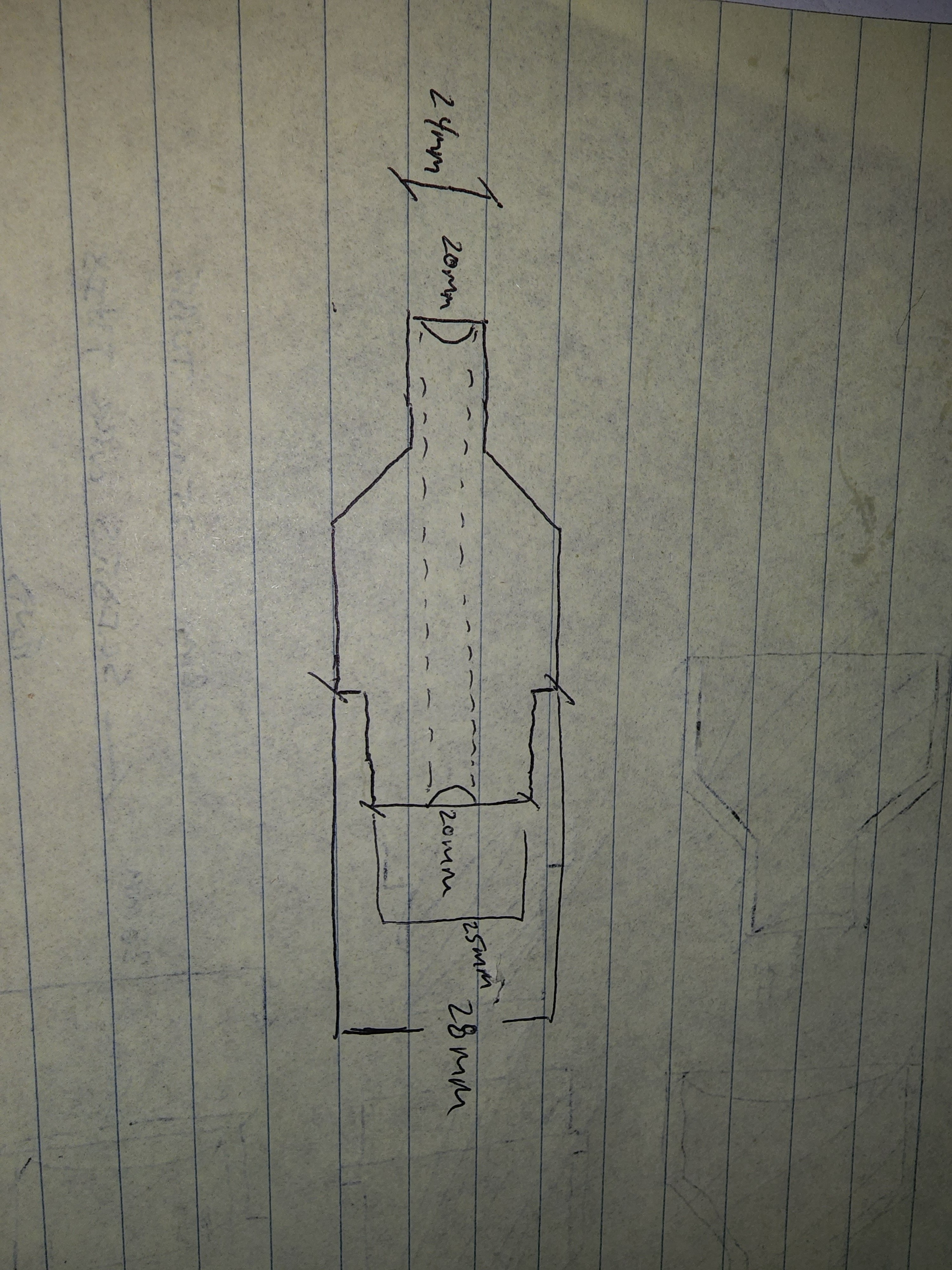

This is the idea for the block side. Reduce from 14mm x 20mm and 25mm x 28mm. Then a c type or tubular clamp can be placed between the fitting and the block to lock it down after the threaded tension is applied. Plan is to thread it on like the bc setup, but permanently hold the tension after.
