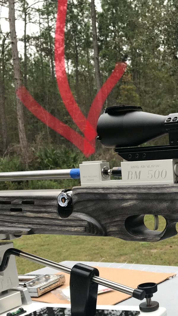

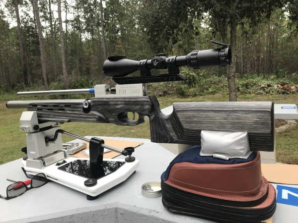

I recieved this rifle from Martin one day before the US Nationals, mounted a scope sighted it in, next day took 2nd place in Light Varmint (12fpe) class.

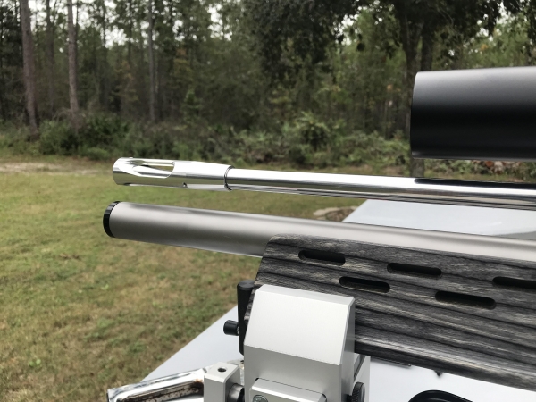

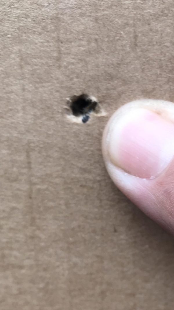

Superb rifle, that was in Sept ive havnt got to really shoot it since then. So i got her out the other day, abjusted the trigger to one stage 6oz pull, removed barrel and polished the exterior to a mirror shine ( cause i like it). Had some light wind outside so i addressed the barrel indexing to my liking. Installed my Weaver T36 and zero’d it then installed a Rowan air stripper. Tuned the groups to perfection, .22 size hole with a 8.4gr pellet in 10 shots. Just wanted to share
-Ken

You tune in the wind to minimize the drop or lift of the pellet when holding extreme left or right. When you hold to the 7 ring to the left for a left to right wind do you notice the pellet poi may be low when it hits the ten ring? Or vise versa when holding extreme right the pellet will lift high on the ten ring.
Pellet spin and other factor causes this.
Extracting extreme accuracy from your rifle :)
Hope this make sense..
** i forgot, index to 12 o’clock in little to no wind to start with. Once at 12 o’clock then start in wind.
