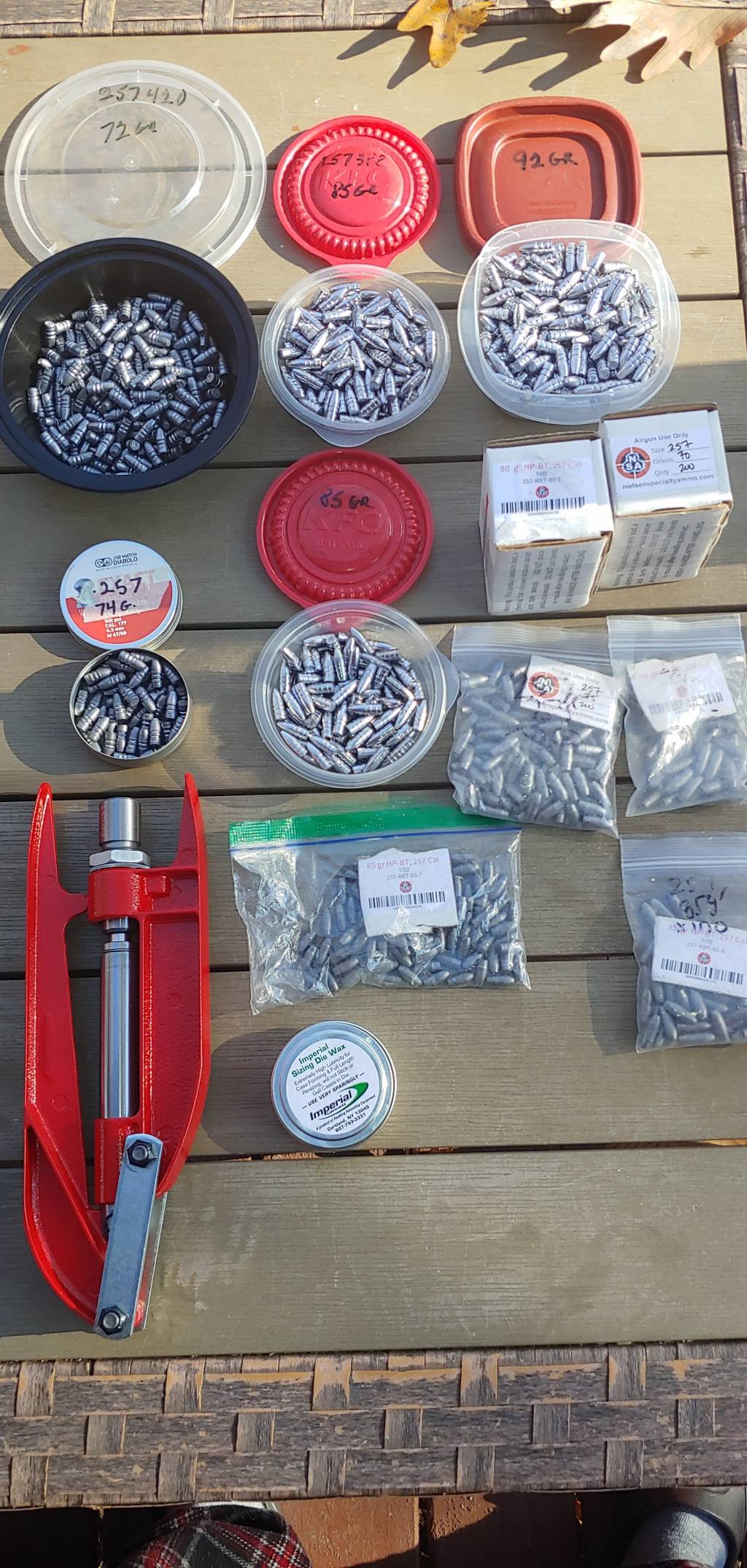

Thanks. Shows what I know. I'm knew to the texan. I wonder if there is a twist rate that I could use that would work with most slugs weights and speeds
