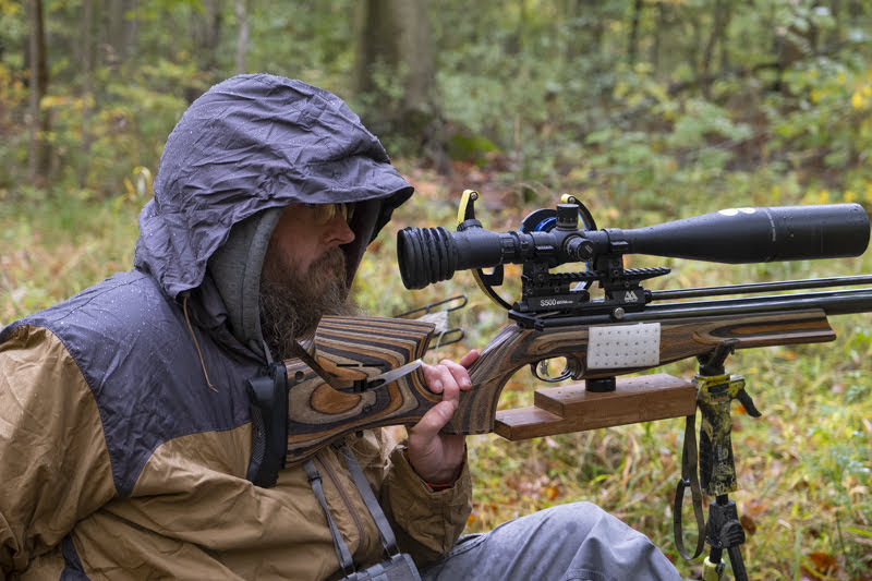

Back to the business at hand… barricade stops.
What I’ve been learning through experimentation is a stable stop, on any of my too many HFT rigs, seems to be directly under a scope’s forward bell. Of course results may vary, but it is at this point along the rifle, where weight distribution seems to settle down and the muzzle settles in and I’m not wobbling around nearly as much in the sticks. So @Franklink - your ideas and pics were spot on.

As for the barricade stops - without a doubt a stop placed forward of the scopes bell will in fact create more stability and less forward barrel swing when sitting in the sticks; 20 out of 20 guns can't be wrong.
The type of stop also matters greatly. If you can get a stop that interfaces nicely with your Y-yoke on your sticks -Voila- you will have the most repeatable interface possible. I have come to really like the PRS UIT round stop. See Pic. This ones placement on the AA S500 XS Carbine, is now where the pic adapter is currently; the least amount of forward barrel swing to date. I'll post some more current pictures of this on my other HFT platforms. Hamsters or knee risers IMO make terrible stops for us to rest our sticks on.
