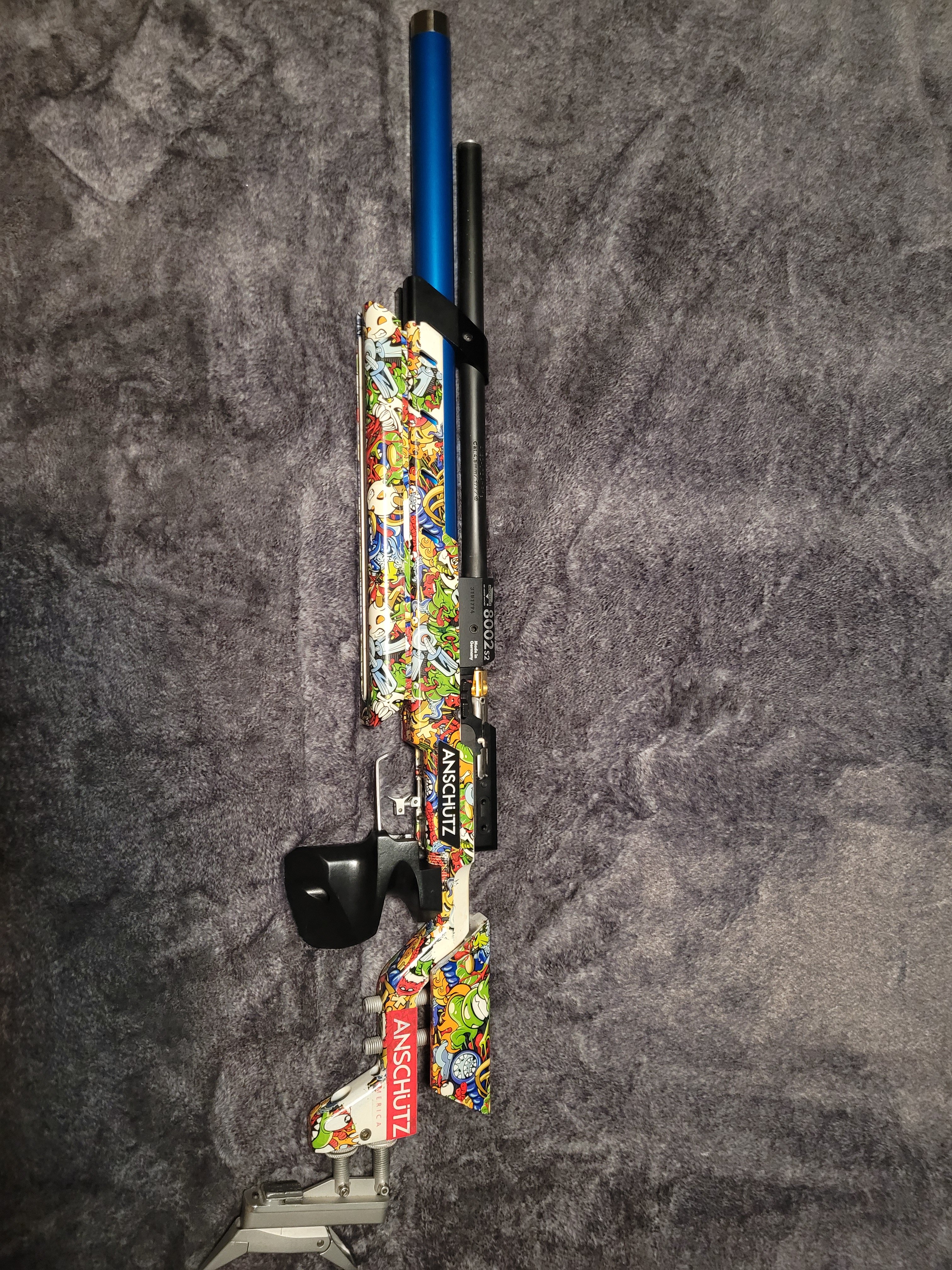

Alright guys I have my rifle back in hand, and working on a few more small things for it, but I am now looking for an optic. As much as I would LOVE a March or something like that I can't afford that for this rifle. So if someone wants to donate one it would be much appreciated!! LOL.
I have the Anschutz 8002S2 set up for 12 ftlb right now, and plan on using it for some hunting as well. So a multi purpose rifle at the end of the day.
What scopes do you guys recommend that wont break the bank, but still work great. Are there any shorter scopes that work in your opinions? Something like the optisan or something like that would be great for hunting, but not so much with the FT side of things.
Need Ideas guys!
The rifle in question. I am going to be adding a carbon shroud next week when material gets in. So the barrel will have a carbon shroud that extends just past the air cylinder.

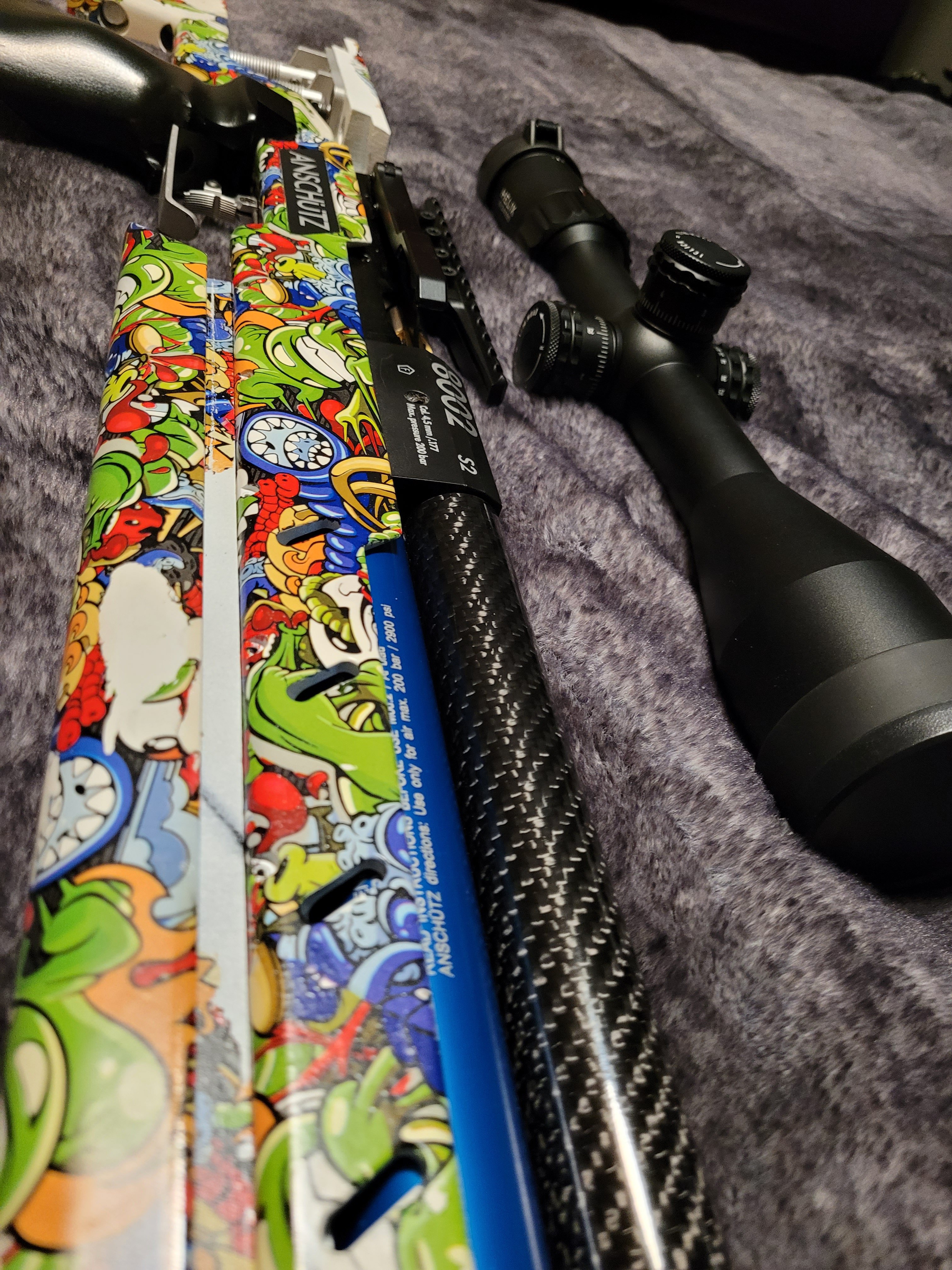

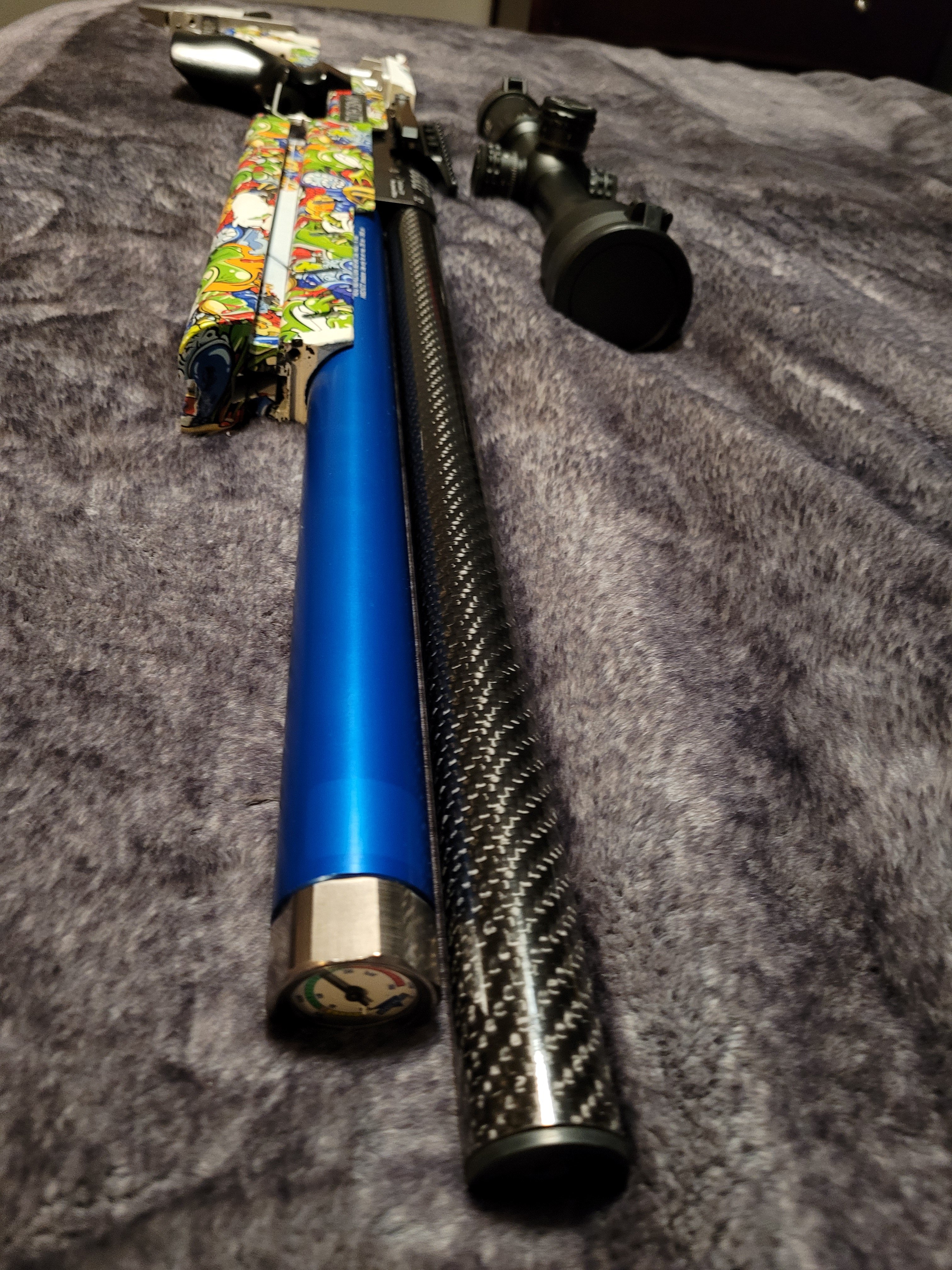

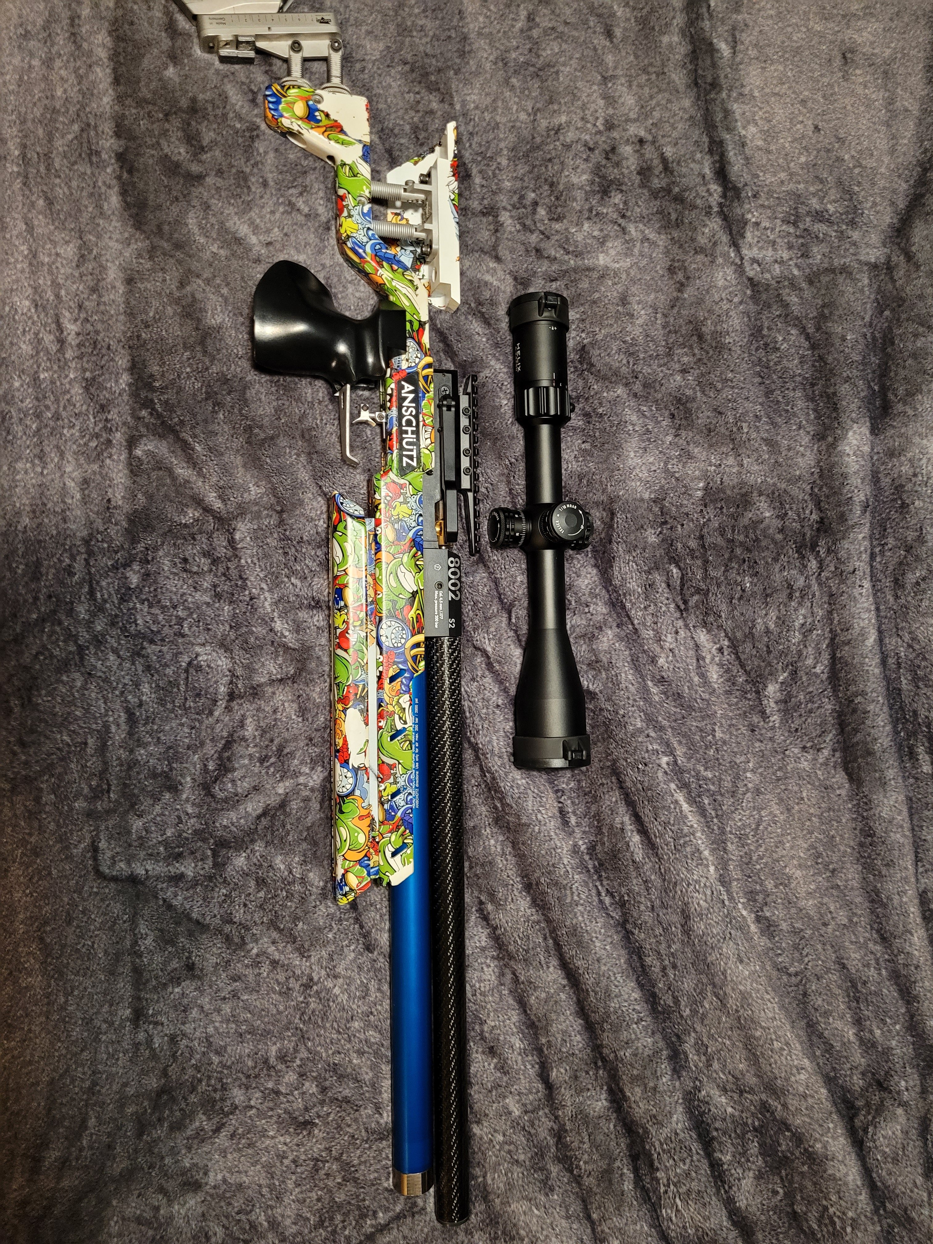

Found a scope for the rifle, and added some "Snazz" to the barrel as well. Cut back the outer sleeve and added a full carbon shroud. Still have to make an insert, but over it shoots and is smooth.
Scope is an Element Helix and the rings should be here Saturday. So hopefully will add more pictures then. If not to snowy and gross out, will get some pictures outside
