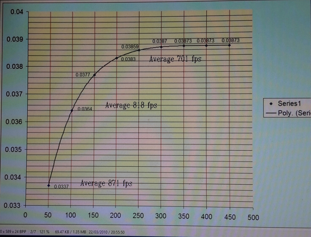

Here is a graph derived from actual average velocity figures over 50, 100, and 200 yards which I researched when the Kings first came out some 9 or 10 yrs ago. The best fit line interpolation and extrapolation shows what you may expect and according to the criteria mentioned in pg 1.
Note that in one respondent's figures above, the bc was taken at an mv similar to my figure figure shown at 150 yards and the bc is similar when actual velocity is matched.
Yes, the chronograph was shielded at the longer ranges and a protected spotter (thanks Rrob ) recorded the results.
You might get something from this. Kind regards, Harry.
