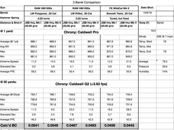

Well, I had enough time to get the data tonight, so now I'm in the process of crunching the numbers. I took screen shots of weather conditions all throughout so I could account for any changes taking place. Bottom line: I don't think we'll see a ton of difference between the results in the barrels (just looking at the number).
Tested:
LW Polygon Barrel, .25 cal with JSB Heavy Mk I and Mk II pellets @ ~ 890 fps mv
LW Polygon Barrel, .25 cal with JSB Heavy Mk I and Mk II pellets @ ~ 860 fps mv
FX WC ST barrel (factory barrel), .25 cal with JSB Heavy Mk I and Mk II pellets @ ~ 860 fps mv
Stay tuned for more...
Sean
Ok, I was wrong, there is a difference between barrels like I originally suspected. I think I'll pull this out into a separate post as there will likely be more people interested in the comparison and may not find it barried at the bottom of this thread. Here's the chart with the results:
