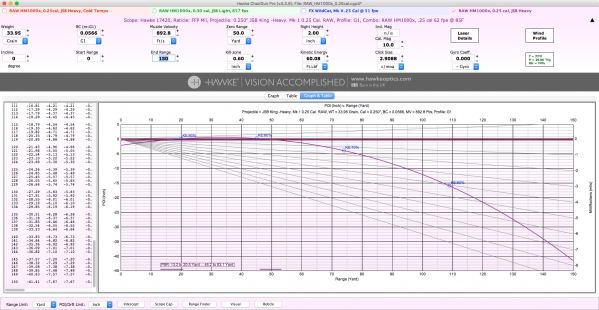

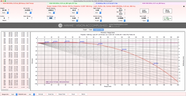

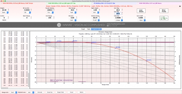

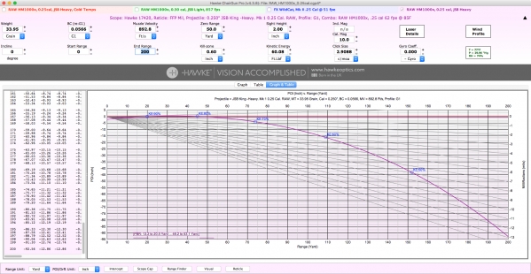

My calculations were based on the same zero distance as an input (50 yards). However, when I shoot the gun, the lites hit high by 0.5 to 1.0 MIL on the target (making the lites 'act' like they've been sighted in further out). I could go back through my comparison testing and adjust the zero point for the lites to show being high by the correct amount at 50 yards and then re-answer your question. It may be that the lites stay higher than the heavies further out...

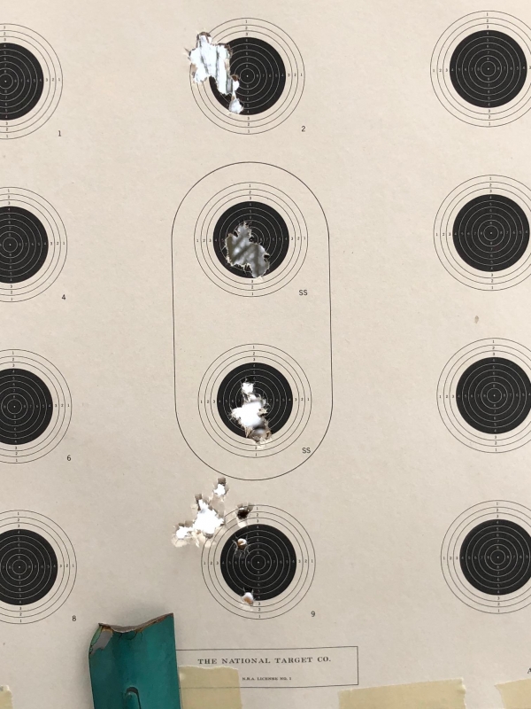

Here's a comparison target showing 4 groups of pellets shot at 50 yards with no changes in zero setting. Top is H&N Baracuda, Second is JSB Heavy, Mk I, Third is JSB Heavy, MK II, bottom is JSB Lite. From estimation, the JSB lite group is centered about 1" (~ 0.6 MIL) higher than the JSB Heavy, Mk I at 50 yards.
With this info taken into account, the 'correct' crossing point is out at 184.5 yards between the two. Sorry for the confusion-I meant to do this from the start but messed up the intent initially. Again, these results are based on my 'eyeballing' method-though the direct, on-paper, comparison is shown at 50 yards in the photo above.
Setup # 1:
Setup # 2:
