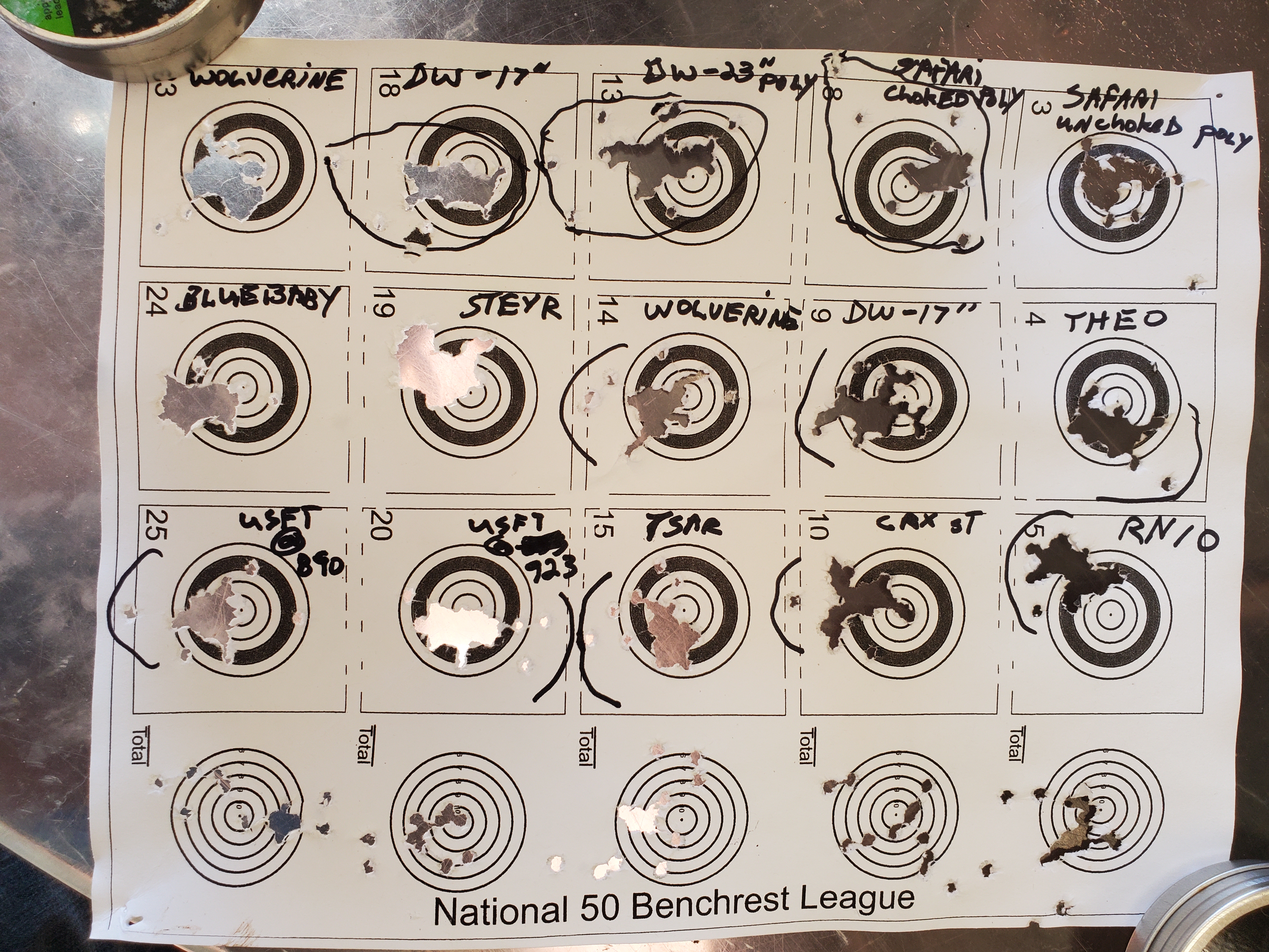

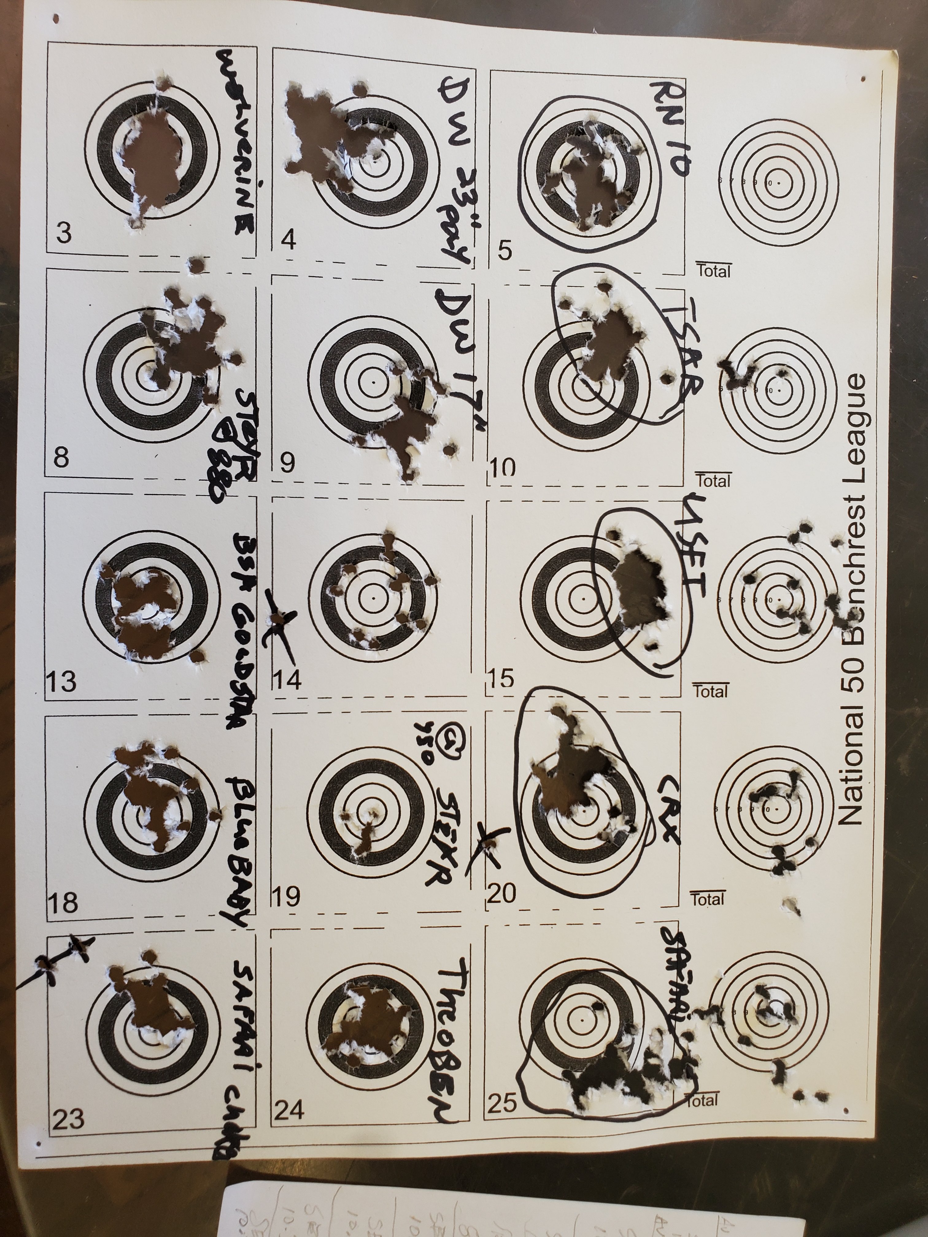

The first attept was to shoot 25 shots at 50 yards with the same poa through all 25. The hope was to see if some would spread more than others as the wind changed. As you can see in the photos, real difference may be difficult to discern but some, like the USFT had much less vertical and the horizontal was somewhat less as well. Peak wind was likely around 8 mph and the 2 outliers on the USFT were during a couple of these gusts. The wind varied pretty much 360 degrees on both cards and is responsible for much of the vertical as all of these are quite consistent.

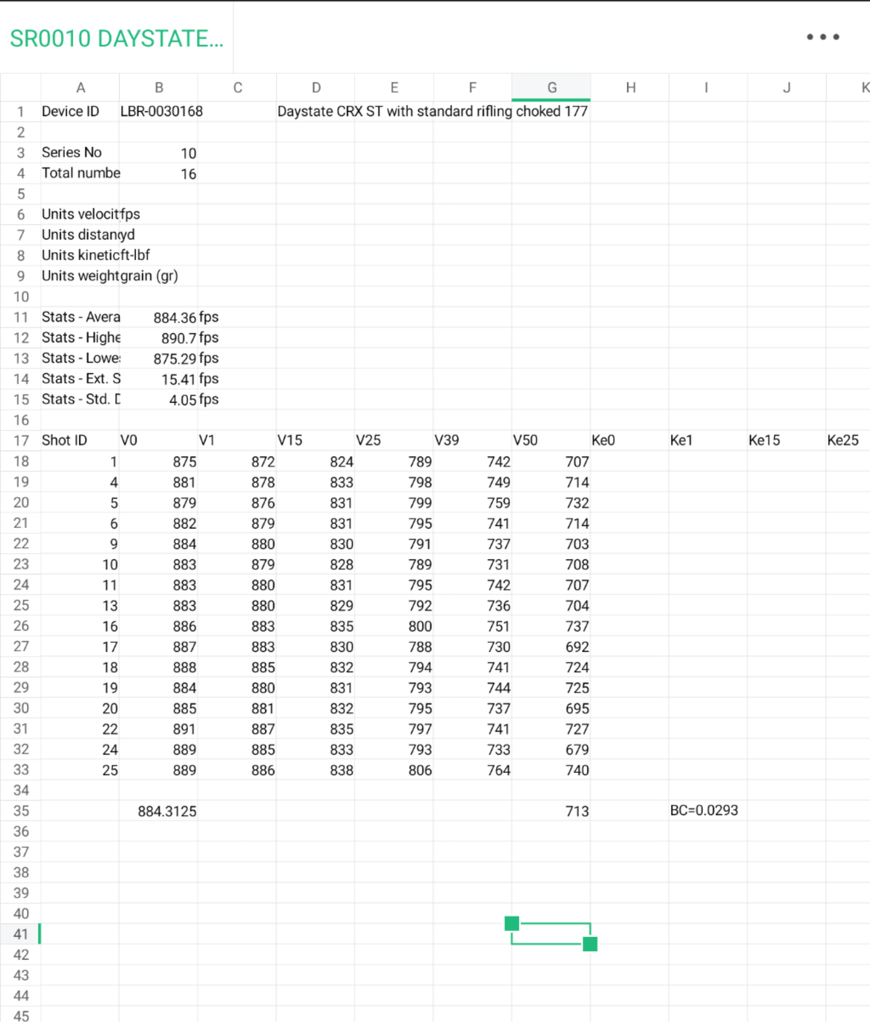

Now I had a TOUGH time editing the LabRadar data as it is SLOOOOWWWW with many glitches but the process was to delete the faulty data so as not to skew the results . The faulty data results when the tracking process goes awry and there is bad or no data in some of the yardage captures. This was why I chose to do 25 shots... to have plenty remaining after the editing. Please note that this was not an attempt to manipulate data, just get rid of faults.
So @Franklink took the spreadsheet data and processed it for me to give this list of rifles based on best to worst bc. There are some things to note but at this point, I need to sign off and will post more as I can. If you see me at EBR, definitely say hello and give me your thoughts.
In Franklink's spreadsheet, there are 2 entries for the USFT. Note above that 1 is at 923 ft/sec average and the other is at 890 ft/sec average. It's pretty interesting that this corroborates the general wisdom that is disseminated on this site about 890 ft/sec being about the best place for tradeoff between velocity and bc. Also, I intended as much as possible for the rifles to be in the 880 to 900 ft/sec range but some, like the Tsar, were not able to get there and I did not try to tune any extensively. Mostly, this was just where they were from last competition use. Also, the Goldstar data is missing from the current spreadsheet but suffice to say, it was quite good and maybe upper middle of the pack. This was one of my LabRadar fights. With regard to that, there are 2 target sheets because somewhere along the way, all my first files were lost. I tried to center up the shots on the second one better but the wind was blowing quite a bit so not perfect. So I shot 325 shots for record plus sighters on the cards and the LabRadar gives the results in a .csv form that I will have to convert to be able to post. I will try to do this soon as it is interesting.
So @Franklink took the spreadsheet data and processed it for me to give this list of rifles based on best to worst bc. There are some things to note but at this point, I need to sign off and will post more as I can. If you see me at EBR, definitely say hello and give me your opinion.

Thanks for the comments, guys. We DO have spreadsheets as well for each rifle and the standard deviations are included. There is much still to post of what we had so far but I couldn't upload any of the pics or sheets last night so I'll try again today.

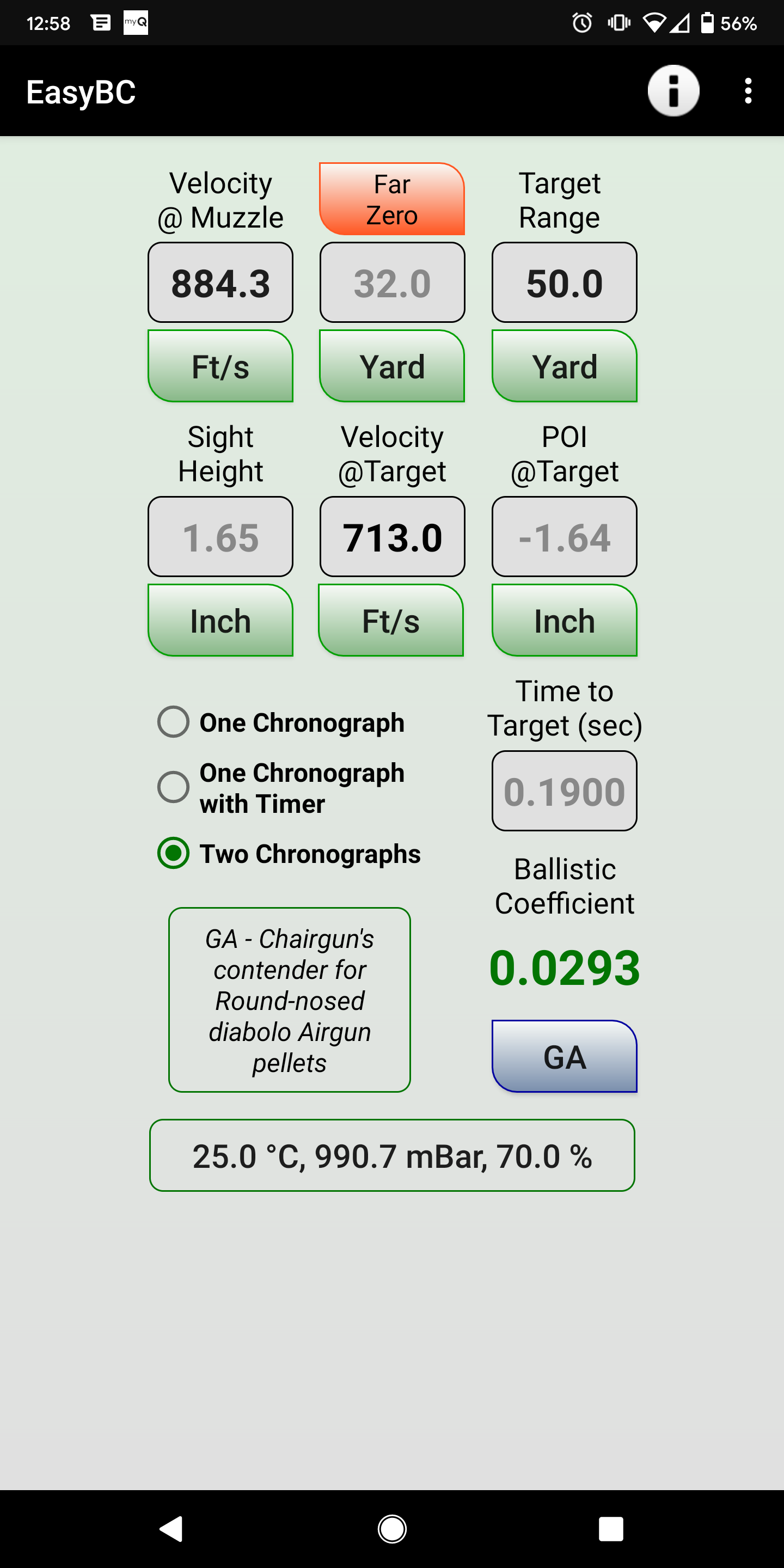

My part of this was extremely small, but I wanted to explain how I arrived at the BCs.
Arzrover sent me the files and I simply got the average for the columns that represented V0 (0 yards) and V50 (50 yards). I then took those average speeds and plugged them into the Android app "Easy BC." to get a BC. Then I ordered those BCs.
As I worked through the files I had no idea how the numbers would shake out. So, yes, it supports my stance (albeit previously only based on anecdotal evidence) but I did not manipulate the data to argue my case.
A file like this was sent to me for each gun.. (I added average fps for the two distances and also the BC from)
And here is a the corresponding screen grab from the app....

    • Consistency. The variability within those 25 shots was rather small, (SD of only 4fps in the example shared above).
