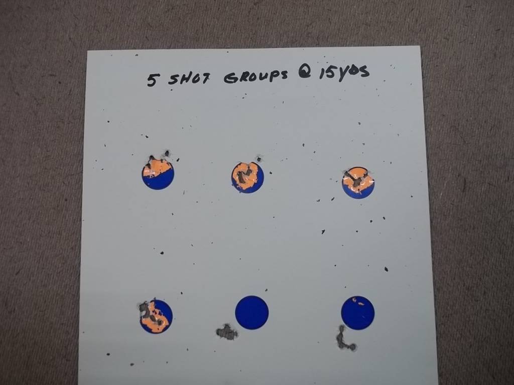

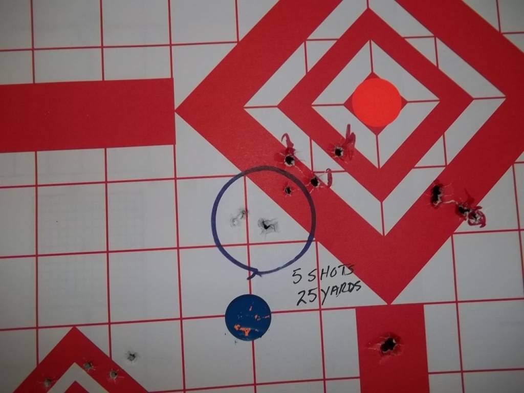

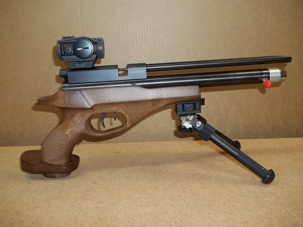

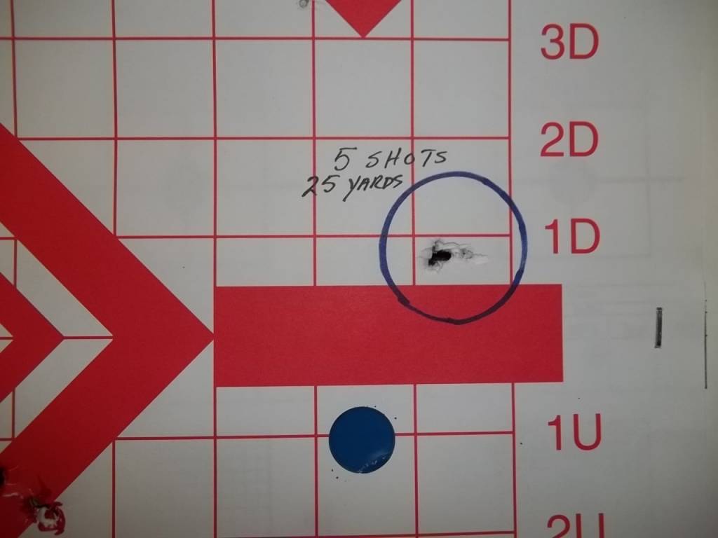

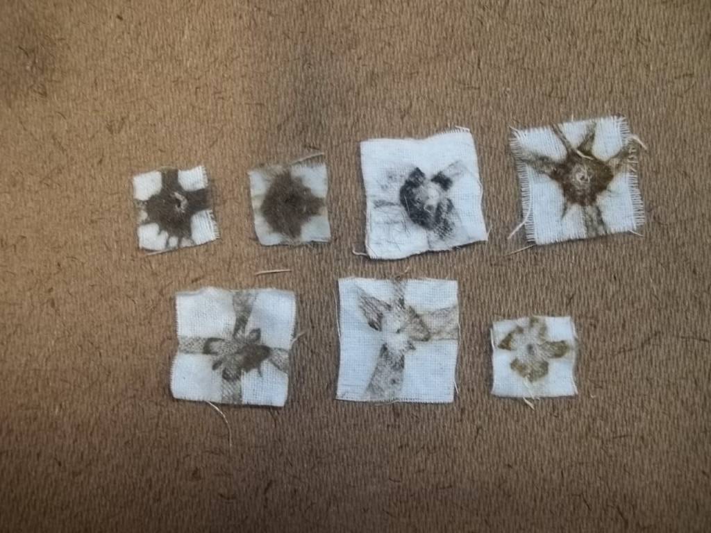

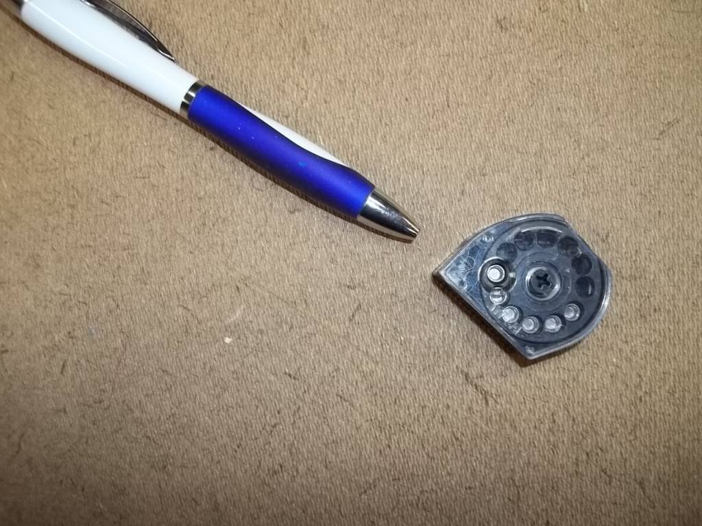

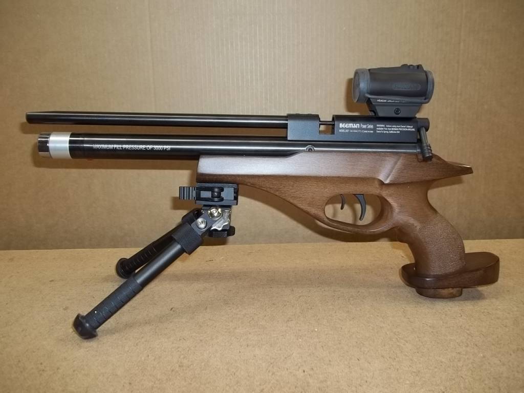

 Beeman 2027 pistol, for $150.00 I feel this is a great buy, VG accuracy, (see pics) fit and finish VG both metal and wood. Bore was the nastiest I have ever cleaned (see pics used more than what is in pic.) but it cleaned up bright and shiny after a total of about 10 minutes. Barrel is easy to remove two set screws on top. I removed sights, using small block of wood to tap front sight off. Installed red dot, had to do minor sanding on inside edge of grip shelf so it would slide up further on grip. Installed short rail on bottom for bipod. It will do over 50 shots before refill is needed. Found a fat tipped ball point pen ideal for seating pellets as you are loading, seats them evenly below the plastic cover. See pics of targets @ 15yds and 25yds these all were shot with a red dot. cronographed five shots all between 500 - 600 fps

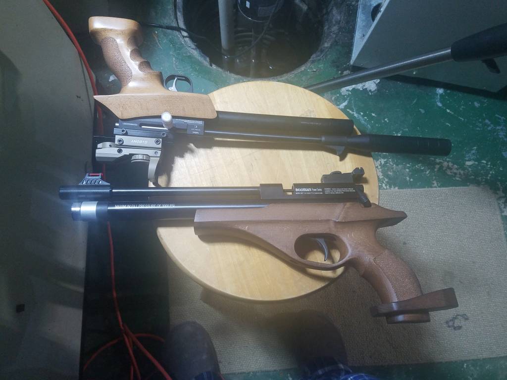

NO it is very different from a Bandit. Power level is super easy to set with a 5mm Allen wrench at the back of the barrel. You can bring it out to get 100 shots (at about 300 fps) or take the spring all the way in and get 30 to 40 shots at 600+ fps. Receiver is set up different as well. The Bandit bolt does not pull out the back of the receiver where the 2027 does. Safety is a flipper style and trigger is a a much longer pull (I am still trying to find and Allen key that fits the adjustment bolt. Magazine is a 12 shot and a lot smoother than the Bandit. It is what I imagine CARM would come up with with the o-ring place holder. Accuracy is great and action is smooth. Of the 2 I prefer this over my Bandit despite it being heavier.
