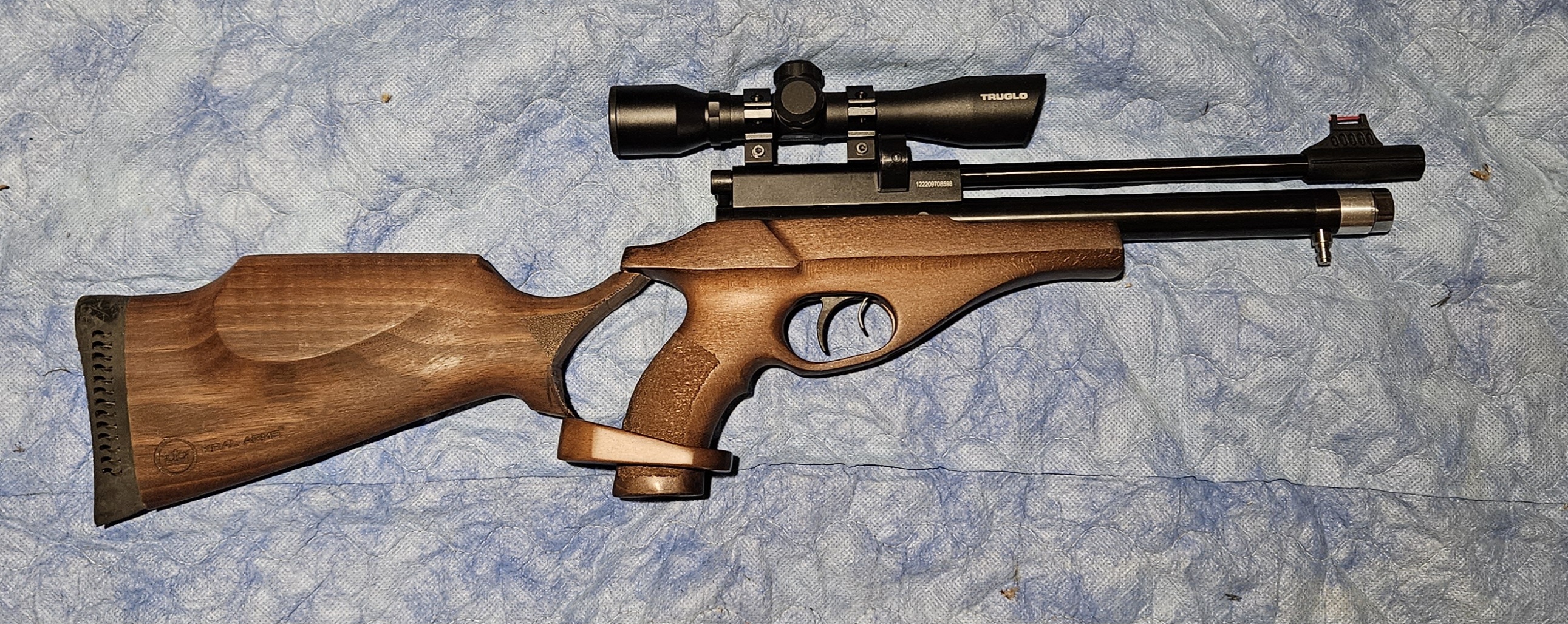

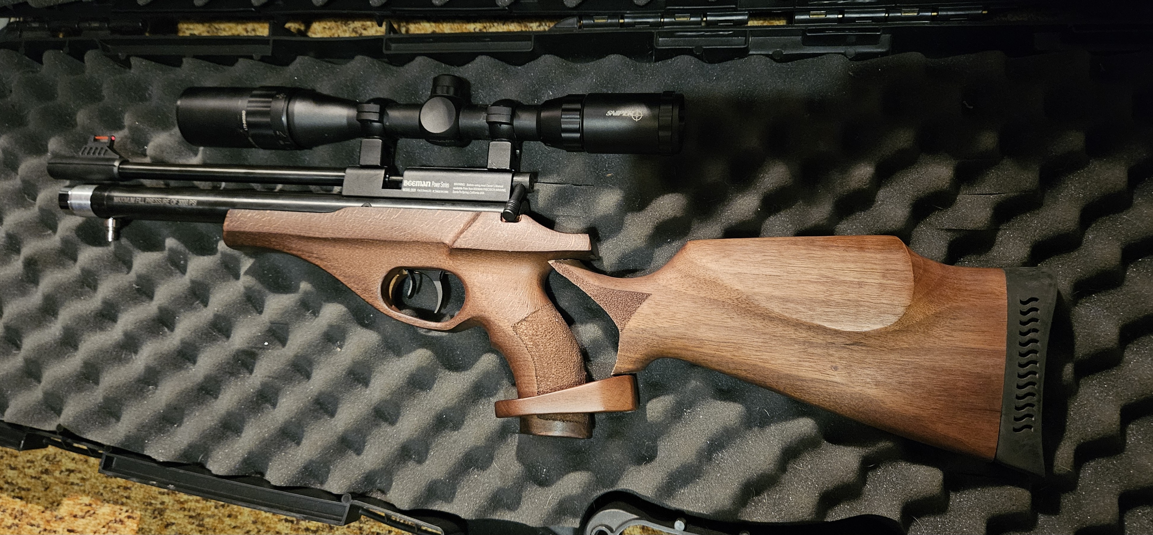

Here's a mock up with an old buttstock I had from my kral mega I used the fore end from. I'm going to cut it down a bit more to shorten the LOP and bring the cheek piece up higher. Mold the palm plate to the stock, and mold the top section of the thumb hole area to just the underneath of the pistol grip's beaver tail. Trying to keep from painting over the stock, and will mask off and do a textured finish to the bonded areas after filler.
I'm still baffled as to why this pistol is so gigantic. The trigger blade is huge lol.
Tossed a cheap tru glo 4x20 on there for now to see how it looks. Will pick up a better scope soon, and come up with some shroud parts.

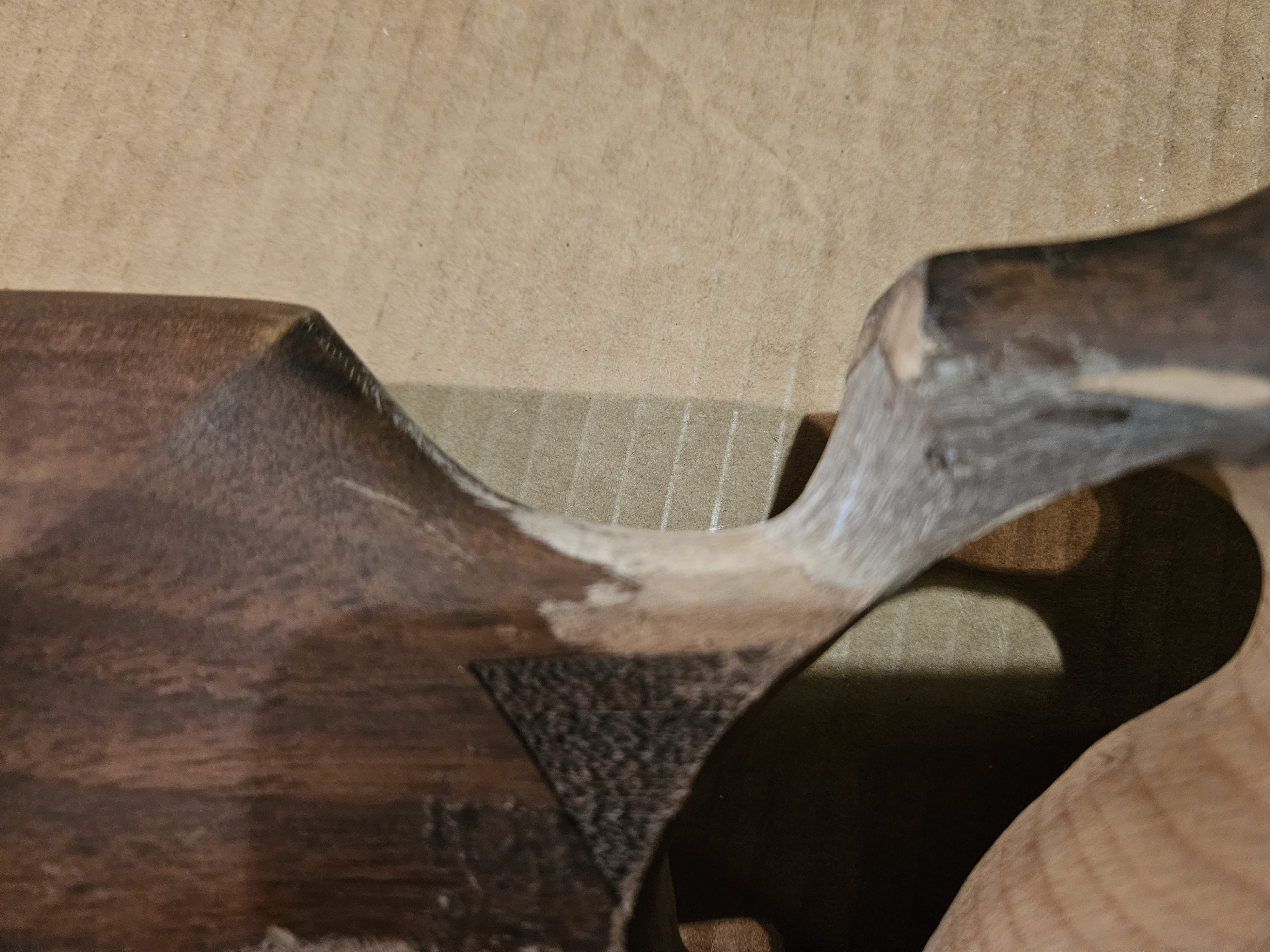

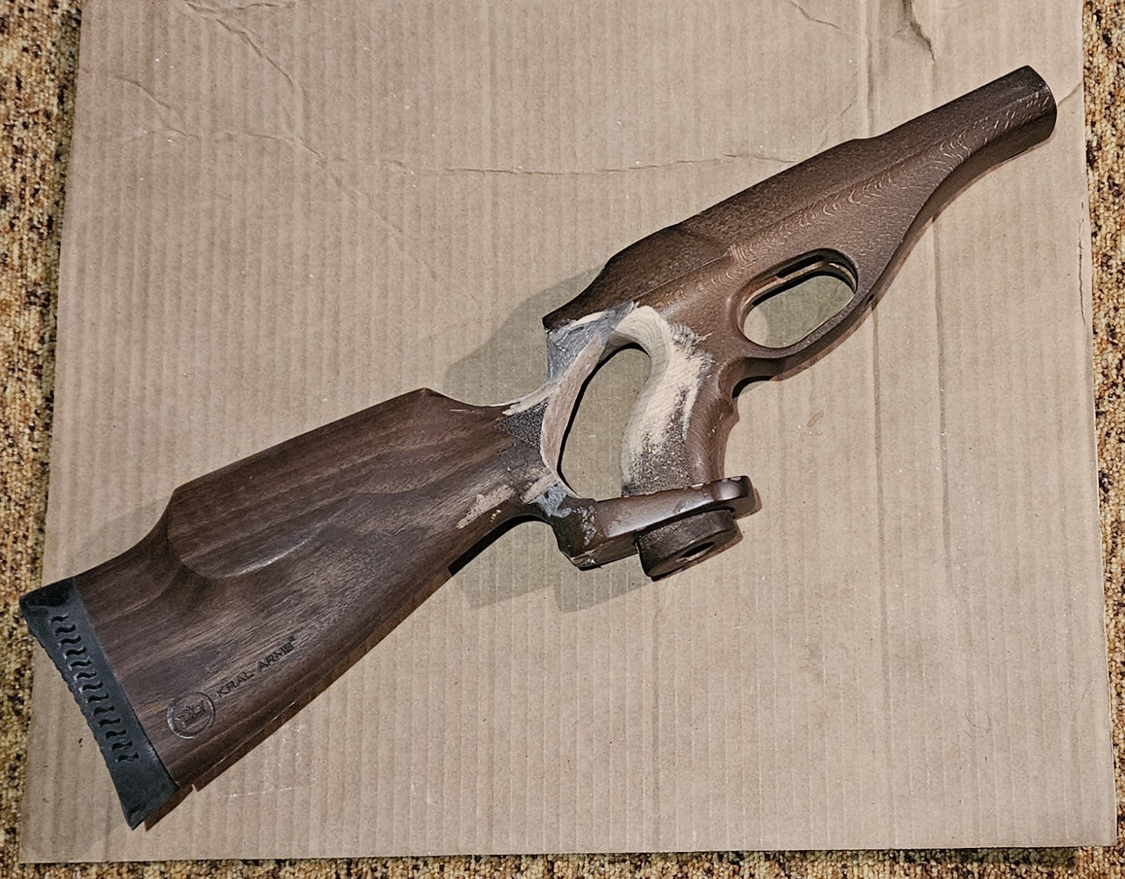

Went to Lowes and just got a new set of sander drums. Made short work of this hard filler. Reshaped the grip and thumbhole, now the stock fits my hand like a glove. After moving up thru the sanding phases, it should come out just about perfect. This was a 50 grit drum to knock it all down.
in this last picture, you can see the out of round drop to the comb from the pistol grip beaver tail. I'm going to add a bit more filler to bring that nice and round.
Probably need one more final brush coat of resin and sand it all back with 60-80-120-220. Final sand the entire stock with 220-320-400. The filler is actually looking pretty dark, so I will most likely give it an oil based dark walnut stain and it will hopefully hide the lines.
I gotta figure out what I'm doing with the Kral logo on the stock too. If I fill it, it's going to ruin the grain and then I'm stuck painting it or dipping. I can't sand it out, because it's too deep and close to the butt pad, so the lines will be off and it'll look flat there.

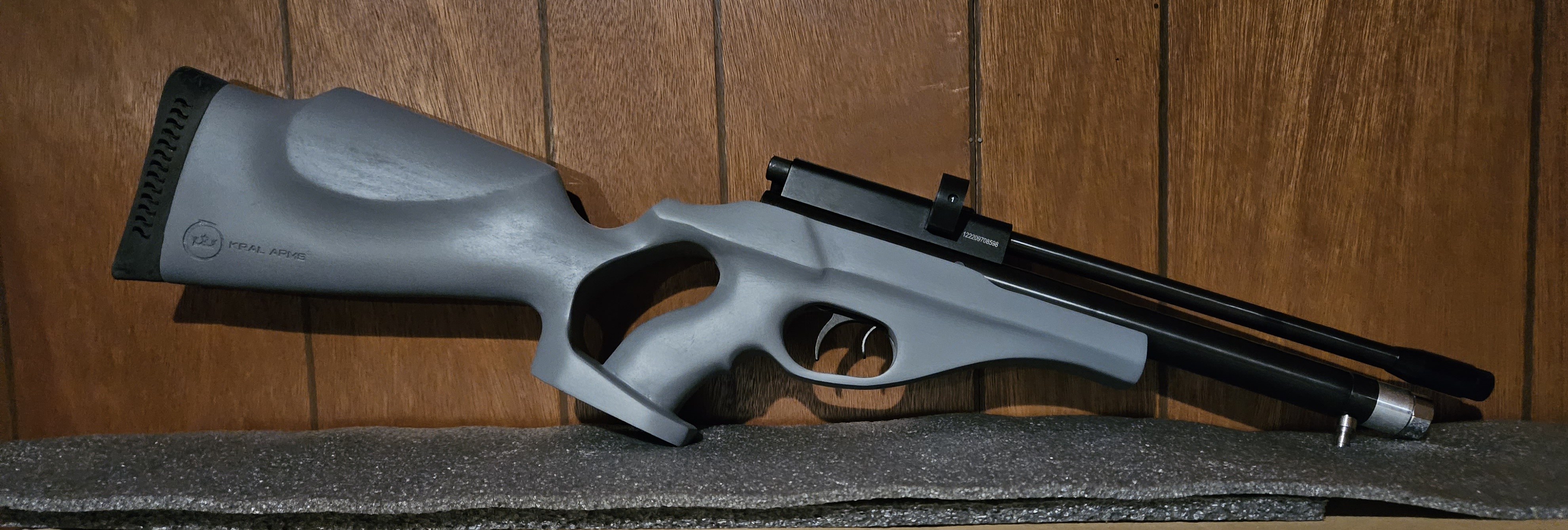

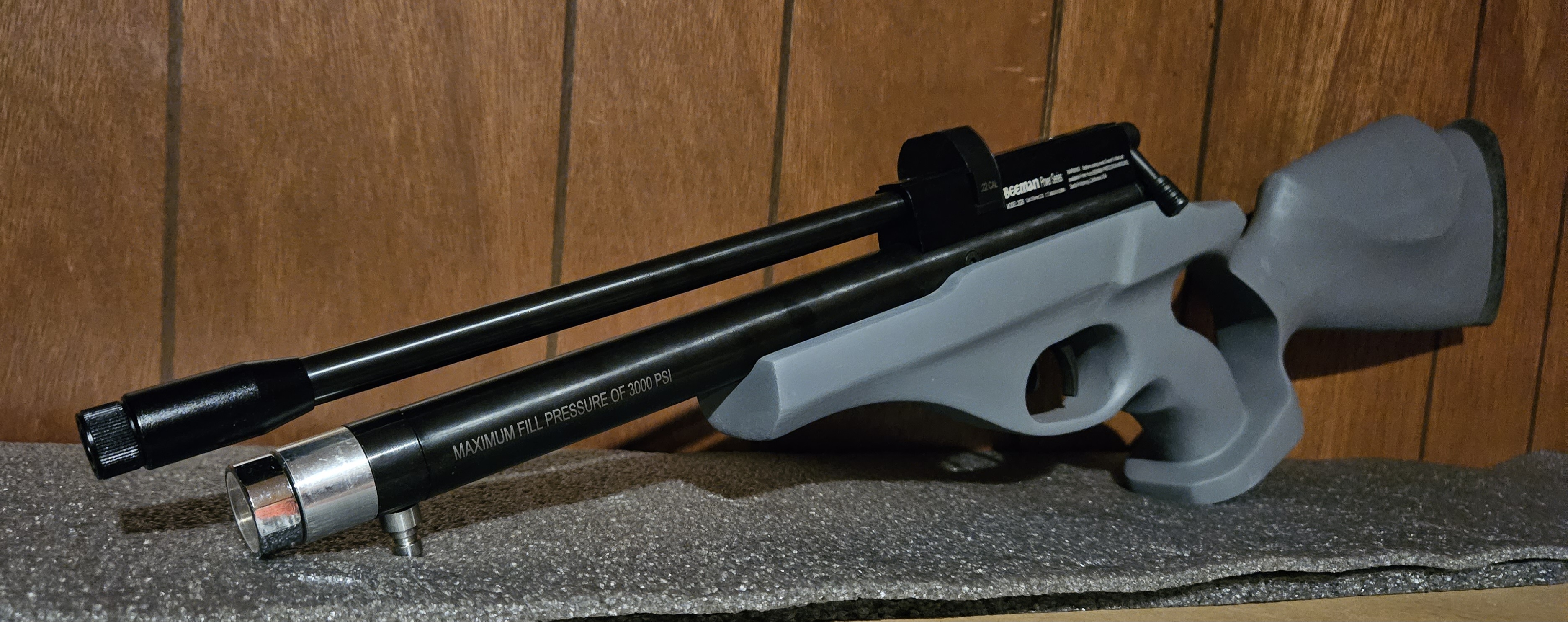

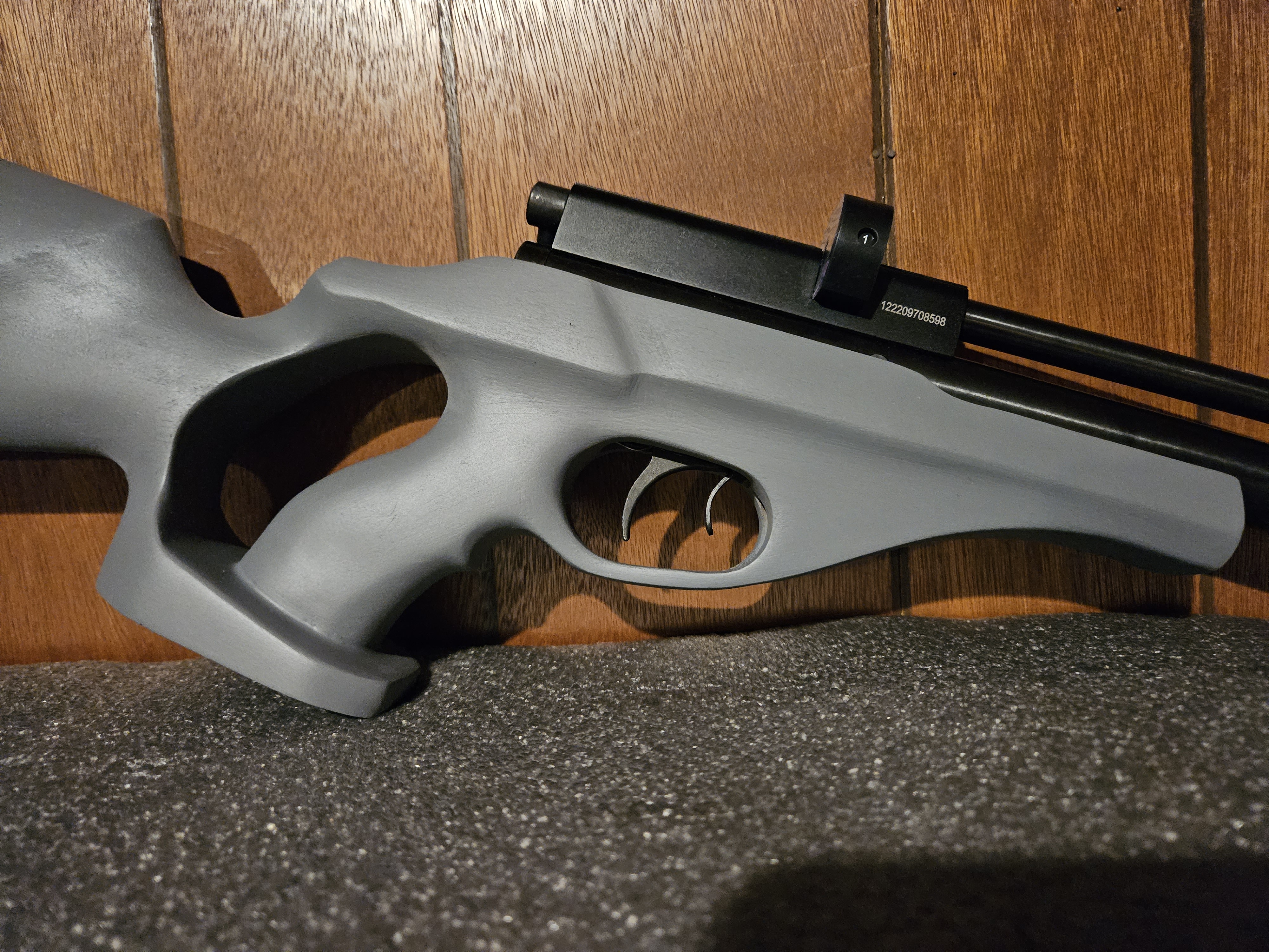

*Update*

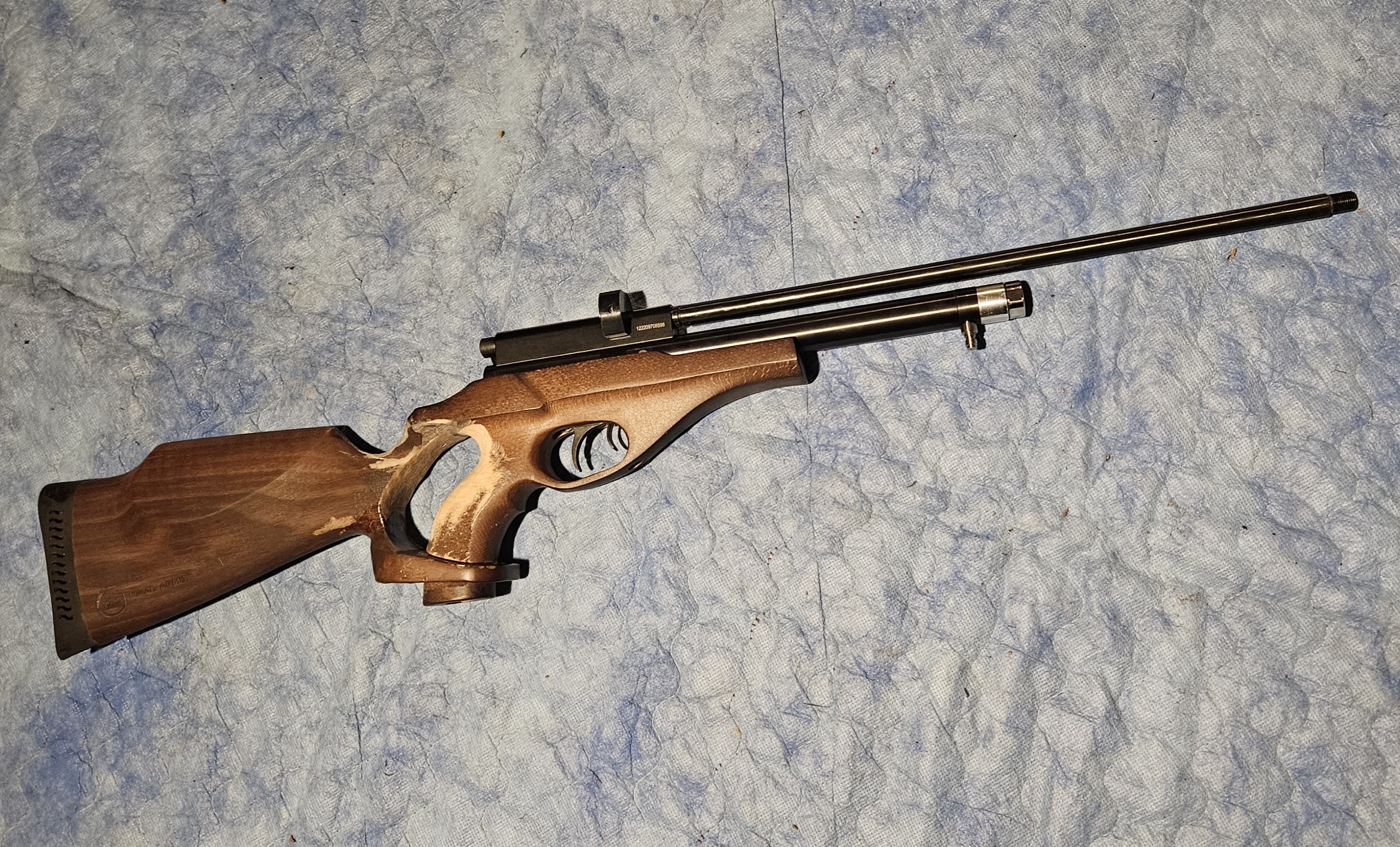

Finally go the stock shaped and sanded. Couldn't get the resin filler to take a stain, so I'm going to paint it or dip. Honestly, I'm digging this first layer of primer.
Going to fill in the Kral logo on the back, and fix a couple minor spots. Also got my 1/2-20 adapter and it fit snug on the barrel. Tried my donnyFL on it, and it's super quiet with a moderator. Just need some CF tube for the shroud, and I can get this thing operational.
I tried the little bearing trick on the trigger like can be done with the crosman break barrels(same trigger group on here, gotta love China), but the sear wouldn't catch and the gun would discharge with just a shake or jiggle.
I took the spring out and crushed it a bit tighter, and now it's much lighter. Still a decent amount of creep, but you can just pull til 2nd stage and do a quick tap and it breaks crisp. I may try a longer take up screw to change the sear angle, but it's fine the way it is too.
Hoping to put a Hawke Vantage 3-9x40AO on this gun, should work perfect for the power level it will have.
