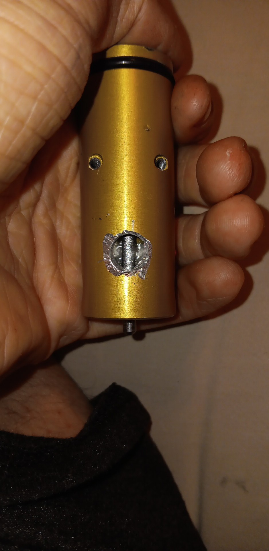

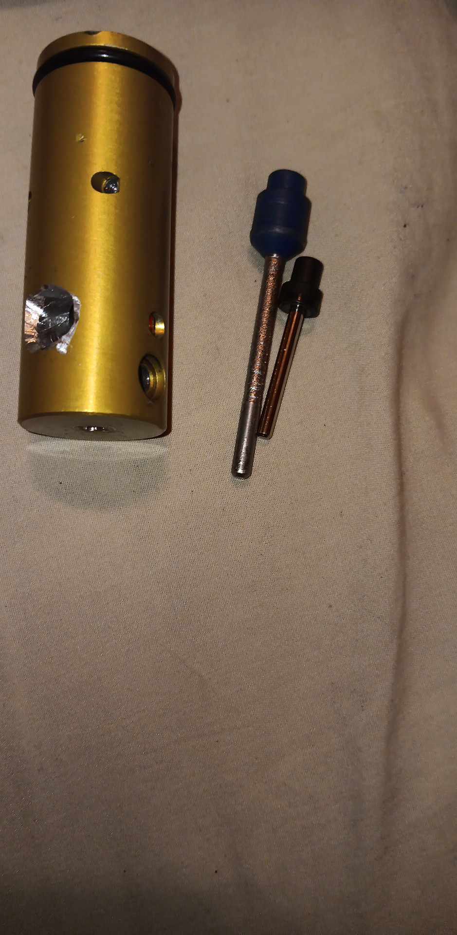

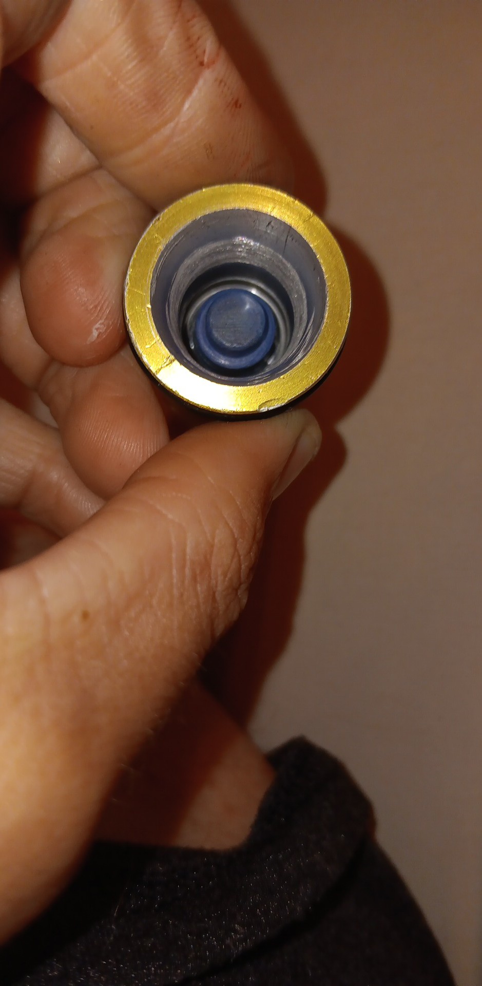

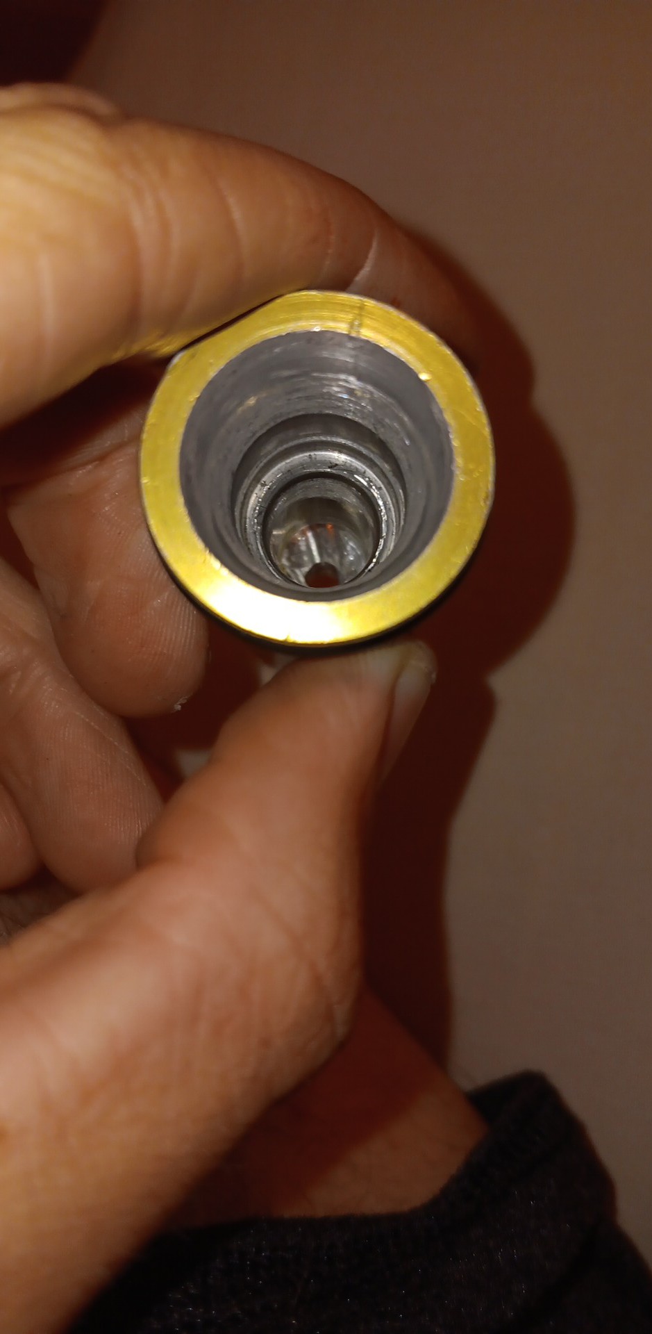

I built a big bore valve for a marauder .22 i have just to tinker around with. It has a .375 throat and a .300 exhaust port pretty big valve uses a way bigger valve stem and poppet than stock only issue is no matter what psi i fill too it valve locks
"pretty big valve uses a way bigger valve stem and poppet than stock only issue is no matter what psi i fill too it valve locks"
Well, that would be the problem right there.

I need to get a heavier hammer made so it will open the valve all the way up
