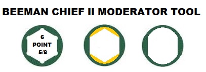

After much searching and not finding any info, or tools for sale, I decided to try making my own tool/socket to remove the moderator.
I was able to decipher the distance across the flats of the nuts {5/8"}. Then, I used a Dremel to grind away the area of the socket
that needed to go around the curved outside edge. Not knowing how much torque was required to remove the nuts,
I opted go with a 6-point socket. After removing the nuts, I think a 12-point might be acceptable. That would require
a little less grinding.
Anyway, I used a 6-point 5/8" socket. With the Dremel, I ground away the amber areas in the pic until it was able to lip over the nut(s).
You only need to go about a quarter of an inch deep into the socket. The nuts are not very thick.
Note: If you're going to attempt this yourself, go slowly and test often. If you remove too much of the socket it may slip on the nut,
and mess up the edges of the nut or the socket, and you may have to start over with a new socket.
Also, a standard socket will work. No need to use a deep well socket, but you will need at least a 4" extension to reach inside the
moderator.
Image should be self-explanatory, but if you have any ???, I'd be glad to assist.
