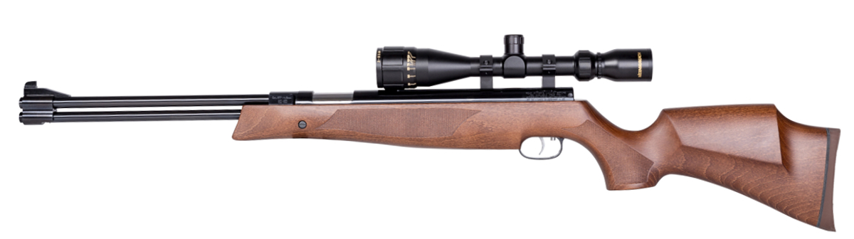

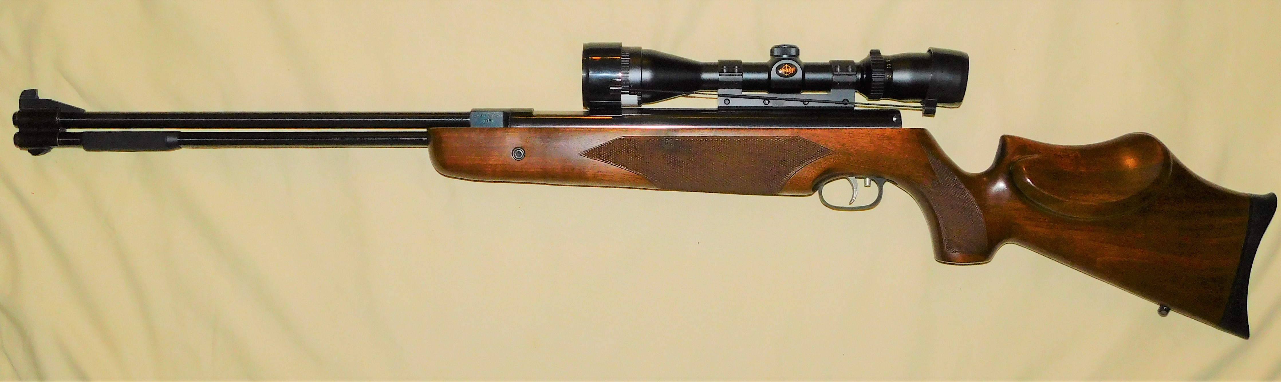

I agree to much of the above. Me always preferring the old stuff to the new. And using to reject any innovation by sheer reflex. They went too tar for instance those laminated, stratified stocks in blue and yellow or so. And ambidextrous is a bit of genderspam ok. Still, from the very biginning I liked the new stocks very much and disliked the older ones as well as the HW80 stocks. Always disliked those unsymmetric right cheek stocks, too.
For instance the recent HW35 stocks are ambidextrous. Don't know what they had in their minds. The back part is beautiful but the forearm is extremly ugly that molten aesthetics like the Gamo Hunter displays. They couldn't decide for a proper style.

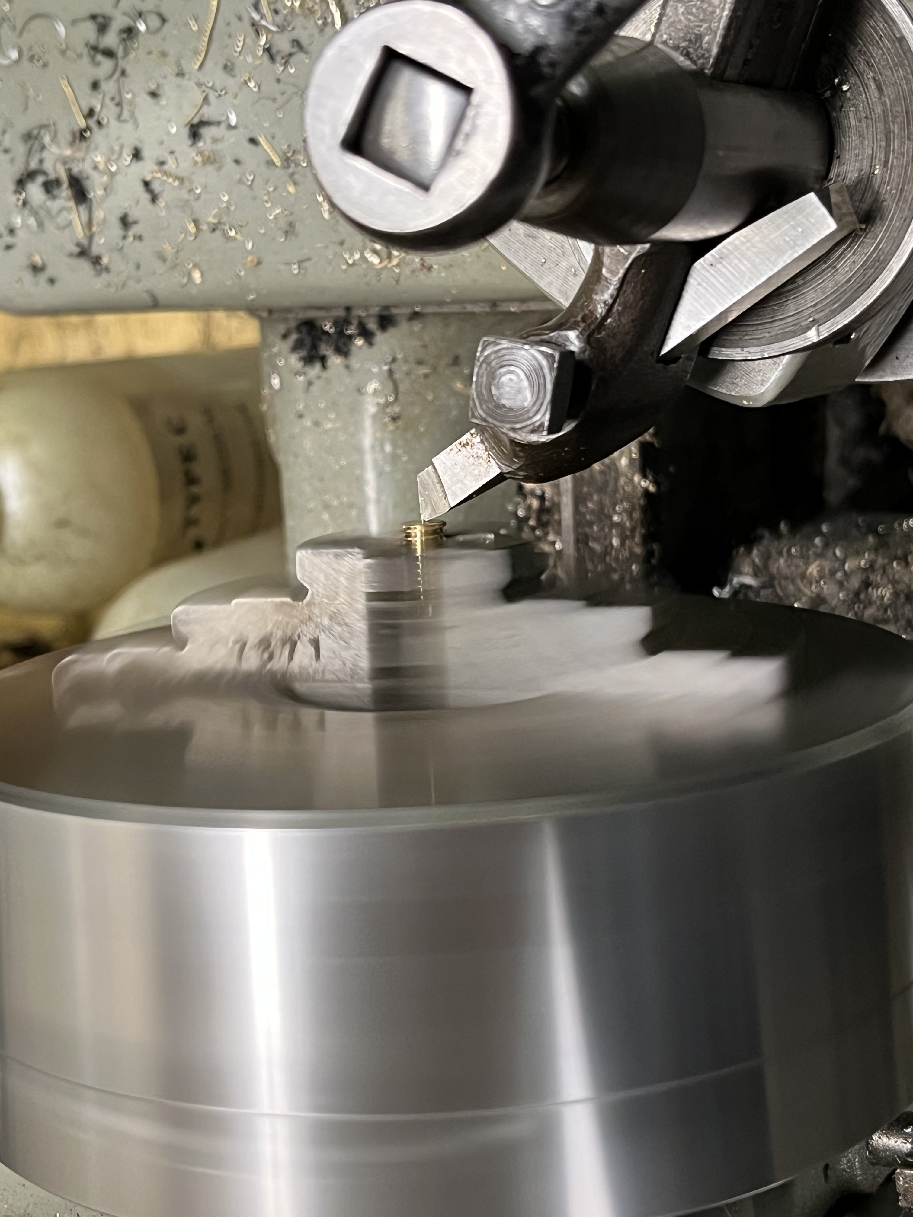

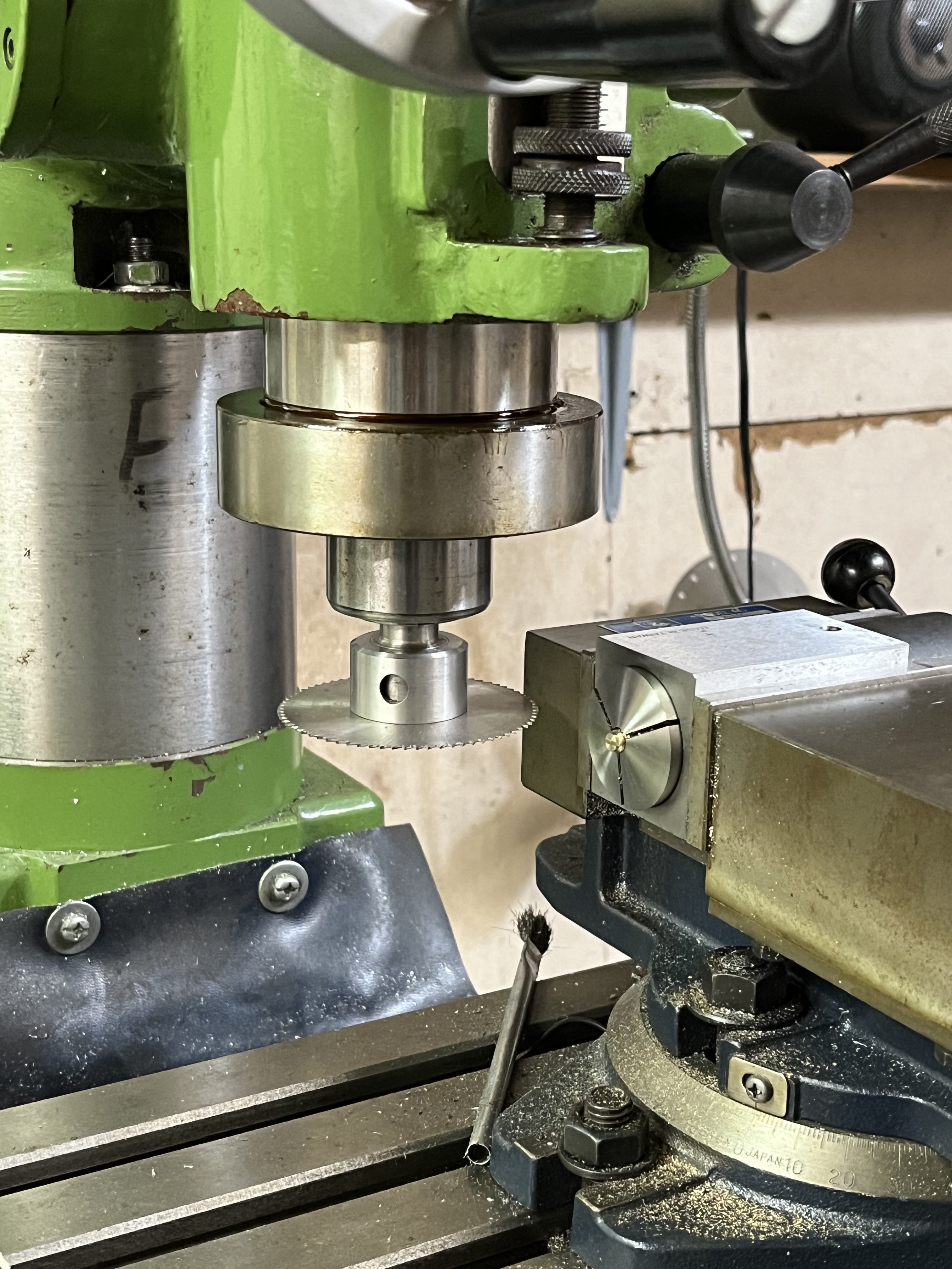

etc. Then I disassemble the rifle and clean out all the factory grease, then make new tighter fitting spring guide and top hat. Deburr and polish anything that’s needed and reassemble with krytox very lightly. IMO now the HW is ready to shoot and there’s no more twang and just feels better. On the flip side many people just unbox them and shoot as is (twang) and all, and eventually burn all the grease from the compression chamber..lol. And that’s fine if you don’t want more. I myself like to make the rifle as good as I can, and eliminate any factory assemble errors and check everything out.
