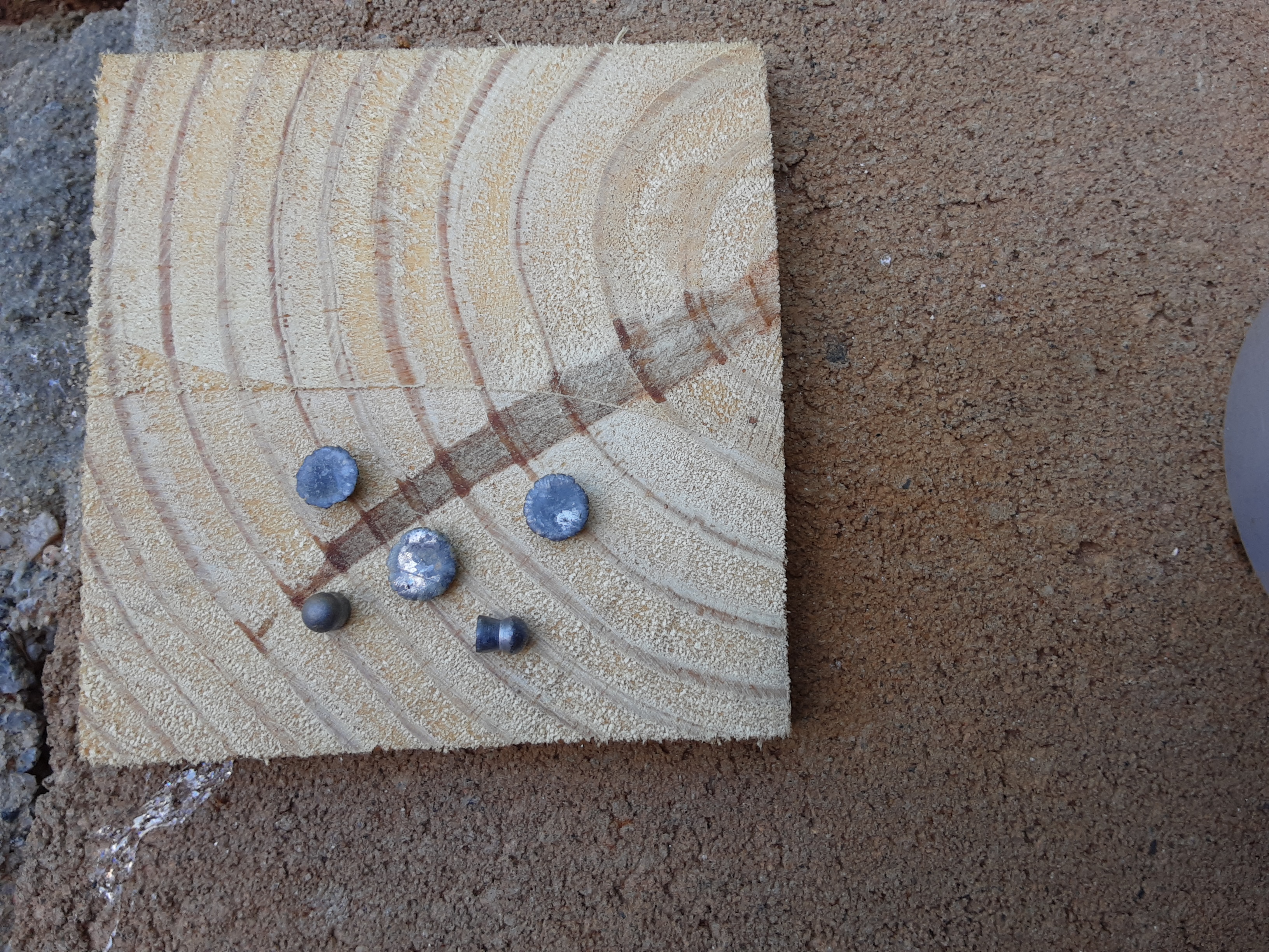

Will not bust a beer bottle at 10 feet.
Attached is what happens when shot at said beer bottle.

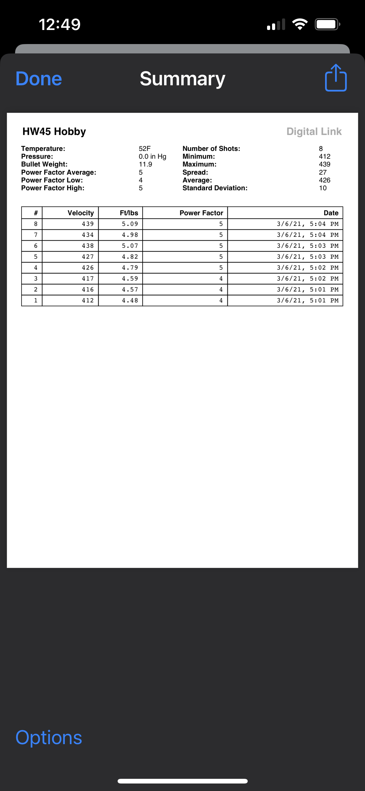

These are the numbers from my .22 on high power with 11.9 Hobbys. Shoot it some to get it heated up and dry fire it twice, that should help.
