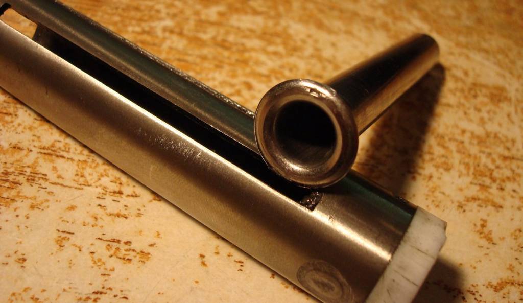

Notes for improvement...One thing that improves this issue, is polishing the seal face down until the barest of slip fit. This way any increase in diameter due to temp expansion, slows the gun much less than it might, while shrinkage, has the lesser impact....(this is noted by any seals in any guns which have worn to the point that they barely seal, but still make surprisingly good power but a tight seal can play real havoc with the guns power) ...nice slip fit then...

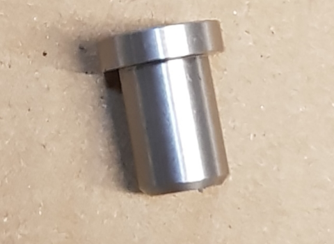

Notes on piston weighting. The OEM guide turned the wrong around to be inside the piston can give you 25 grams added weight to the piston, and send the Hobby pellet into 570 fps territory... Placed in at the opposite end (no weight in piston) loses 40 fps as the piston weight fights the long TP on its own.....its not the heaviest piston, being relieved for the duel cocking arm slots.....it needs the weight..
