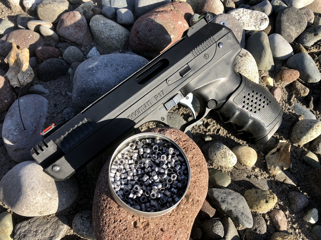

Beeman P17 Pistol (model 2004) quick review... Hint, I love this gun!
Guys, I have had this pistol for several years now and for a low dollar gun you wont find a better trigger. Extremely accurate and the single shot action forces you to focus on you marksmanship.
If you are in the market for a new pistol (even if you are not) take a look!

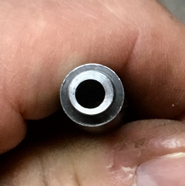

One thing too look out for (which I didn't) was the off-center-drilled bore in the barrel. Got the pistol cheap, used, and now I know why. Never shot well, and since I got it cheap, no biggie. Also gave me an excuse to make it a .22. Took a new Crosman 2240 barrel and machined it to fit the P17. Few layers of aluminum/metal duct tape on the piston top and now I have a .22 cal P17 that shoots extremely well and still squeaks out about 350-360 fps with light Hobby's.
