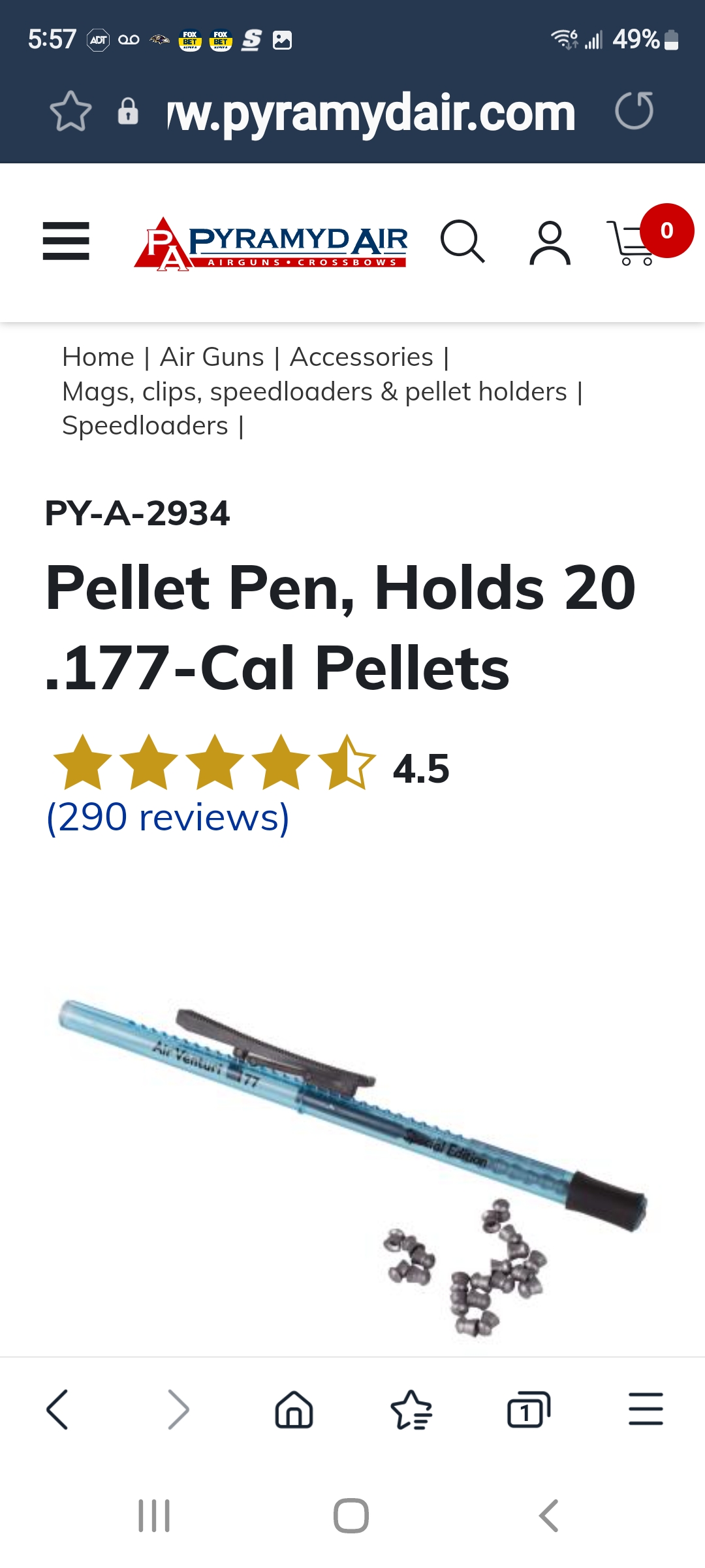

Take a look at a $10 pellet pen. Should solve your fat finger problem.
