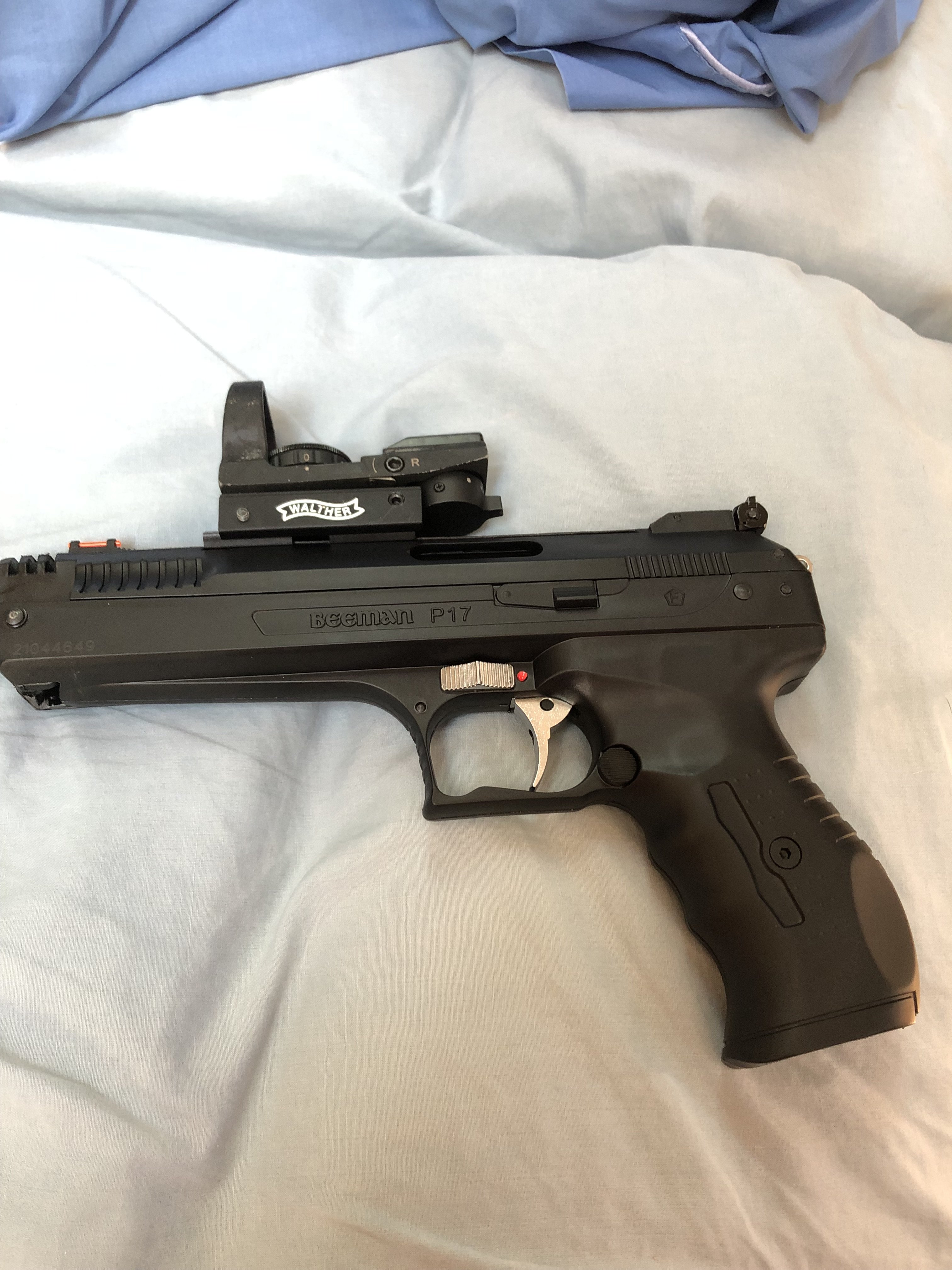

i about to have a spinal fusion so i got one as they are really cheap to play with as im gonna be down for some time after this fusion, anyways what a cool little accurate thing very good trigger also shooting 8.44 fx out of it, barrel was filthy so of course i cleaned it well. open sightes at 12 yards is a blast 2 inch groups im happy. can put 3-4 in a inch if use a rest but not every time as its pretty hard, thinking a red dot but they dont magnify which is fine i can see just fine if i use the glasses, what are you guys set up with, just out of curiosity,

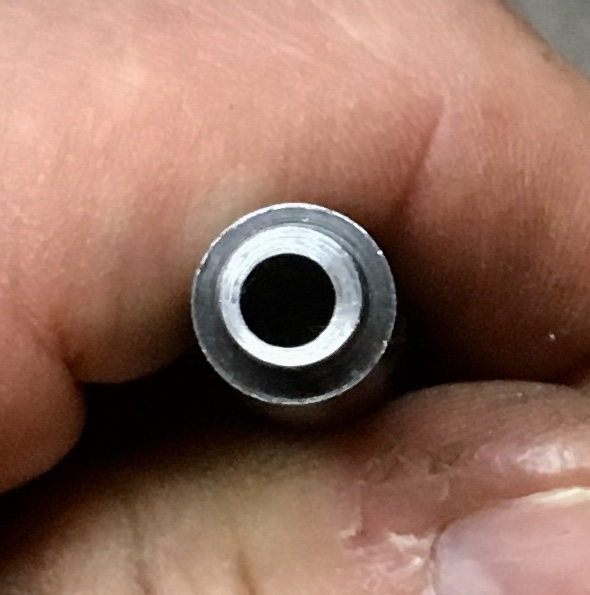

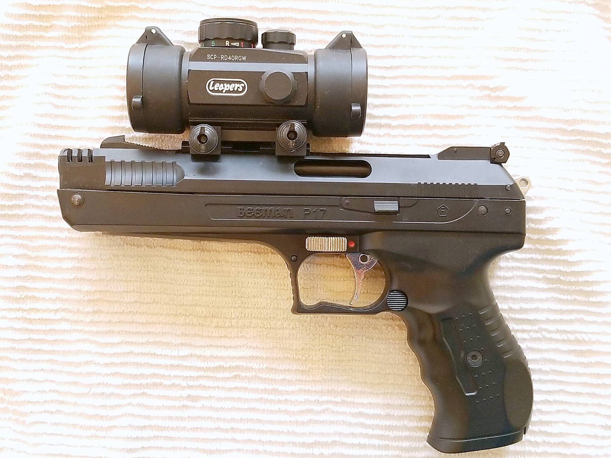

These are fun and surprisingly accurate. I used to have a couple of these that I picked up on clearance at Walmart for some ridiculously low price some years ago. I put red dots on mine. I removed the barrels for polishing. I used a cone-shaped Dremel grinding bit to ease the breech chamfer a bit and to re-crown the barrel. I used the corner of a craytex abrasive block with some oil, chucked the breech end of the barrel in my hand drill to polish the crown.
You can take the grip apart and put some moly paste on the trigger components to smooth them out. You can also remove a link to disable the automatic safety and make it fully manual.
Some of these are very sensitive to how you dress the hairpin trigger mechanism spring inside the grip. A certain orientation would cause the mechanism to malfunction.
With a rest, I think mine would easily group a half inch or less at 15 yards and I think I was using jsb 7.33 grain.
Hope your surgery goes well and have fun with your p17!
Regards,
Feinwerk

Is cocking the piston difficult with the optic mounted as you show it? With mine I have to push on the top of the slide in front of the rear sight. If I push on the rear site on the cocking stroke it gets uncomfortable real quick.
