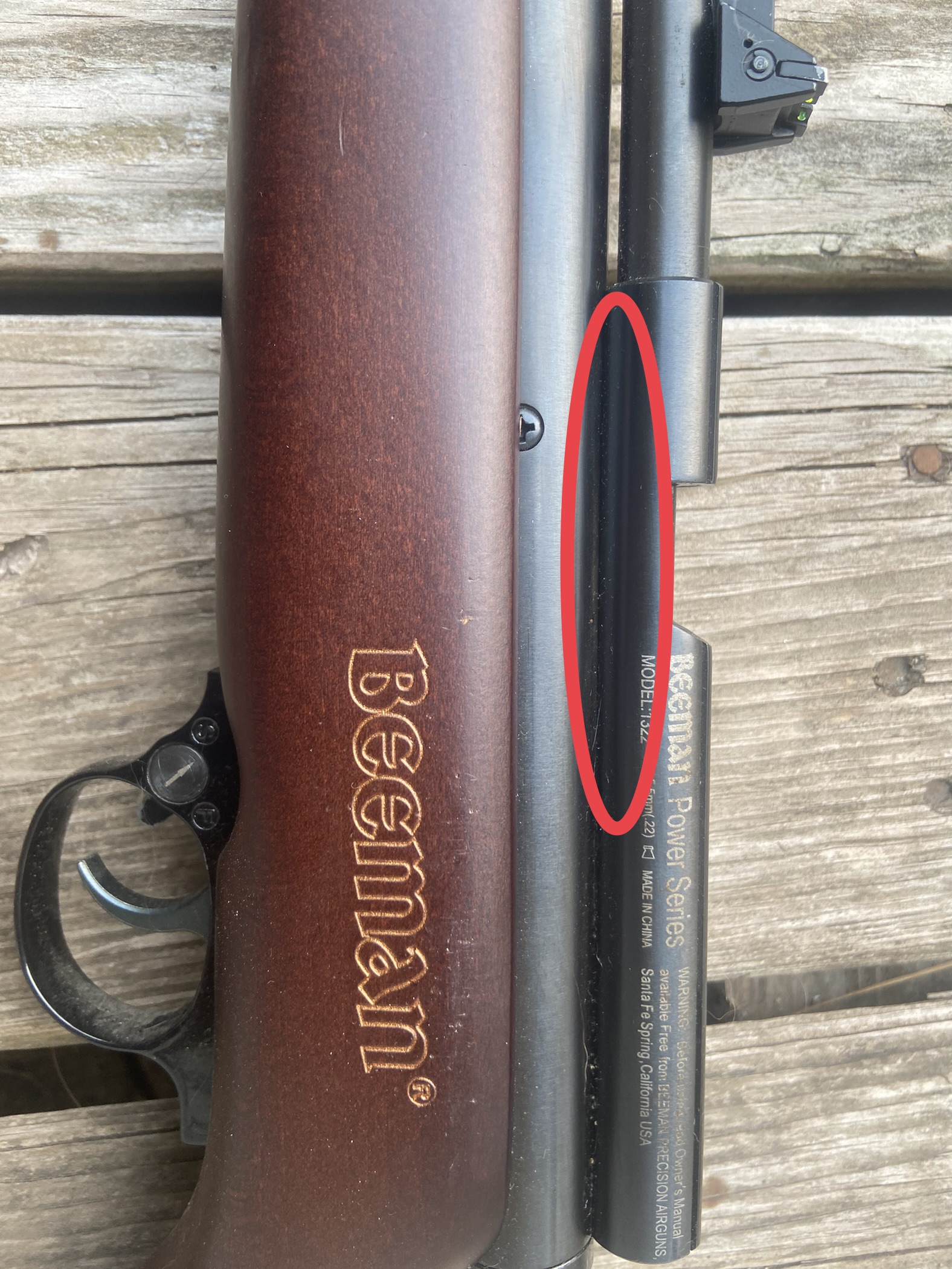

Beeman qb chief leaks when fired
Hi, I have a beeman QB chief 1 (.22) and it blows most of the air out of the side right under the breech when fired the pellet still has around 600 fps with the leak (used to be 800-900fps) the tank and everything holds pressure it’s only when I fire. If anyone knows how to fix this I’d greatly appreciate it.
