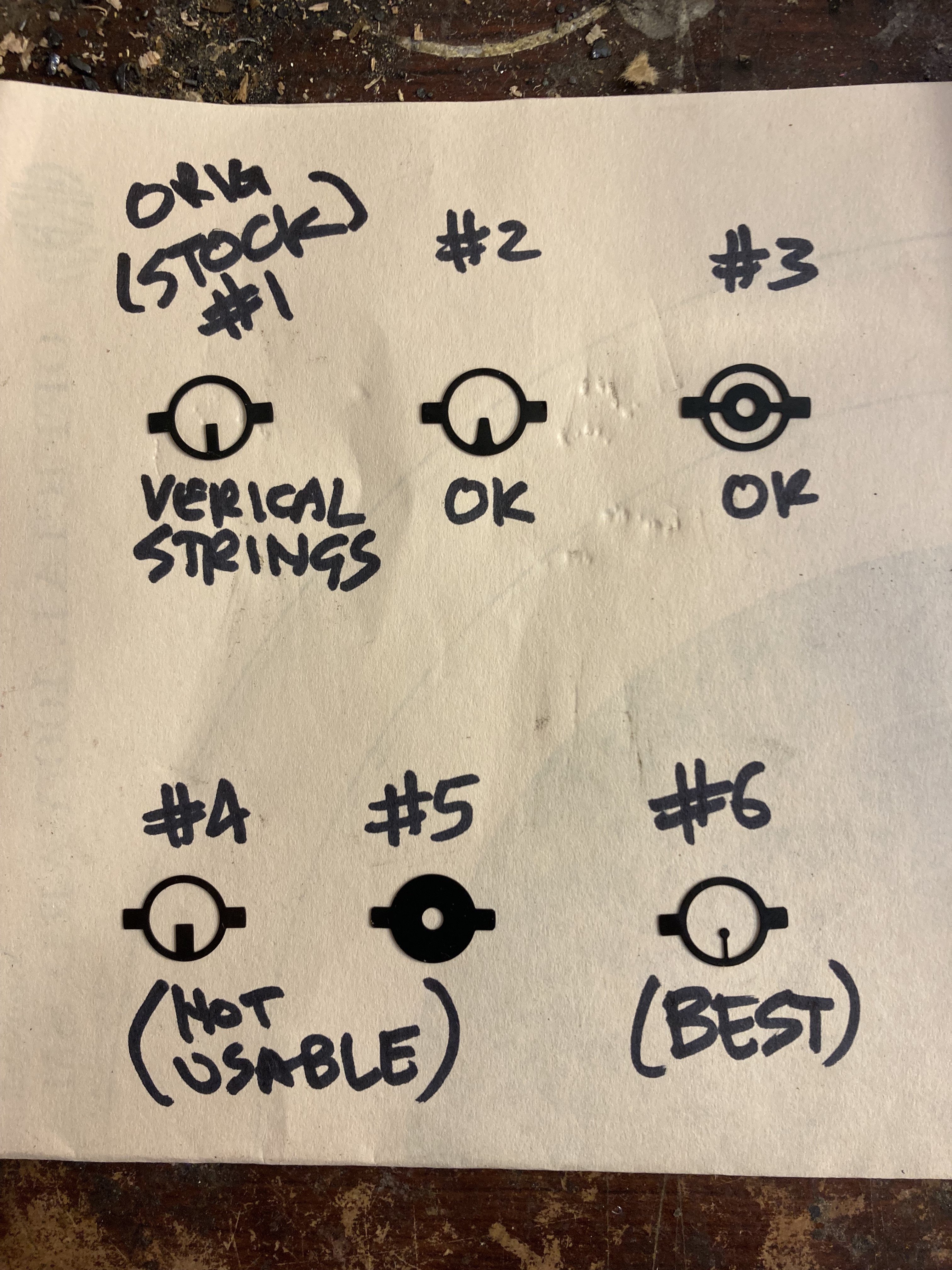

I shot 10 shot groups with sights #1, 2, 3, and 6. Inserts 4 & 5 were unuseable with my target selection.
Here's the results, sorry if my notes are a bit confusing... All pellets for this test were Crosman Domed 7.0 gr
I found sight #6 using a 6pm hold was the most precise.
Good news, after a couple of hundred rounds my flinching was reduced quite a bit. Also probably well on the way to breaking it in properly. My conclusion is I would love to keep working with and shooting the open sights but really would like some type of rear ghost ring. Would a Tech-Sights type set up work or would the break barrel hinge make it pointless to try? Curious about the vertical stringing. I see the potential for accuracy with this gun.

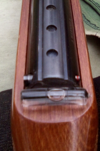

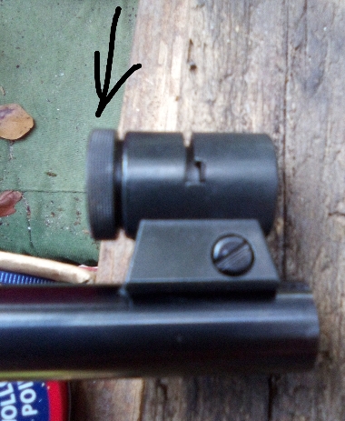

3 things you may watch.. the insert set thing screw can loosen.. my ne the big thing was the front globe walking up its dovetail you see what ot took to stop that .. it stays put on the end of the muzzle now .. then the rear can shift ..
The globe walking was the biggest issue . That weak flathead screw just cant hold it .. but a bolt and nail polish as glue and movment indicator ( if it cracks its moving) pit a stop to that and poi shifts. 😉
First picture you see the globe walked up the dovetail and climbs the sloped part, not good ..
I have not noticed any movement of the front sight in the dovetail. I will try the nail polish trick though and watch it. In any case my shot inconsistancy is vertical. My R9 seems to be shooting dead on left/right. Thanks
Dont forget to match the rear sight notch to the post used... If you (and should) use the lolly use the "U" notch and cradle the ball in the cup so to say..
Thanks for the idea but when it comes to open sights I love rear peeps. I've had them as standard issue on my M1, M14, mini-14 and AR rifles over the years. Combined with a simple front rectangular post they are the best sights for me. With the stock square notch on the R9, the lollypop front post is the best of the ones that shipped with the airgun.

In my opinion the globe front sight needs to be set right on the end of the barrel not back on the slopped part of its dovetail. / As forward as possible..

Well.. the globe if back on the sloped part of its dovetail will walk up and can cause that vert stringing.. goes to why mine is bolted on as i showed and mounted away from the sloped cut end of the dovetail and at the muzzle end. Just a fraction of a fraction of a mm riding up the slope gives that vert stringing. I did not " fix" mine just for the fun of it..
The lolly and U notch is most accurate combo with the proper 6 oclock hold. Not the 6 oclock hold for assault guns or pistols.. it's target compition not military spray and pray...

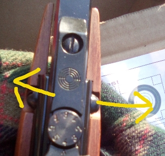

Heres another trick ive done to work on my hold . I call ot the cant cante device 😉 ( temporary glued on in place)
