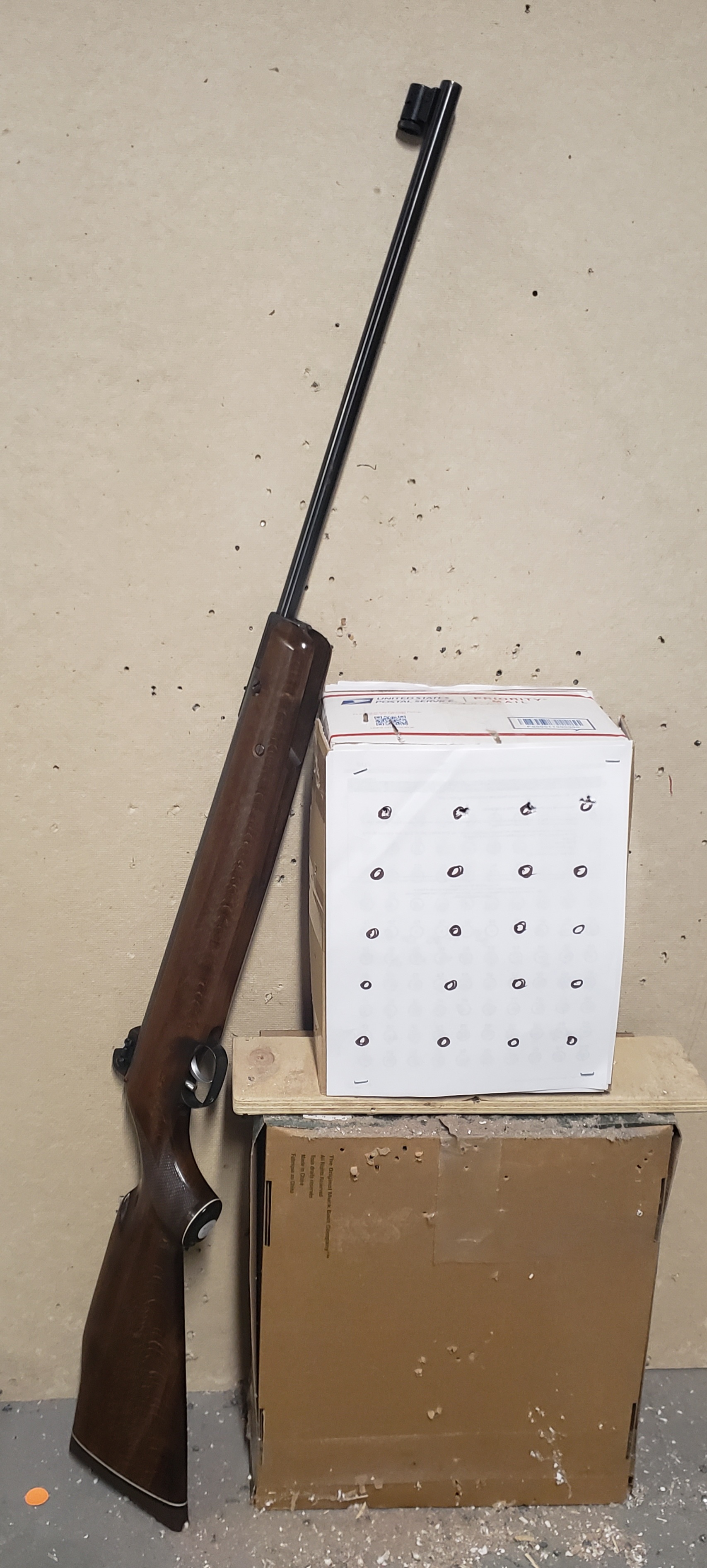

A random Beeman R1 manual I found online mentioned a 1,000 shot count for full break-in of the spring/piston/firing mechanism. Imagine similar for the R9. I'm at about 300 now.
Wellllll... Maybe.. i think it's more to get it all good and seasoned... The more shots i go the better it seems to get not just 1200 and it's there... Then when ots at ots best the spring busts and tune time..lol
Well.. the globe if back on the sloped part of its dovetail will walk up and can cause that vert stringing.. goes to why mine is bolted on as i showed and mounted away from the sloped cut end of the dovetail and at the muzzle end. Just a fraction of a fraction of a mm riding up the slope gives that vert stringing. I did not " fix" mine just for the fun of it..
OK, I'll be paying attention to that. I am a bit sceptical that is the cause of the issue I'm having. In my first target I posted with the extreme stringing they were still staying on the black. If the front sight was "walking" I would think they would walk off the aiming black.
No the walking up the dovetail slope it's like adjusting the eleavation not windage .. as it goes up the "ramp" part of the dovetail end the post drops and causes you to aim higher or lower ?( or like that).
Then you get some vert stringing.. .
It took me a lot of shots and observation to discover that deal.. anyway id just move it as far forward as i could and lock it down make a index mark with a pencil and keep your eye on the mark for walking .. it all them little things you check and tweak as you go to get it stright and true ( any gun) . Like i say rome was not built in a Day. It took lots of shots and time to get mine in the right direction and a solid hitter at any yardage 10m to 100y on irons..

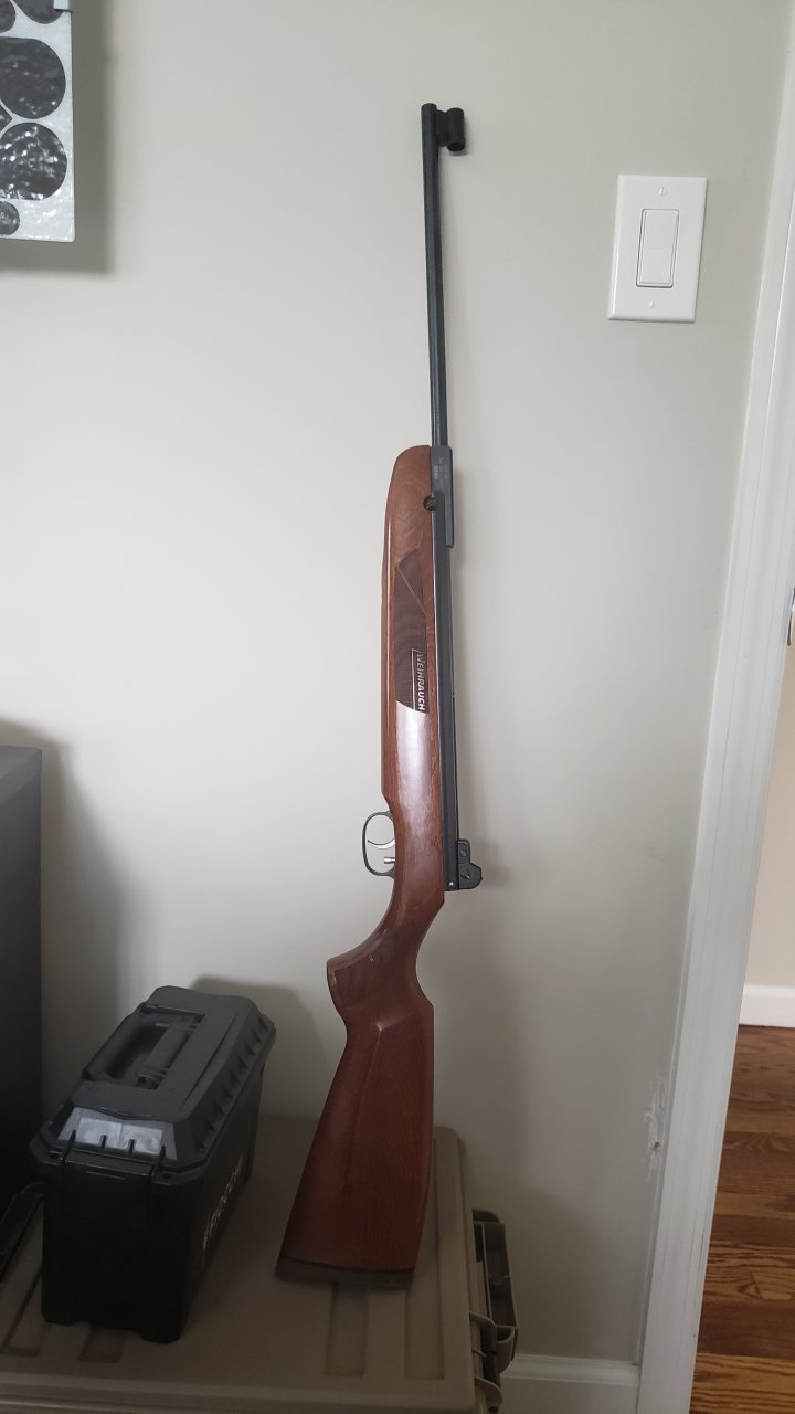

First picture you see the globe walked up the dovetail and climbs the sloped part, not good ..
What is the importance of the middle photo? I know it's the rear sight.
It can rock or be off from centered. Its pin fit but the hole in the sight is slightly bigger then the pin. If you loosen the screw that holdd it down you can wiggle the assembly left and right.. ya, the globe will move like a scope from recoil ... If they would of squared off the dovetail to act like a stop instead of tapering it so ot can creep up on to the round of the barrel..
One thig to can add is if you find one click is a tad too much one way or the other you can use that rear play to fine tune by bumping it left or right slightly to tweek the click adj. Cause you cant drift the front post to do it

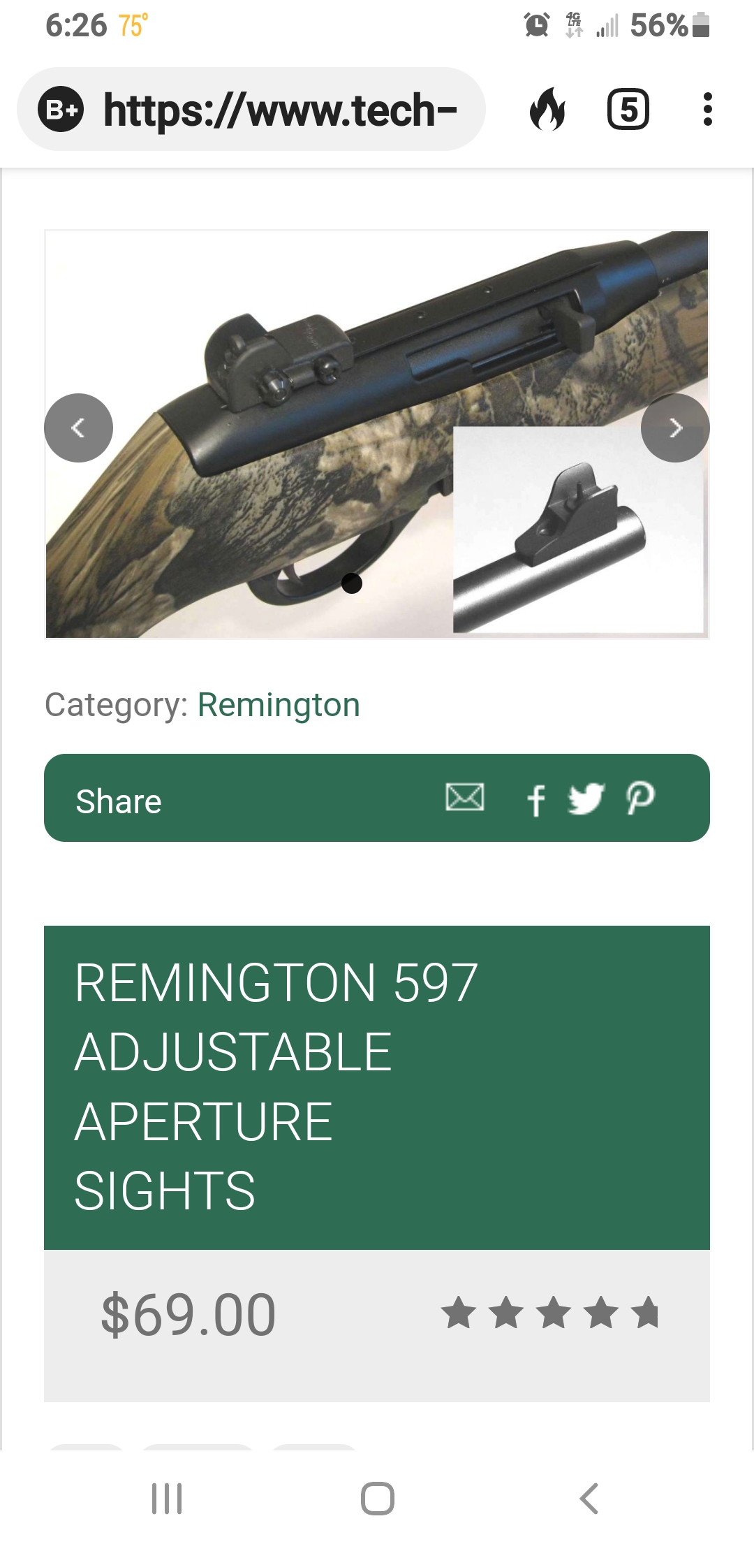

Looked around a bit more regarding tech sights for an airgun. All tech sights I've been able to find are specific for a single model powder burner. Can't find a "generic" tech sight that could be dovetail or rail mounted.
Tech sights work great on Weihrauchs as long as you don't have barrel droop. I did a big write up about them and barrel droop on the newer R9s and Hw95s. I've used the tech sights on my Hw30s, 50, 95 and R1.
Thanks! that's great news. Which one would I order for an R9? for which (PB) gun?
This one. Order it over the phone and tell them you're using it for a Weihrauch and you don't need the front sight. They'll take ten bucks off and ship you just the rear sight. I had great service from them. Make sure you order the 5 dollar adjustment tool. It makes adjustments much easier.
