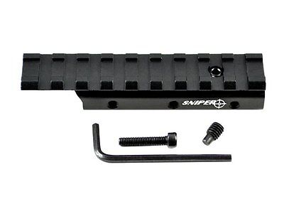

The BKLs you have are excellent mounts. But the ones you have are very narrow with a lot of clamping area. The double screw two piece would have been a better choice, and I use them with good results without a stop pin.
The heavy scope you have will also be more prone to making things shift around than a lighter one would.
A set of the cheap two piece UTG mounts with a stop pin would solve your problems easily. As would the same in a one piece version.
In my opinion adding a picatinny adapter and more rings on top of that will add a whole other set of potential issues and unnecessary complication and height. But, it will probably work and it's your rifle.
Having good pellets that fit the bore well and are the proper weight (8gr and up) also go a long way into making the gun shoot well. Don't know what you are using but I thought it best to mention it.
Thanks, I would need a taller version. The medium height rings won't clear the objective of my scope off the barrel.
My bad but this set should give you about 3 mm of objective lens clearance and solve the shifting problem. https://us.hawkeoptics.com/tactical-ring-mounts-1-2-piece-9-11mm-high.html
Note - the latch on the base must not be installed 180 degrees as it will bind.
Save your money. These work and look good also. They have the scope pin and won’t damage the scope.
Same thing on a 1-piece. I find the one piece mounts keep some longer scopes from being able to go forward enough. You may have that problem with this scope so probably the the 2 piece would be better.
Same thing on a 1-piece. I find the one piece mounts keep some longer scopes from being able to go forward enough. You may have that problem with this scope so probably the the 2 piece would be better.View attachment 289171
I have a UTG one piece mount on order with a stop pin and slope compensation with a set of rings. Will be looking into a smaller scope for sure, something like a BugBuster or similar. So far getting best results out of the JSB Match Diabolo 7.33gr. Also the basic Crosman Domed (7.0gr) shot better than others. Regards
