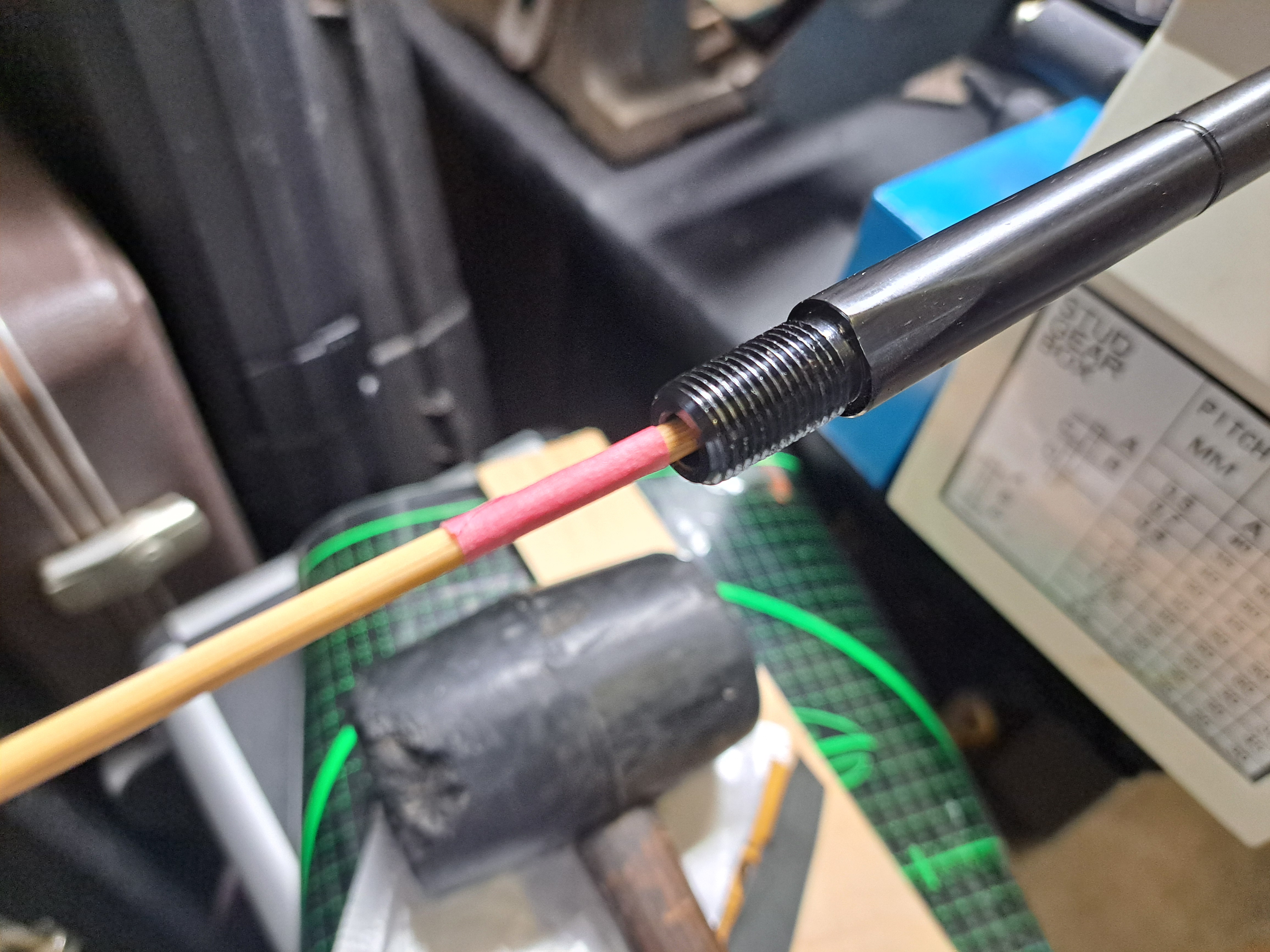

If anyone is interested in taking the shroud of, the front of the barrel shroud unscrew. Once that part is off the second shroud part needs to be pulled towards the muzzle end while slightly rotating it left and right. It has a ramp that tightens it on as the first shroud was screwed on. Pic of the barrel end.
