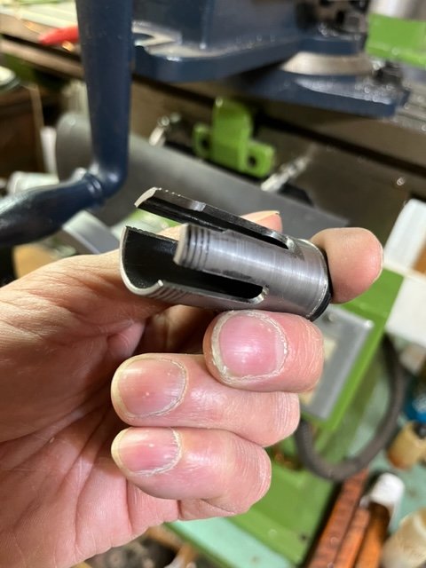

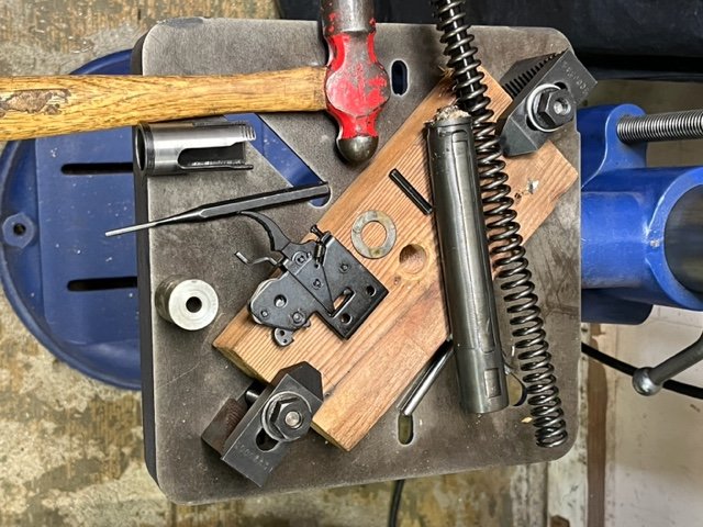

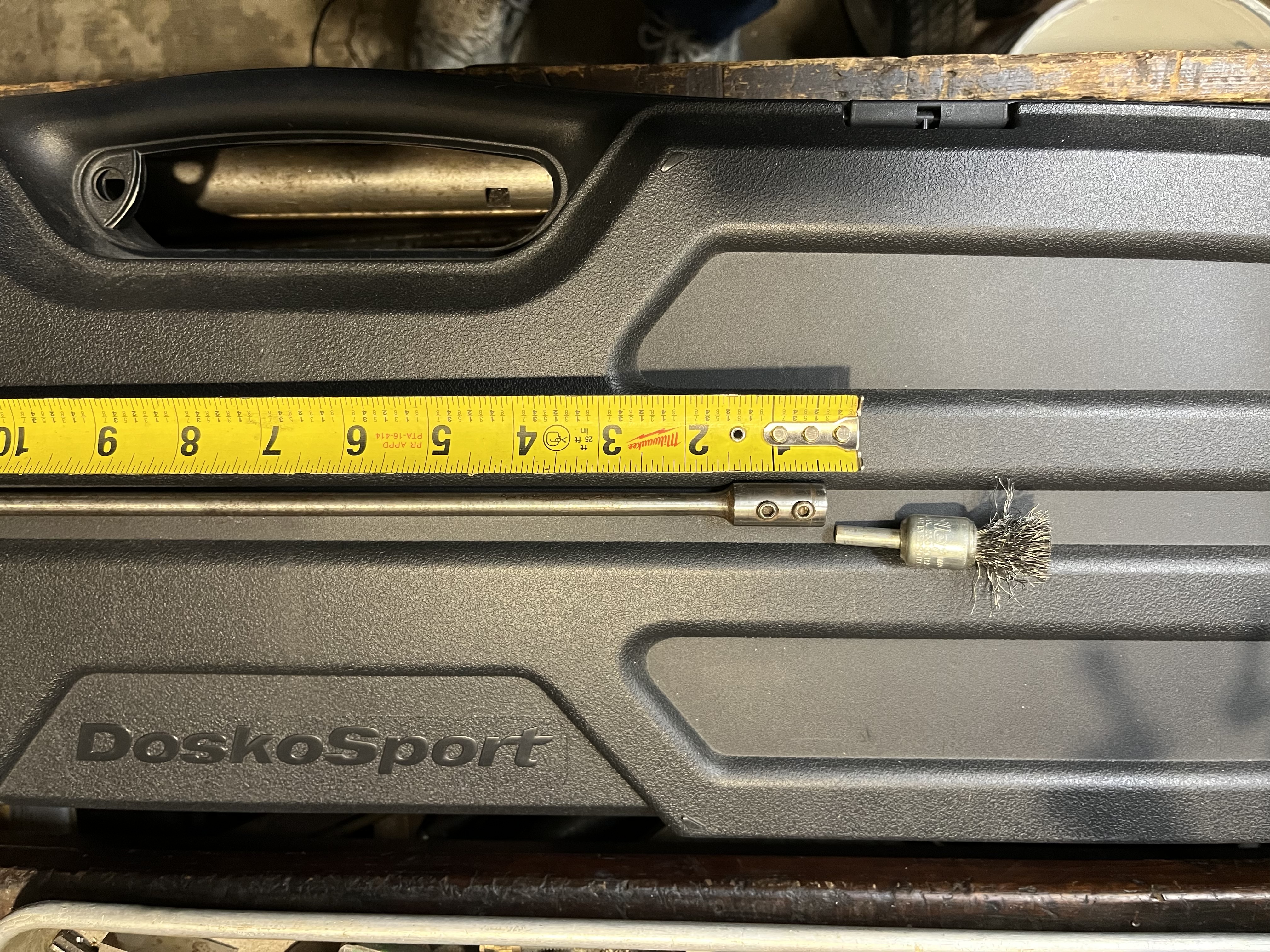

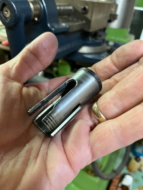

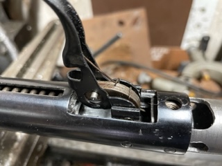

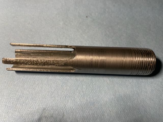

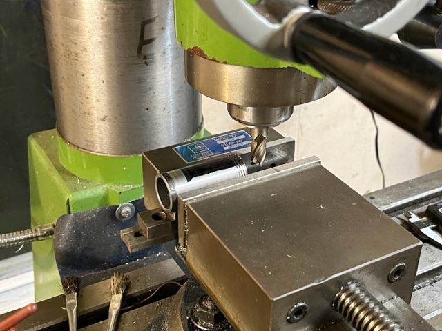

I made a tool to disassemble a Marksman 45 made by Norica out of an iron pipe nipple. I bought the nipple for $2.50 and turned it to a useable dimension and then milled slots so it can reach the spring to depress it allowing the trigger mechanism to be removed prior to getting the piston out for seal replacement. I used a Custom Air Seals seal. They claim to run in within 200 shots but I sized it some to speed up the process. Had to remove the old wax/bubblegum seal from the chamber. Like an orig 124 has. I poke out what I can and then use a little 1/4" shank cup brush on the end of a long drill bit extension and a power drill. Did it for one of my brothers. Kar

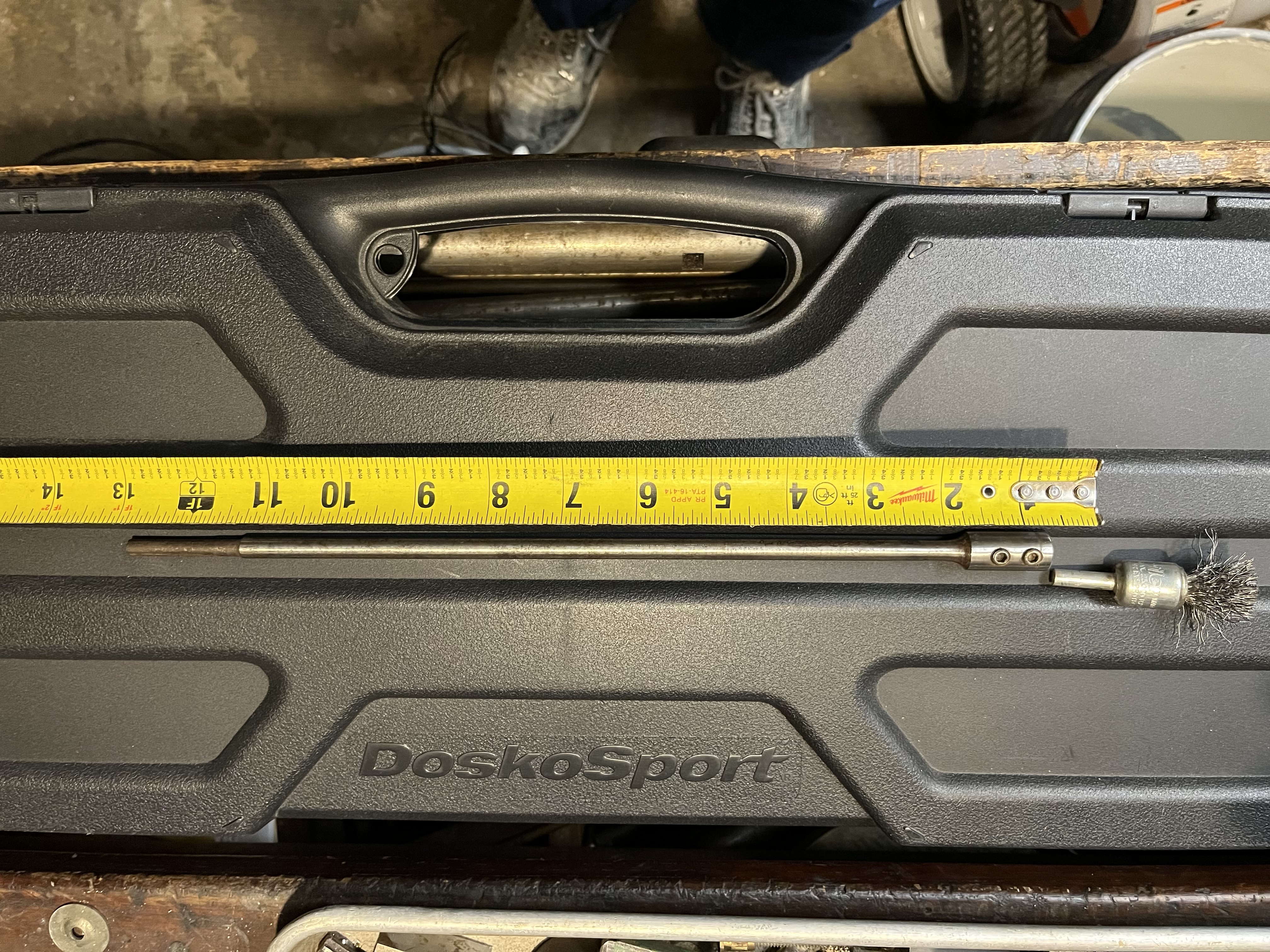

It’s actually not a cup wheel. The drill extension is 13 inches overall. Never mind the tape measure. I think Irwin makes them for paddle bits.

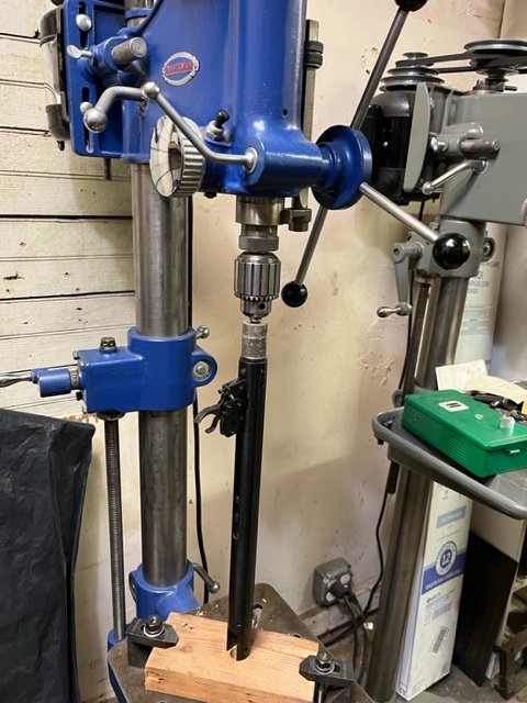

I’ve never had it damage the cylinder because the wire only has centrifugal pressure against the sides. Don’t turn the thing 50,000 rpm, ok? I spin forward and reverse alternately

Nice photos and some good ingenuity on making the spring pusher from a plumbing fitting.

Yesterday, I decided to make another attempt at crafting a "spring compressing tool" to disassemble my Beeman GS700 springer (aka Marksman 0035) using the same method and pipe nipple that KWK used in his above post. I purchased a 6" galvanized 3/4" nipple at my local HD for $4 and change, plus tax. First I chucked it up in a lathe and remove the pipe thread on one side using a cut off tool. Then I removed about .075" on the exterior surface for the full length. I did not use a boring bar to remove any material from the internal surface at this time.
Using a fine tipped Magic Marker, i drew a rectangular shape 5/8" wide and 2 1/2" in length. I then clamped the piece in my small hand operated milling machine and began slowly removing metal from the marked area. I repeated the same on two opposite sides using a smaller carbide milling bit where the pins are located. I then cleaned up the rough edges with a small file.
After inserting the tool in the receiver I realized that I had to remove more metal in tight areas and rather that put the part back in the mill, I decided to use my Dremel tool with a round stone bit to complete the finish work. All toll it took about two hours to make the tool and less than $5.00 in material. it certainly is not a work of art, but it functional. Thanks again to KWK for the concept and providing the photos.

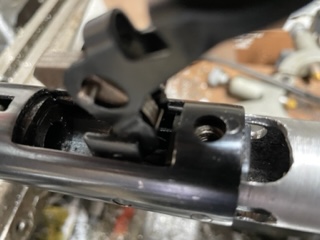

I am a beginner working on air guns. But have many years of experience as a shade tree hobby machinist, with good mechanical skills and a die hard do it yourselfer. Attaching a few photos of the tool in use.

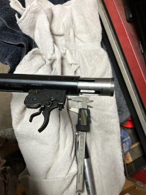

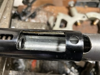

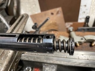

First I wrapped 2" painters masking tape around the front of the Beeman GS700 receiver/housing to protect the bluing from getting marred. Then inserted the receiver/housing into a three jaw chuck, tightened the jaws and engaged the back gears so the chuck would not turn during the process. Inserted the home made spring compression tool into the rear of the receiver. I moved the lathe bed tail piece close to the tool and locked it in place. Using the hand wheel on the tail piece made the process of pushing the tool forward, thereby compressing and pushing the spring forward. Then the two pins securing the trigger were removed allowing the trigger housing to be released and extracted from its housing in photo 3. Then it was simply cranking the tail piece in reverse and the tool was extracted from the housing. Photo 4. This allows al the internal parts to be removed. I ordered the replacement seal, moly lube and the barrel chamber o-ring from a firm in Australia, so it will be a few weeks wait to get all the parts.
