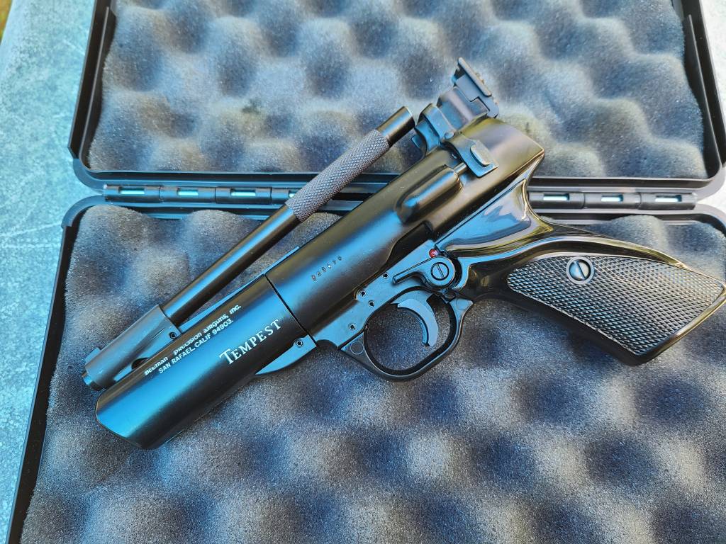

Well the big brown truck dropped it off yesterday.
At the start of this thread I said that I have always wanted one and for the week that I’ve been waiting for it my expectations ran a gamut of the positive and negative. I have never purchased a used airgun, sight unseen. The closest I have come to it was the purchase of my Umarex S&W 586, which was an open box purchase. The seller described the Tempest to be a San Rafael version, fully operational and in very good condition (VG) 90% of original condition.
Most of the comments and reviews I’ve read have described it as a good shooter that packs well, shoots well and although definitely not a target pistol it delivers a decent punch for it’s size with an effective range of 20 yards.
This is a gun that feels so good in your hand that you just want to shoot it. As everyone says it is a bear to cock but it’s not too bad once you fire it a few times, you develop your own technique. It is fun to shoot. I put a couple dozen pellets through a soup can at 10 yards. I don’t concern myself much with power, I just want to consistently hit what I’m aiming at. This pistol does that quite nicely, although it did put a hurtin on that soup can.
The gun was delivered in a aftermarket pistol case as well as an owners manual. The previous owner also fitted the trigger with a wide comfortable shoe which was a nice added bonus for me. My fears of that 90% of original condition were laid to rest immediately. In my opinion this pistol leans more towards excellent than it does towards very good. The only visible flaw I can see is a very faint stress crack on the underside of the plastic forearm. The only wear I see is in part of the “Tempest “ branding on the right side of the forearm. Otherwise the pistol is very clean. In fact I would say to the casual observer it appears to be in mint condition. My collection is not huge or fancy but I do have some nice classics in very good condition. Whoever owned this gun took excellent care of it. It’s safe to say that I am very happy with the purchase.
Thats a nice real Webley you got there buddy....It will have the better quality build i described, with the full length guide rod and so will not twang...
Webley supplied this gun to Beeman under license and is a sought after model....Its really worth investing in some nice wood grip options available for it.
If you need tuning advice and trigger advice, you know where to find me ..but it looks like its made a decent start with the Beeman trigger shoe already installed .....Hobby pellets if you want the accuracy..
Anytime....Your best bet, if you are not opening it, is to clean the barrel. Many pre owners use all types of lubes in these pistols which the they do not require due to the Teflon seal.....these lubes eventually working their way out into the barrel, wrecking accuracy...
Later if you want to tune it, do not add anything like slip washers at the distal end of the gun as you need the full guide rod length left alone....its seating face for the mainspring is already well finished, however, the bottom of the piston is not. You can drop a 14mm diameter steel washer down inside the piston to give you a nice smooth face for the mainspring and it will smooth out the cycle, removing torque.
Then clean your mainspring and inside of piston.....adding a smear of Superlube general purpose grease on the guide rod. Do not go near it with Moly. Moly is good stuff in air rifles but robs power in the pistol...its more of a damper...Superlube is a better choice...its also nice and clean to use on the cocking slide area, especially if you like pocketing the gun.....keep the moly away...
Add a touch of Superlube to the piston seal to aid fitment ...check the breech seal and you should be @ 470/480 fps with the Hobby.
