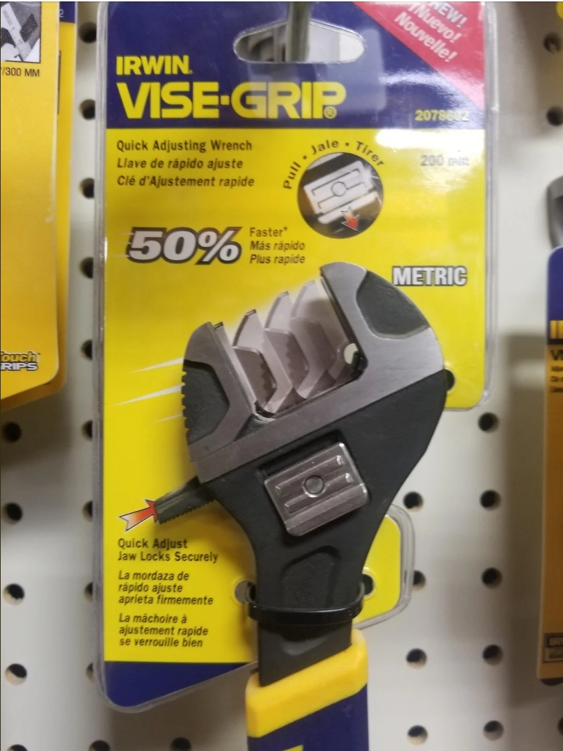

I finally got interested in the pistol when I looked at it today as I sit waiting impatiently for my MK2 impact to arrive. So I tried to fill it with air and that was a no go. The check valve is bad and all of the air just gushes back out when I bleed the line it won’t hold any air at all. Onto the operating table it goes and outcome the Allen wrenches, screw drivers and a metric Crescent wrench.
