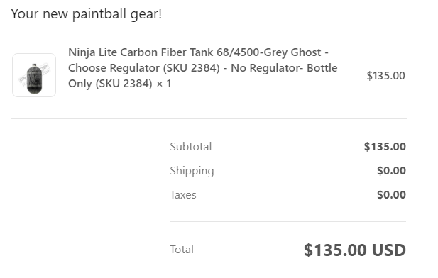

Got a ninja 68 empty No paintball regs so it ran only 135 to the door from ProEdgePB very reasonable price dont know what I was doing looking at aliexpress for a small bottle, Price wise the the smaller ones cost the same or more on aliexpress, Makes no sense for me to buy the china ones when I can get DOT certified bottle for less, Already bought a m18 valve but whatever Il just buy a 2 liter bottle to pair that for that in the near future as sometimes the 3 L is a bit big for a range day, Guess Il just need to purchase another valve in 5/8-18 unf https://www.aliexpress.us/item/3256....0.0.11ad38da72JZxo&mp=1&gatewayAdapt=glo2usa.
