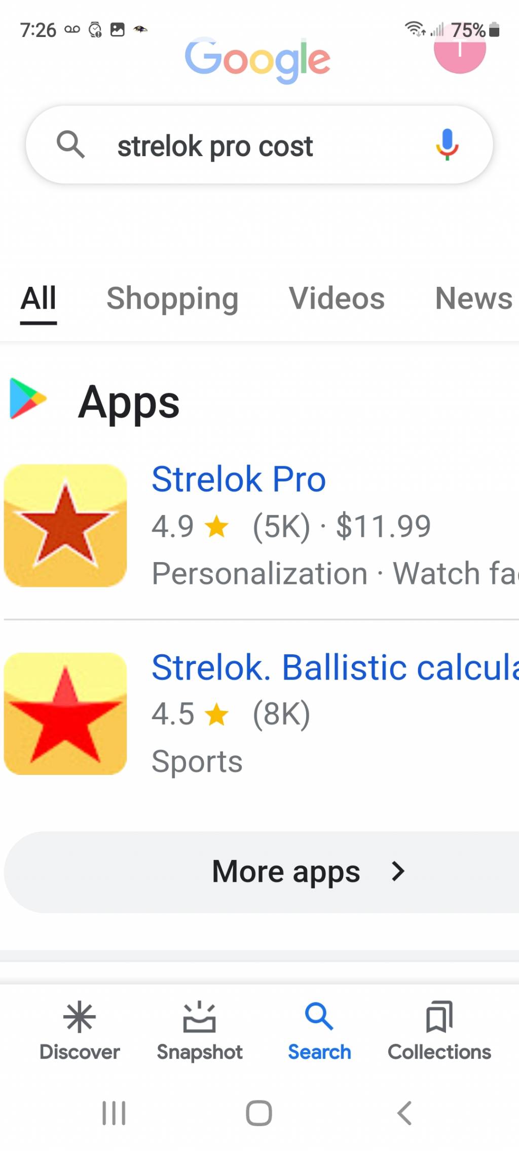

Best $100 you could spend.xSpeed, distance and ballistics is the name of the game with air guns. To get a good foundation I would suggest these 3 items or similar to get you started. That crow @ 85 yds with a 5 mph crosswind now become a big possibility. Happy shooting.
Reactions: d3vnull
