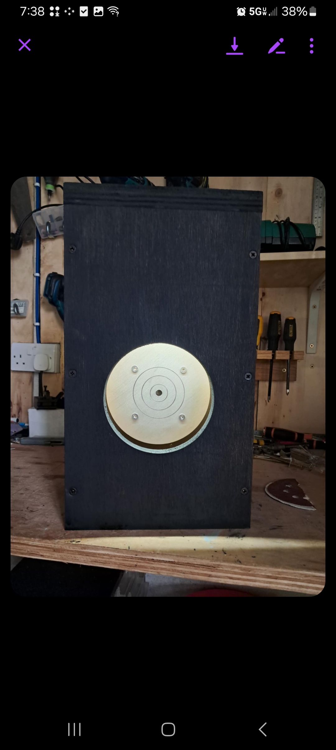

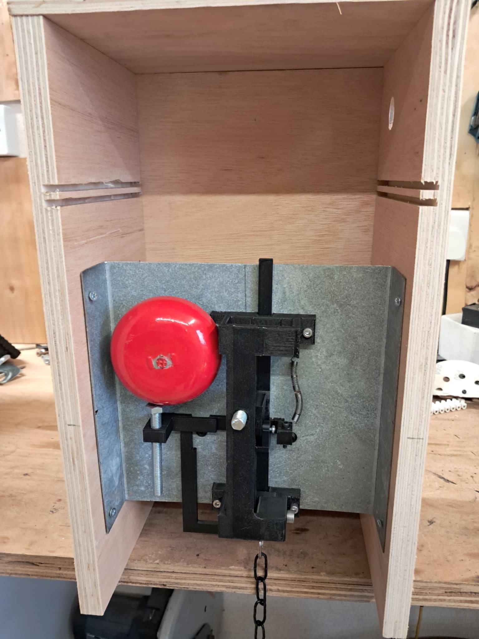

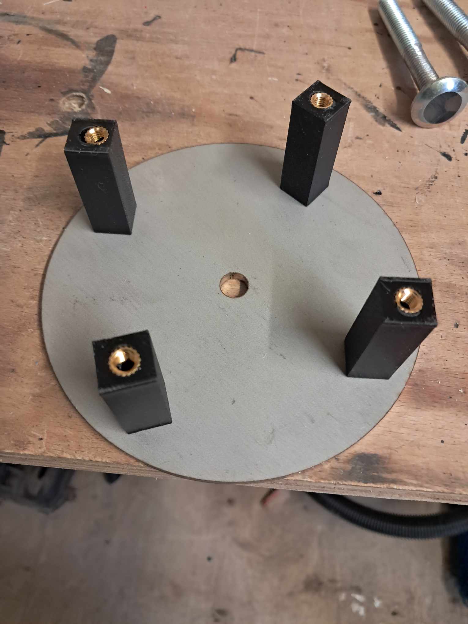

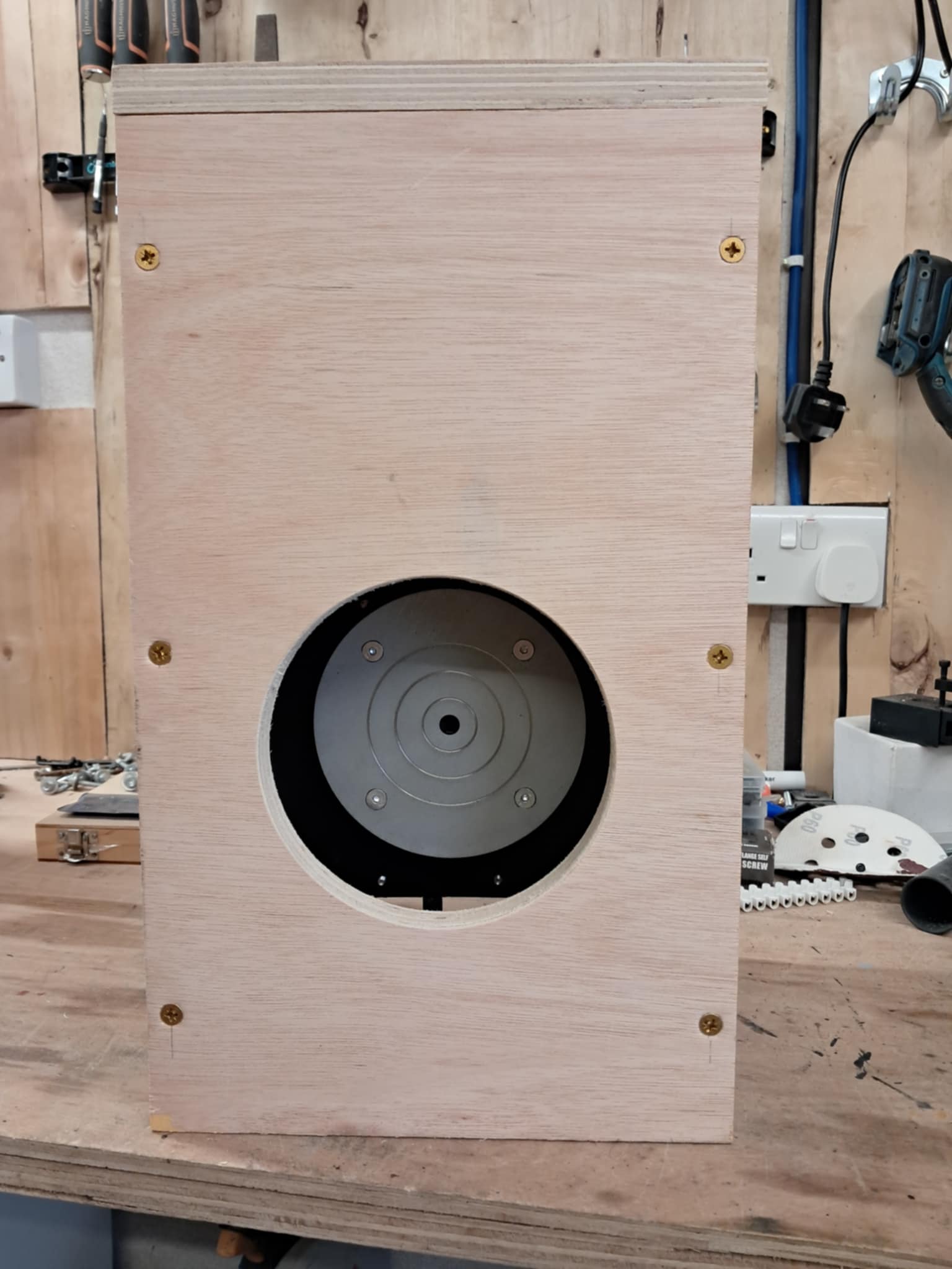

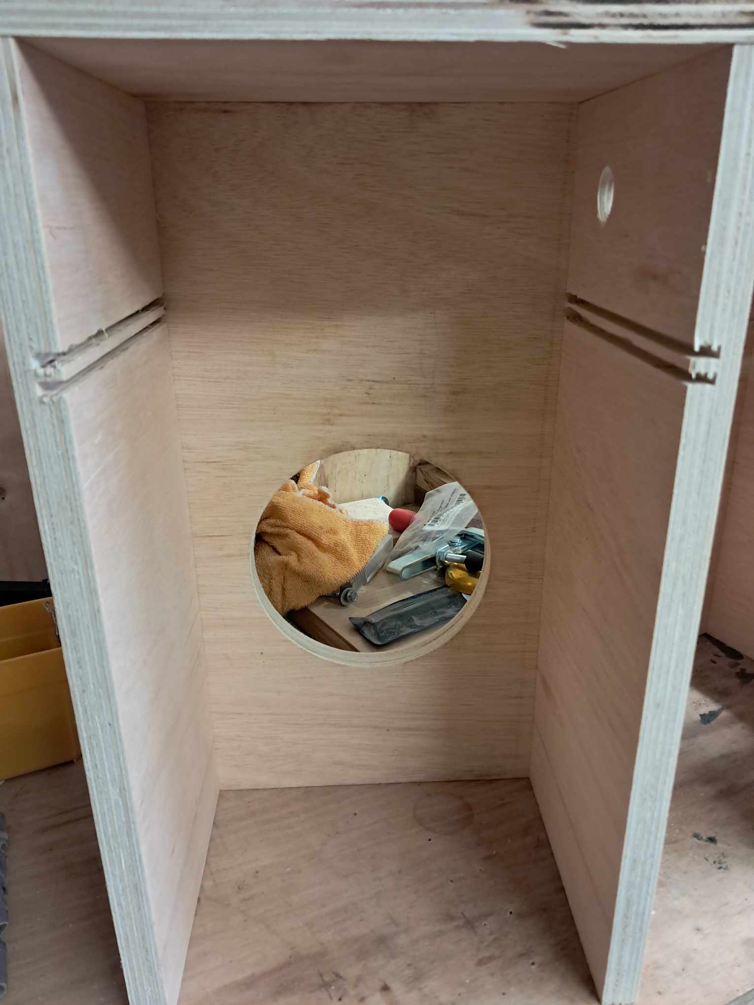

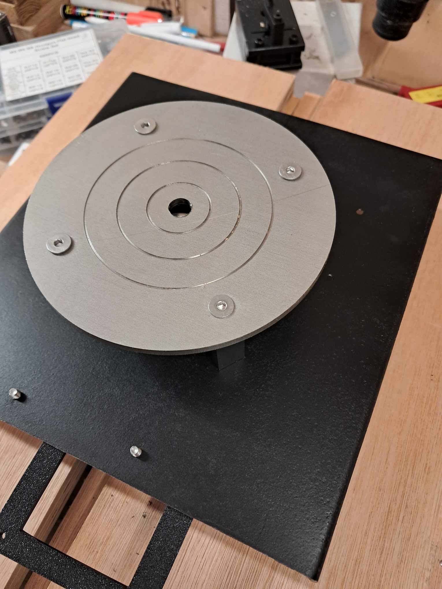

putting this together soon, made as a kit.
And made to order.
I have been looking for bells you can actually hit, but they do get pretty expensive if they are to stand a chance against a FAC .177 rifle.
To compensate i have been thinking, what if you block direct hits, so you would just grace the bell.
Plenty cheap to build one up

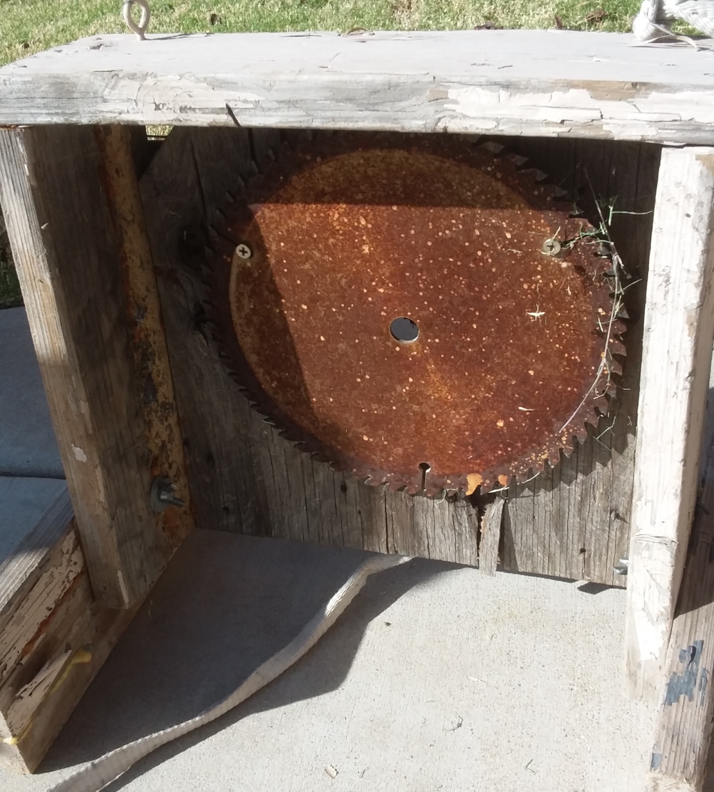

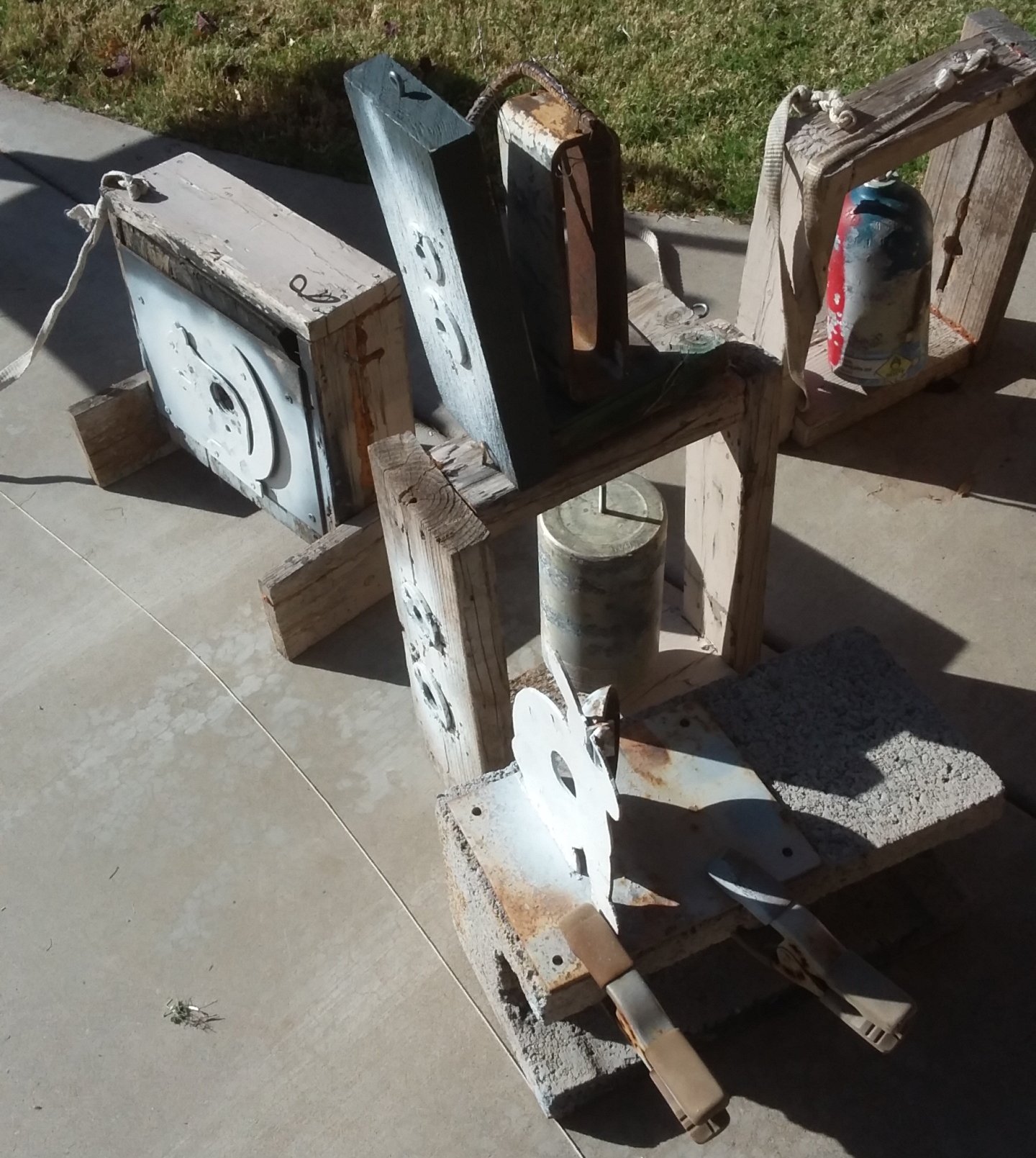

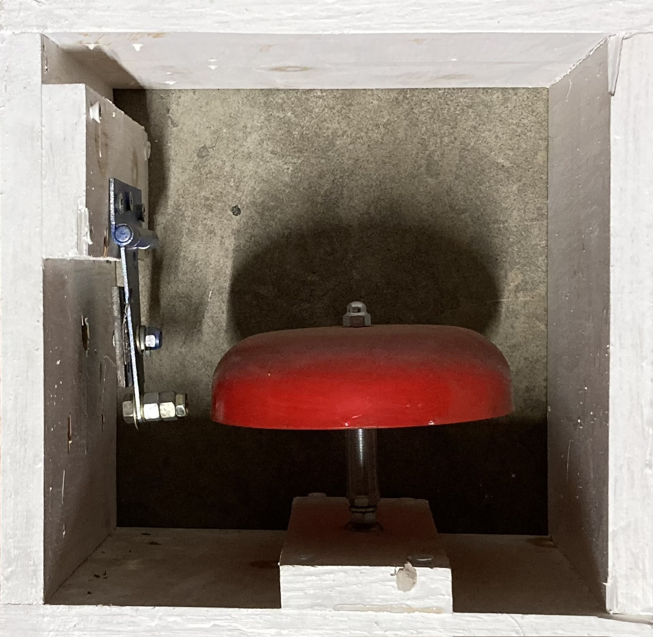

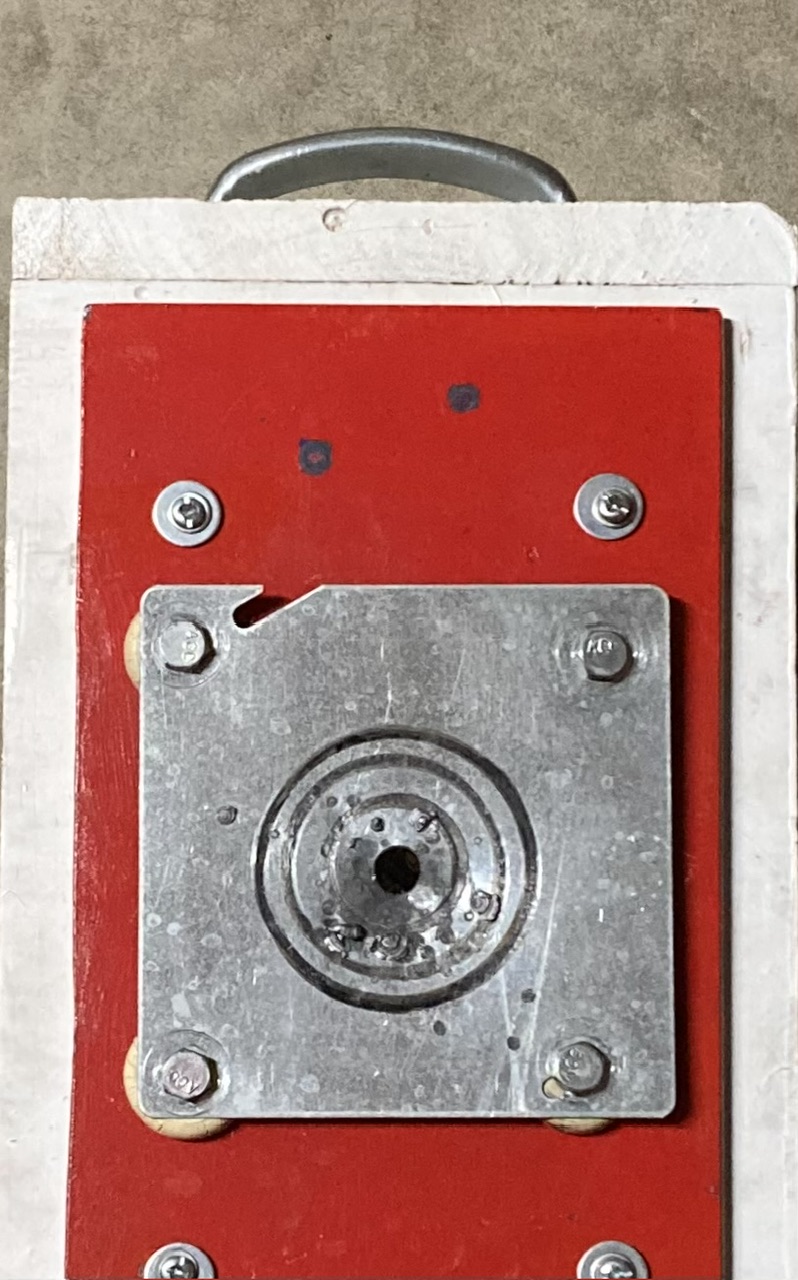

These were bells I created for my entertainment and FT matches. There was a post back a while that documented many different types of bells and unique targets...These are well used so not very elegant, but fun... The top middle is the point of this post.
Wayne Burns brought some targets to LD's Temecula Challenge one year and among those was a similar one using 2" x 8" x 3/16" rectangular tubing for construction. It rings SOOO sweetly... , kind of nice church bell like and loud enough, but not obnoxious. It would be a candidate for that and holds up to ANYTHING airgun related...
The squirrel uses a 10" saw blade and is pretty loud but a harsher sound. This was another Wayne Burns target with an old saw blade from his business. It's held up to thousands of rounds, many many of which were over 50 ft lb. Good blade... hasn't even dented. I tried a couple of my own and 50 ft lb would go right through them.
