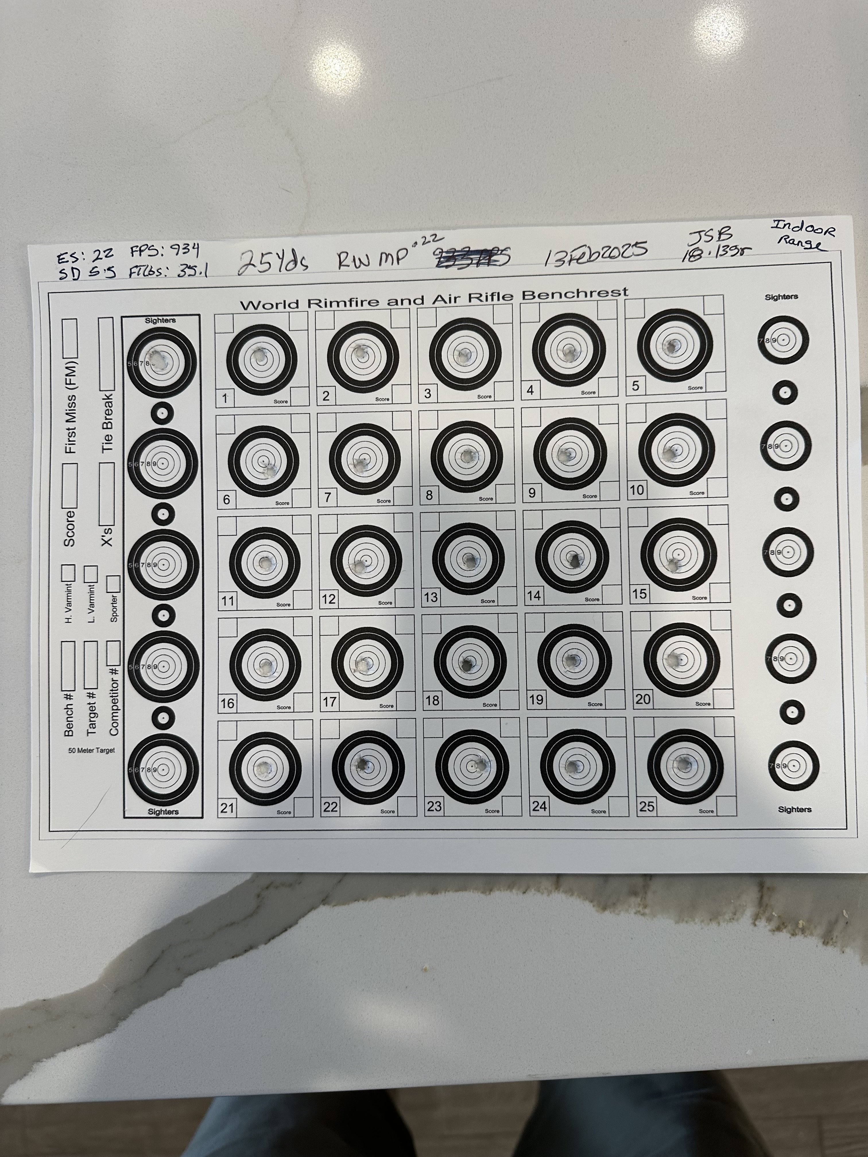

I have attached a couple of paper targets (1”) I shot at an indoor range at both 25/50 yards with my .22 Redwolf standard. I am wondering if it would be worth it to buy a tuner to hopefully tighten up the groups or maybe I just continue to work on my shooting techniques which will hopefully improve my accuracy. I understand wind will be an additional element I will need to deal with, but just would like your thoughts in general regarding the tuning aspect. Thank you.

You have some vertical deviation in your 50Y card and I suspect that could be technique? It’s easy to relax the bag squeeze too quickly after breaking the shot and that can cause vertical. Your bag position can also cause that to so some experimentation may be in order.

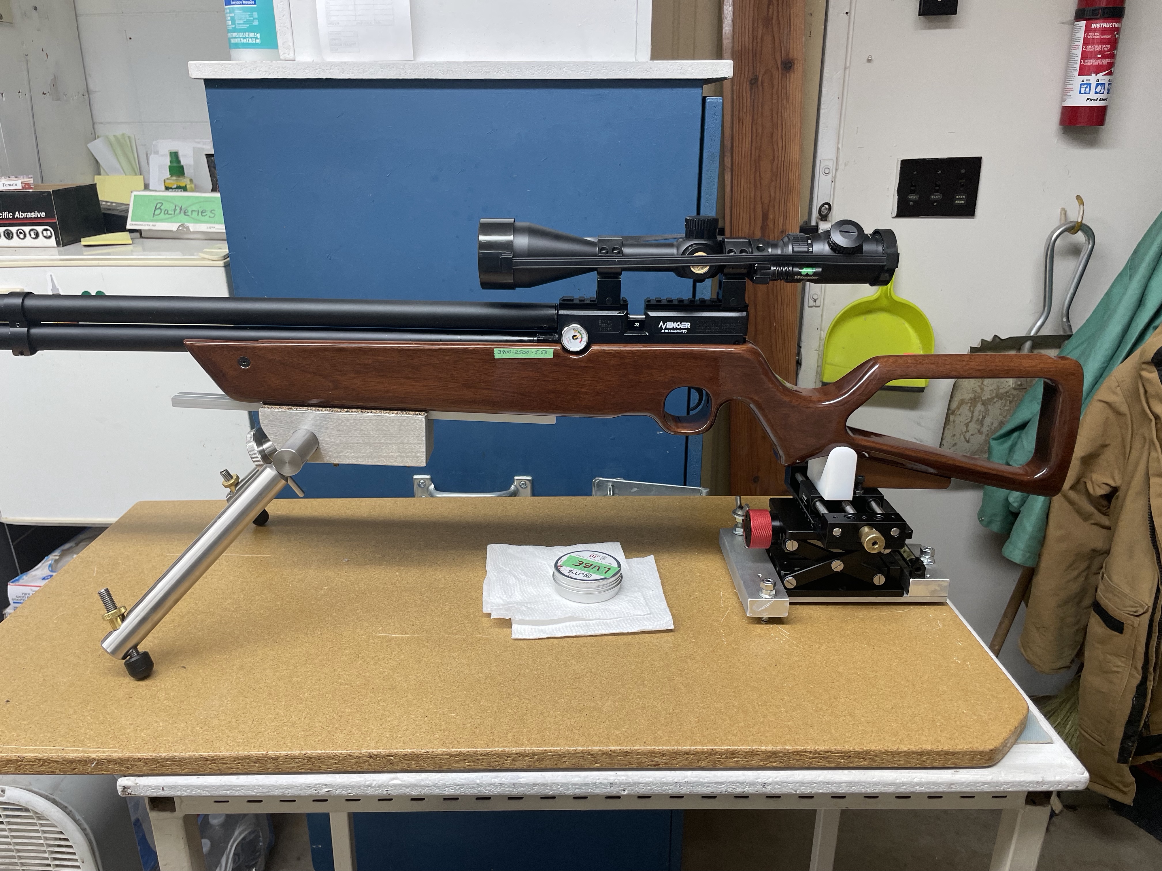

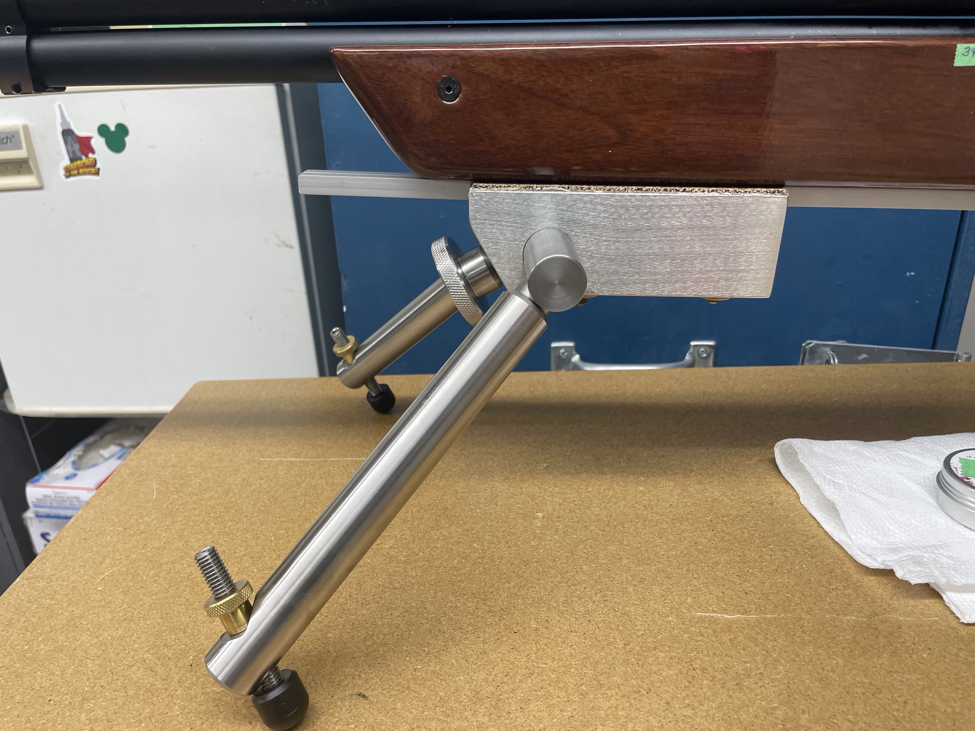

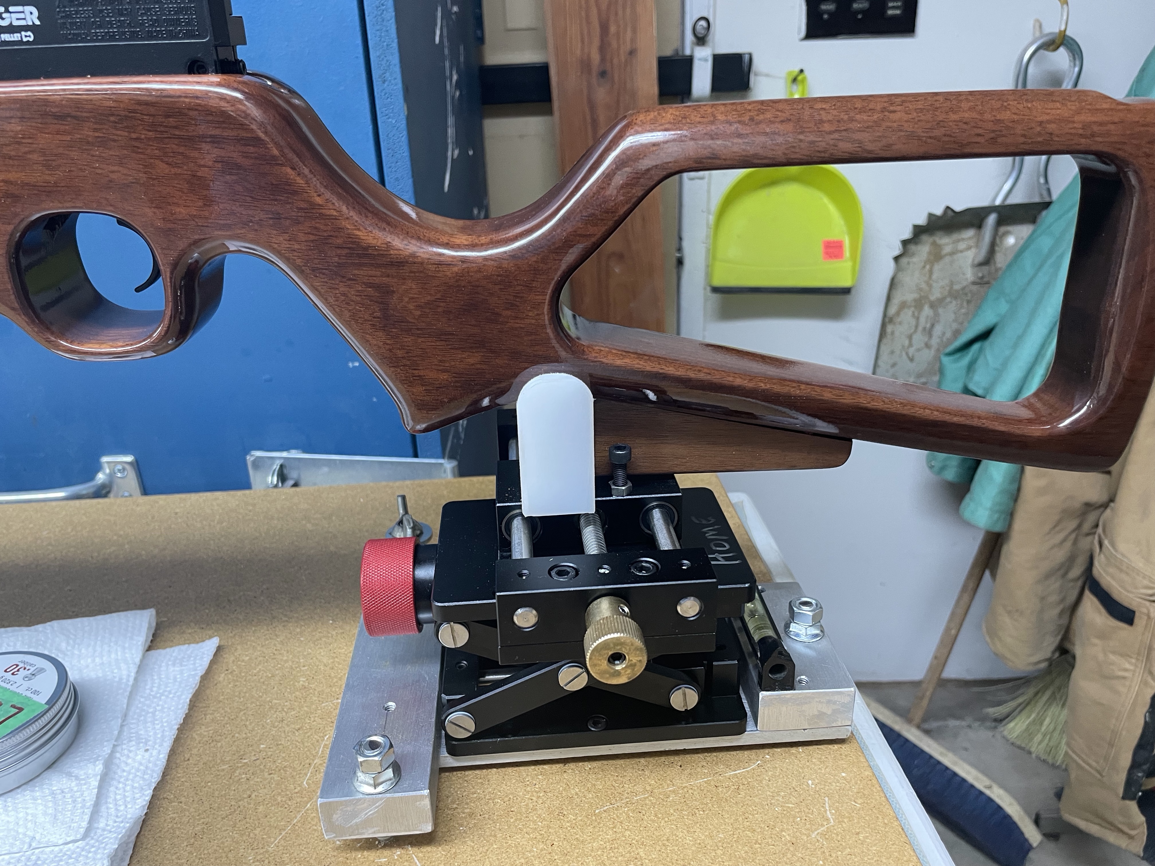

Many of us shooting ARA and N50 have gone away from rear bags and gone to rear mechanical rests. Windage and elevation can be easily adjusted and it removes the human “squeeze” element from the equation.
Here is one that I use.
Reactions: Loufish
AOA used to include a pamphlet with their rifles stating something to the effect that I am paraphrasing “any projectile shot above 900 FPS should be lubricated”. Therefore that is another factor to consider in your chase for accuracy.
Good to know…What do you use to lube a pellet…silicone? Is the rear mechanical rest a separate unit from the front rest or is it a one piece? I did see some lab jacks and was also looking at the Cheney rear bag with a pump. What do you use? It would be nice not to have the squeeze factor. Thank you!
View attachment 538934View attachment 538933
Oh wow. That is nice. I take it that it is a one-off rear rest. It looks like I have some research to do for my set-up. I hope I can find something similar to help. Thanks for the pic!

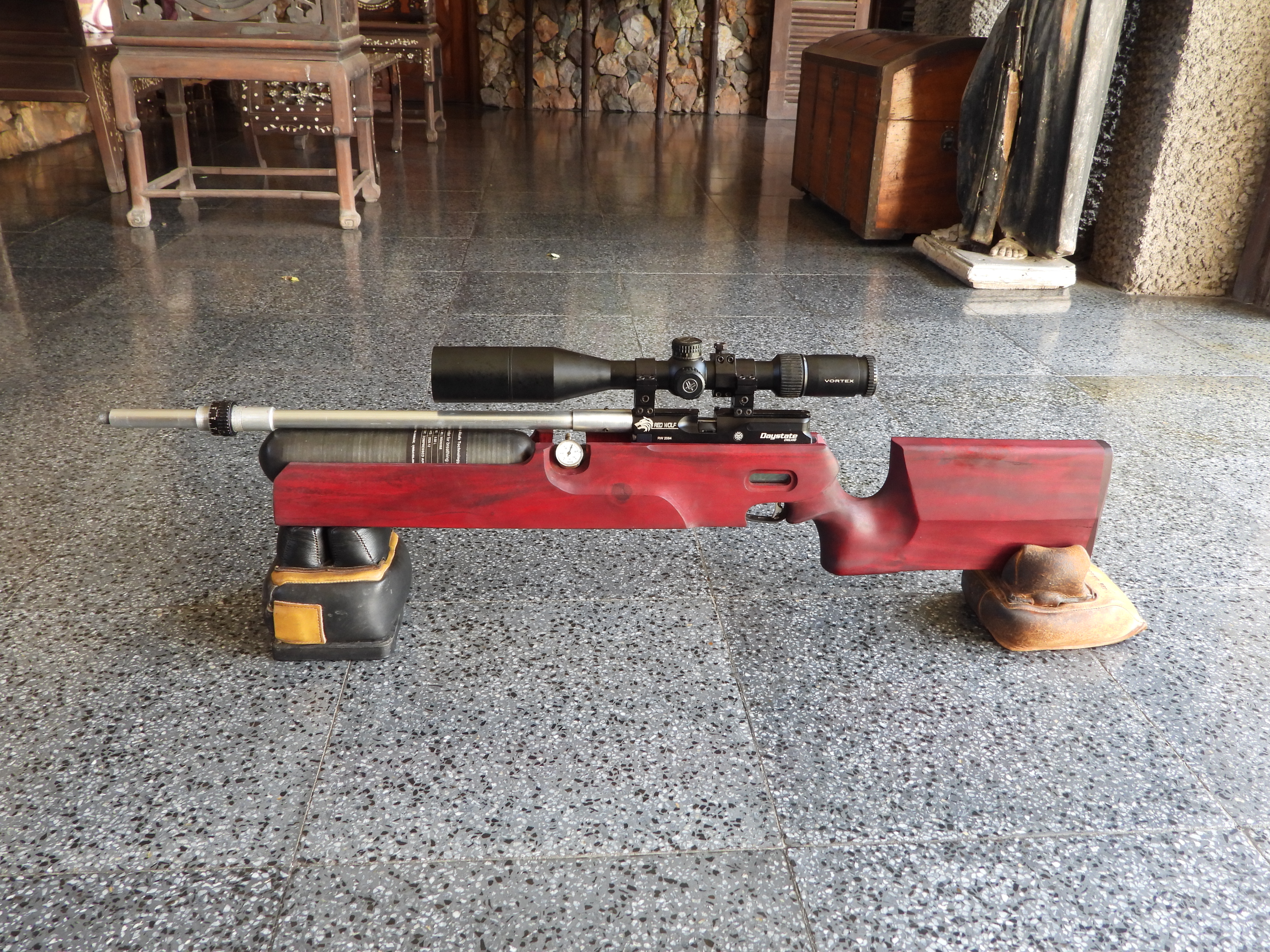

RW’s are finicky when shooting benchrest using a bipod as front rest. I had a BR stock made for mine and the accuracy has increased significantly. Harmonics is way way better than the stock laminate and less prone to cant. The BR stock is perfect for mechanical front/rear rests as well as sandbags.
My RW was originally a .22 HP (2019) and I converted it to .177 and has a Heliboard and a Huma reg for WRABF BR25 HV meter purposes.
Reactions: Perry Perry

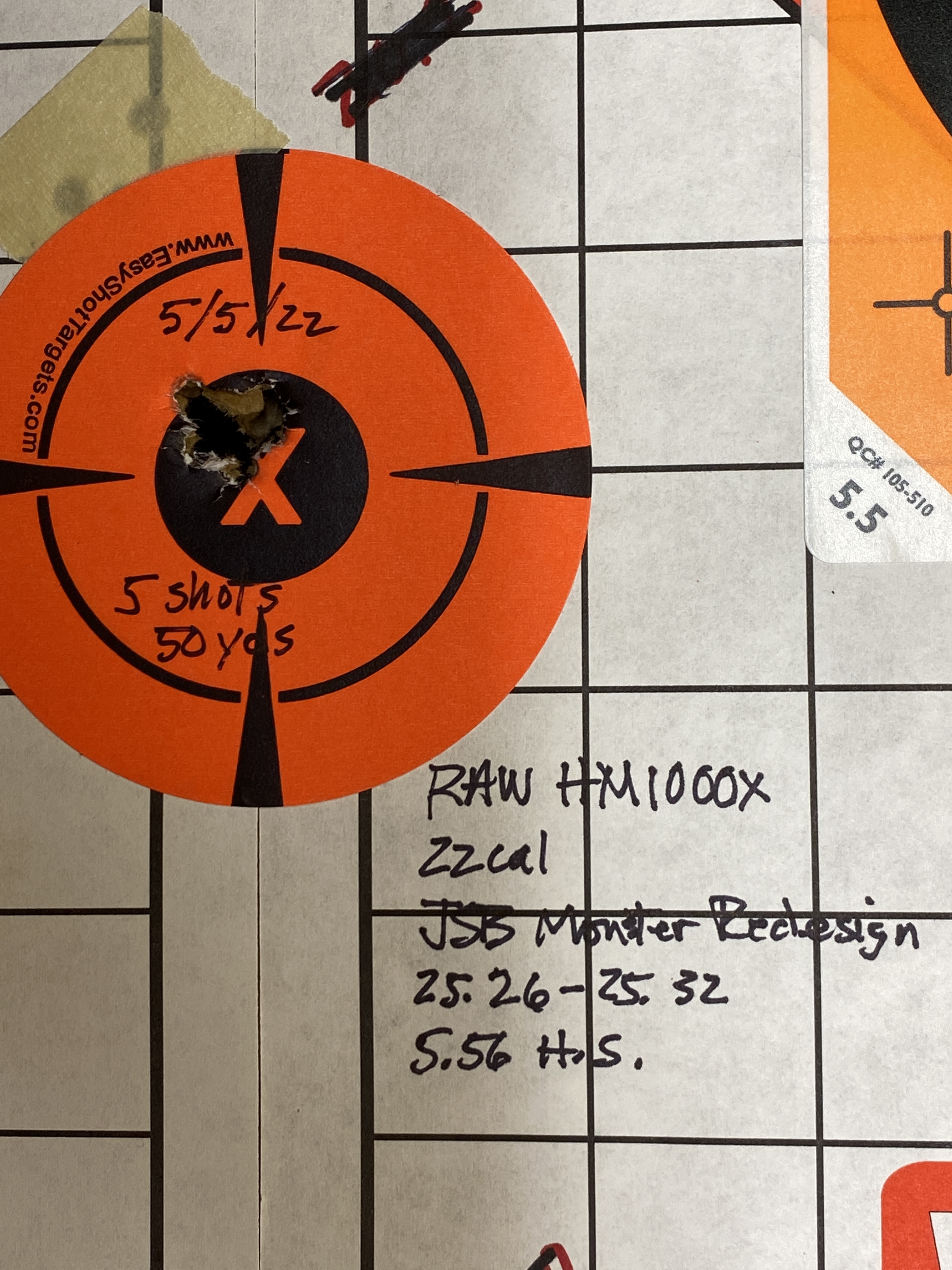

I just saw this thread and can offer a small bit of advice. For best luck with high fps speeds at 50 yards, I recommend sorting your heavy pellets by weight (tenth grain batches) then lubing. I use Old English furniture spray wax. I spray batches in paper towel, roll them around, then let dry over night. The small amount of wax left on pellet is all the lube needed. I shoot 25 grainers at 950fps at 50 yards with success (under minute angle).
WOW, Nicely done Ross! That RAW is a shooter.

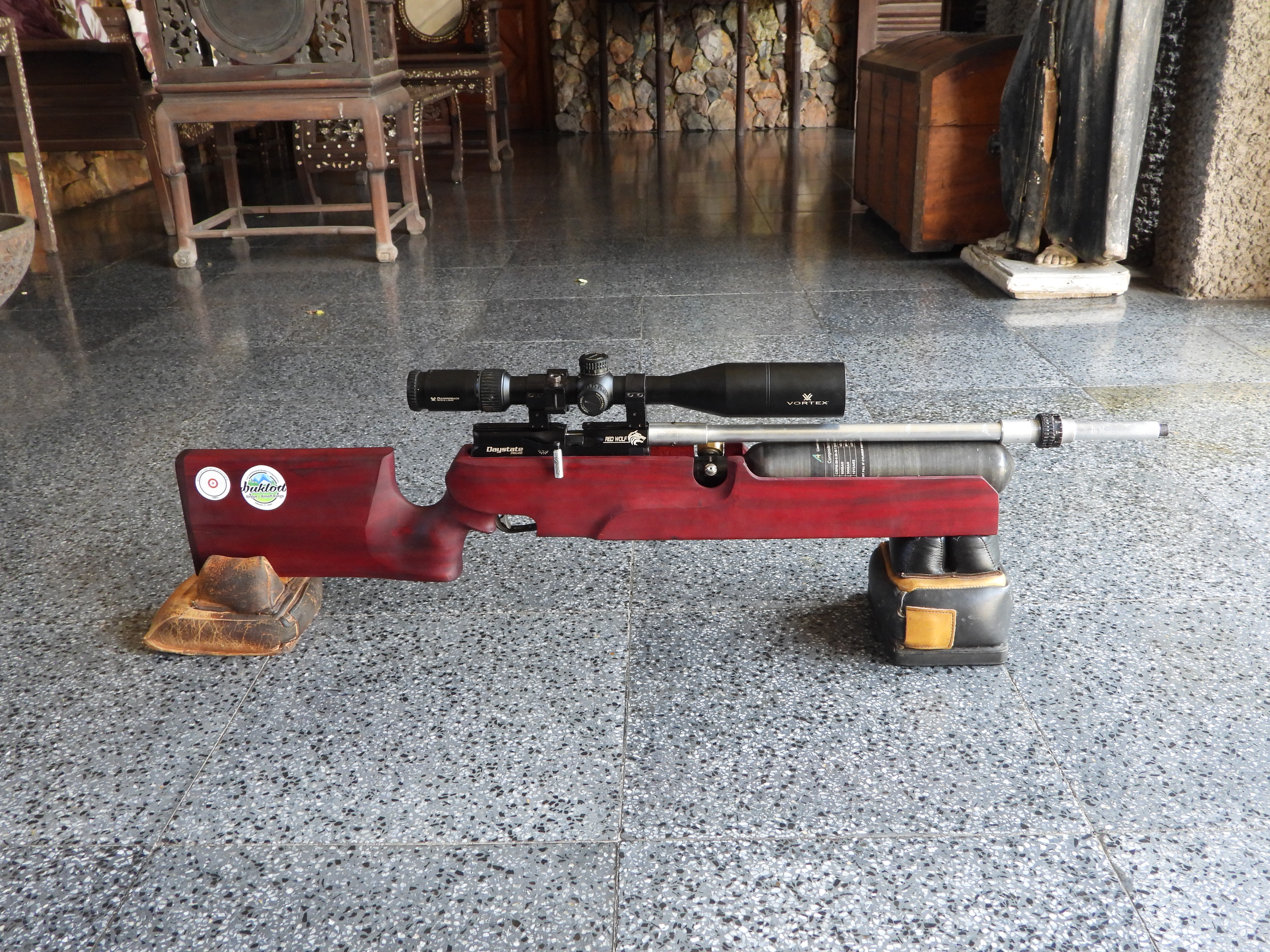

My RW was originally a .22 HP (2019) and I converted it to .177 and has a Heliboard and a Huma reg for WRABF BR25 HV meter purposes. View attachment 538983View attachment 538982
Nice stock. I was thinking about buying the GP Stock from Daystate and converting it over so I would have a flatter surface for bench.
