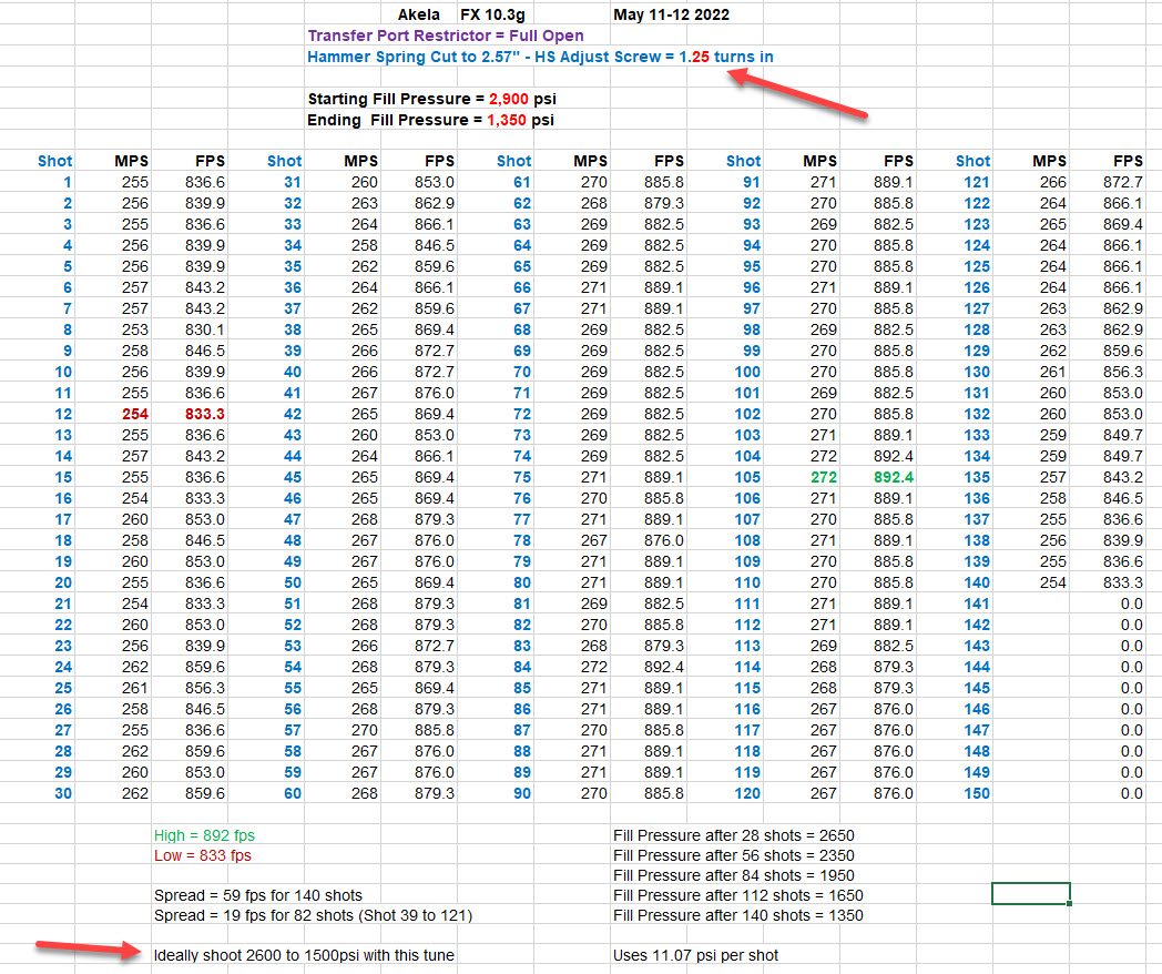

hello everyone, this is my first post on here and what would be better to talk about than my first PCP airgun! I just ordered an Akela in .177 from airgun depot (220 bucks off with a free Benjamin hand pump) I have been trying to do some research online while im waiting for it to arrive but I am having some difficulty finding good information. does anyone have any chronograph numbers for the .177? I have seen some people saying they're sending 10.34s at around 1000 fps, is that the norm? also, other than shortening the hammer spring is there any mods anyone would recommend? once I get the gun in the mail and spend some time getting to know the gun I will be posting a ton of content on my YouTube channel as well to help spread any information shared here. thanks guys!

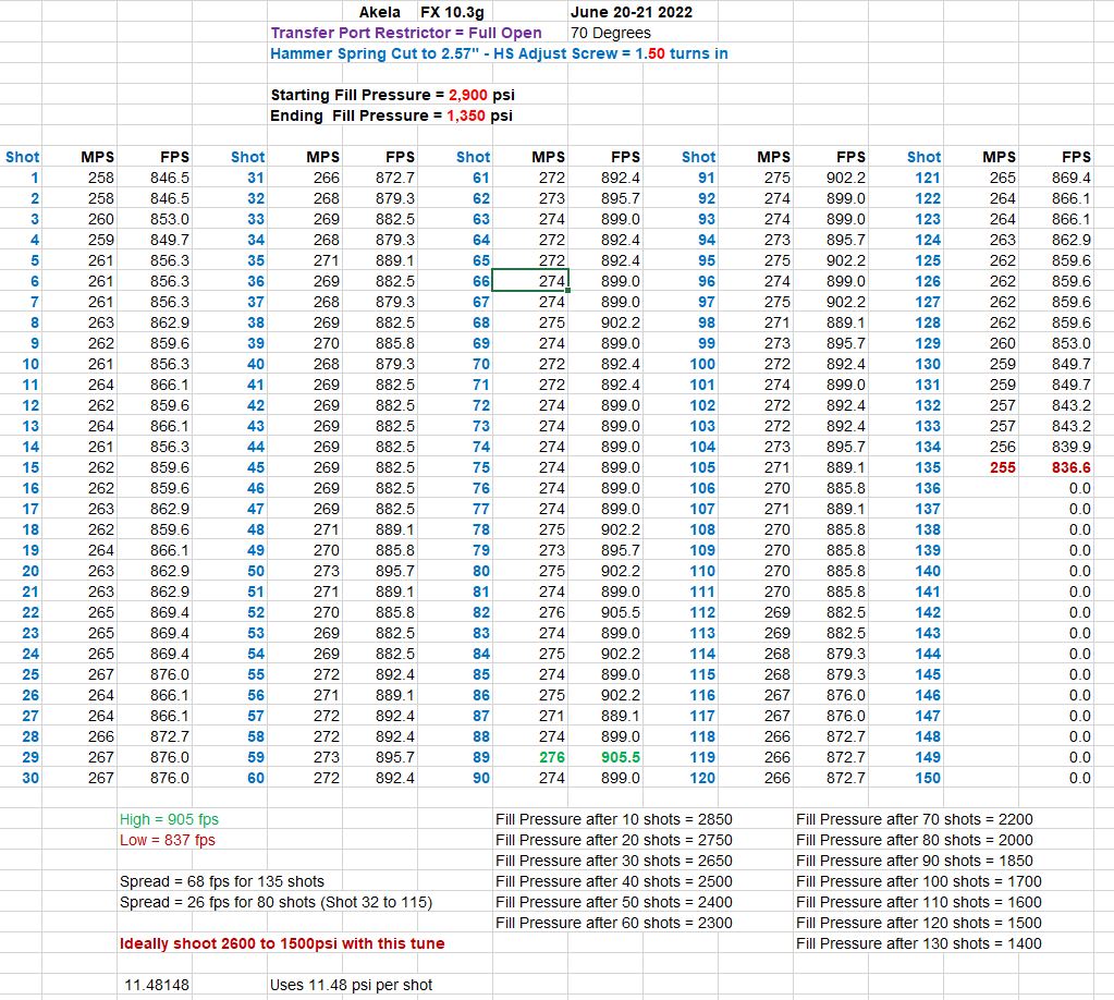

Hi Tyler,
I’ve posted extensively regarding my results with shortening the stock hammer spring length (3.5” in the .177 Akela) on both the GTA (Gateway to Airguns) and AGN forums.
I would suggest shortening the hammer spring to 2.57” with your .177 Akela. I’d like to know if Crosman is still selling these rifles with the 3.5” spring in them - ridiculous and makes them perform very sub optimally.
They are simple guns to work on and are very accurate and consistent once you address the hammer spring.
There is a good video on YouTube on how to adjust and polish up the triggers on the Craftsman Series (Kratos/Cayden/Akela) rifles:
Also, it’s easy to polish up the hammer itself once you are into the trigger sears.
PM me if you have questions.
-Ed

hey, thank you for all that info, come to think of it, I think I have read most of your posts talking about this. this is great information and I really appreciate you sharing. after seeing these shot charts im thinking the hammer spring mod is going to be first thing on my to do list. my plan as of now is to keep the gun stock long enough to do a YouTube video (haven't seen many of the US spec in .177) and then doing this mod and comparing the 2. in your experience did you see any improvements with the stock hammer spring length by just adjusting the transfer port by chance?

This still has a good bell curve to it as your looking at the first 30 shots? Reason why I ditched the spring shortening idea before the gun was released to the public. I’ll agree it’s better then having all that valve dwell and it’s a quick (kinda fix).
That led me to develop a tune kit that balances the valve out from 3000 to 1800psi for both .177 and .22 Akela,Kratos and Cayden guns.
