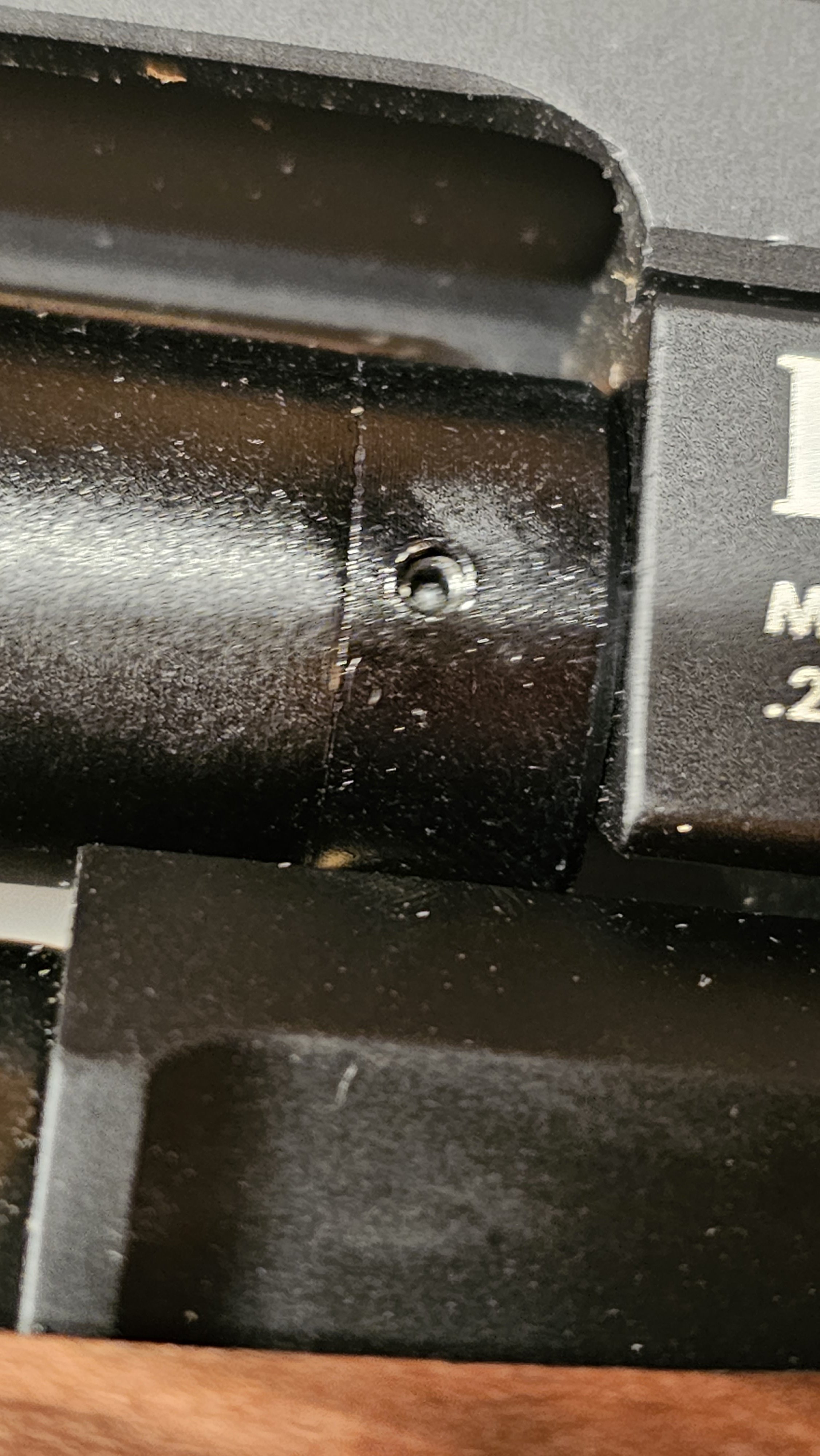

G'day,
Long time lurker, first time buyer of a PCP. I purchased the Akela .22 and right out of the box the barrel shroud moves about a 1/4" back and forth if you wiggle it. Accuracy seems okay as I'm trying different pellets. Presently using JSB jumbo heavy 18.13, and Benjamin Discovery 14.3 hollow points. I haven't had time to stretch it out yet, so my testing at is 10 to 25 yards.
My question, is the barrel shroud moving the barrel as well? Based on YT videos, the break down seems pretty easy. Is this something that I can tighten up or should I mail it off to Benjamin?

Have you tried screwing on the shroud a bit tighter. The air stripper inside the shroud is threaded onto the barrel, so yes, unintended movement of the shroud could have some effect on POI. Moving "back and forth 1/4 inch" is not normal. My .22 Akela does not move at all and is a laser beam at 25 yds. The starlings, sparrows and crows hate it.

I wasn't sure if the barrel shroud was screwed in, so I will give that a try. Thank you for the advice, and I'll report my results. I was more concerned about taking it apart and canceling the warranty.
There's a grub screw that secures the shroud. I cinched that down and that took care of maybe 75% of the issue. There's still some play in the shroud. Should I dismantle the rifle and inspect all parts?
I've attached a .PDF that shows the components of the Akela. The shroud should not move, it should be rigid. There's a collar held by 2 set screws (that's in your photo above) that's threaded. The shroud threads on to the collar. The barrel is about 6" shorter than the shroud. You can twist the shroud to unthread it off the collar. Then pull the shroud away from the rifle to remove it.

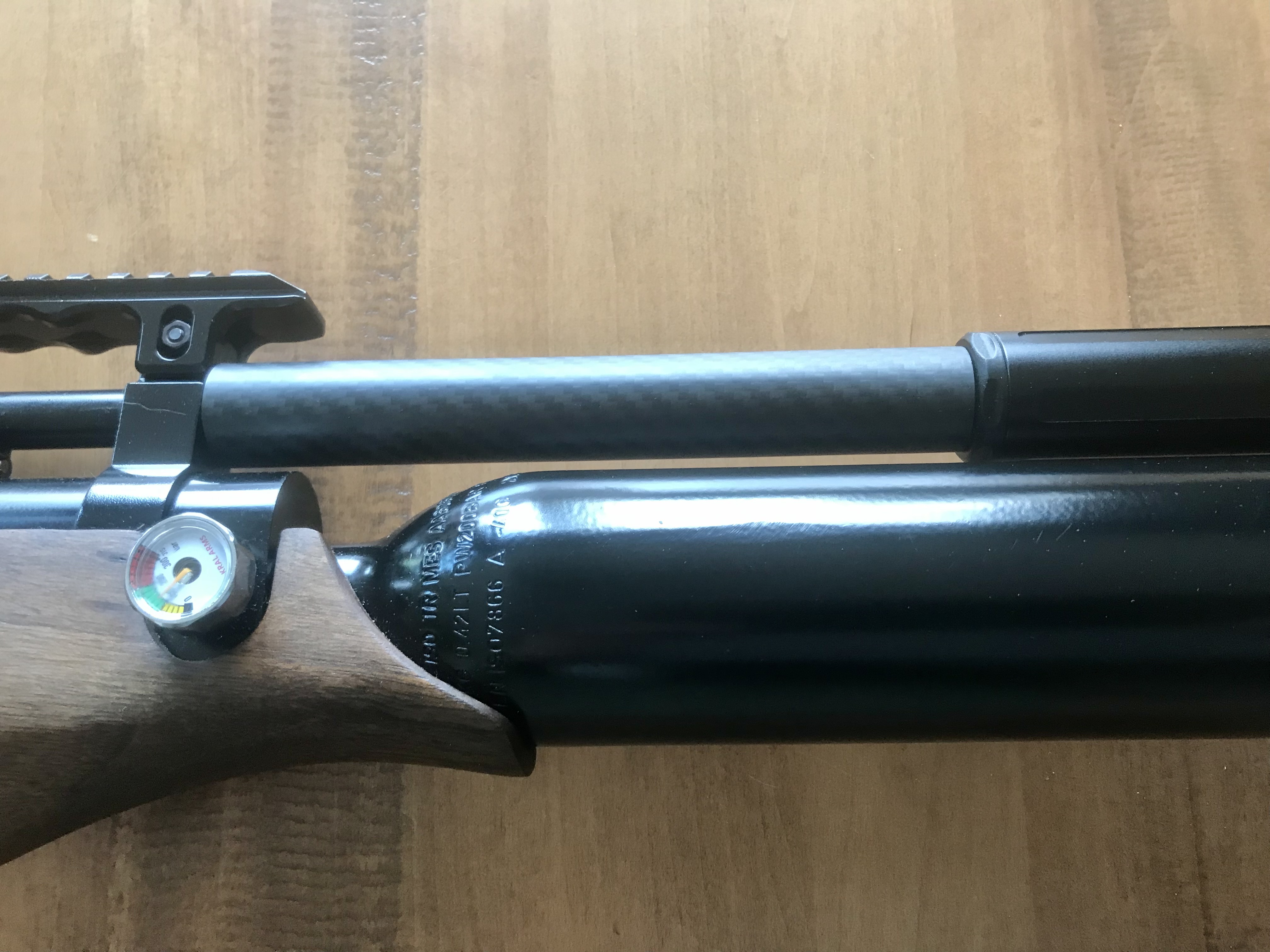

I have two Kral Empire X's,...same rifle..... The shrouds are paper thin and move all about. You cannot mount anything on the shrouds. I removed the shroud on my Kral, installed a moderator on the barrel thread, and covered everything with a piece of carbon fiber. You will be happy if you do the same. I used rubber grommets to hold the carbon fiber shroud in place. I did post this in the Kral thread...

Thank you @Hy-Score , I'll do some research on your build. I appreciate your advice in helping me sort this rifle. I do love the Akela and have high hopes for the long term ownership.
