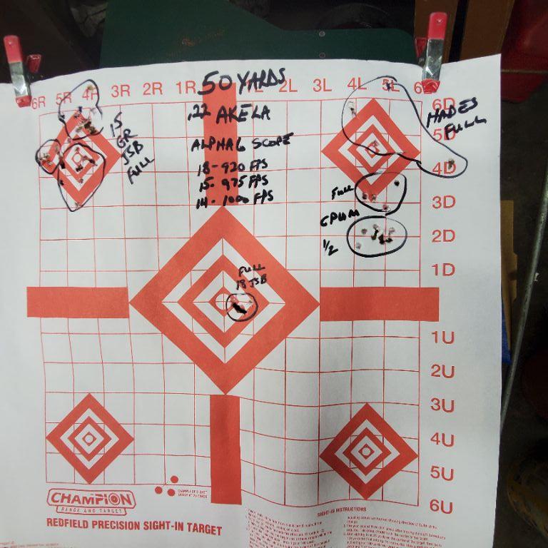

What O'Doyle said. Try Crosmans at half to 3/4 power for 760- 900 fps. Find the setting where its most accurate. I was shooting mine at full power at 1000 fps and they were still fairly accurate out to 50 yards. But for best results mine was shooting the JSB 18 gr at 925 fps on full power, hammer spring backed all the way out, and I was getting 1/2" to 3/4" groups at 50 yards. I've never had much luck with H&N pellets in my pcp's. They were ok, just not great. But the 14.66 shot great out of my 0.22 springers. For pcp's I stick to JSB in various weights, and Crosman 14.3 if the gun likes them. My 2 cents.

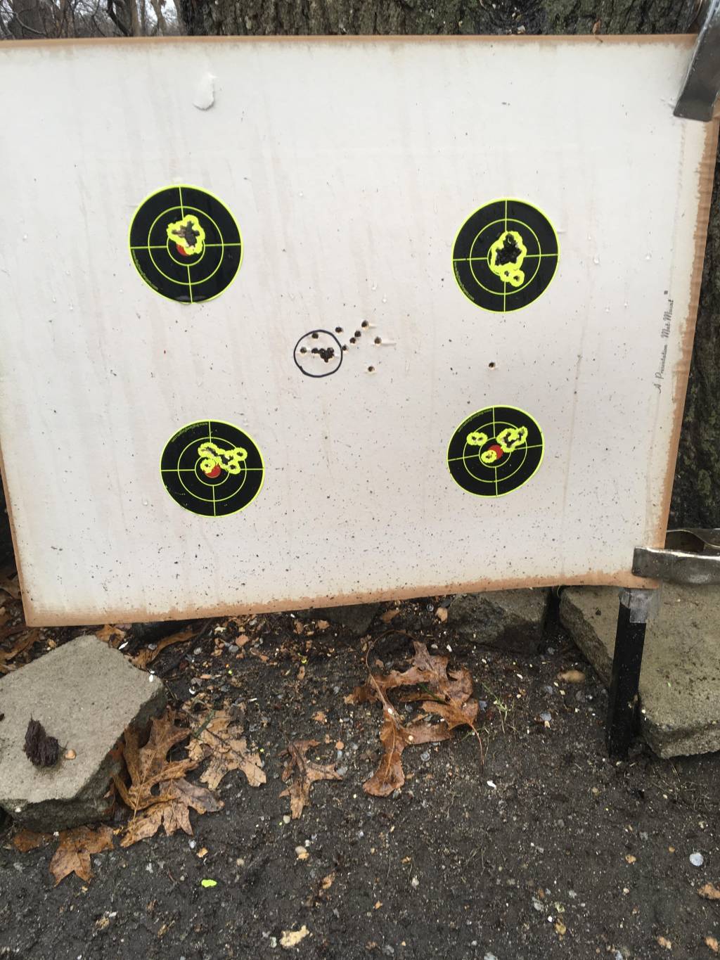

yep, 20mph crosswind will play heck with just about any pellet especially a 14.3 gr Crosman. This target was shot at 50 yards outside with a light wind. 18 gr jsb shot great at full power. The Crosmans weren't that bad considering they were going 1000 fps. The lower group of crosmans were probably around 800 fps but I didn't chrony them at that setting at that time. Still shot better than the Hades or 16 gr jsb. Also the center group of 18's is six shots. The other six are the left group on the top left target, I just forgot to mark it. The two larger groups were 16 gr jsb at 975 fps.

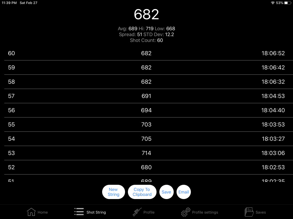

I’ve found mine likes slower velocities. Groups shrink down to nothing at 670-700fps.
This might sound lame but at that speed the pellet is doing its weight in fpe.
At 670 a 14grain is producing 14fpe, 21g /21fpe.
I’ve gotten 48 consistent shots with 21-23 grain H&n slugs by Chasing my velocities,
starting lower, finding where the pellet/ slug is hitting these speeds then as it falls off I make hairline adjustments to the power.
I've gotten 72 shots total(6 mags) using 15.89 hades. I threw out 12 shots total which where the adjustment shots that came in a little too hot or the shots that dropped off before adjustment
seriously if you can notice you turned the dial it’s too much. Shots taken at 36 yards.
