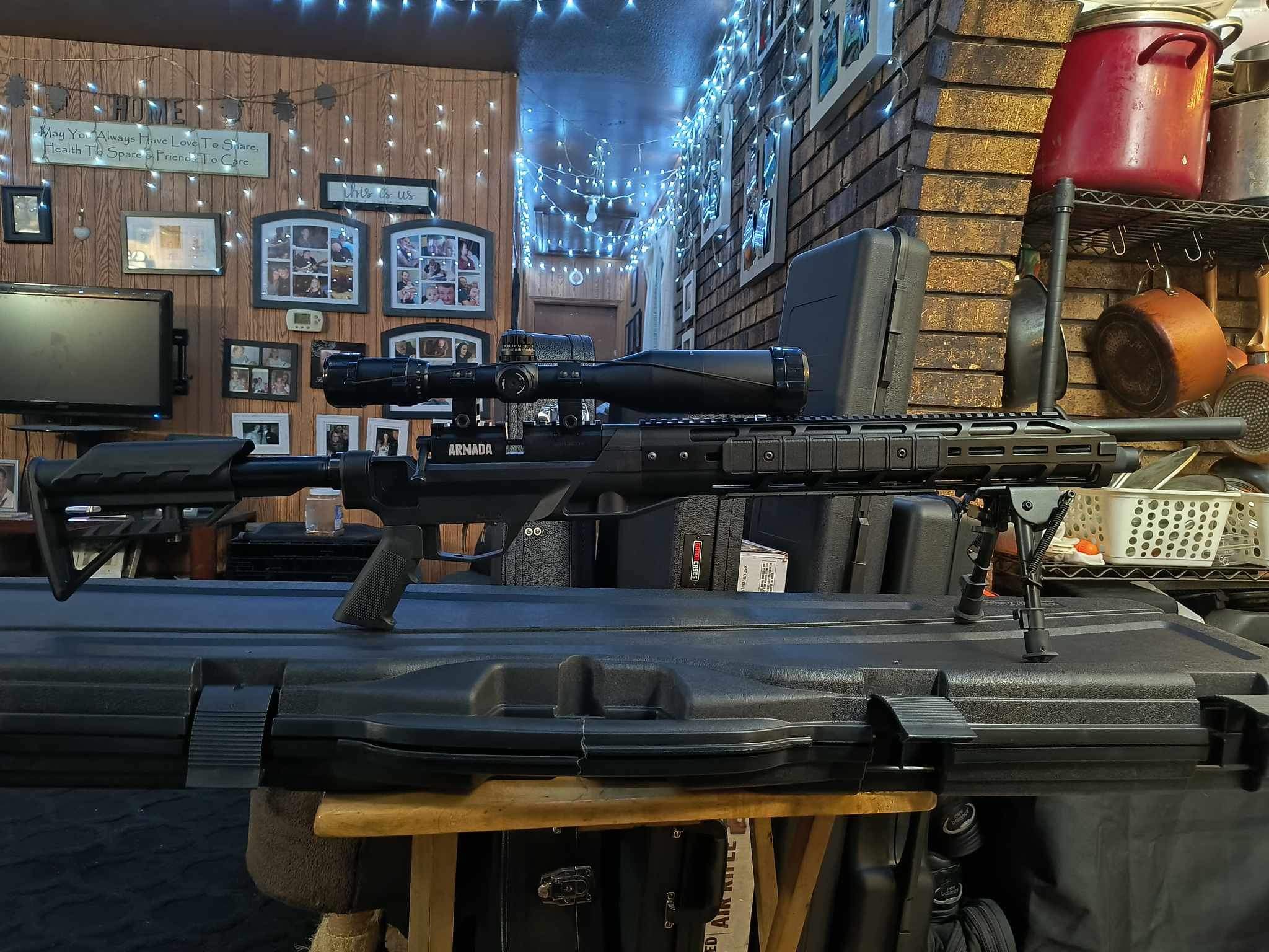

Benjamin Armada, looking for tips on best mods..
I recently picked up a new Armada .22 just looking for some advice or recommendations on mods, anything I should look out for or be aware of ect..

I would for sure recommend a nicer bipod. Caldwell makes a decent one for under $50. (unless it's just for a display stand).
If I were to build an Mrod/Armada now, this is what I would do -
1. Polish barrel/open up ports on air stripper (the stock air stripper from Benjamin has very small holes to vent air into the shroud. Opening up these ports will make the gun substantially quieter. If you have the prowess I would DEFINITELY clean up the leade on that OEM Crosman barrel. That will probably give you your BIGGEST return on investment from an accuracy perspective.
2. Lawyer spring removal (extremely easy to do and will give you an incredible trigger).
3. Add a Huma Reg with the XL Plenum - the reg + a Hill/JSAR lightweight hammer (or drill out the one you have to lighten it), PEEK striker, and lighter valve spring will give you substantially more usable air and just a more pleasant shooting experience. The XL Plenum will give you ample plenum size for a slug tune and have incredible efficiency for a pellet tune if done right. SSG/SSS/TSS optional. I have had plenty of luck running the stock spring or a Hill 262 spring in my .177 build.
4. (maybe) an upgraded valve from Hill or JSAR/enlarged TP's from Hill

I agree with the extra spring removal as well and forgot about this cheap and easy mod. It basically turns the trigger into a match trigger for free. When suggesting this mod you should also mention that he will need to add back a spacer to recapture the sear and keep it from walking around and ruining the consistency.
The stripper mod is questionable on a Gen 2 platform. It doesn't make much of any difference.
The rest of the post contradicts itself by suggesting he take the whole rifle apart and install things that cost a significant amount of $ followed by saying that you would have just bought another gun instead of spending all the money and effort.
This is of course my opinion again but DONT REGULATE IT. This platform can EASILY be tuned to shoot 40+ rounds within 20fps of each other. A regulator costs significant $, adds weight, parts and seals, WILL CREEP AND EVENTUALLY FAIL AND NEED REBUILT, and kneecaps the power unless you do a bunch of other stuff. On top of that it barely provides any improvement other than shot count and many people will be chasing leaks for the rest of their experience.
Suggesting a bunch of mods that require complete disassembly without even asking about their skill level or desire to take apart their brand new rifle is a great way to end up forcing someone right out of the hobby when they cant get it to seal up or perform hardly any better than factory.
Do the cheap or free and easy mods first, learn the gun and evaluate what you like it to do that it doesn't do already. In my opinion.

Nope - the baffles are different than the air stripper.
The air stripper is the piece that is press fit onto the barrel and centers the barrel within the shroud. There is an o ring around the edge of it. I would not modify the baffles within the shroud.
This old thread from GTA details the whole thing very nicely:
