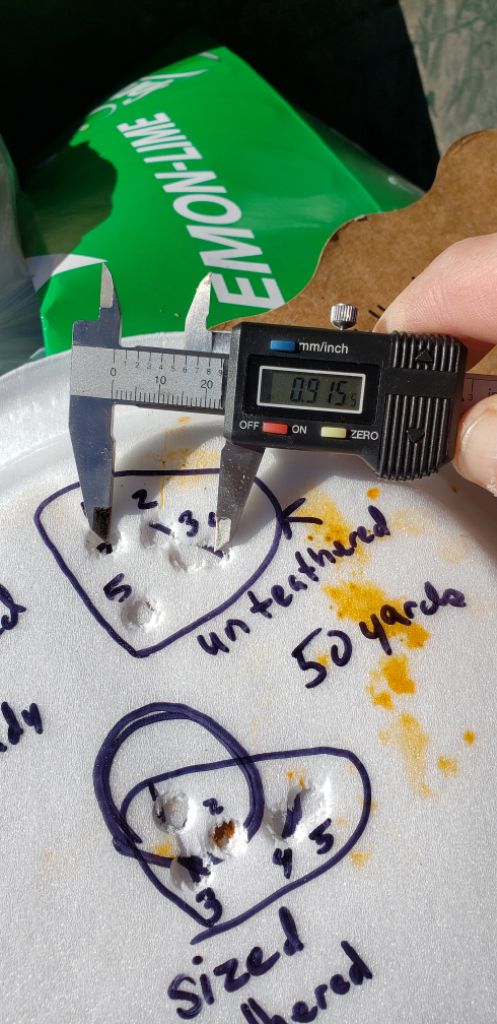

The lead is harder than we need but I can get sub 1" groups teathered at 50 yards at 800 fps for 210 ft lbs.
Un teathered 1.5" at 50 yards.

I will find a .38,.357,9mm round that cost $10 per 100 that will suit my needs.That is my current quest.So far with the Hornady .38 sized to .357 I can get 1" groups at 50 yards I have sub 1" at 40 yards.

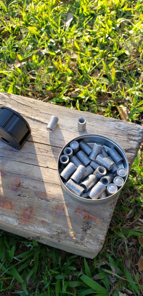

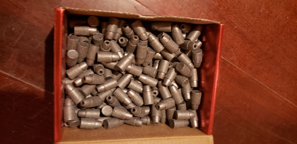

I bought some off the shelf .38 hornady 148grain hollow point wad cutters.
I'm done buying pellets
These have a low b.c. so its essentially a 148 grain pellet.$23 for a box of 250 they are sized .359"
Run them through a Lee precision. 357 die/press its 3/4"-1" groups at 50 yards.Expanded over 1/2" in soft loose soil.10 cents per round and avalible locally.Shooting at 800 fps and 210 ft lbs

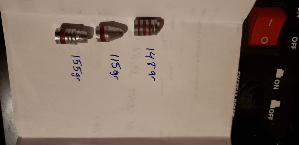

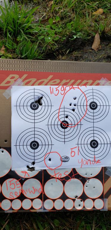

Today I received a package from GT bullets.
Some 155 grain semi wad cutters.115 grain round nose and some 148 grain wad cutters.

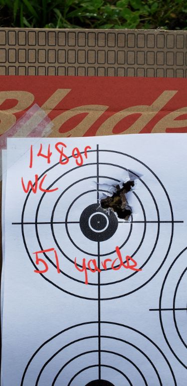

I must say the 148 grain wad cutters stole my heart and I found the mold for it.
51 yards and a 7/8" ctc groups on a stock bulldog.
I drilled out barrel and valve port to .260" and removed transfer port,tightened hammer spring all the way and that gave me 840 fps with 158 grains for 242ft lbs.Todays test I installed the transfer port and backed off hammer spring to factory settings.
Fps unknow......guessing 730 is fps.
The black bullseye is 7/8"

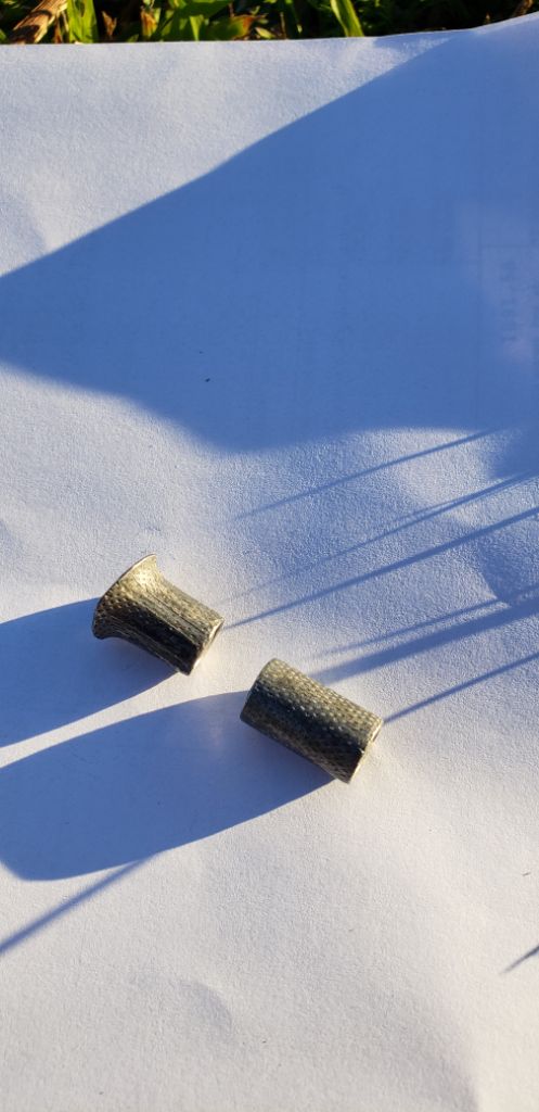

Love these .38 wad cutters.I order them in .358 and I size them to .357.
Try one of the HBWC turned around and shot in the soft soil.The expansion will amaze you. We shot them backwards all the time from handguns at 7-800 fps. Don't know how accurate they'll be at distance though. Also if I remember correctly when purchased in bulk, (1000-5000) you could save 1 or 2 cents each.
I watched a YouTube video on the same last week. Amazing expansion turned around backwards!
