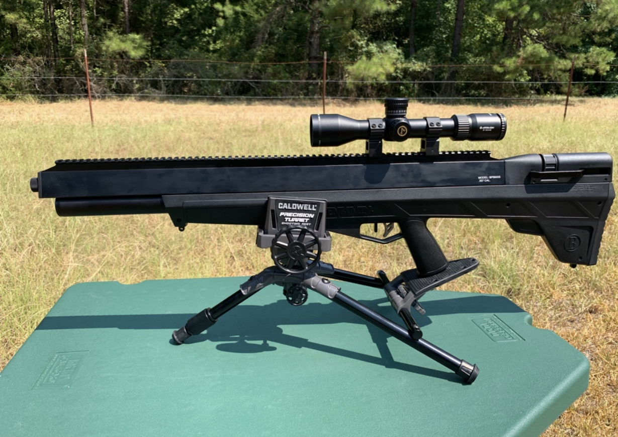

I’d been contemplating picking one of these up for a while. I didn’t know if I wanted a .457 Bulldog or an M357. I decided to go with the M357 because it’s cheaper to shoot considering ammo costs, I have more experience with various iterations of the.357 Benjamin Bulldog and I’m pretty familiar with the platform to where I’m comfortable enough to work on my own gun to a certain degree. I paired mine with an Athlon Helos 2-12x42mm FFP as seen below. I may try another scope or two on it in time

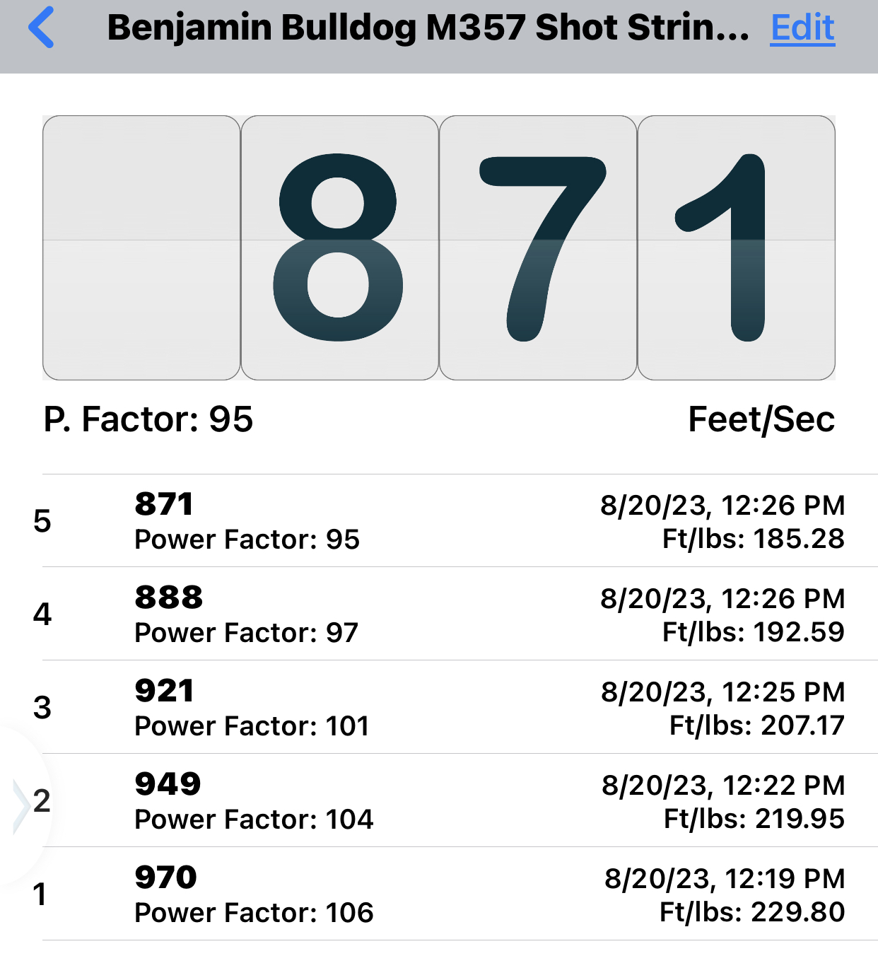

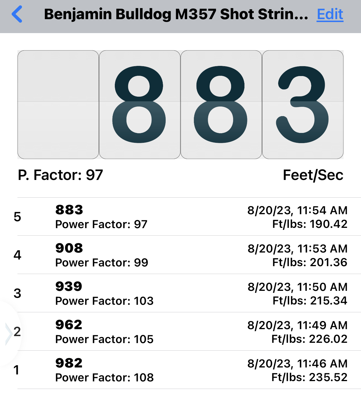

I sighted in the Helos at 25 yards shooting NSA 110 grain slugs. Per my other Bulldogs, this one shoots them pretty well up close. I only made it out to 35 yards before the heat started cooking my electronics and giving me a headache. I packed it in around 103F. Here’s a couple of shot strings.

My verdict on taking out deer at a distance is also inconclusive. I don’t want to speculate there so I’ll wait until I have more data. To satisfy the 215 ft/Lb minimum requirement for taking white tail deer, these 110 grain NSA slugs need to be shot at an approximate minimum velocity of 939 fps from this Benjamin Bulldog M357. My suggestion is to chronograph your rifle once you get it to be sure that it’s consistently shooting at or above this velocity with 110 grain NSA slugs or other projectiles of the same weight.
As you can see from my shot strings, the first two shots from a 2900-2800 psi fill meet the legal minimum requirement. After five shots (one magazine) the reservoir finishes around 2100-2000 psi. I haven’t pushed any shots below 2000 psi. That’s good enough for me for an unregulated hunting PCP. Oh yea, This rifle is LOUD and powerful. This isn’t a toy. You’ll likely want to wear hearing protection if you wish to preserve your hearing. It is not a backyard friendly rifle out of the box. I have not shot it with a moderator yet.

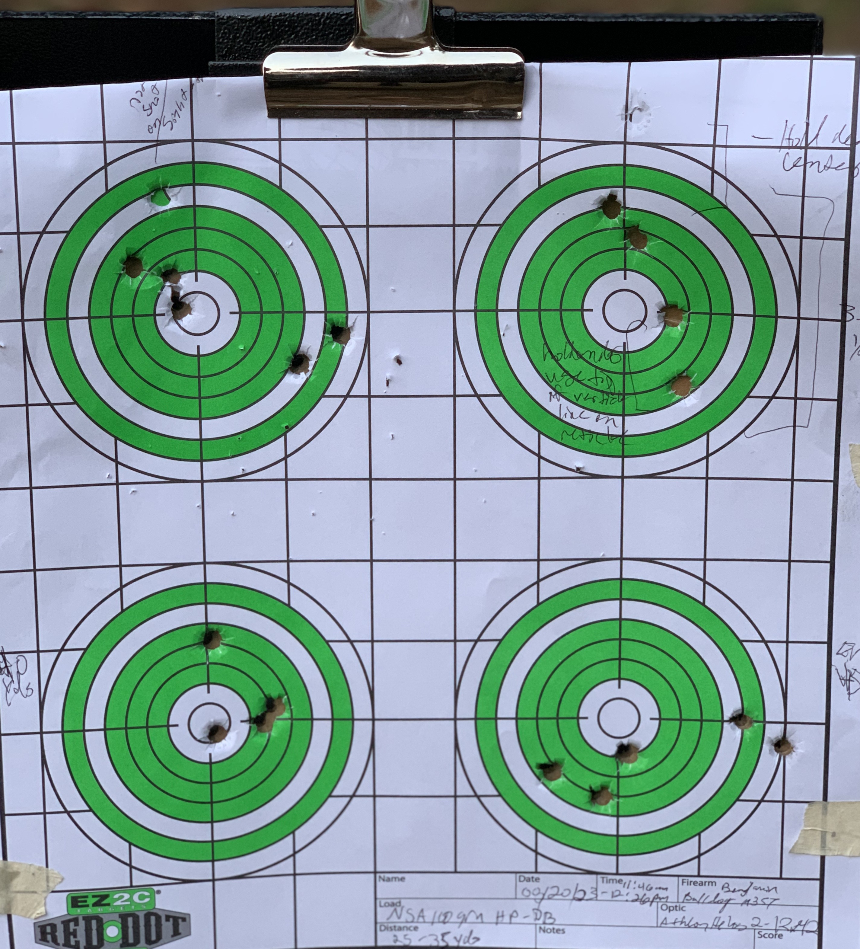

As you can see below I’m not where I want to be. The top left was my first 25 yard target getting my scope zeroed. Hence the low shot into the target below which was my first shot. The top right target helped me nail down and confirm my zero. Then I moved back to 34-35 yards in the center right target. As you can see I’m chasing my hold here. The reticle has no subtentions for holdunder. So I have to find my optimal zero. When it cools off, I’ll make it point to get back to it. But the second 25 yard target shows me that the gun and ammo are compatible when the shooter does his/her part. But I think that ultimately distance will tell the tale.

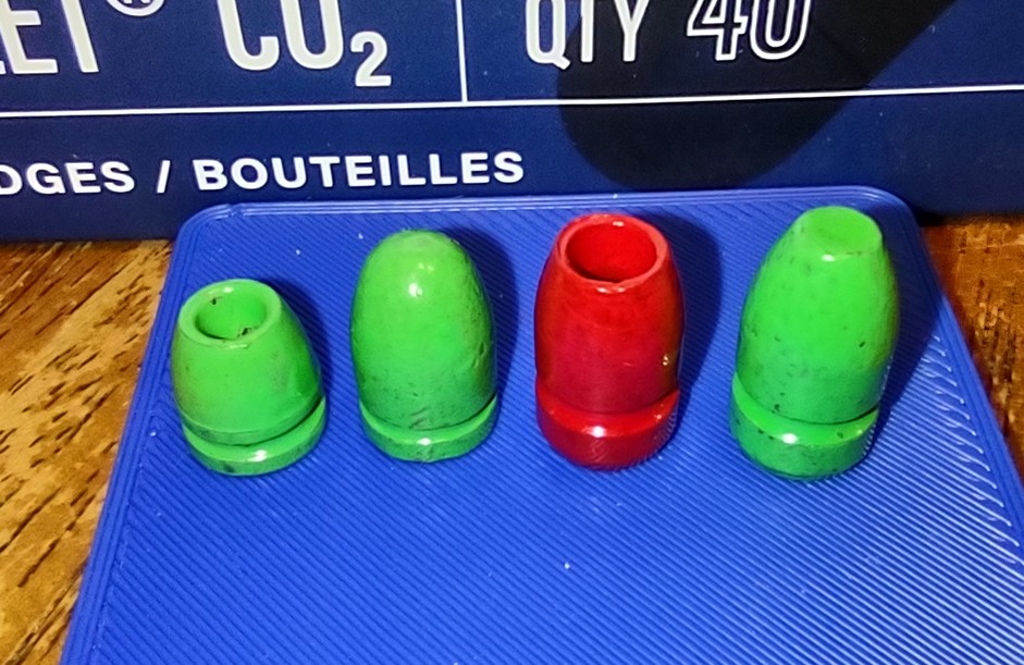

I have some flat nose in 155 grain, same shape as the 135 gr hollow point, but haven't shot them enough to really know. I have about 2 pounds of the hollow points. The 130gr Lee mold (round nose with 2R curve) has been my gun's favorite and most accurate round, running those up around 780-800fps which is under your power level, but they are made for 9mm handguns, so 1000fps should be fine if you can reach it. I have enough of each I can send some samples if you are OK with powder coated ammo. All have been run through a Lee 0.357 die which is pretty close to size. I can make new ones that are 0.358 or squeeze down to 0.356, since you said the barrels seem to be the same as old BD, I'd guess 0.357. Only thing I use now is "pure" soft lead. Let me get some pictures.
I also need to make myself some 88gr flat nose and 84gr hollow point, good for smaller stuff like medium size pests! Last testing had those around 110-120fpe, but I'm clean out of those. But if you need 50cal muzzle laser bullets, I have pounds of those!

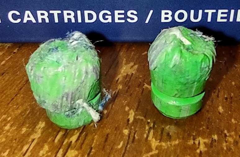

In order 84gr 130gr 135gr 155gr. The 84 is old junk lead that I won't shoot and won't give to anyone, I'm going to melt it and make it into a soft face hammer. But you get the idea, it's a NOE mold and not my favorite. The 130 Lee is one of my favorite to cast, just easy to make lots. The 135 and 155 are Lee steel molds, they get heavy and the hollow point is 1 at a time which has a higher success rate than the solid version.
I haven't shot anything but paper and cotton with the 135, not seeing much expansion. All of them mush up really good in the cotton so expansion in flesh and hide should be decent.
I'll try to dig around in my cotton bucket and see what I can harvest for you. The 130 go about 8 to 10 inches deep into old denim, the 155 are almost to the back of the bucket at 12 inches, this is about the max power I can test in my garage without fitting a steel plate in the bottom of the bucket.

Found a couple of the 155 that didn't get smashed into a big ball, somewhere in the 200-210 fps range on these into denim in a bucket. I'll have to unpack the entire bucket and see what I have before my next casting session, should be about 2 pounds of lead in there.

I did a little more shooting this evening and set my zero from 25 to 40 yards. When I shot from 45 yards with a 40 yard zero, the slug dropped. It seems that somewhere around 40 yards is my apex zero with this scope in these rings shooting these slugs. I’m still feeling this scope and rifle out. Not the biggest fan of this 2-12x42mm Helos Gen 2. I don’t think it belongs on this rifle. With the range this gun is capable of I think that a scope with a max magnification of at least 20x with a 50mm objective should be the minimum standard. This Helos may be better suited for a stock .357 Benjamin Bulldog, but then there’s the issue of light transmission in low light environments close to dusk and dawn. That’s another thread altogether.

The lower left target is where I reset my zero from 25 to 40 yards. I think I had one slug fall out of the mag in my pocket.
They are not good groups, but they’re honest. I can live with 1” at 40 yards for now. I guess things can really only get better from here.
