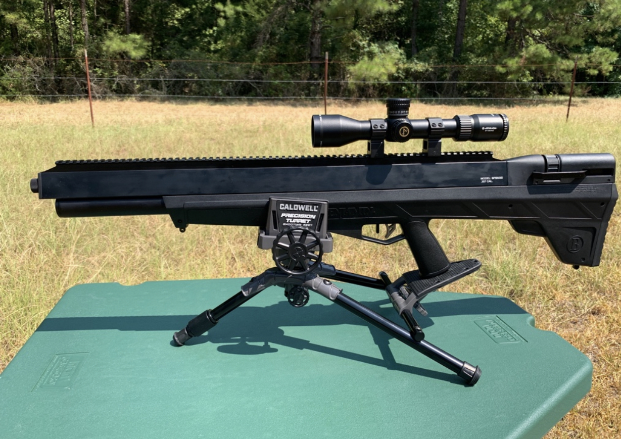

I’d been contemplating picking one of these up for a while. I didn’t know if I wanted a .457 Bulldog or an M357. I decided to go with the M357 because it’s cheaper to shoot considering ammo costs, I have more experience with various iterations of the.357 Benjamin Bulldog and I’m pretty familiar with the platform to where I’m comfortable enough to work on my own gun to a certain degree. I paired mine with an Athlon Helos 2-12x42mm FFP as seen below. I may try another scope or two on it in time

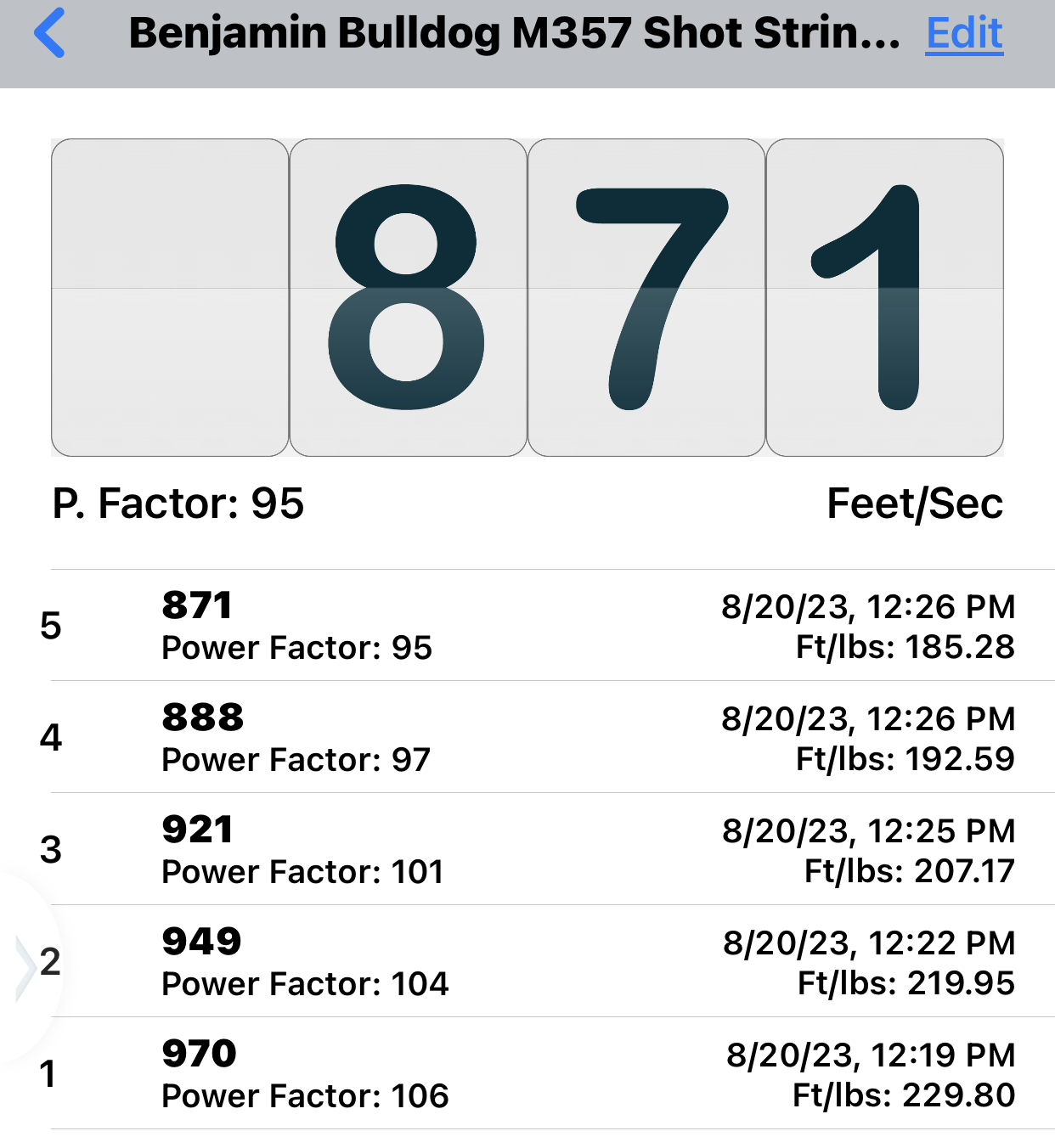

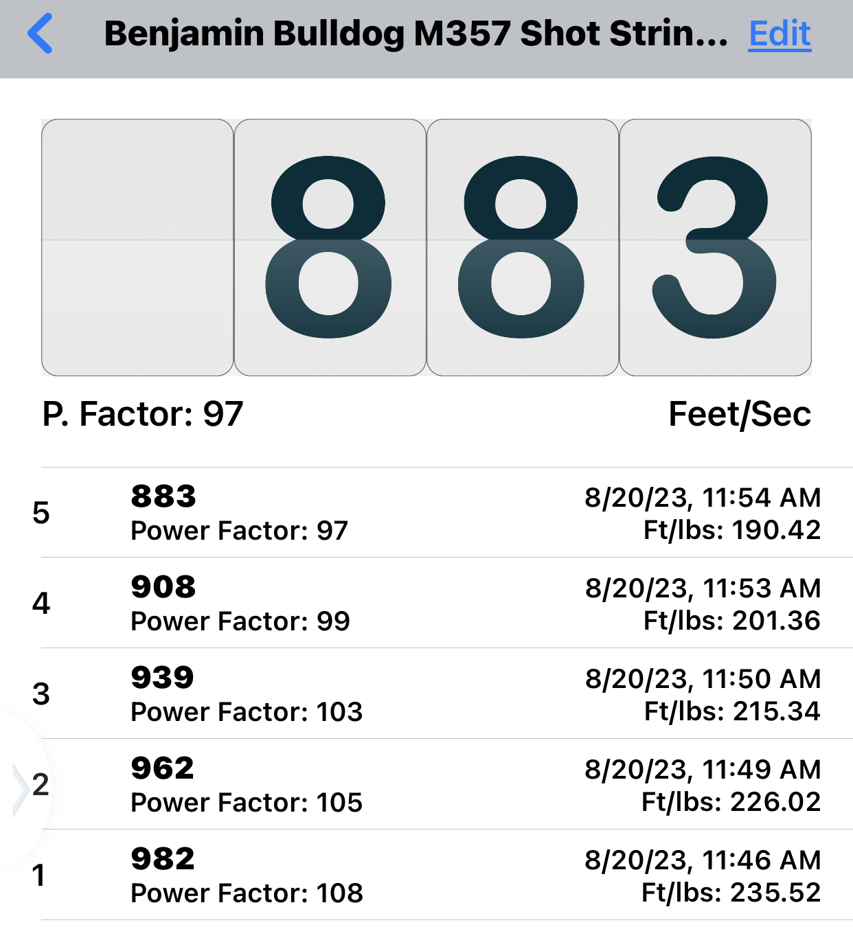

I sighted in the Helos at 25 yards shooting NSA 110 grain slugs. Per my other Bulldogs, this one shoots them pretty well up close. I only made it out to 35 yards before the heat started cooking my electronics and giving me a headache. I packed it in around 103F. Here’s a couple of shot strings.
My initial impression of this rifle is that out of the box, this is an adequate deer gun for me considering my experience with the platform and the regulations for deer hunting in the state of Texas as of 2023. The M357 is also capable of taking raccoon to coyote sized varmints. Due to the increased velocities compared to the stock .357 Bulldog, I’m thinking this gun is capable of ethically taking out varmints from longer distances with light 110 grain slugs. I’ll know more when I stretch my range farther.
My verdict on taking out deer at a distance is also inconclusive. I don’t want to speculate there so I’ll wait until I have more data. To satisfy the 215 ft/Lb minimum requirement for taking white tail deer, these 110 grain NSA slugs need to be shot at an approximate minimum velocity of 939 fps from this Benjamin Bulldog M357. My suggestion is to chronograph your rifle once you get it to be sure that it’s consistently shooting at or above this velocity with 110 grain NSA slugs or other projectiles of the same weight.
As you can see from my shot strings, the first two shots from a 2900-2800 psi fill meet the legal minimum requirement. After five shots (one magazine) the reservoir finishes around 2100-2000 psi. I haven’t pushed any shots below 2000 psi. That’s good enough for me for an unregulated hunting PCP. Oh yea, This rifle is LOUD and powerful. This isn’t a toy. You’ll likely want to wear hearing protection if you wish to preserve your hearing. It is not a backyard friendly rifle out of the box. I have not shot it with a moderator yet.

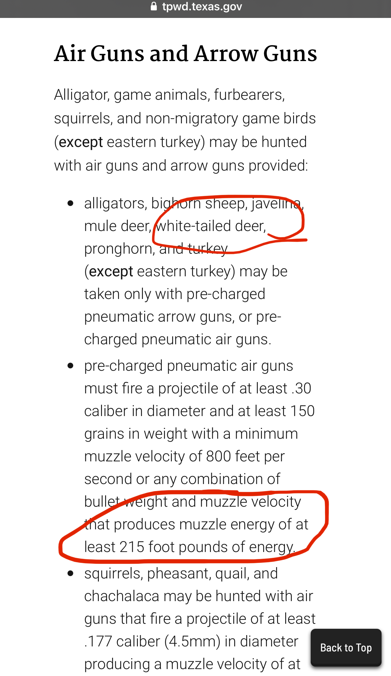

@c_m_shooter Unless something changed between last season and this season, that is incorrect. If you have evidence of the 300 ft/lb regulation that you speak of please post it.
Source: https://tpwd.texas.gov/regulations/...eep, javelina,,pre-charged pneumatic air guns.
@c_m_shooter I took a screenshot directly from the TPWD site. Here it is and I’ll edit my previous post to include the link beneath the screen shot.
The regs clearly state a 215 ft/lb minimum, caliber, suggested projectile weight, or an alternative projectile/velocity combination that equates to the 215 ft/lb minimum for taking deer and other game animals except eastern turkey. It was also printed the same in the hard copy of last season’s Outdoor Annual.
Thanks for being a part of the push to expand regulations to include hunting with airguns in Texas. According to my chronograph data, the Benjamin Bulldog M357 shooting NSA 110 grain slugs doing at least 939 fps fits the bill.

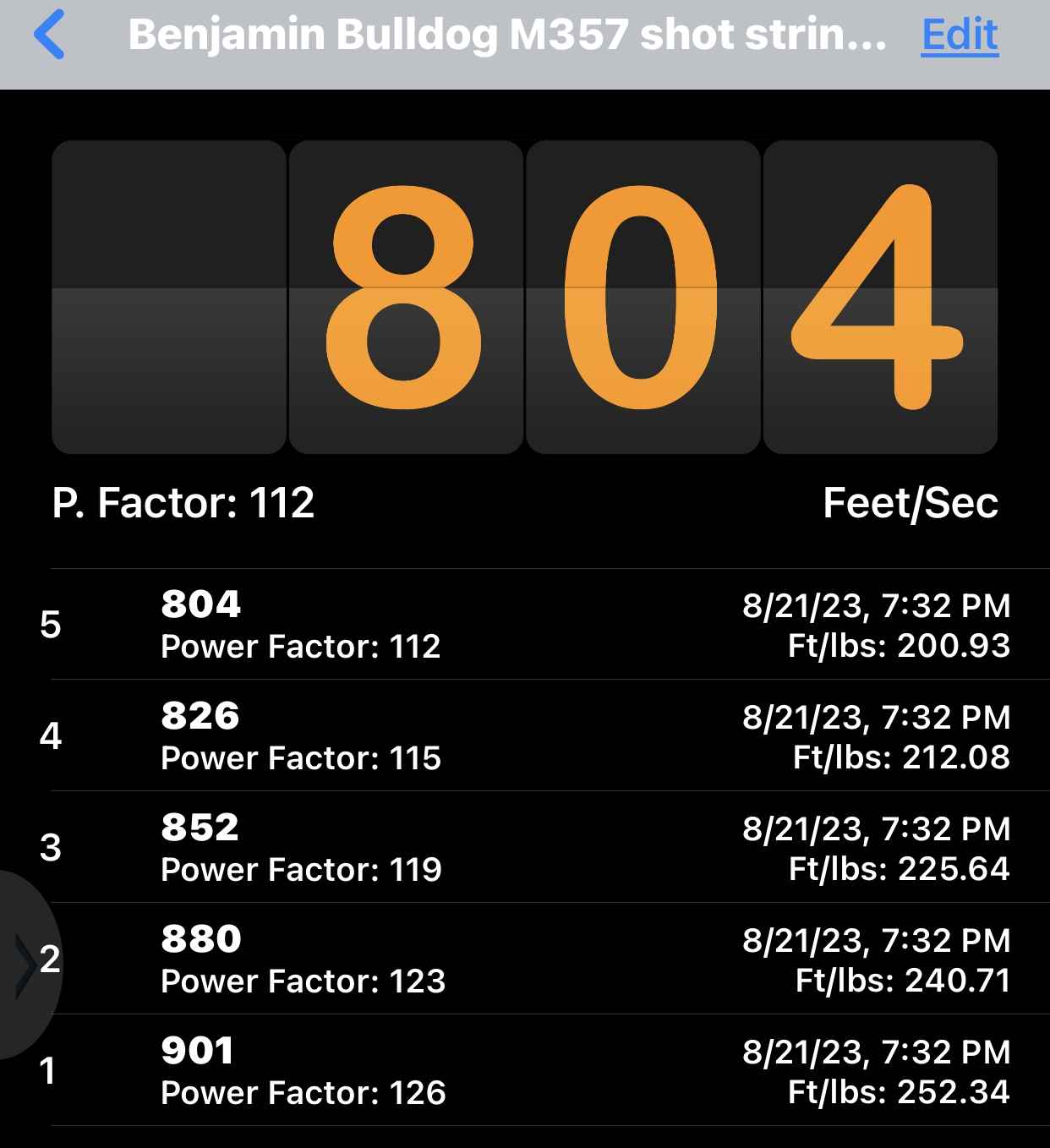

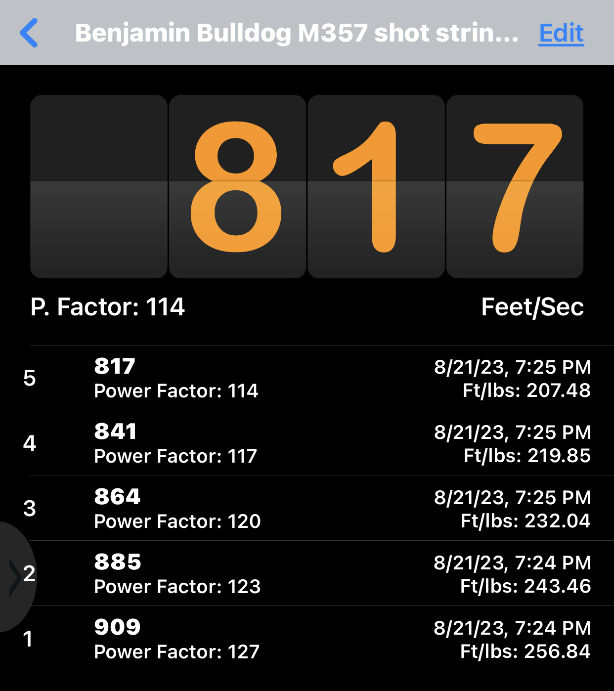

Todays results. Griffin slugs: 140 grain rebated boattail slugs shot from 43 yards. I didn’t adjust scope reticle to accommodate the change in weight. The first shot hit high and I held for the other 4 rather crudely. These slugs hit the bullet trap noticeably harder than the NSAs. One shot hit particularly hard sending the metal target clip and the clip’s adapter flying through the air, dropped the target, and made the trap jump. The trap is braced by sections of wood wedged behind it.

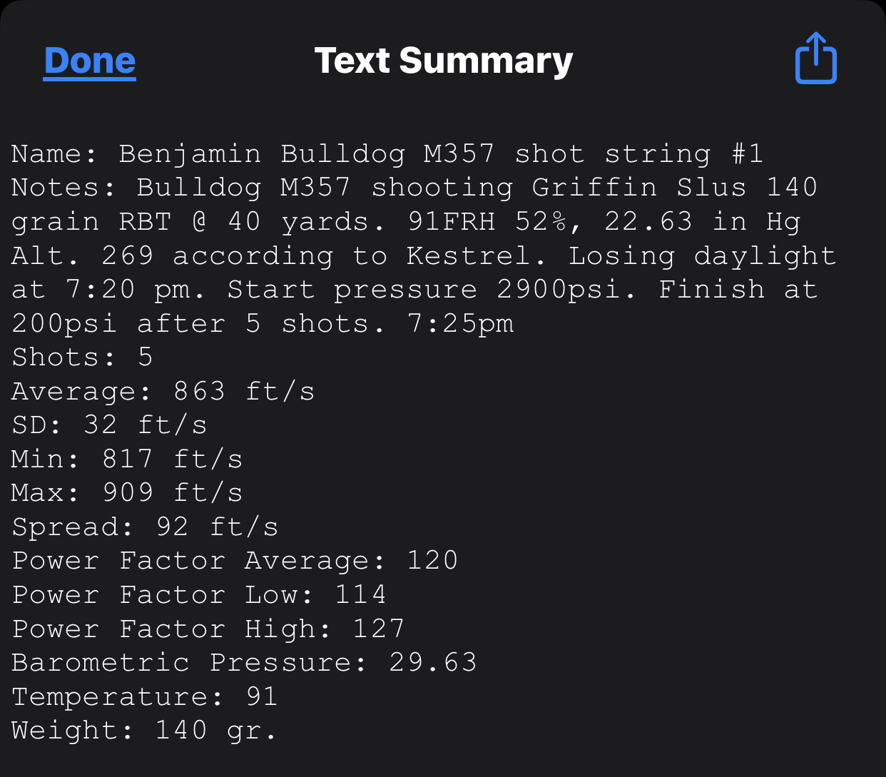

Below are data from two (5-shot) shot strings shooting the Griffin 140 grain rebated boattail slugs from a stock Benjamin Bulldog M357. In a 1st shot comparison, Notice an increase in fpe by about 21.32 fpe in exchange for sacrificing 73fps (982 fps - 908 fps = a difference of 73 fps); see the fastest (1st shot on a topped off reservoir around 2900-3000 psi) 110 grain NSA slug shot yesterday at 982 fps in post #1 compared to the fastest 140 grain RBT Griffin slug shot this evening in this post at 909 fps. That’s a 30 grain difference in slug weight comparing the 1st shots from the two aforementioned shot strings.
In the notes below that’s supposed to read “finish at 2000 psi.”

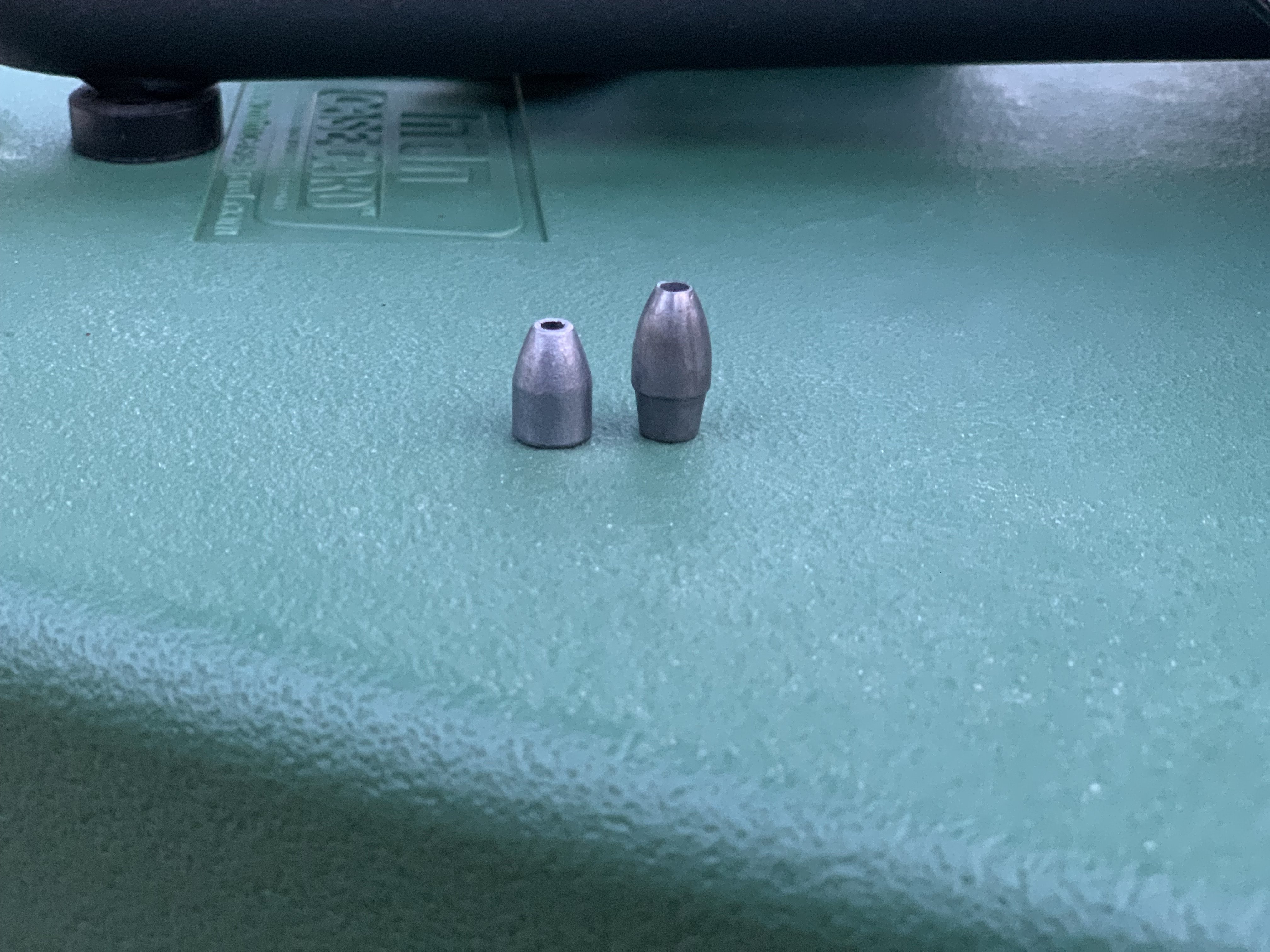

Pictured below are an NSA 110 grain hollow point dish base slug (left) next to a Griffin 140 grain rebated boattail slug (right).

Edit: i rushed out to get a few mags off chronographing these above pictured Griffin slugs. I didn’t adjust my scope to shoot them I just shot them. Two mags without paying a whole lot of attention to DOPE for chronograph data. Then the pictured group using roughly estimated holds. They held good enough for me to work with them more in the future. My setup was not comfortable at all, but I made due with what was on-hand to get more data out there.
