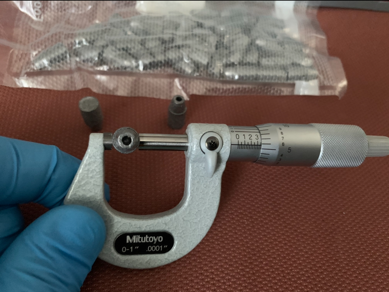

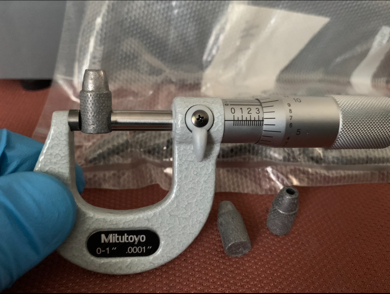

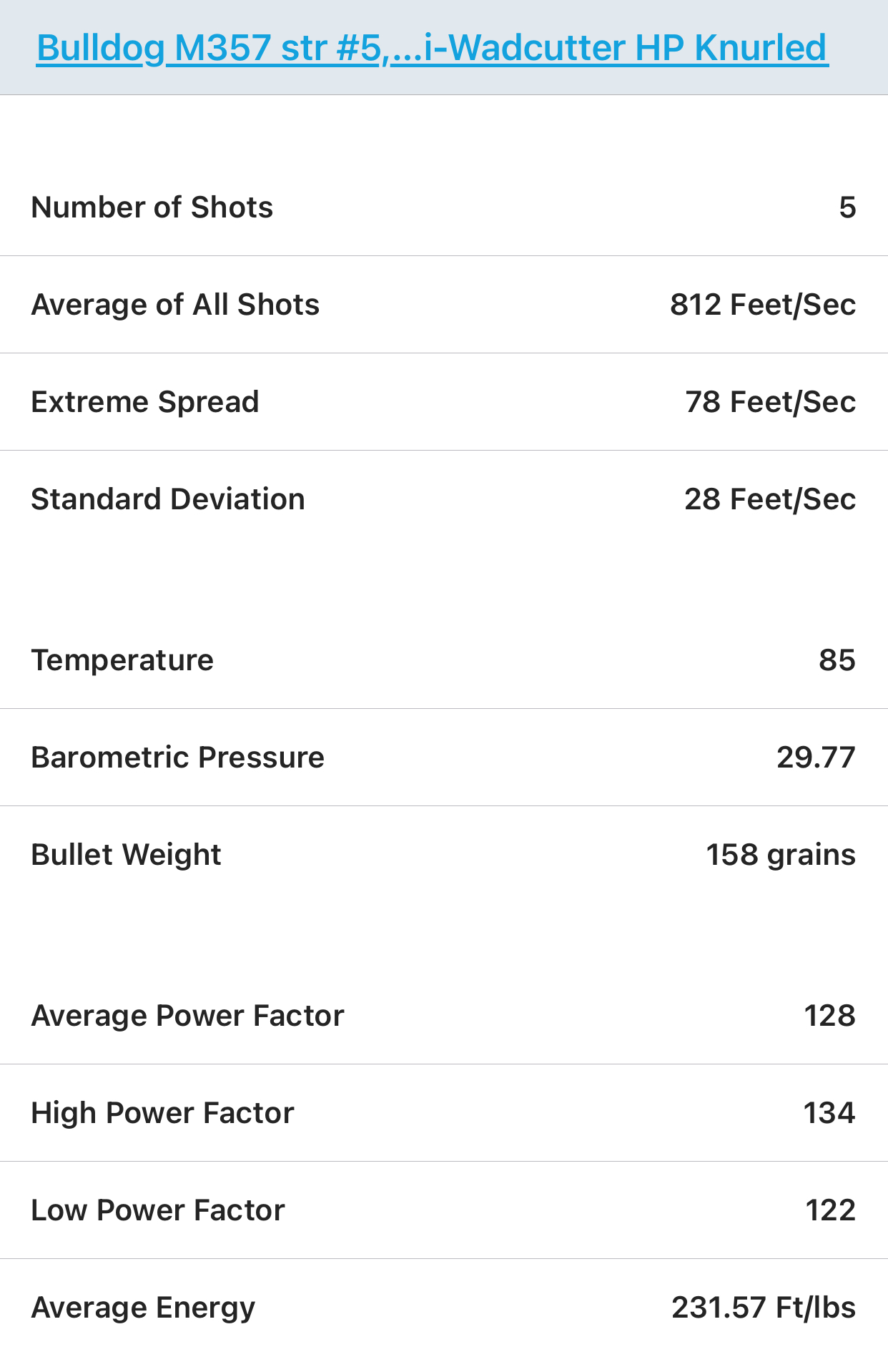

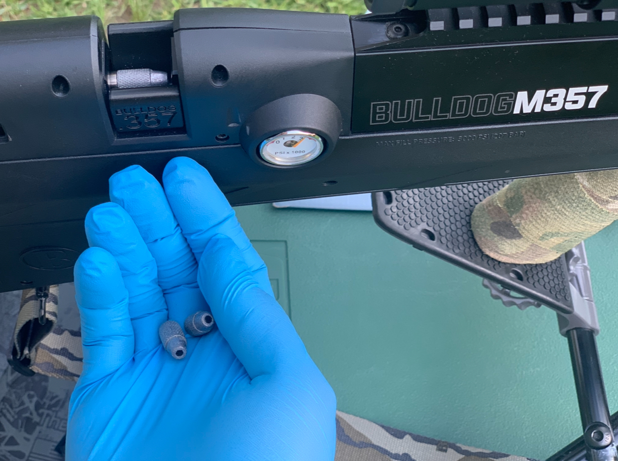

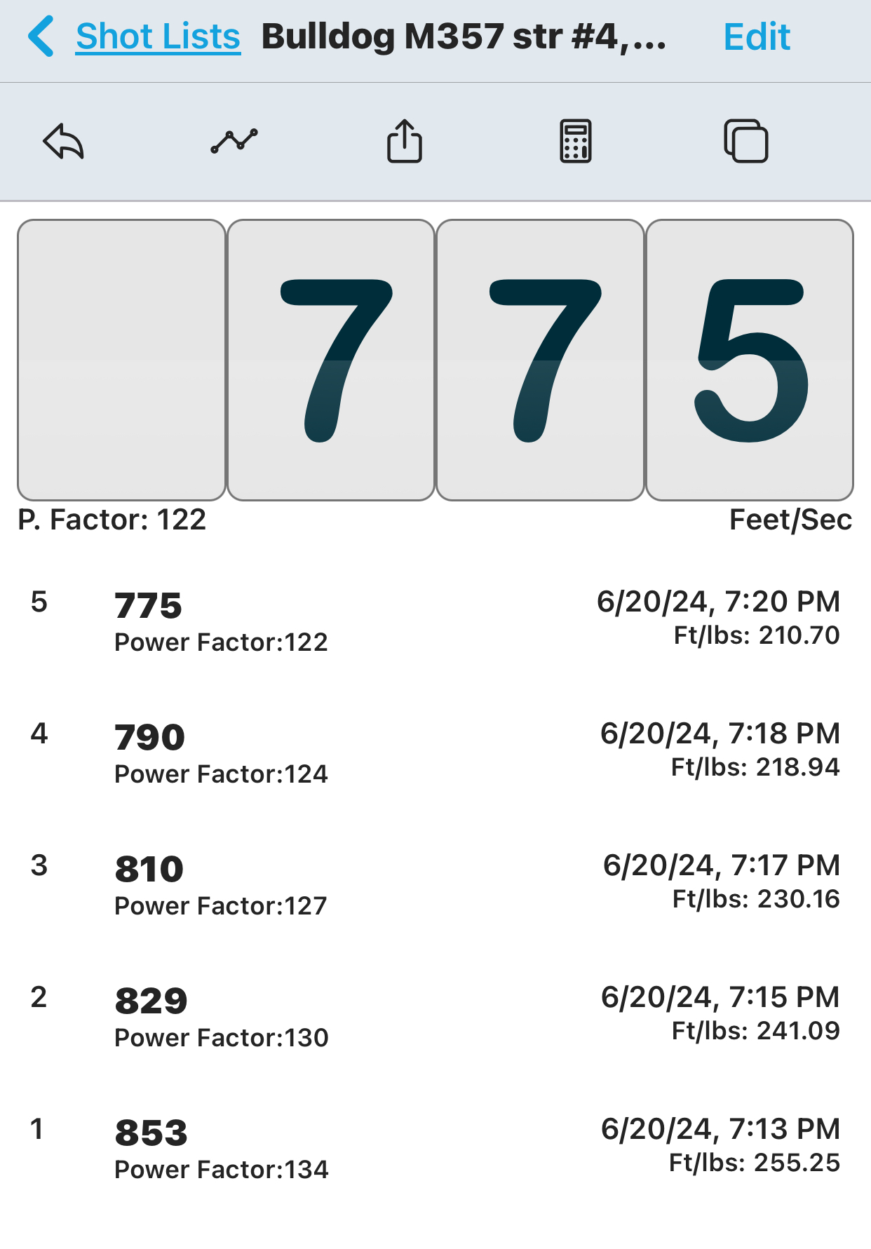

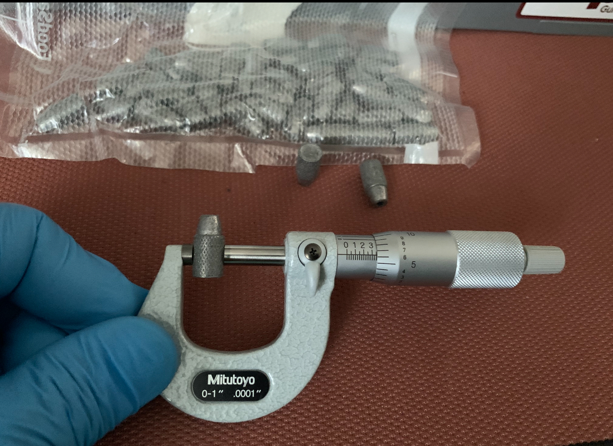

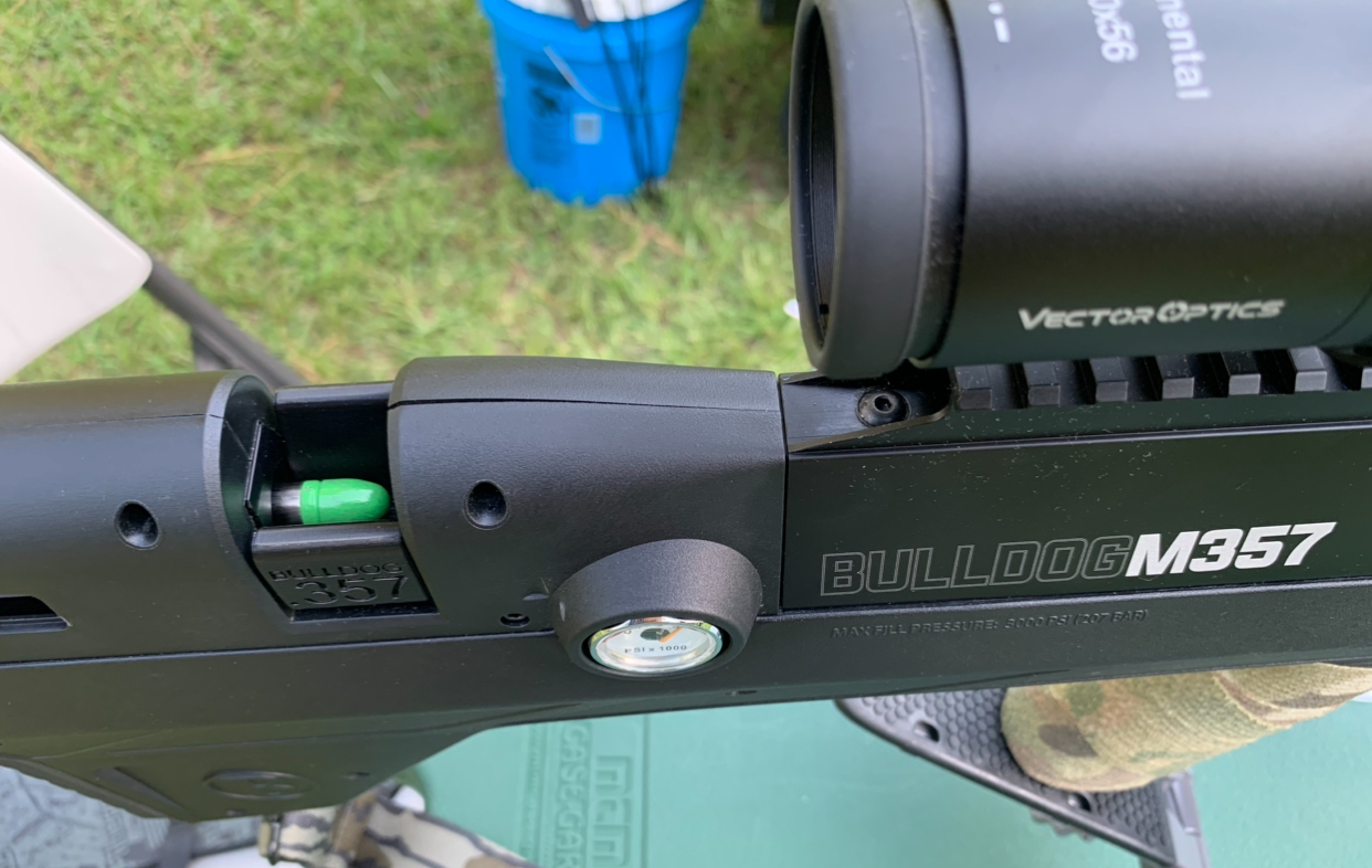

Benjamin Bulldog M357 shooting some Hornady .38, 158 grain knurled, flat base, hollow tip semi-wadcutter reloads. I’m still unsure about the actual the weight of these. This is the weight I was told and that is listed on the product description. @karl_h sent these. I didn’t weigh them to verify the weight. They seemed to range in diameter, .3555 - .3576 which also seems sort of consistent with what other say in the product reviews.
It took a couple of shot strings to get a feel for these. I was pleasantly surprised. They performed to my liking. I’d like to work with these more. But the weight is still in question. They perform at velocities very similar to the way that 165 grain Griffin boattail slugs shot from this gun.
Can knurling reduce a projectiles velocity when shot from big-bore airguns?

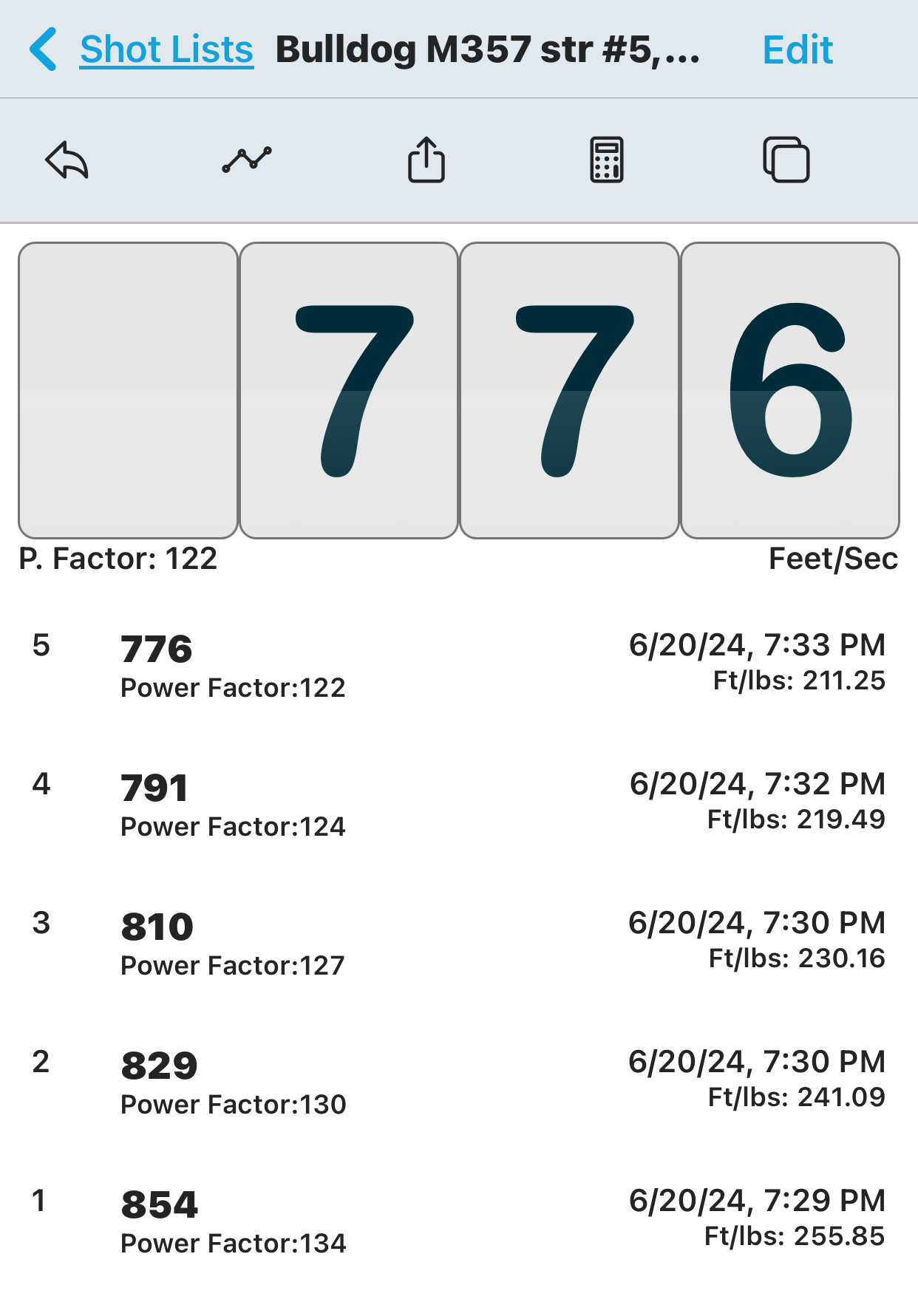

Shot string data:

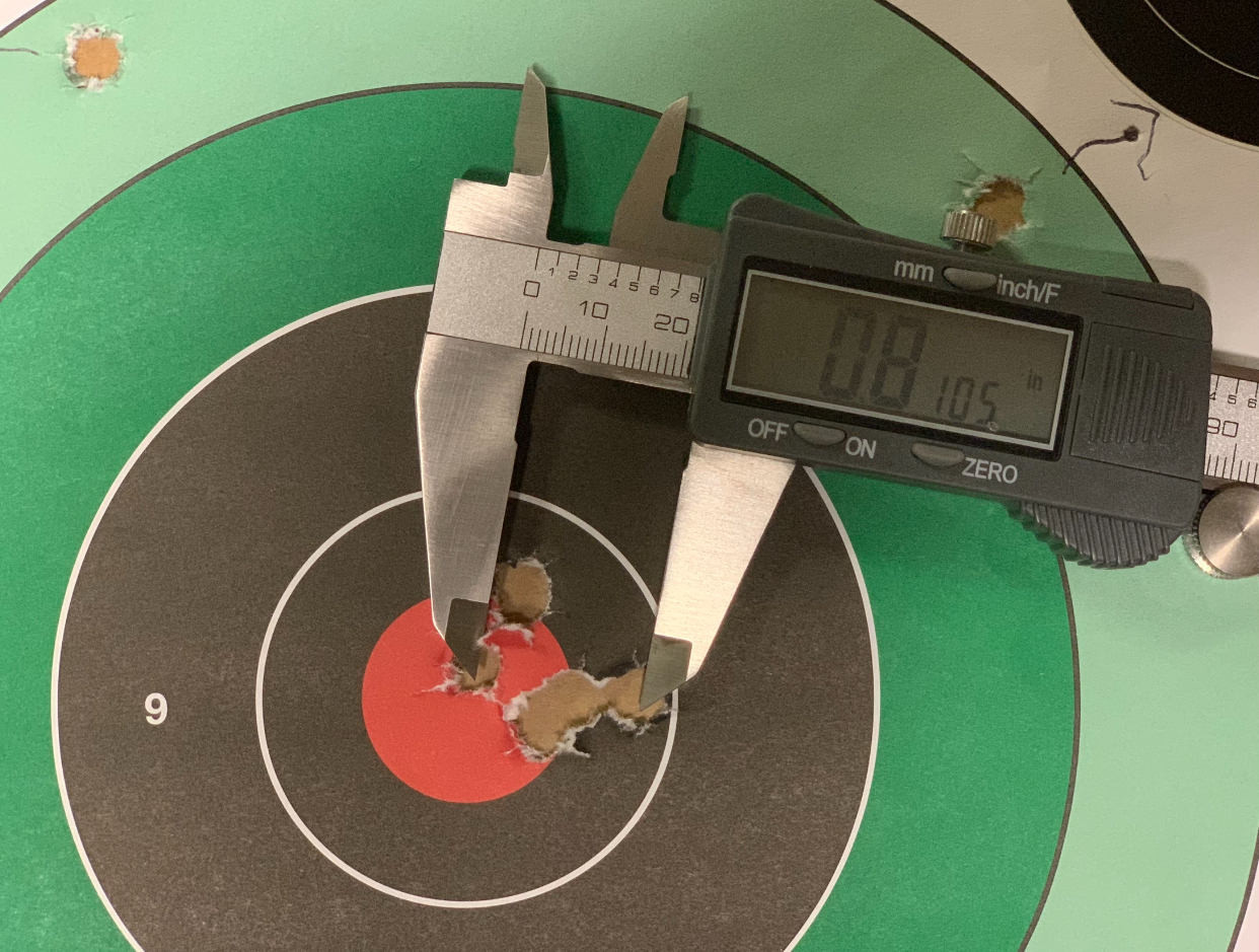

Here’s a few groups from 50 yards. Nothing spectacular, but considering my setup and abilities I know that I can work with these. I have decent DOPE so I’m thinking that things can only look up from here. Shots touching work for me and two almost in the same hole in the bullseye? All things considered, not bad.

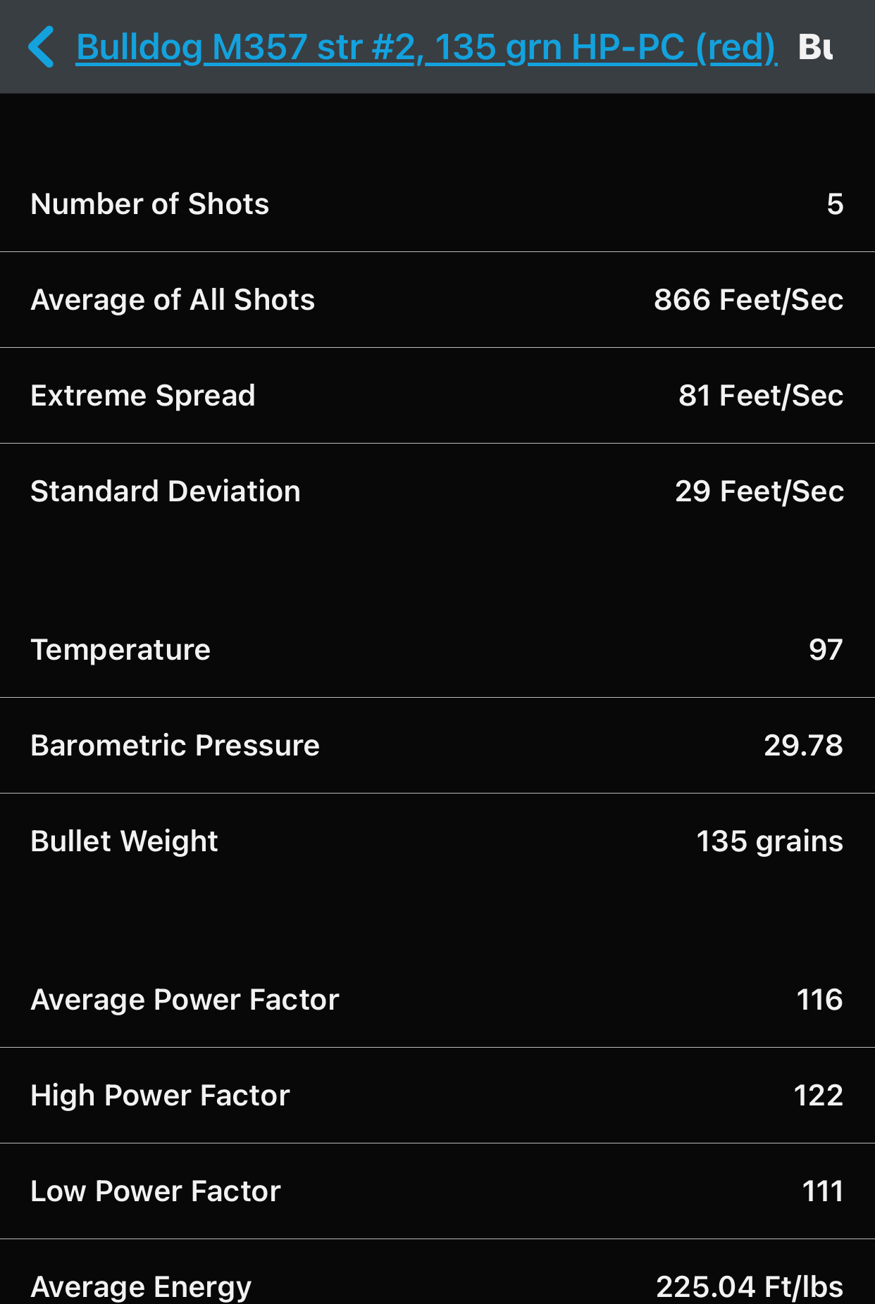

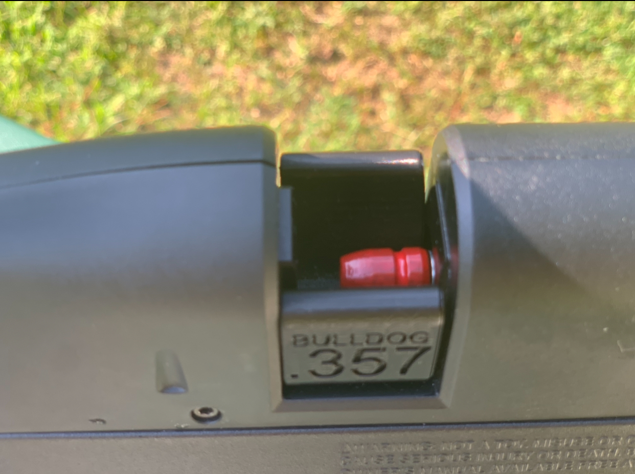

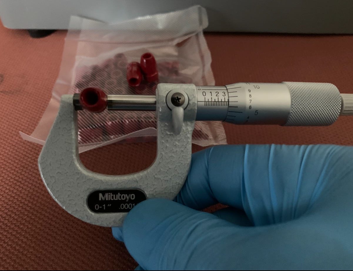

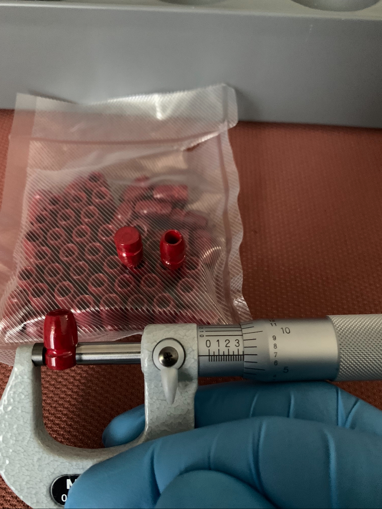

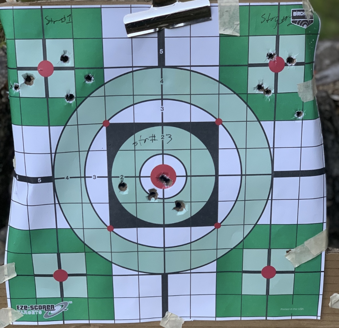

Now for some of the slugs that @Greg_E sent. First up I shot the red powder coated hollow tip slugs. These felt more 130-135 grain, but I can’t recall the weight I was told. I’ll have to review some old messages and weigh them. They mostly measured .357 in diameter. I measured the diameter of 4 slugs.
Shot a couple groups from my M357 using a single-shot tray. At first I shot from a Caldwell Lead Sled, but I ditched it for my Caldwell Turret Rest because the turret is more comfortable for me to use.

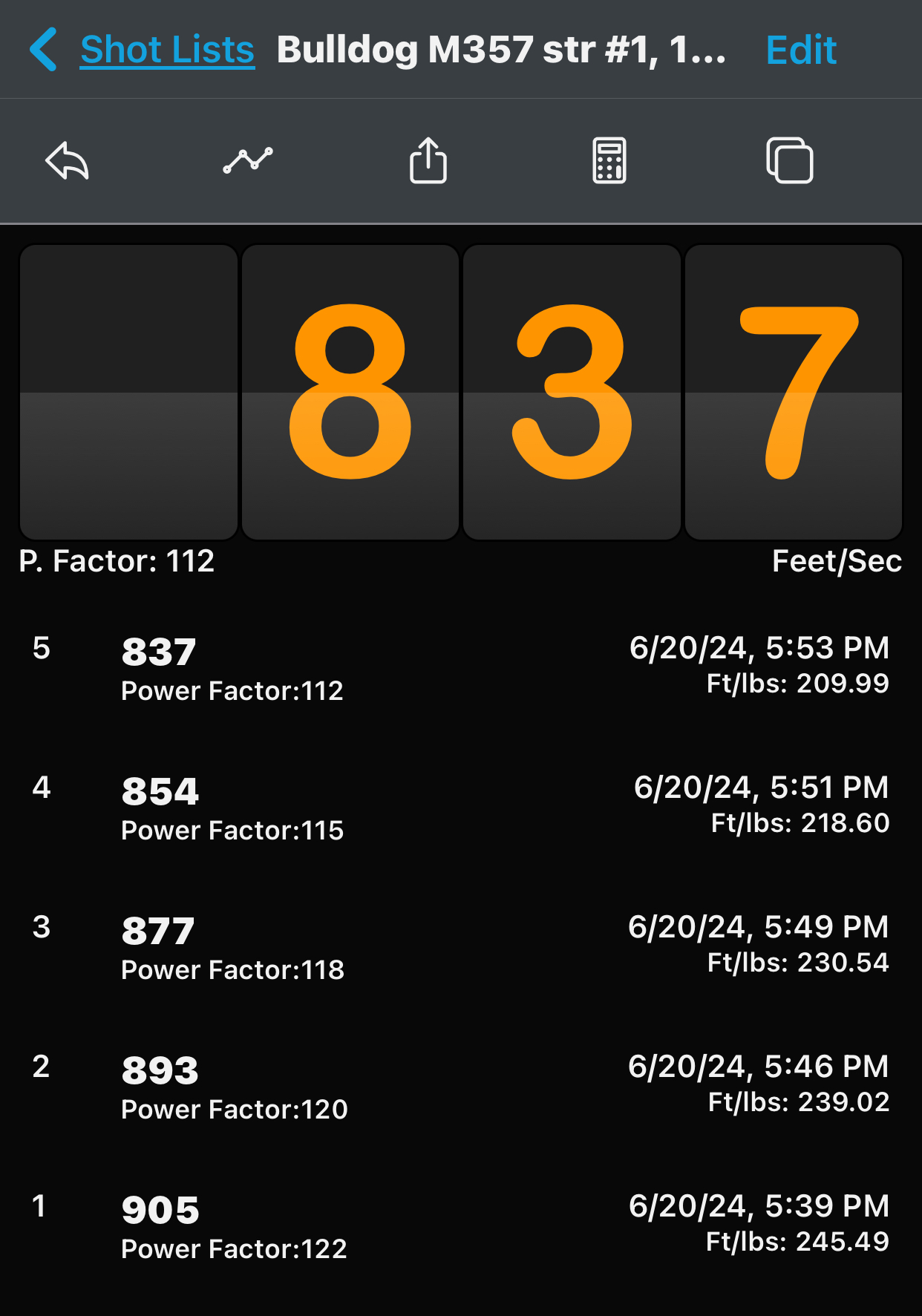

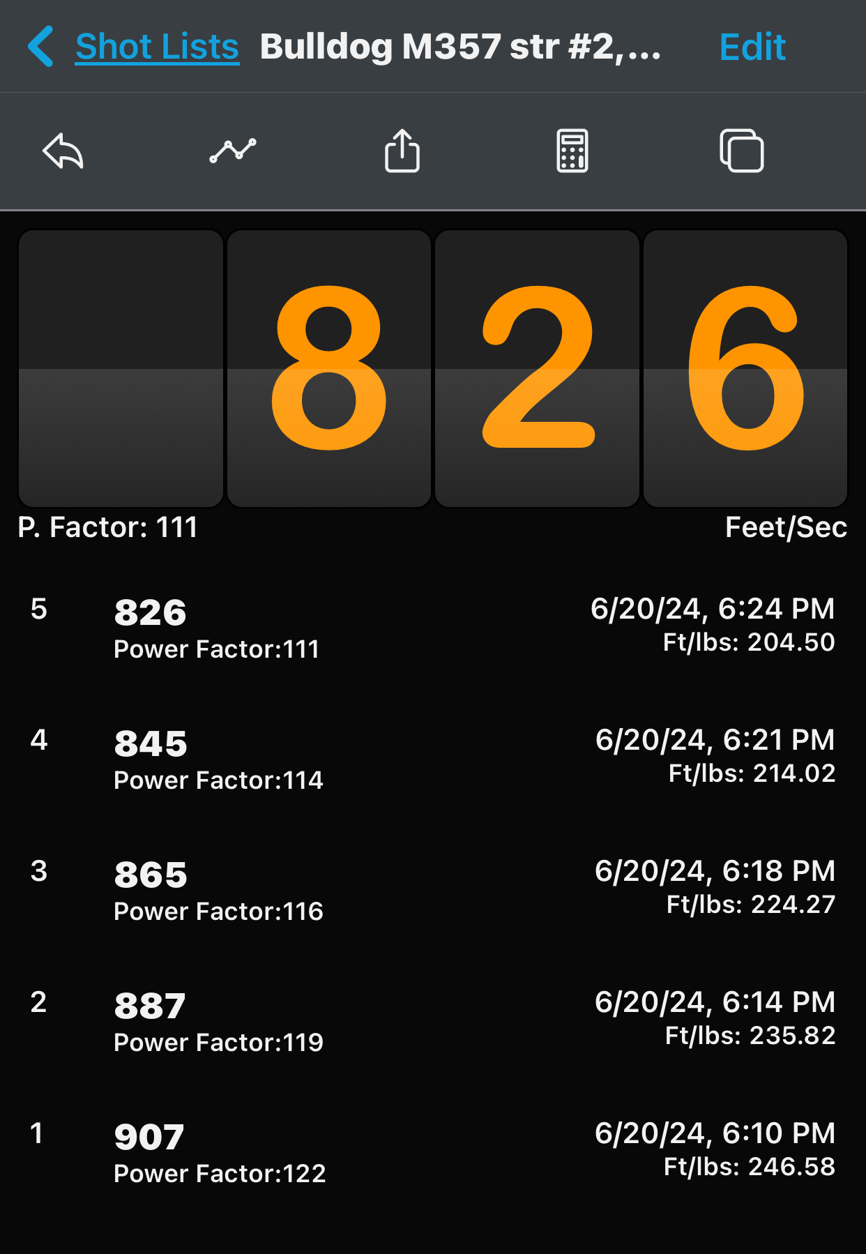

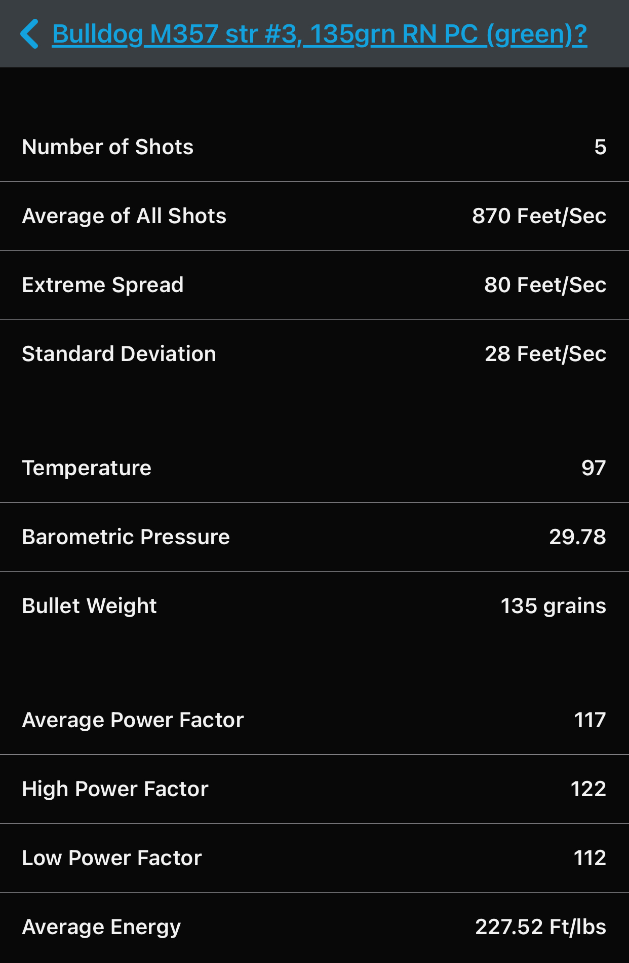

Some shot string data. I entered the weight as 135 grain. I need to verify this.
I was not able to get these to group well.
This is embarrassing.

A shot string

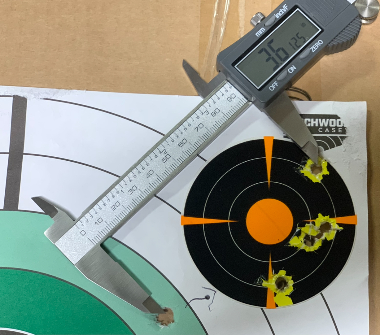

Still working with these 158 grain SWC-HP slugs. A sample size of about 10 slugs from a new batch measured .3575-.3585 in diameter. No chronograph or tables. Shooting off of a bucket and using Primos trigger sticks bipod at 50 yards. Shooting untethered and from the magazine. They fit nicely in the mag although the dry lube gets on and in the mag. I figure a toothbrush can be used to clean it. Anyhow, I had to check my DOPE, adjust my scope, and figure my holds for various pressure levels. So far the best group of the day.

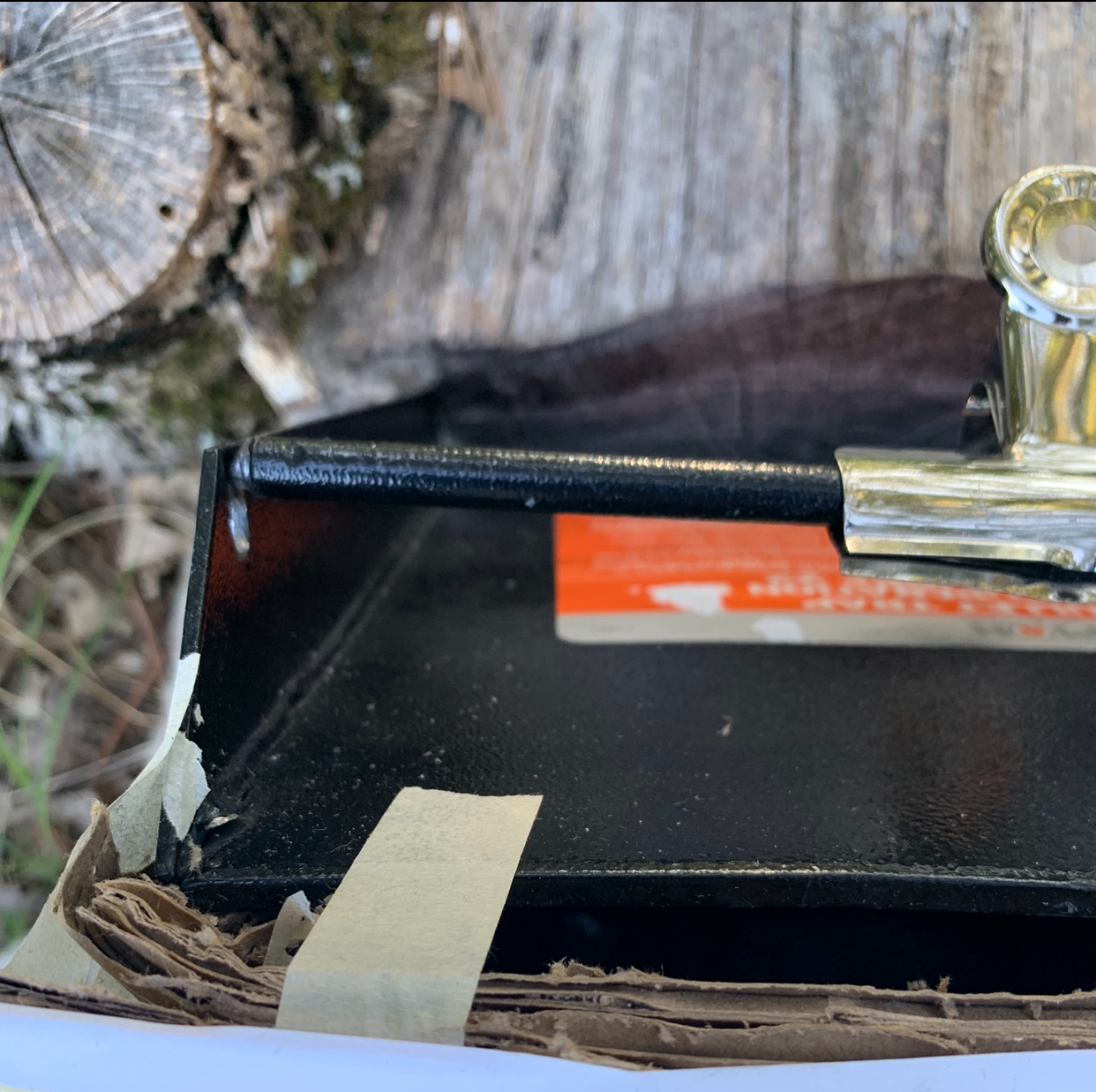

Here’s that entire target. Not sure what happened to the 5th shot on the bottom two. I heard them strike metal. In fact I’m tearing up my trap. I’ve broken some welds. These hit pretty hard.
You can see the weld on the left side is of the bar is broken and the back plate of the trap is getting dinged up pretty decent. If you look closely at the edge of the rear plate it has a hump from a number of hard hitting impacts high on the plate. Also the seam on the left is separating (below the piece of tape). Time to get this welded up when I empty it.
The group measurements where I could find 5 holes. This ain’t YouTube. I admit it, I'm not a great shot. I don’t throw out shots and give you a long speech about “what if” or “I had a mosquito biting my balls when I took that shot.” I love to hunt and all sorts of stuff happens on the hunt (yes your balls can get bitten or worse). We gotta deal with it the way that it happens. If I threw or pulled the shot or if I didn’t clean my barrel, that’s on me. This is real world stuff and I am liking these bullets!

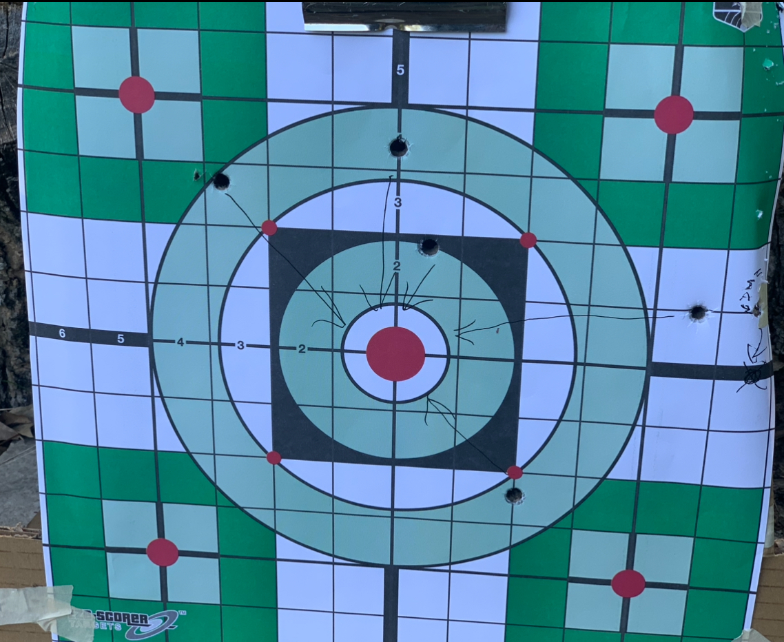

I was able to work for about 50 minutes standing shooting from behind my Primos Trigger Stick bipod. I only got around to shooting the no-longer-produced 140 grain hollow-point boattail slugs by Griffin Airgun Ammo. At first I held dead center with settings I’d adjusted from my 50 yard zero. I still have to review my DOPE. My shots were consistently hitting right about 1”-1.5” and I threw a few shots being impatient. Real-world target. This was not a good result, but I felt like sharing anyhow. It should at least serve to contrast how I expect these slugs to perform (based upon their performance at 50 yards and things I’ve read) once I get have time to work on this some more and am properly prepared. I can’t guarantee these slugs will do what I want out to 100 yards, but I saw enough in this session to have an idea of what to expect.
10 shots from the magazine. The marked shots are from the first mag. I started holding dead center on the fist shot which is the lowest. Then I tried holding over when I thought I should be and the second shot hit too high. By shot 5 I was closer to where I wanted to be.
On the second mag I adjusted the elevation on my scope some until I realized that I didn’t recall the reticle subtensions.

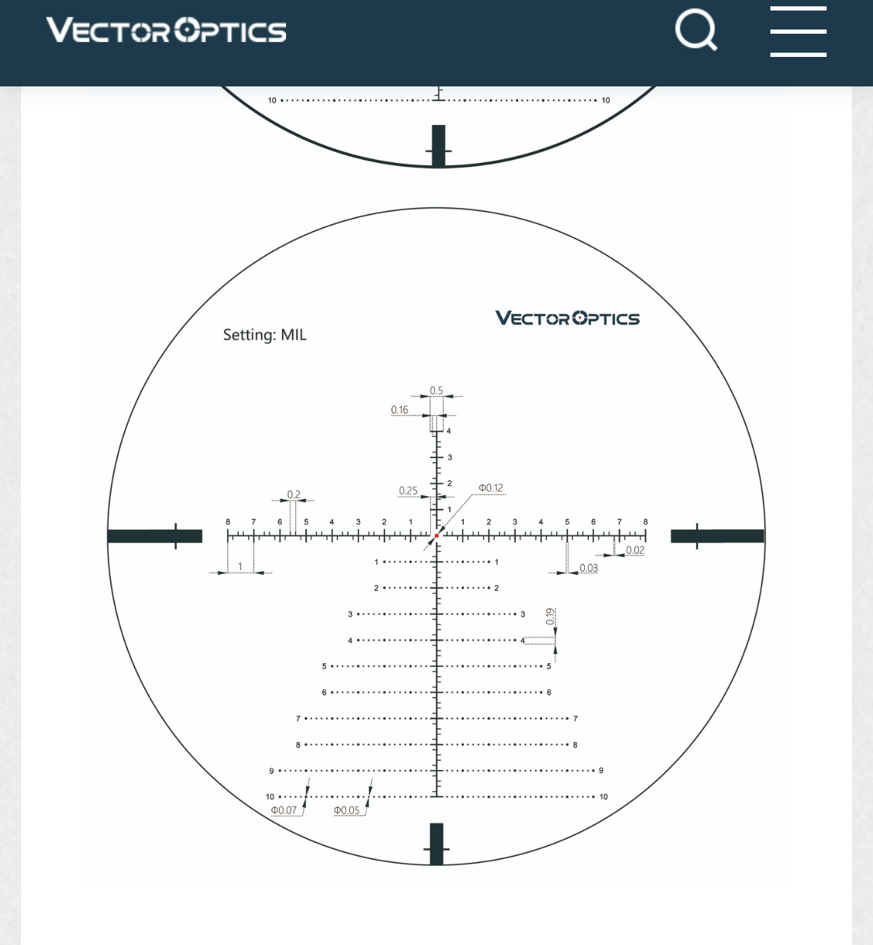

Edit: Below are the subtentions. Apparently there is 0.2 mil distance between the hashmarks.
I didn’t want to continue to dial guessing how many clicks to adjust the elevation so I continued to shoot using holdovers. Lackluster performance, but I know how I want to approach this next time out. Until then……
