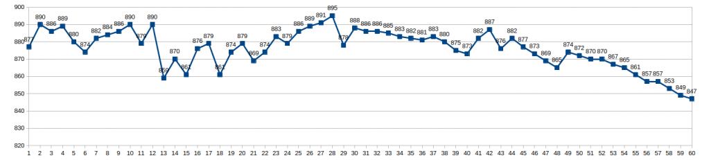

Second set from Benjamin Cayden, 18.13 grain JSB Jumbo Heavy. (3000-1800 psi, 60 shots)
1-12 (874-890) - Extreme spread, 16 fps
13-24 (859-883) - Extreme spread, 24 fps (something is wrong here, several are abnormally low).
25-36 (879-895) - Extreme spread, 16 fps
37-48 (865-887) - Extreme spread, 22 fps
Summary high of 895, low 865 with extreme spread of 36 fps for 48 shots.
Something was wrong with shots 13-24, because all 12 were abnormally low for some reason. Shot 49 was 874, where as shot 13 was only 859.
49-60 (874-847) - Extreme spread, 27 fps.
Total 60 shots high 895, low 847 extreme spread 48 fps.
I feel confident that with sorted pellets the Cayden is capable of 50-52 shots with extreme spread of 20 fps or less.. Unsorted it should easily do 48 shots with an extreme spread of 25 fps or less.. (already been done)..
My friend bought one at the same time as I did and his is more powerful, shooting about 20 fps faster than mine but with much fewer shots.. He shoots 40 shots with extreme spread of 60 fps and I shoot 48 shots with extreme spread of 24 fps and 60 shots with an extreme spread of 48 fps. Mine is about 32 fpe and his is about 33.5 fpe..
He has shot his Cayden with ¼ inch groups at 40 yards, I have not yet tested mine, (very cold and bunch of snow).. Hoping mine is also accurate.. I feel optimistic that it will be accurate and serve me well..
I am very happy with my Cayden as it shoots 18.13 grain pellets mostly in the mid 880’s, and I am cool with that.. I paid $390 for mine, and am pleased about that too..
