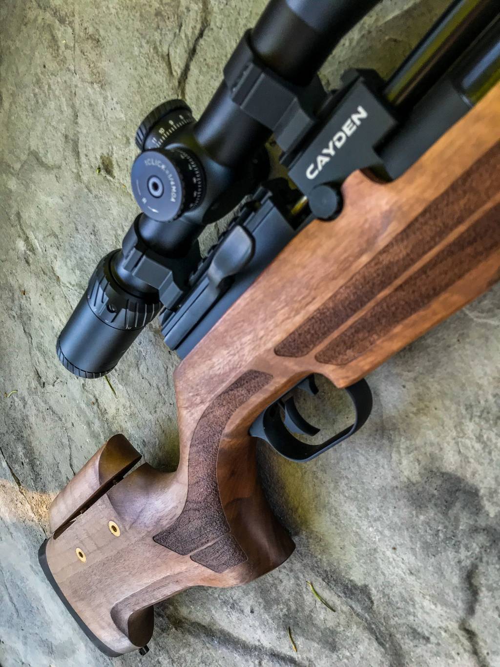

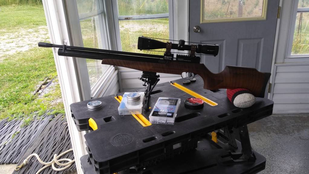

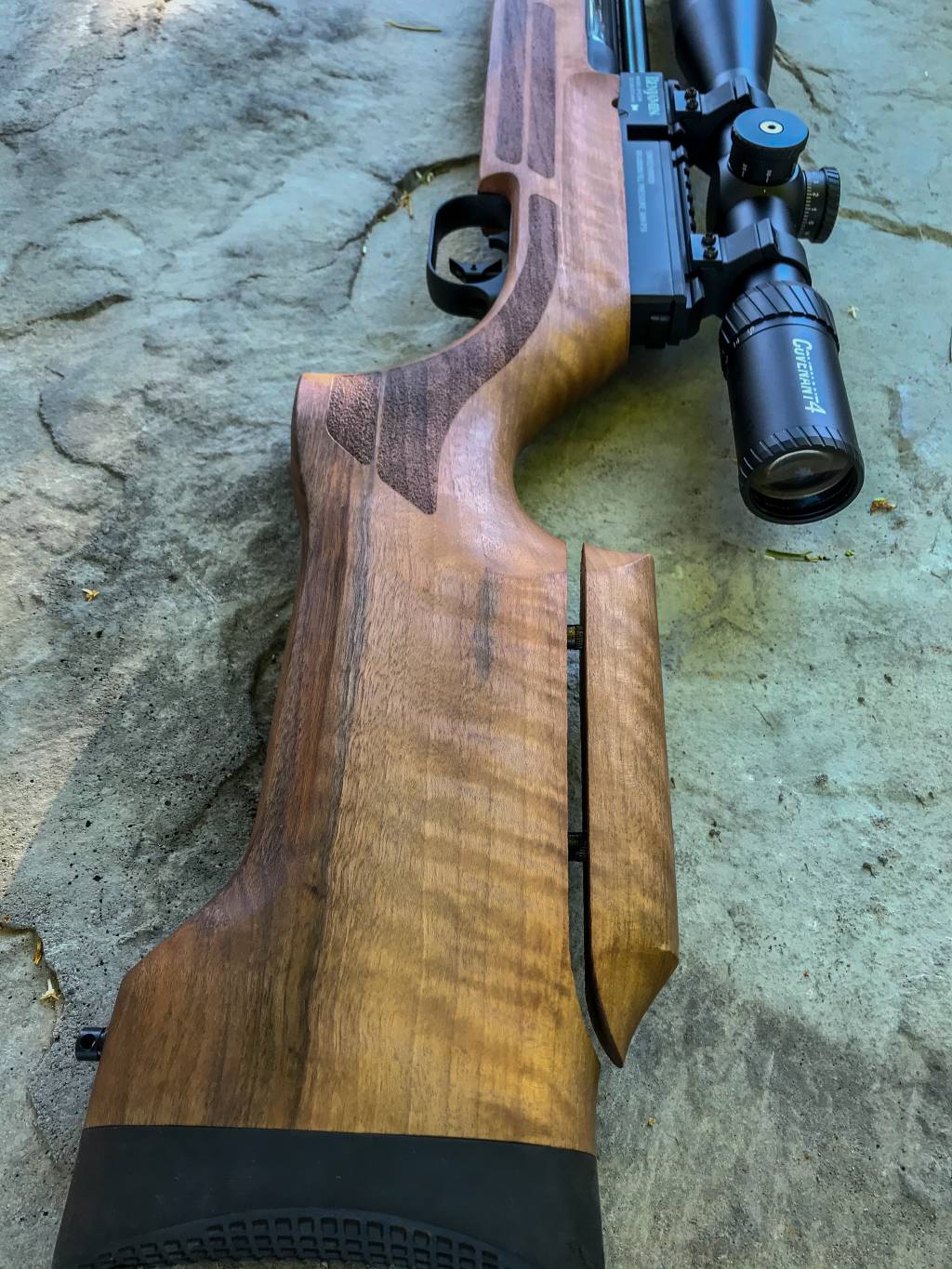

Recieved the Cayden last week from Crosman. What beautiful wood!!! So happy with the craftsmanship on this. The excitement of anticipating what the wood grain is going to look like while waiting to receive the craftsman series rifles is like waiting to check a lottery ticket. I’ve been anxious since I ordered it Hahahaha! This one has tiger striping in the wood that appears when looking from front to back in the light. Tried to get a picture but they do it NO justice. It’s gorgeous and I wouldn’t sell it back to them for 100 bucks more than I paid.

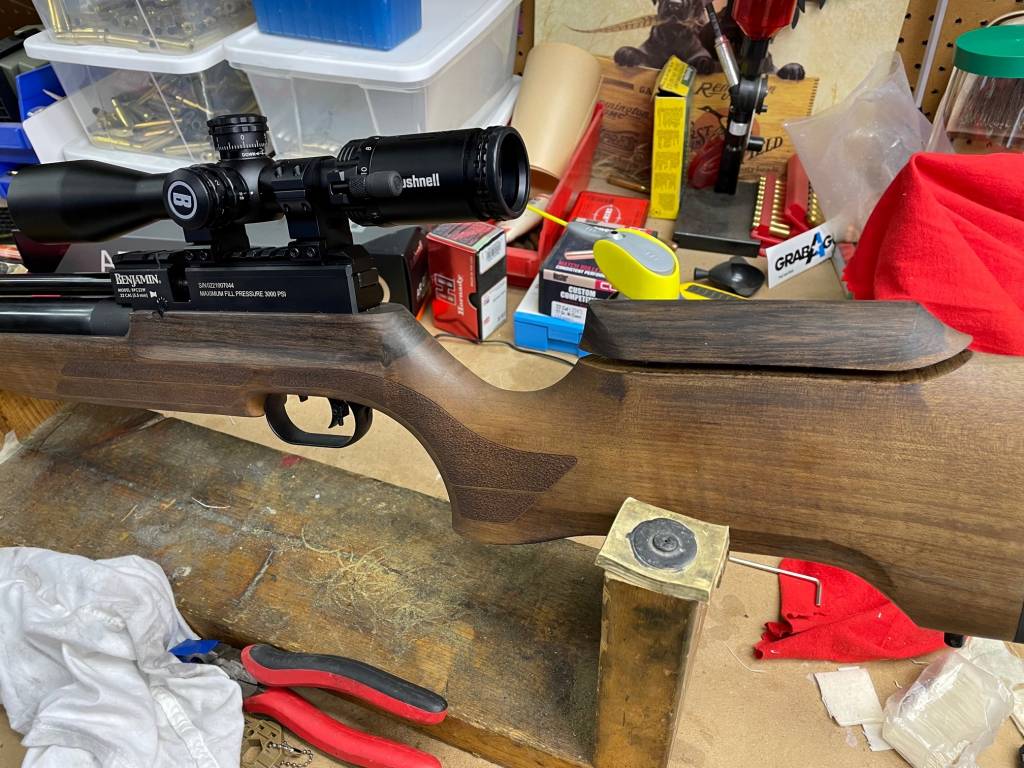

So long as we have resurrected the Cayden discussion lets take a second look at the ‘non adjustable trigger’ according to the factory other than the trigger shoe. Obviously there are no holes in the trigger guard to allow a hex wrench to go anywhere. But if you remove the action from the stock and remove the now exposed trigger sideplate you will find hidden in there two adjustments that can be made for both the first and second stage pull. Firstly at this point, slide out the moving parts of the sear and stone hone and then polish the contact points for perfect fit. Replace the high tension trigger return spring with a lesser one. Having tuned mine to personal preference I have eliminated the first stage and tuned the second stage (now the only stage like on a fine target pistol) to a 11/4”lb crisp let off.
