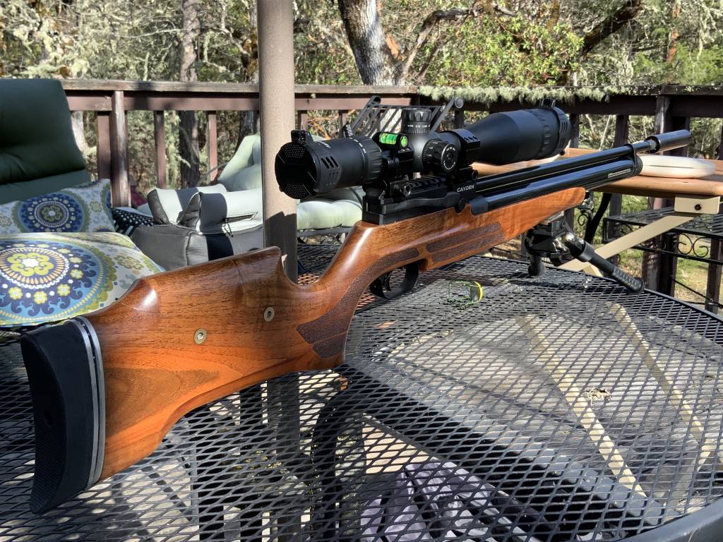

I added an adjustable butt plate butt plate.,and the donny sumo. Both additions were awesome!
Is that a monopod on the butt? That's pretty cool.

So long as we have resurrected the Cayden discussion lets take a second look at the ‘non adjustable trigger’ according to the factory other than the trigger shoe. Obviously there are no holes in the trigger guard to allow a hex wrench to go anywhere. But if you remove the action from the stock and remove the now exposed trigger sideplate you will find hidden in there two adjustments that can be made for both the first and second stage pull. Firstly at this point, slide out the moving parts of the sear and stone hone and then polish the contact points for perfect fit. Replace the high tension trigger return spring with a lesser one. Having tuned mine to personal preference I have eliminated the first stage and tuned the second stage (now the only stage like on a fine target pistol) to a 11/4”lb crisp let off.
I did the same on my Akela but with less success due to the excessive linkage needed to make it a bull pup.
Works for me..
