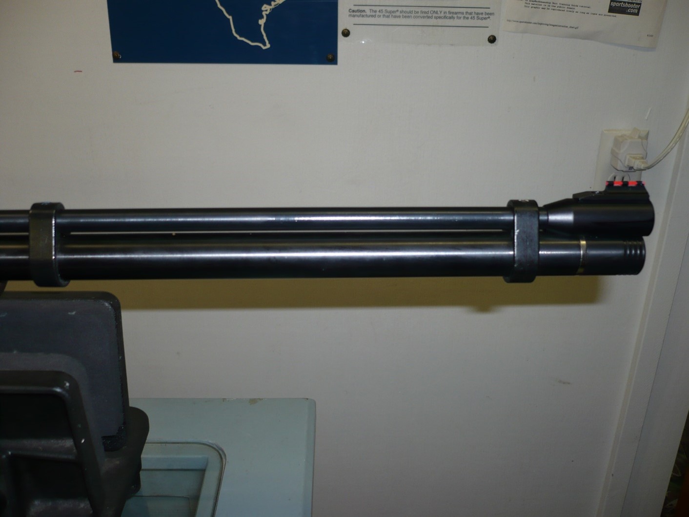

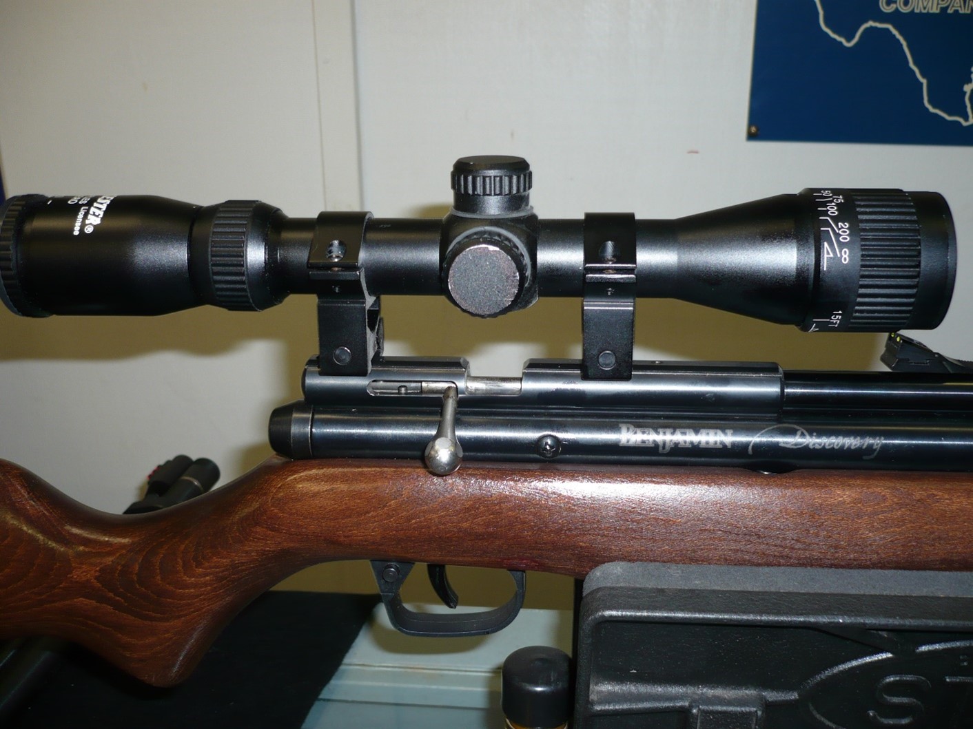

I identified 3 areas during the initial field test that were needed, for both units to meet my goals, (1) - scope (2)- trigger work and (3)- 2nd. barrel band. I chose the Winchester branded 2x7x32 AO Scope, did the 3-screw mod to trigger and set at 2.25 lbs. (info available on the net) and installed a second barrel band purchased directly from Crosman. There are pros and cons about second barrel bands. I fall in the Pro group; there was some slight movement at the muzzle end of the barrel, at least on my units, so I chose to eliminate this with the 2nd. Barrel band, I installed the band and after cleaning both band and lock set screws, and using Blue lock tight, tightened just enough to prevent movement of barrel, no more!!

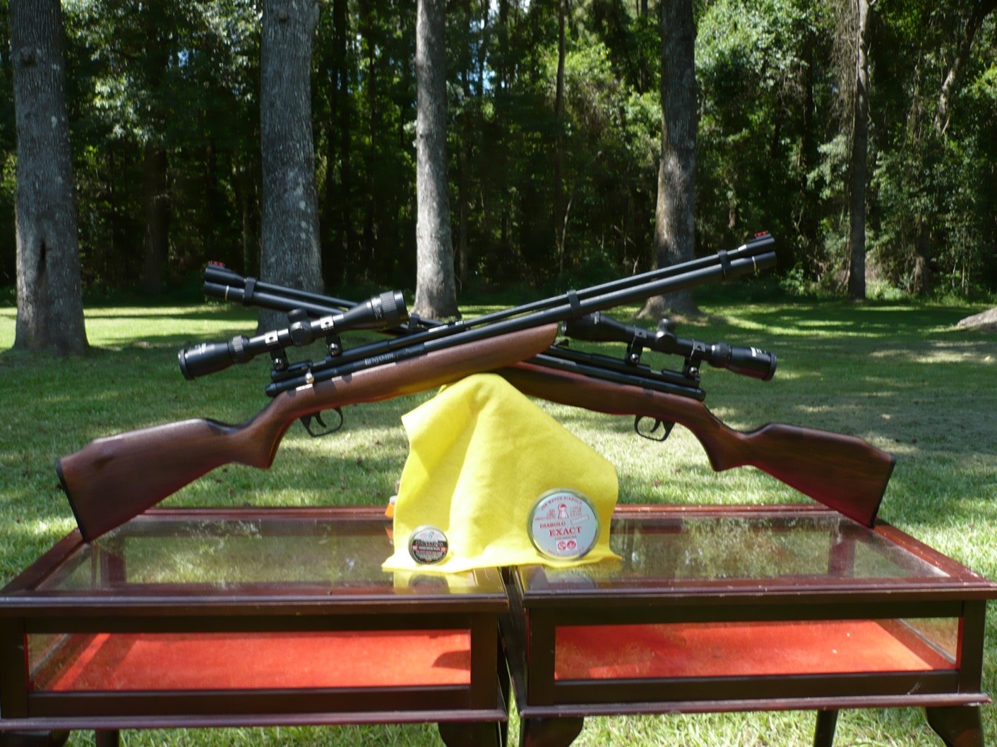

I find myself reaching for the Discovery units now, giving the 60+ year old 113/114 units a well-deserved rest!
