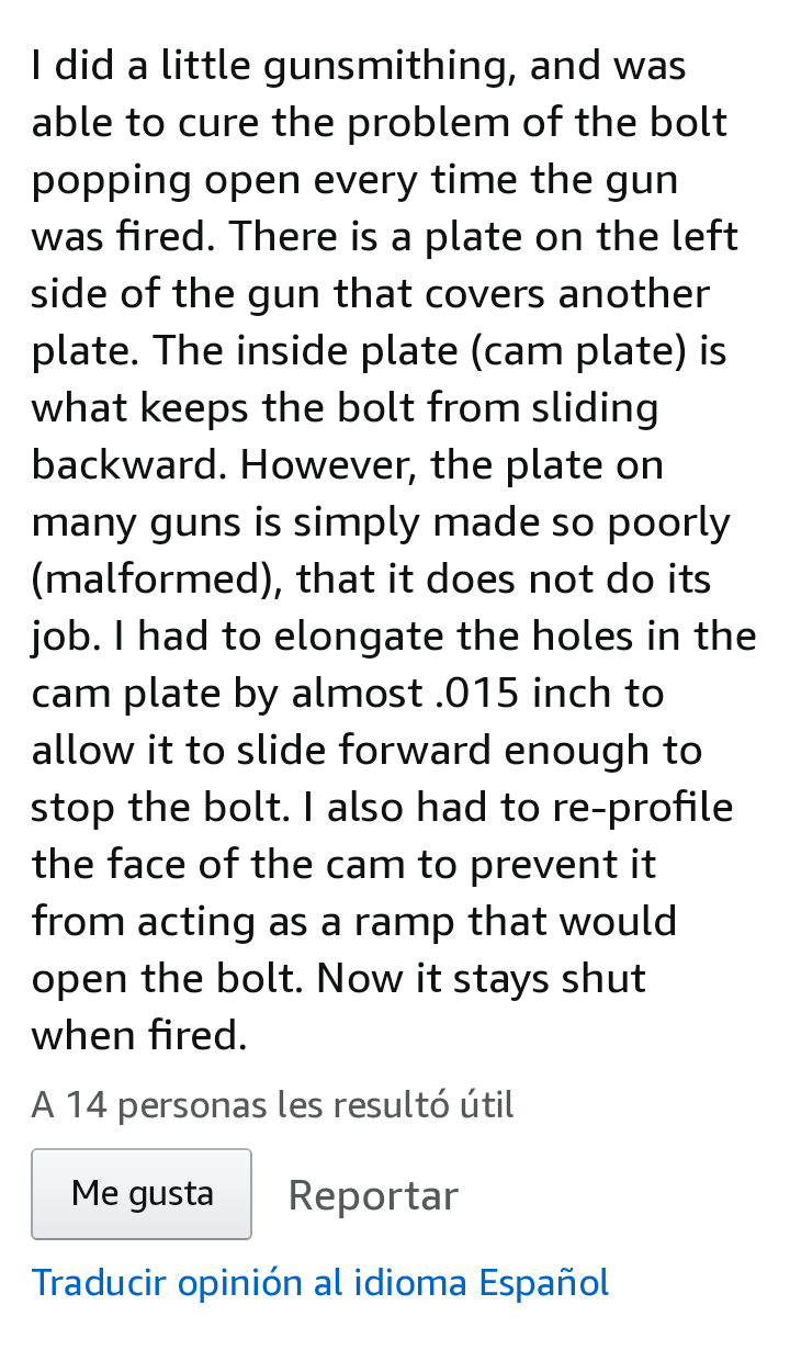

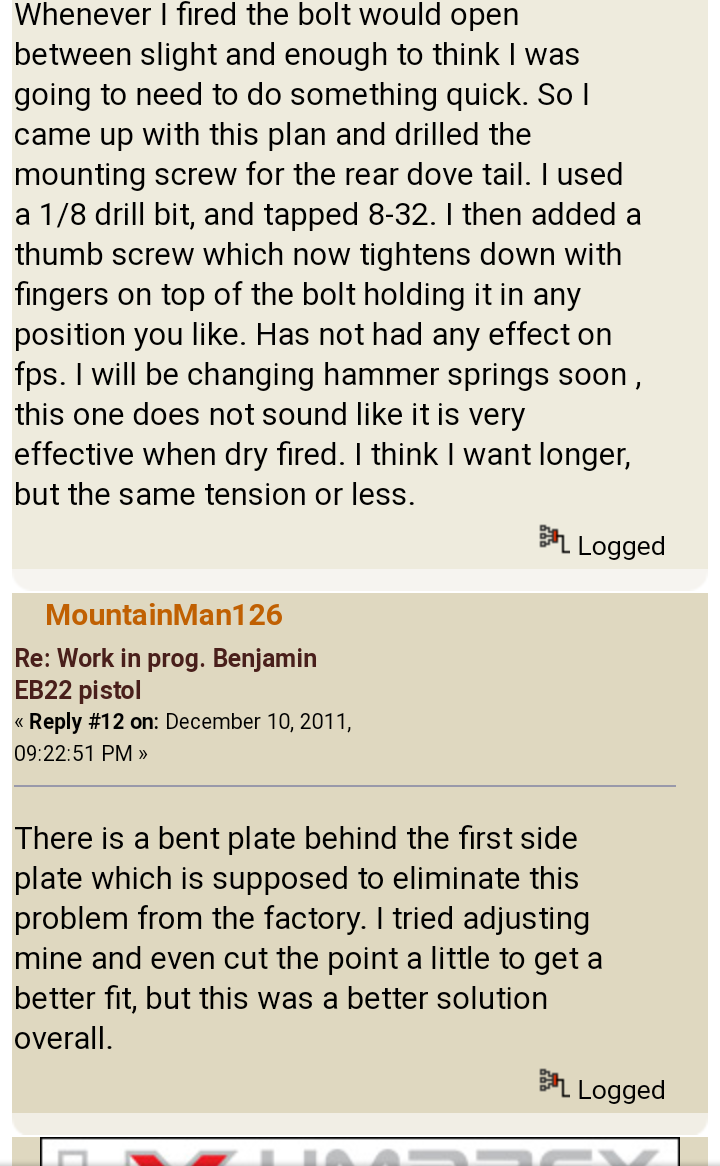

Any know how to fix this? Looks like the same bolt as the hb pistols.
B Bocephus Member Jan 5, 2018 165 55 Hokes Bluff, Alabama, United States Mar 11, 2021 Add bookmark #1 Mar 11, 2021 Add bookmark #1 Any know how to fix this? Looks like the same bolt as the hb pistols.
Odoyle Member Aug 28, 2020 8,340 157 Excessive Flatulence, United States Mar 11, 2021 Add bookmark #2 Mar 11, 2021 Add bookmark #2 SEE bottom suggestion - Upvote 0
B Bocephus Member Jan 5, 2018 165 55 Hokes Bluff, Alabama, United States Mar 11, 2021 Add bookmark #3 Mar 11, 2021 Add bookmark #3 Thank, I’ll give this a try this weekend. Upvote 0
