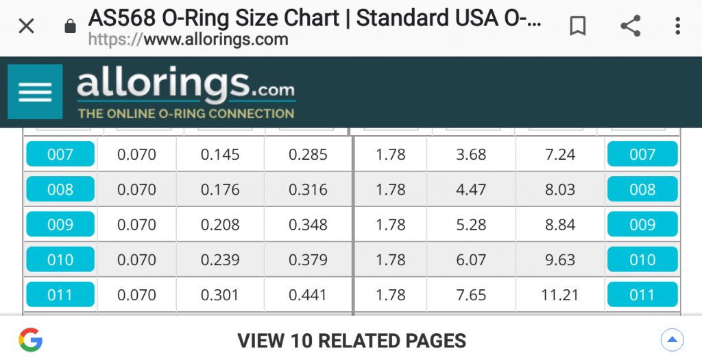

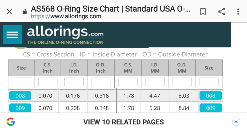

If you have some calipers, measure your bolt probe. If it's close to 0.176", use a -008. If it's close to 0.208", use a -009. Go with either either polyurethane or Buna-N. 70 durometer is the safe bet.

Oh! A -006? It has an ID of .114" which is WAY undersized. I suspect what you call "feel the friction every time I use the bolt" doesn't quite do it justice. The nearest dash size that would generally be used for .177 cal is a -008, two steps larger than the one you have in there now...and a world of difference in terms of fit down at the bottom end of the sizing spectrum.
But since Crosman is apparently using metric, I would order some M1.5 x 4 and some M1.5 x 4.5 in 70 durometer and try each one.
