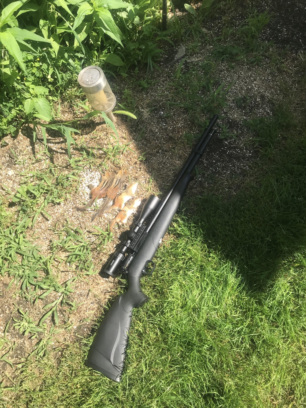

Mine shoots pretty good with Walmart pellets .22 caliber from Crosman. Shoots under .75 groups at 30 yards with no wind.. budget gun for pest control about it.
Matt
I only shoot groups when sighting in as I like to shoot free hand or off my shooting sticks. After reading this I went out and shot a few groups at 40 yards using my bench and sand bags. Polymag shorts shot just under 1" groups and JSB Hades shot .75 very consistently. I'm sure there are pellets out there that will shoot more accurate but since I'm hunting with it I'm sticking with the Hades as it is grouping minute of squirrel.

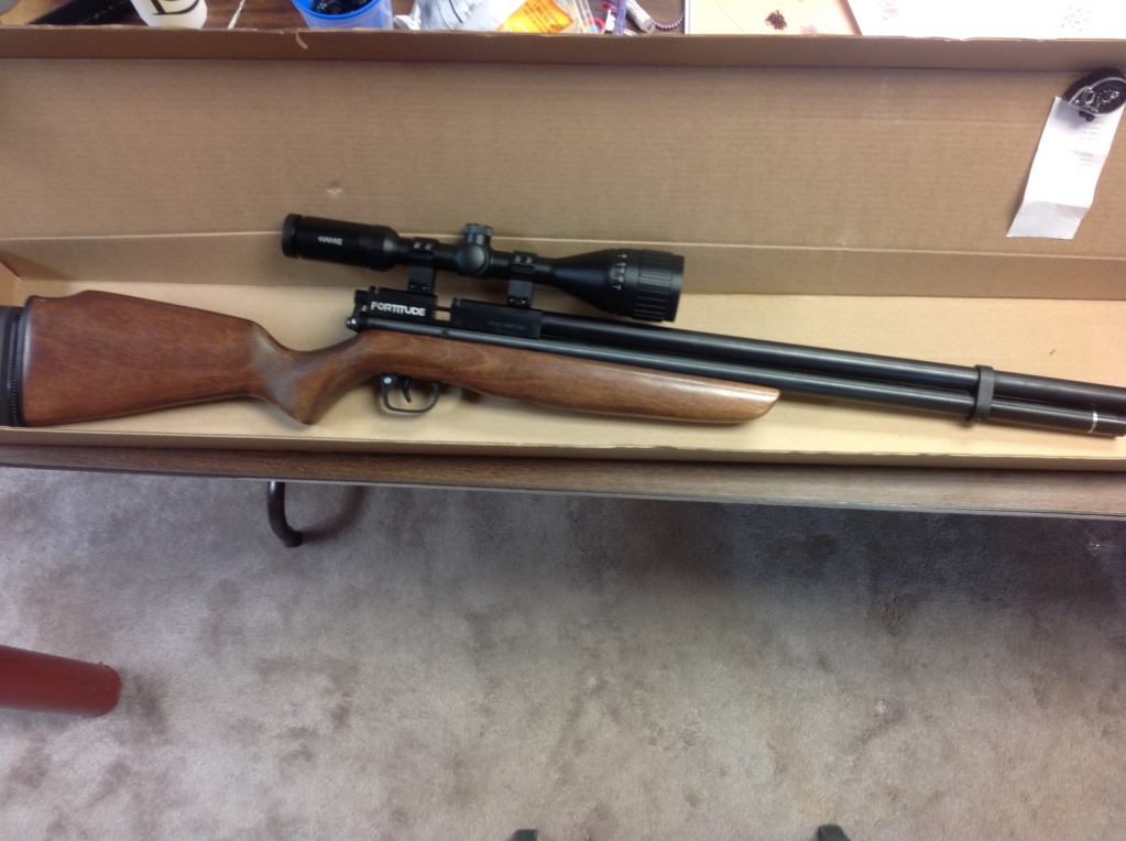

 Mine was shipped on Friday received on Saturday from pyramid air . Ohio to West Virginia two days not bad! thank you Ruth @ PA I also have been waiting a very long time seems like over six months . So here's what I think about the Benjamin Fortitude 👍🏻 For a gun that only cost $299 made in America! Get over 60 good shots! Very accurate at 25 to 35 yards!! Maybe further I love it . When I first got it I shot 50 rounds to make sure it was working OK and it was ! So the first thing I did was adjust the trigger as to Airgun Depot YouTube video( replace trigger spring and adjusted sear Spring )that all . Then switched out the stock with the disco stock that I had (pictures below ) then I went shooting maybe 250 rounds of pellets Crossman 7.9 g /JSB match 7.87 g and JSB EXACT 8.44 But JSB 7.87 we're the best for me the 25 yards one hole & @ 35 yards less than a half inch ran out of daylight so I couldn't shoot any further ! One thing about the JSB match Diabolo 8.44 did not fit the magazine all that well seemed that the skirt was a little wide some I had to push-them in Mag ? But were very accurate . My Fortutude is shooting at about 850 ft./s in .177 ( see picture below ) it is backyard friendly but not quiet , sounds somewhat like a cap gun not bad but not super quite as far as the gun goes the bluing looks great , breach nice all but the air tube is a little bit off . Also the bolt is a little bit stiff seems like the hammer could be polished I also don't think I would pay for a new trigger of any sort / adjust the one you have I don't think it's worth putting the extra money in it , once you adjust it it's fairly good👌 all things considered great airgun

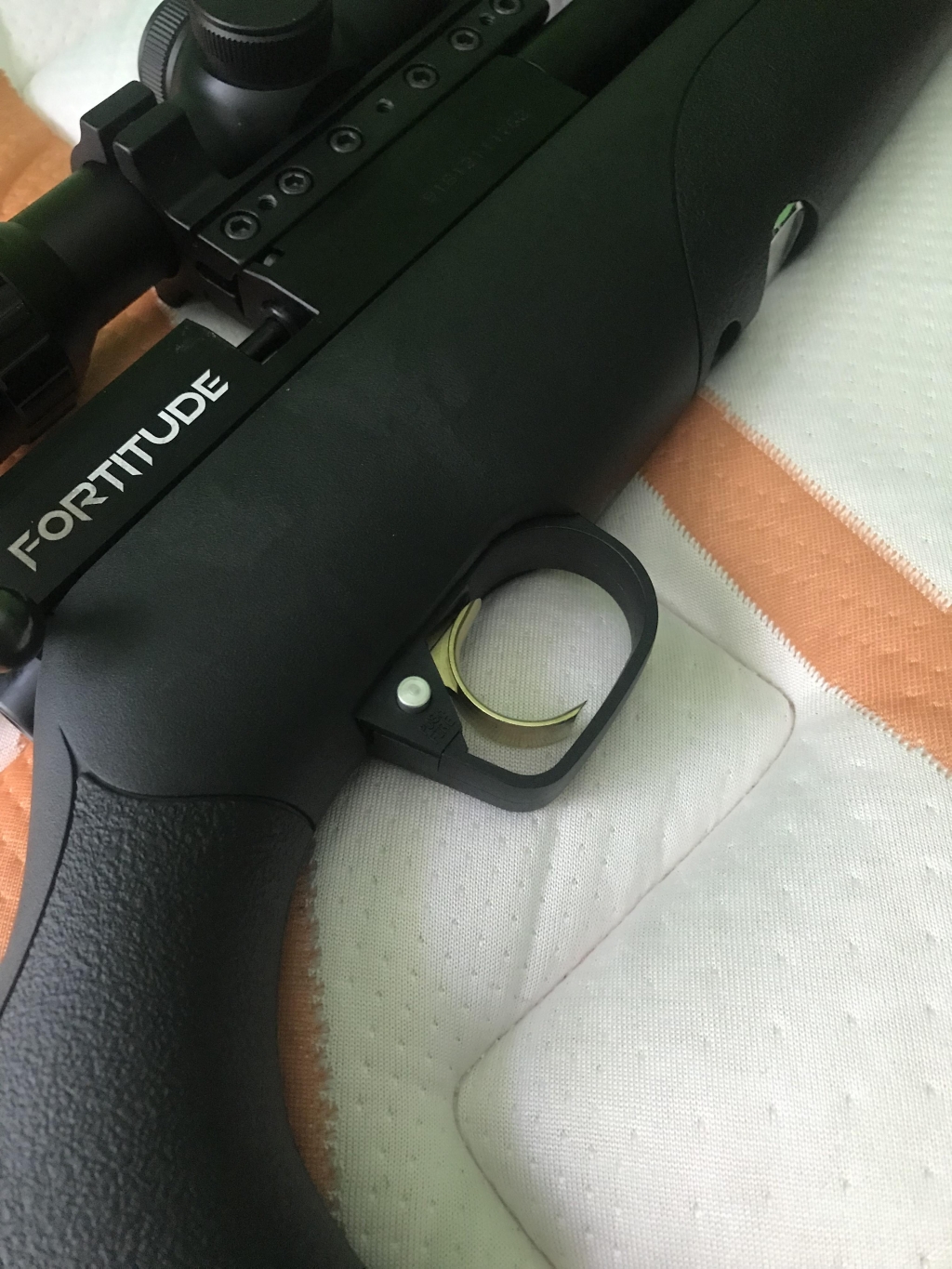

I finally got my Baker metal trigger installed. I could have gone Crowmans route and just adjusted the plastic trigger but decided it was worth it to me to have a metal trigger. The kit came with a lighter spring and two screws for trigger travel. Was able to install in about 5 minutes and am very happy with the results. Trigger is breaking around 2 to 2 1/2 pounds using the "rustynuts trigger guage" which may not be accurate but it's all I have at the moment. Overall, if I had to do it over I would still buy the Baker trigger.

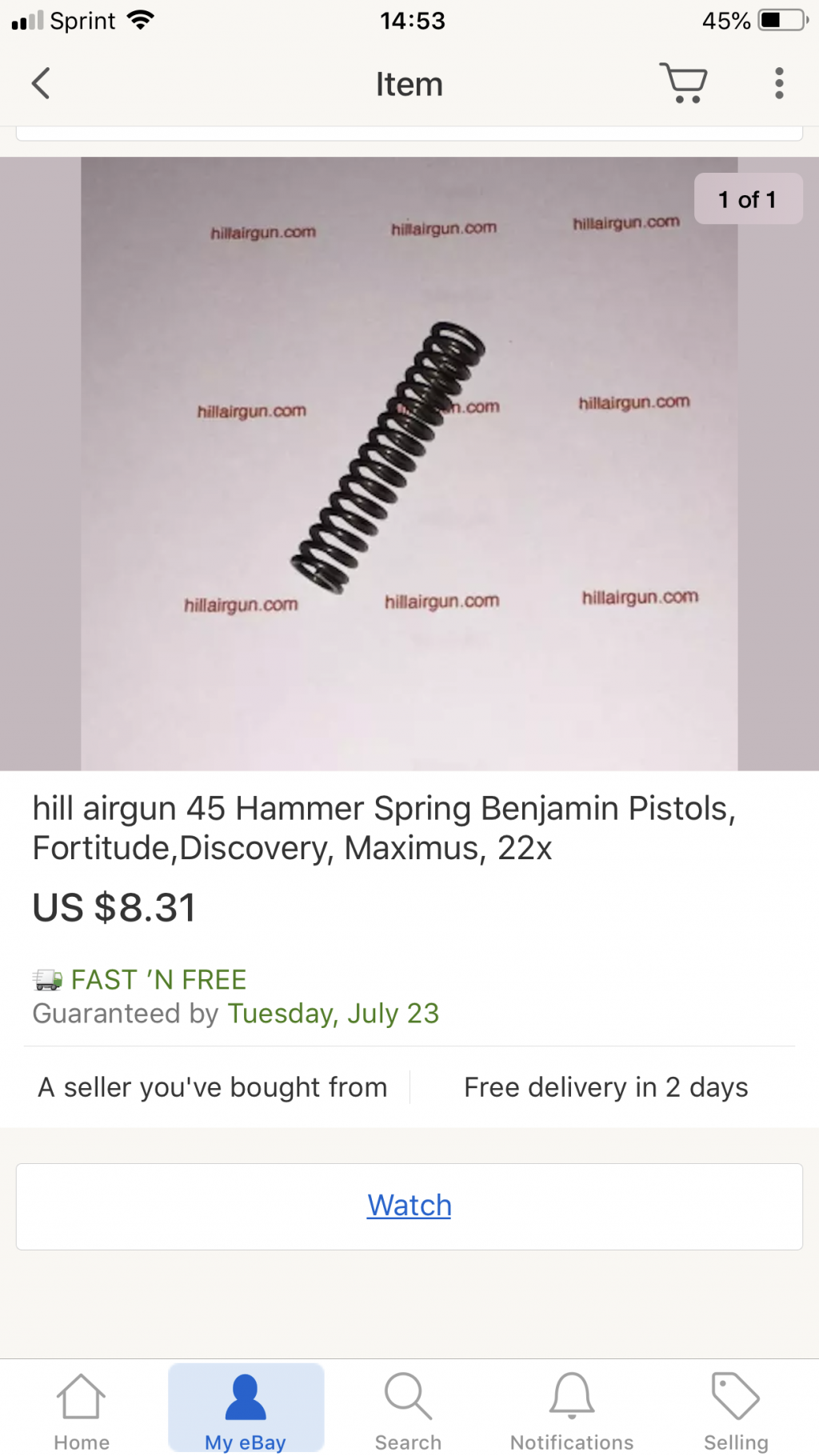

I got the baker trigger installed and tuned, its 100000 times better than Crosman’s trigger. I don’t have a gauge but I’d say 1-2 lb trigger pull now. I also got a Hill hammer spring and I upped the power a little bit. Now my groups at 20 yards and 30 yards are well under .75” 20 yards is usually one hole now. This is with crappy Walmart pellets too. I’ll have to test to 50 yards to see if it holds groups still.
Matt
I got the spring on eBay, I attached a pic so you can search it. The install was very easy just need to remove three screws take the old spring out and install this one. Once you get the action out of the stock remove the screw that holds the trigger block in the rear near the end cap, then just remove the two screws from the breach near the end cap and it’ll come right off. Hope this helps.
