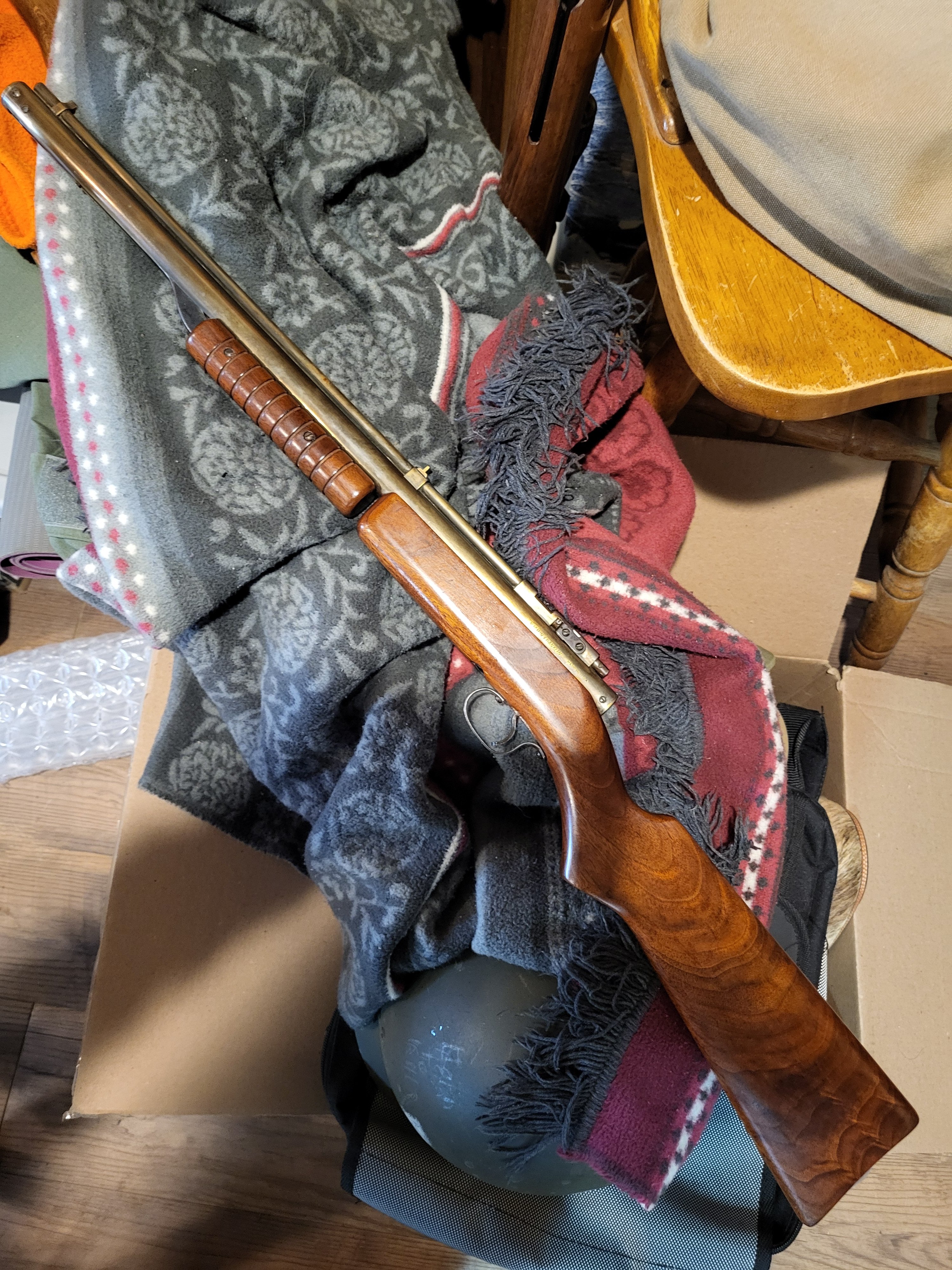

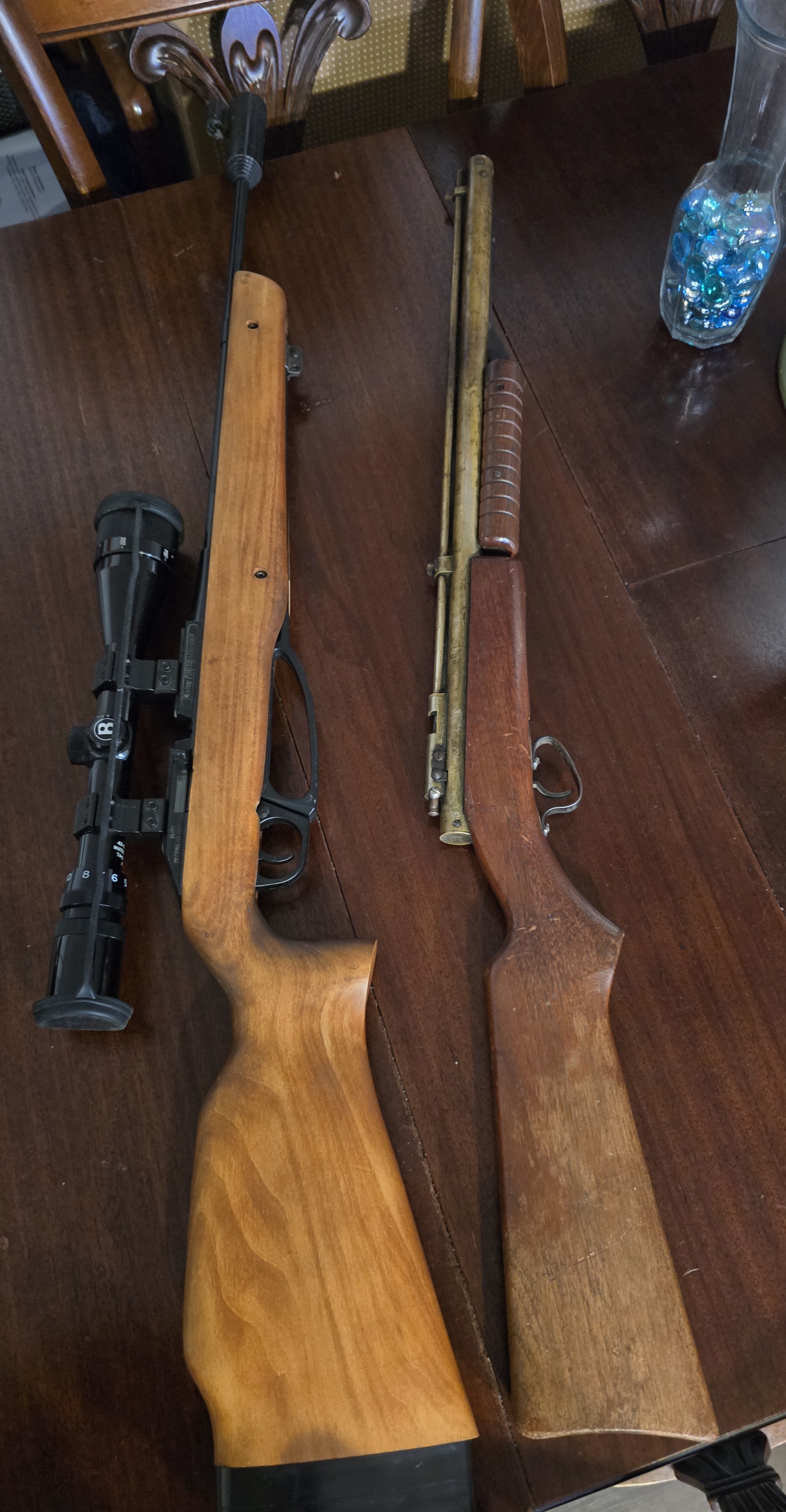

Well, AoA called this guy a 1965 model, but so far in my research, it's looking like an early forties model!

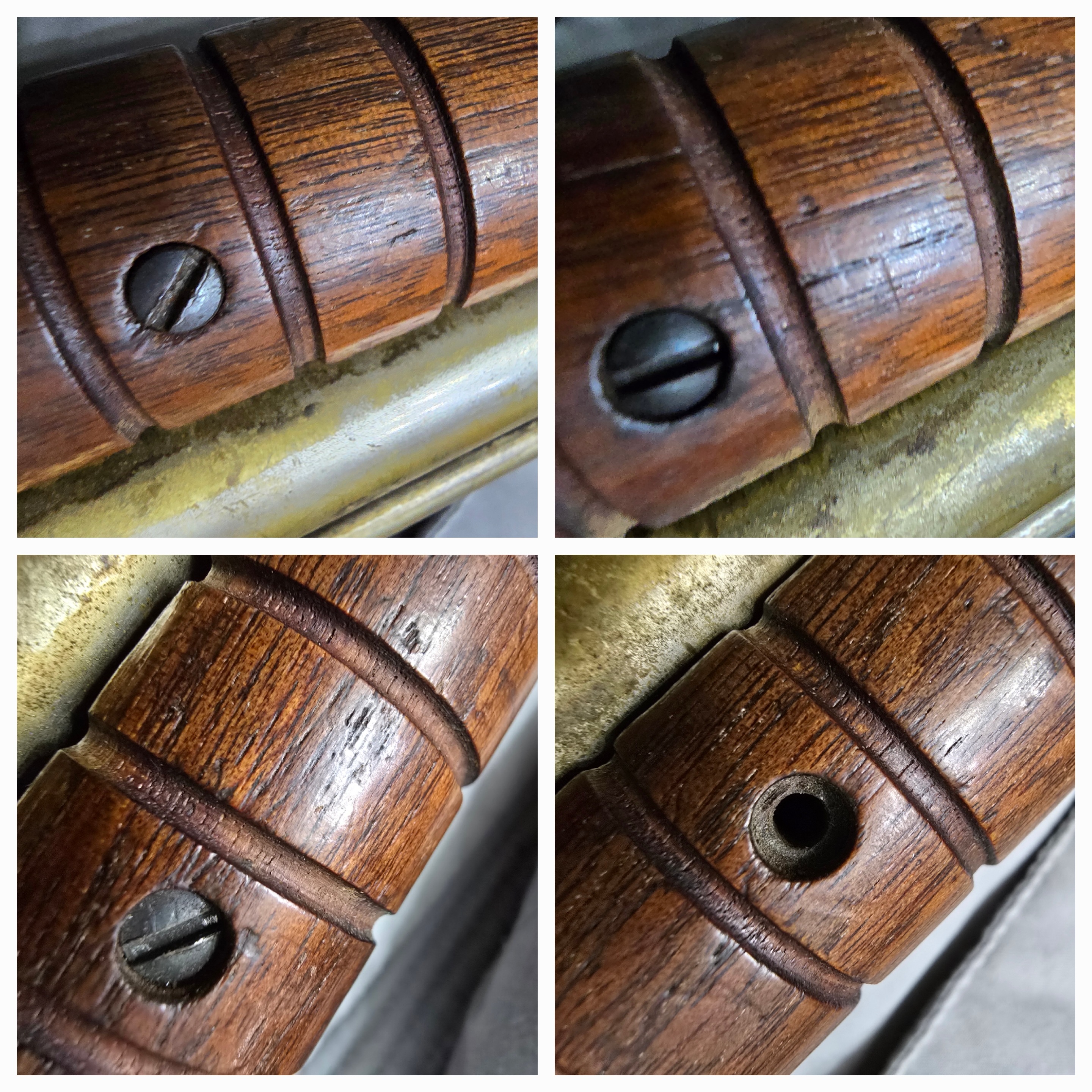

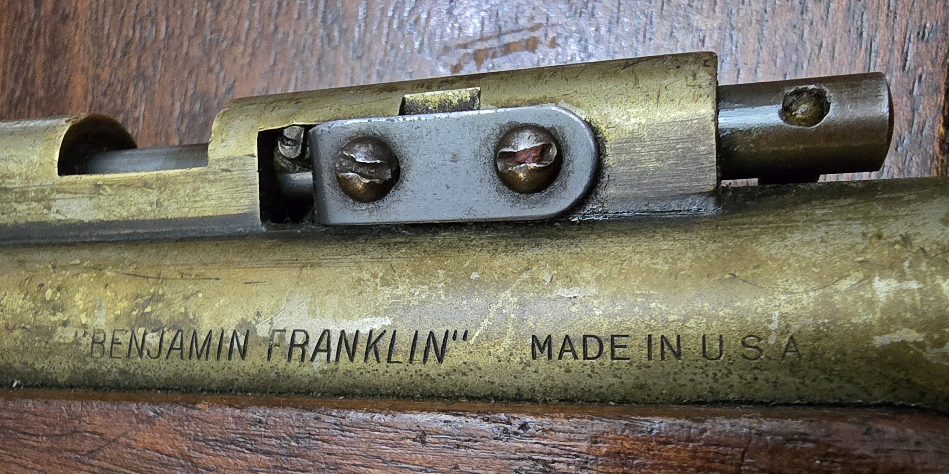

The giveaway is the flatblade screws mounting the Tootsie Roll pump handle.
Also, it seems 317s or .177 models are fewer in numbers than 312..22 cals.

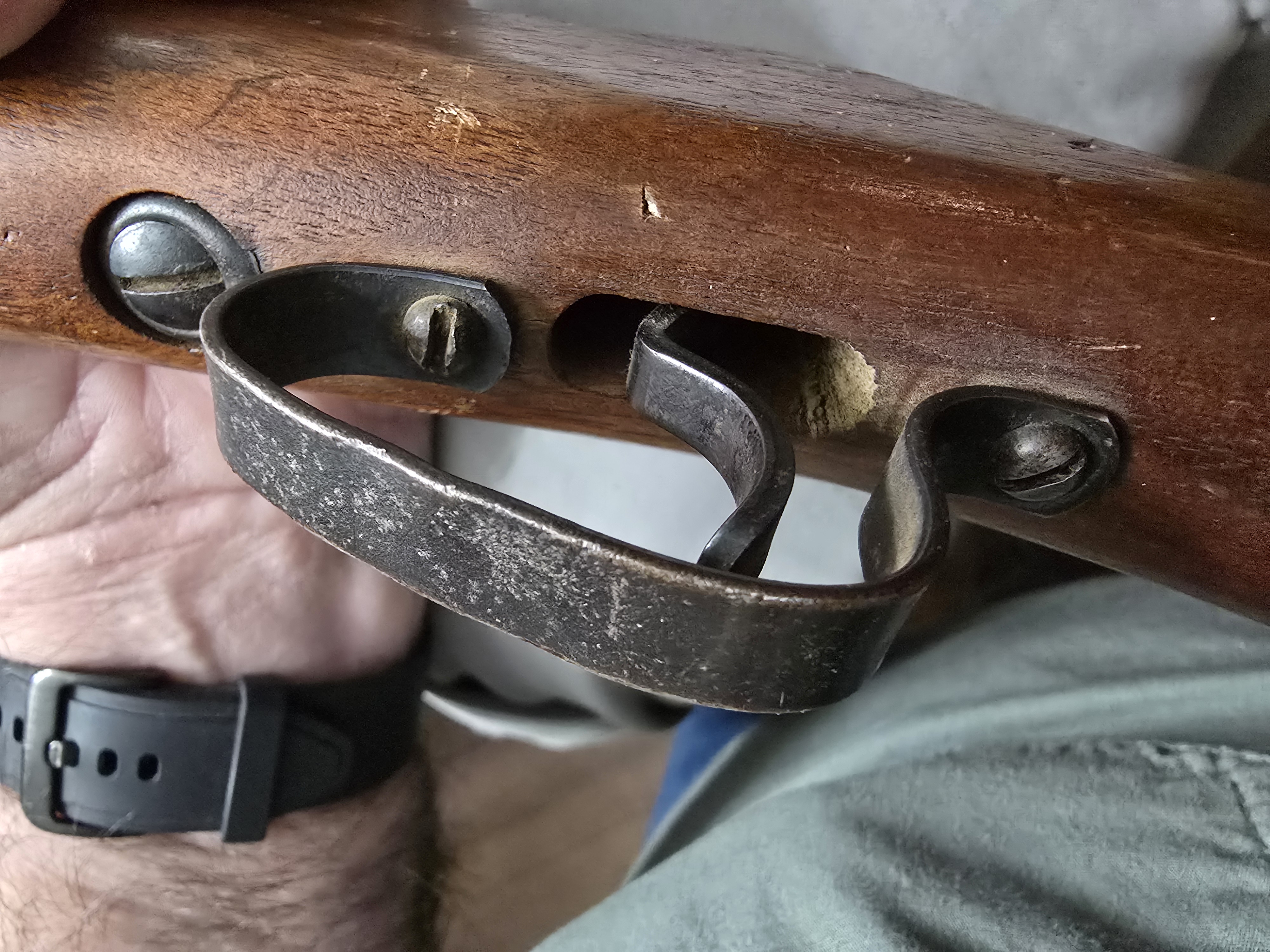

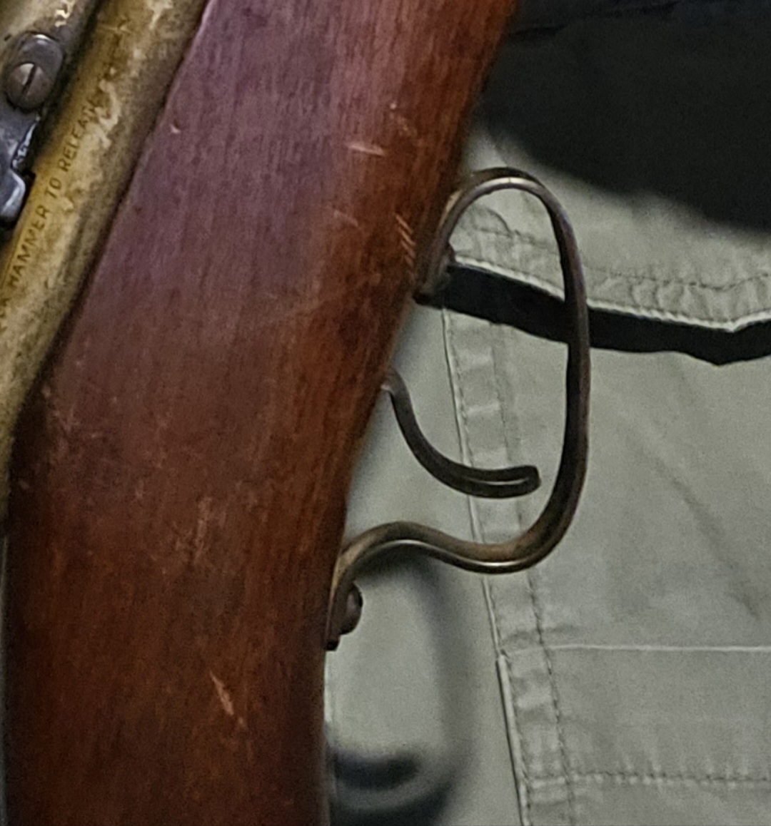

I can't figure out this trigger guard.
I can't find any like it, so it may have been bent?
That was a good buy for the price, but it's not a 1960's Benjamin. Looks like the trigger guard has been smashed at the front or purposefully reshaped.

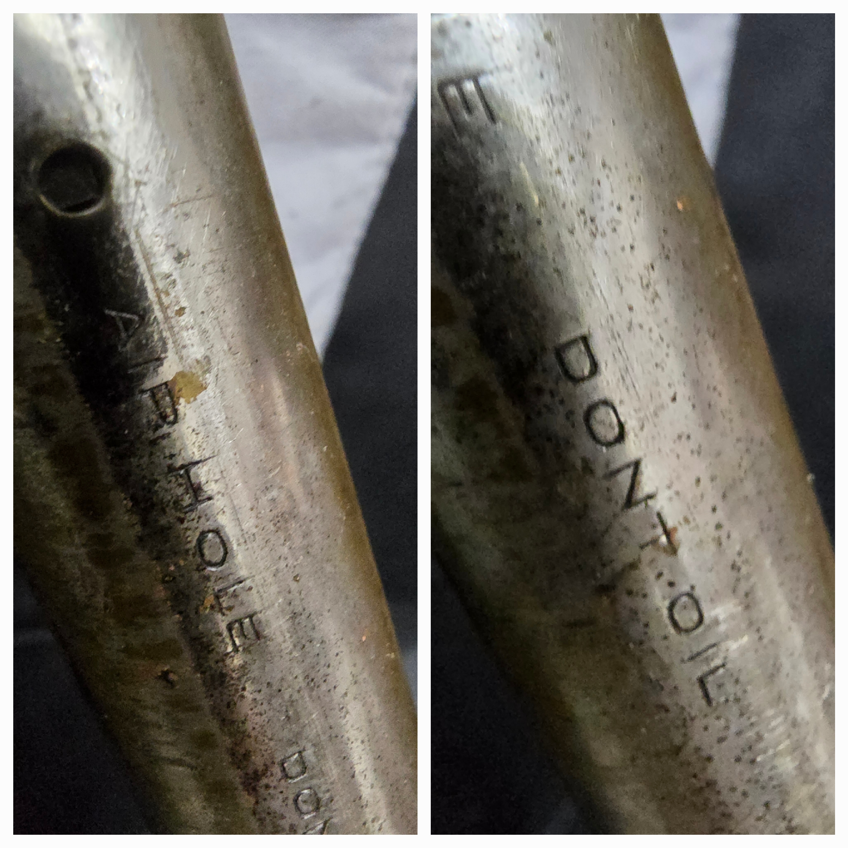

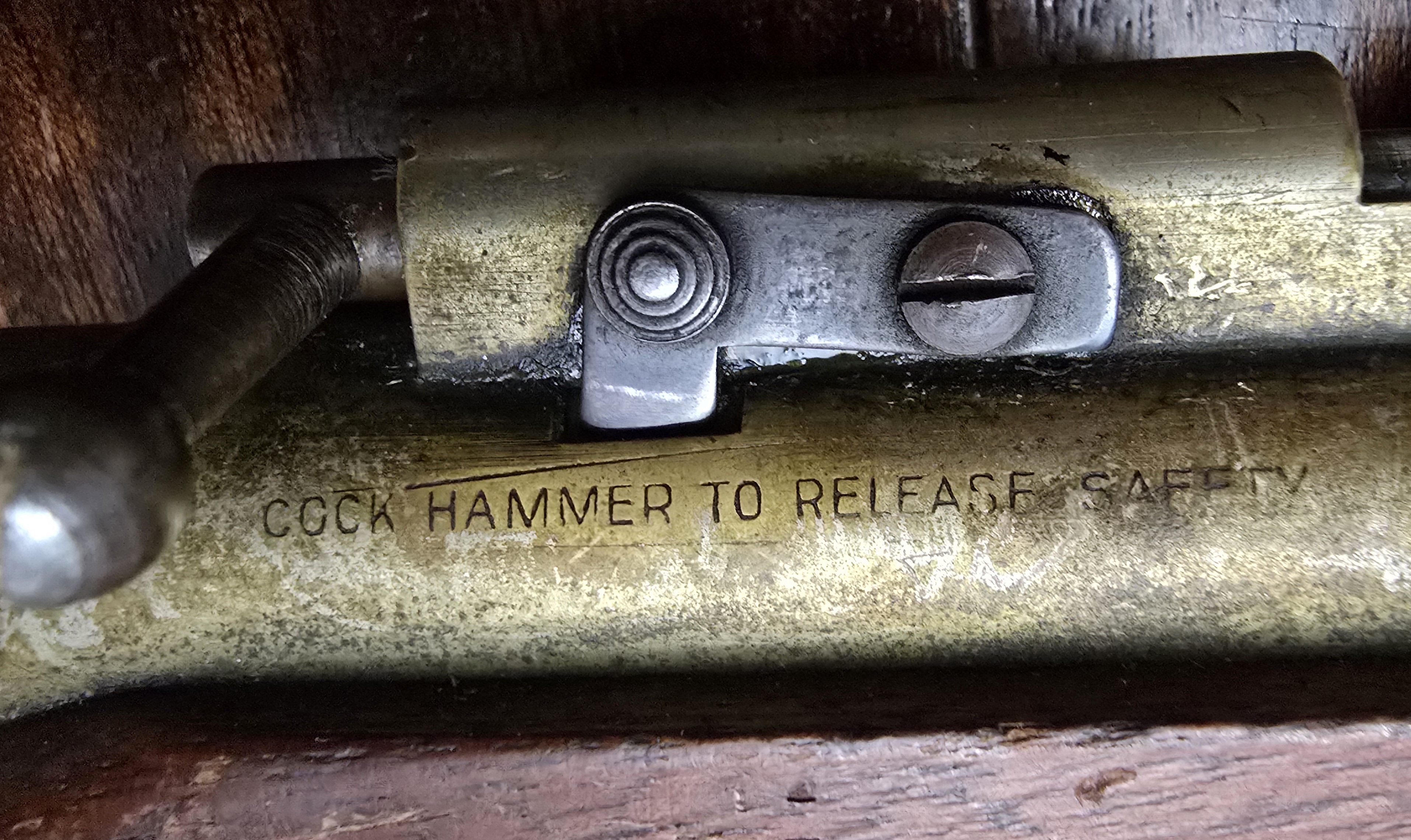

The manufacture date can be narrowed down within a couple years by the characteristics of the gun. Does it have "Made in USA" stamped on the left rear or front of tube?
It really was They sold it for a flat $85 they covered shipping and handling. I told them that 85 plus shipping etc, was a lot for a ruined parts gun to use as a wall hanger. Who knew? They told me it didn't function.
Thers no damage on it so I don't know how they managed that shape?

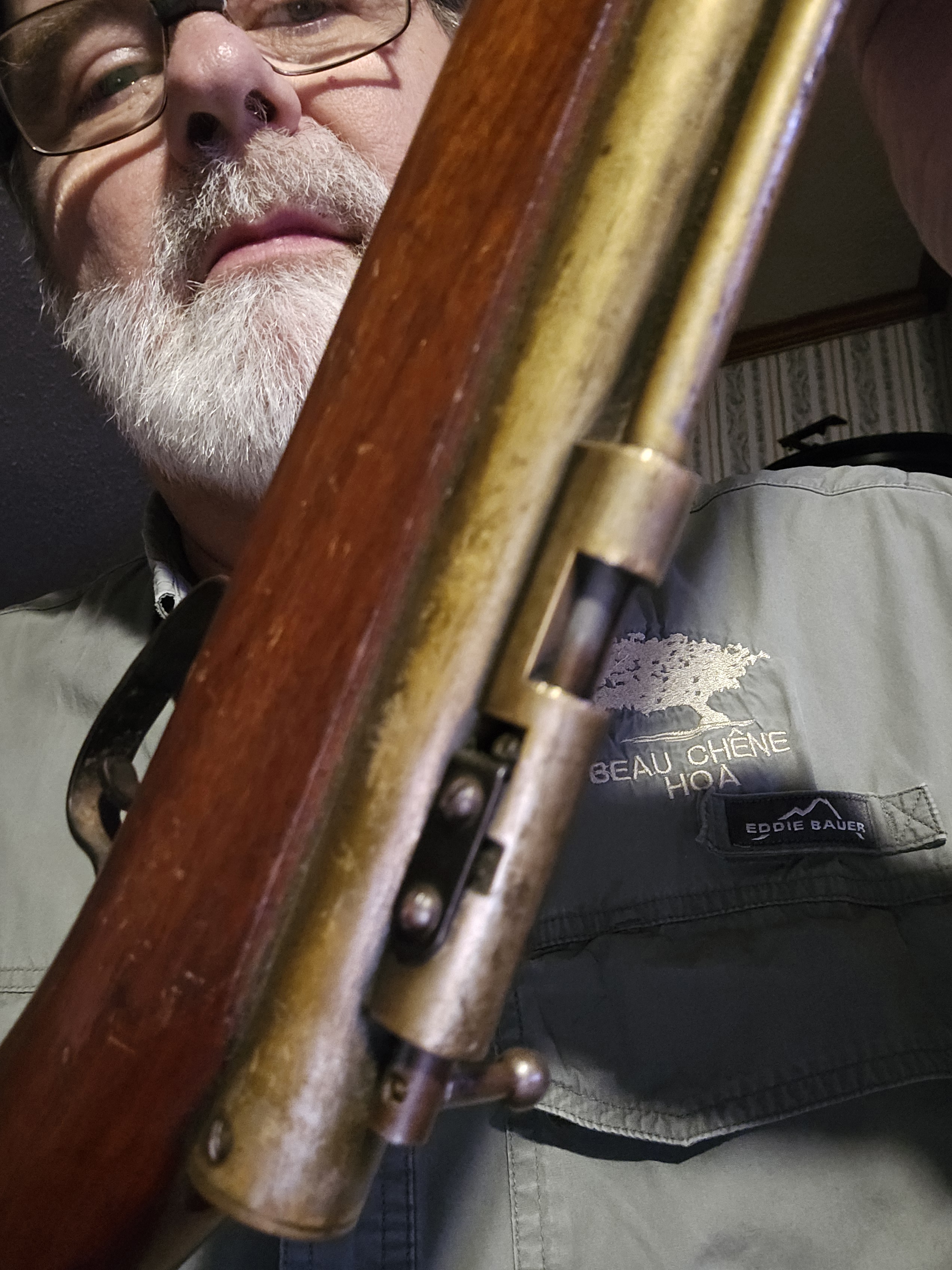

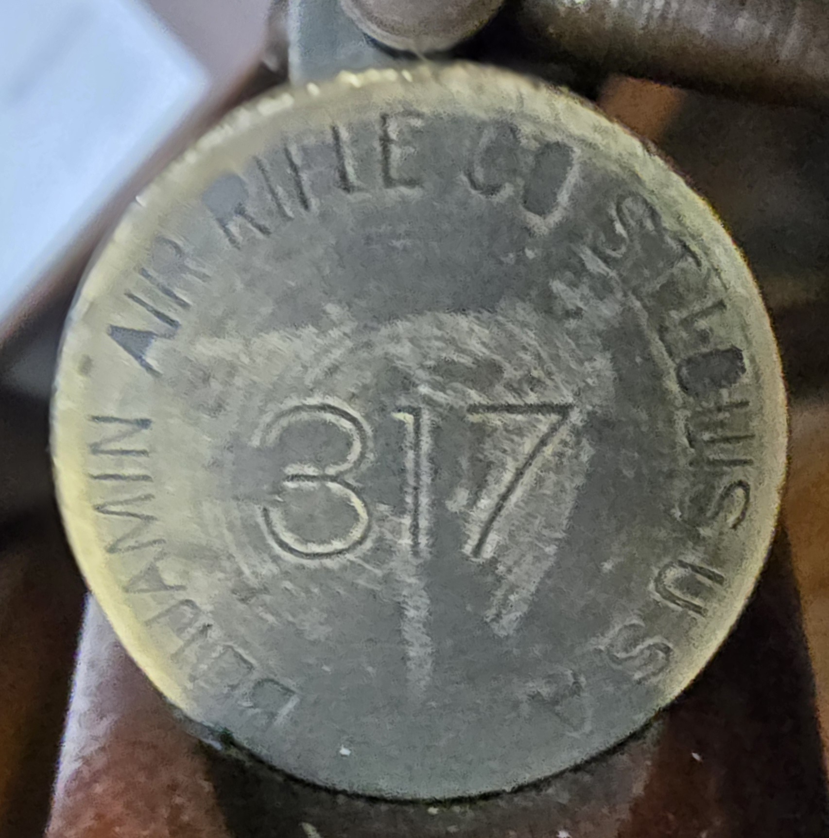

Ill have to have a better look when I get glasses. I did read Benjamin Franklin, and some saftey operating instructions. A 317 on the back plate which is very hard to read. Ill have to use my jewelers galasses. Lol.
The key to it age is in the pump handle screws according to an article in GTA. Saying that the earliest models had flathead screws. 1943.

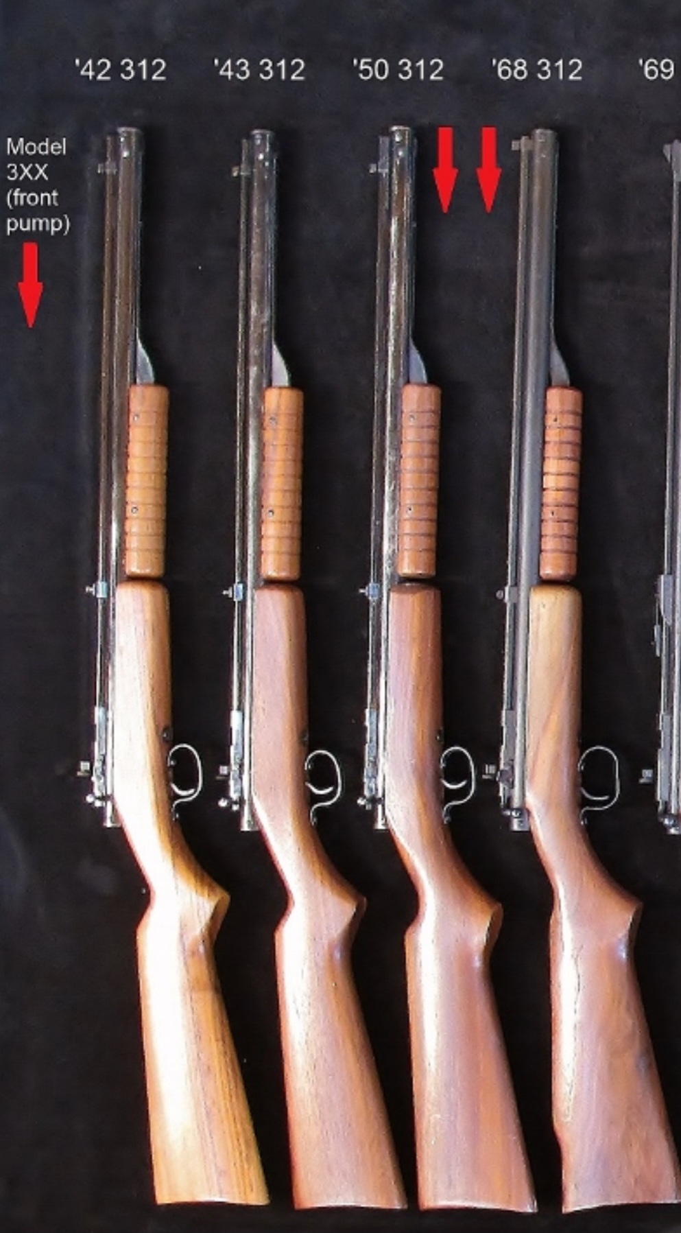

I've been collecting, studying and documenting Benjamin variants for many years and found that there is a lot of misinformation on the internet including, apparently, the article you found on GTA.
The very first 31X models from 1939-mid '41 had pins holding the pump handle on. Late 1941-1952 had the slotted screws like yours. In 1953 they went back to pins. There were many other changes during that time period also which can help identify year of manufacture.
These are facts, not regurgitated info from google searches or the "BlueBook of Airguns", which is in dire need of an overhaul.

I noticed! 👍
Yup I don't think the article was necessarily wrong I think I misunderstood what I read.

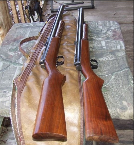

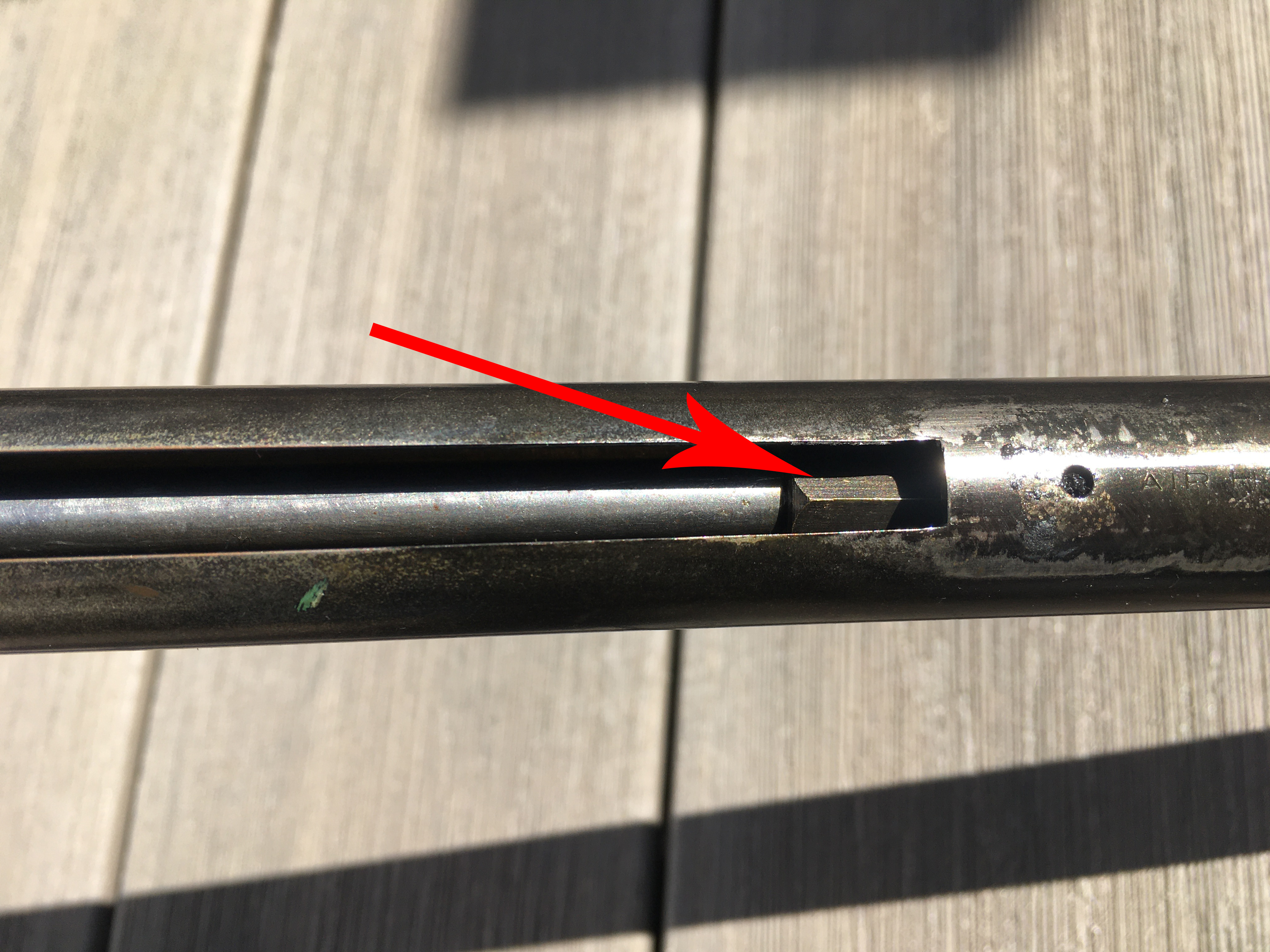

Yours has the "Made in USA" stamp at rear of tube and also looks like it's thicker in the grip than the slab sides. Can you post a photo of the tube slot with the pump handle fully open like example photo here. I'd like to see if it has the pump head for a leather seal or for the updated hy-car flat top seal. That will determine if its a 1949 or 1950 gun.
