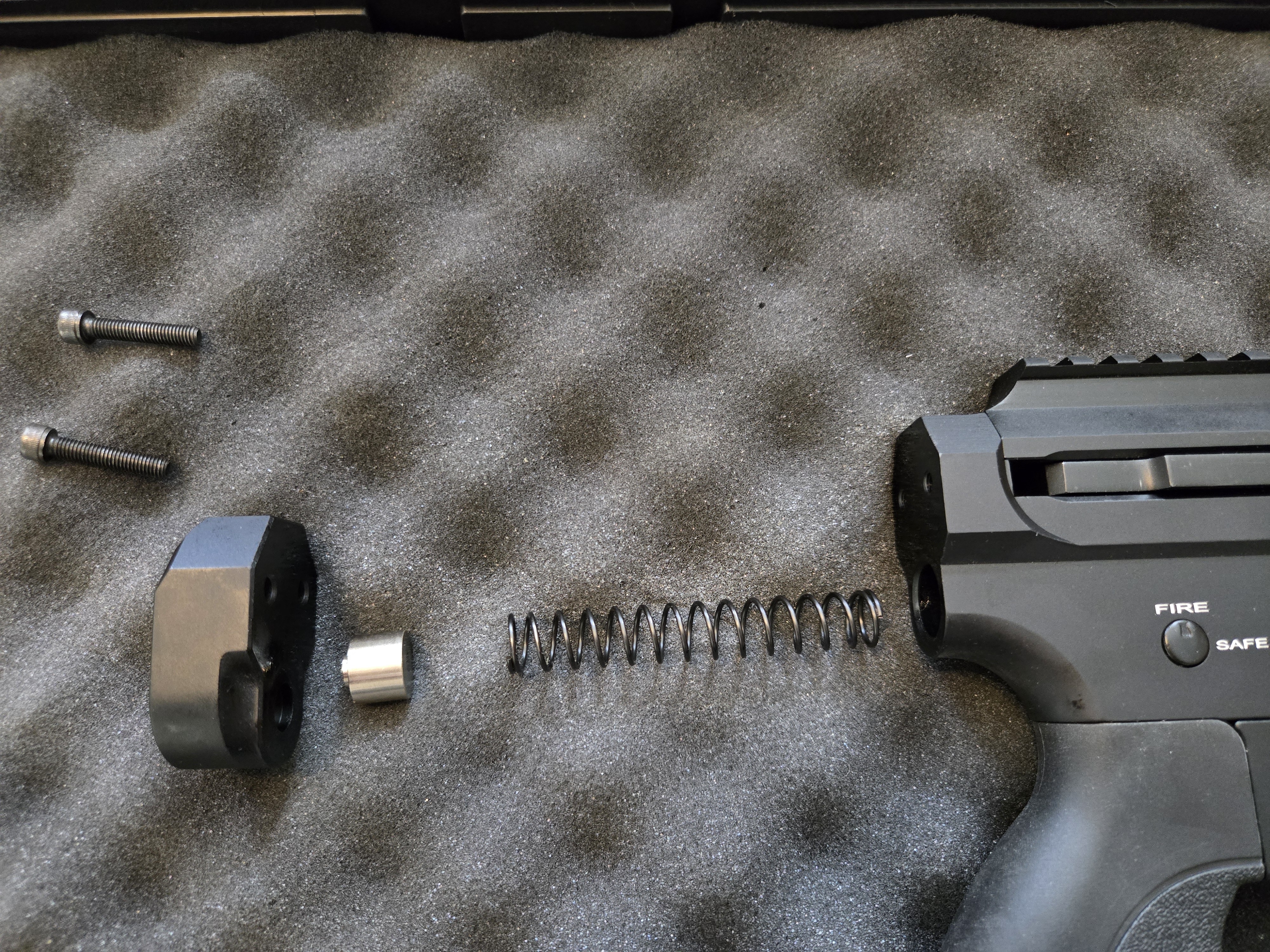

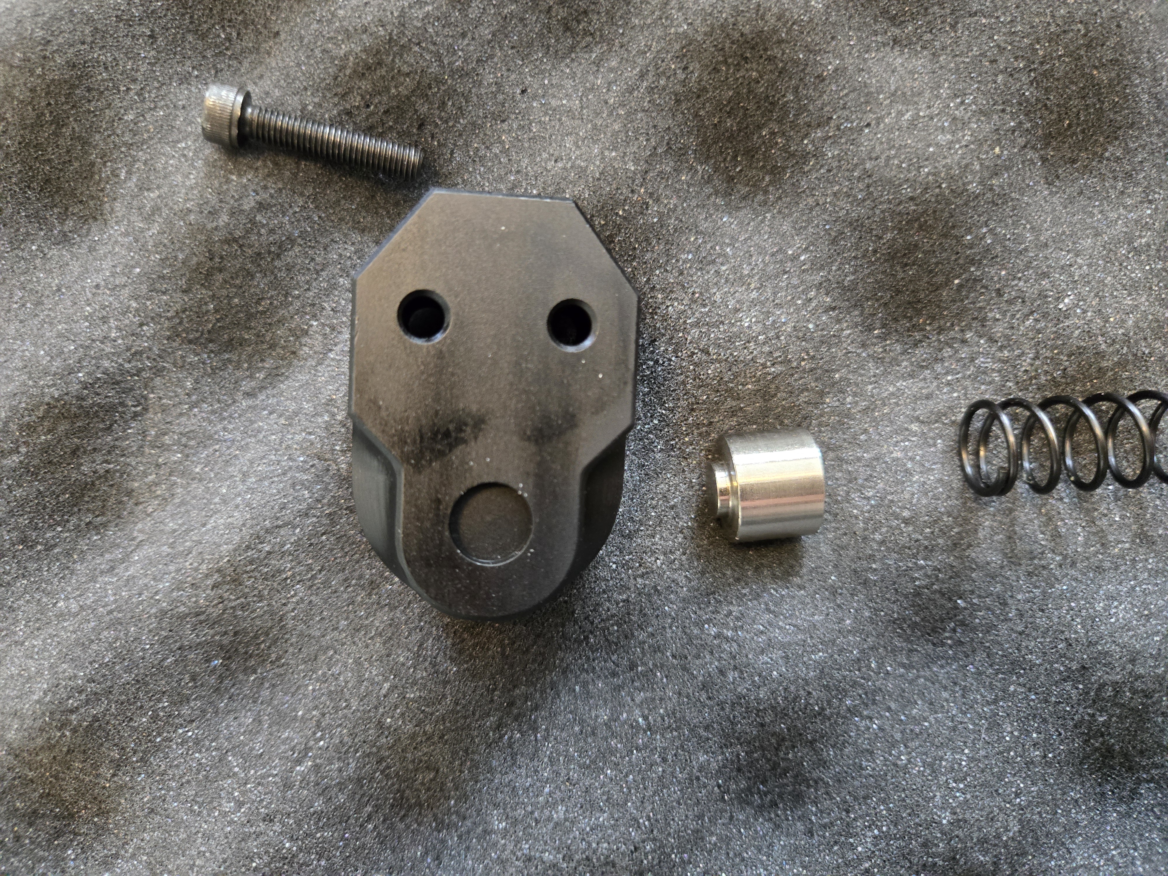

With the stock removed, you will see two allen head screws. While holding pressure down on the buffer tube block, unscrew both of these, as the hammer spring will have pressure against this. Once you remove the buffer tube block, you will have a spacer, then the hammer spring, and further down in, the hammer, seen in the picture below, minus the hammer itself.

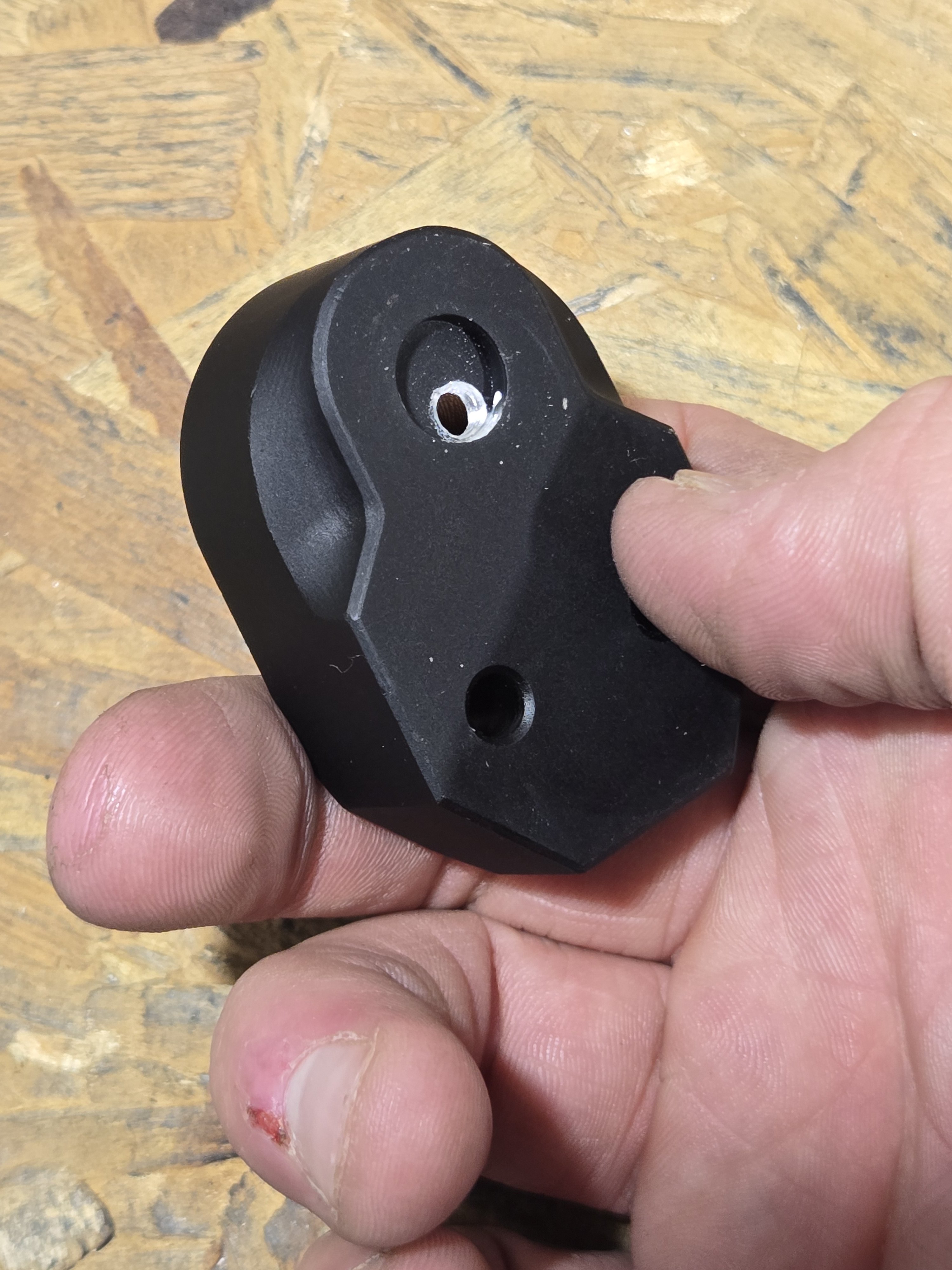

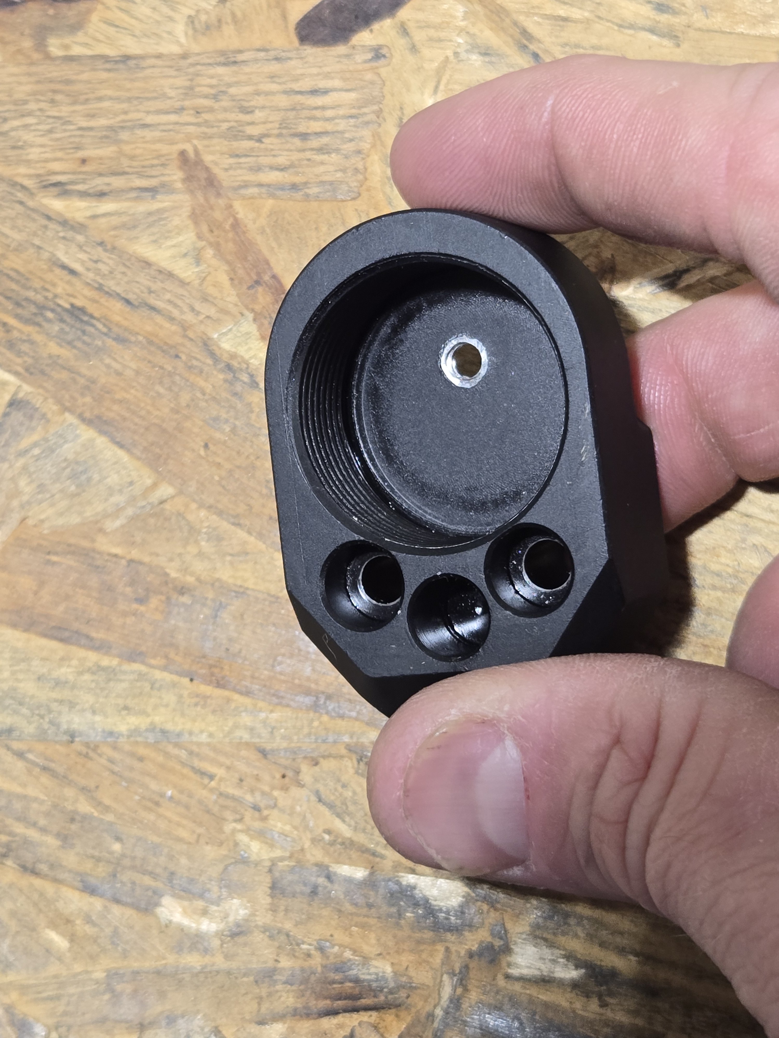

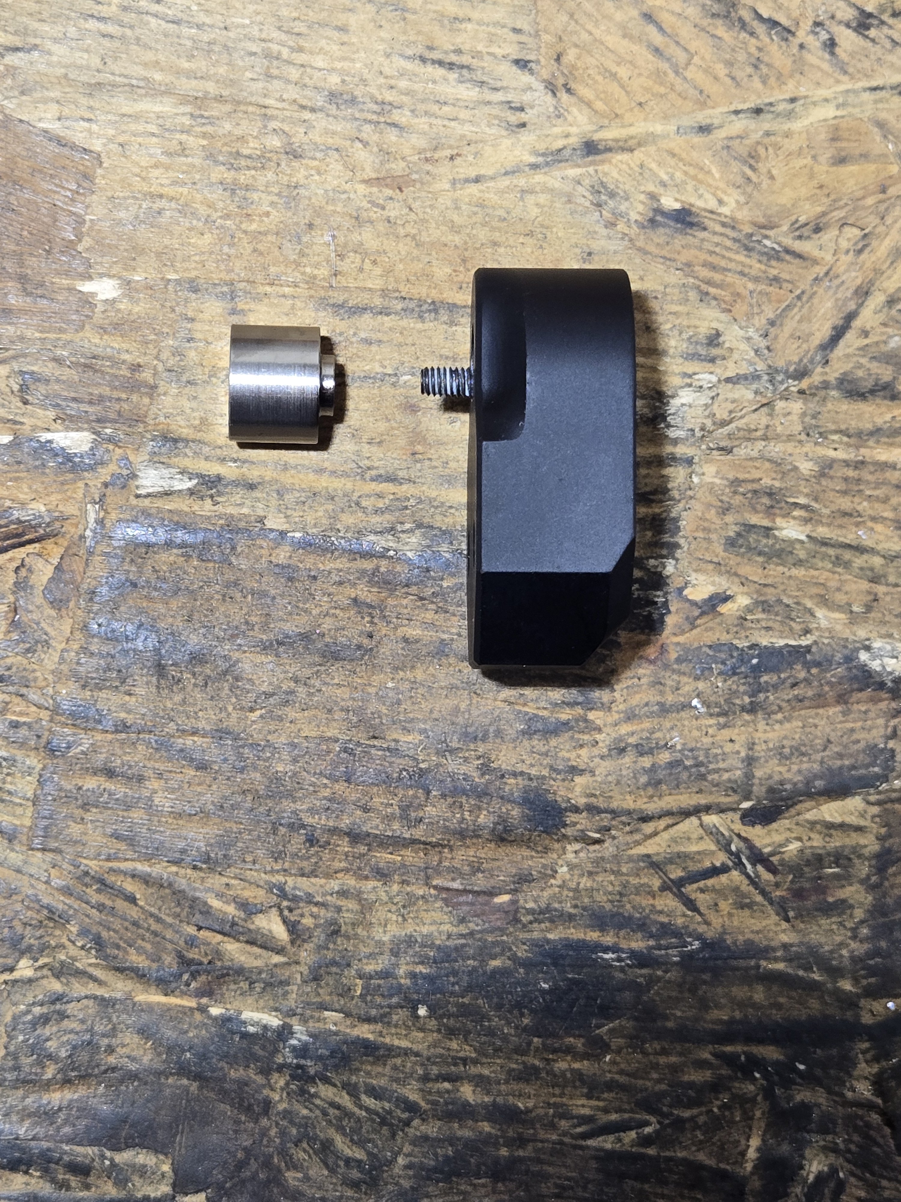

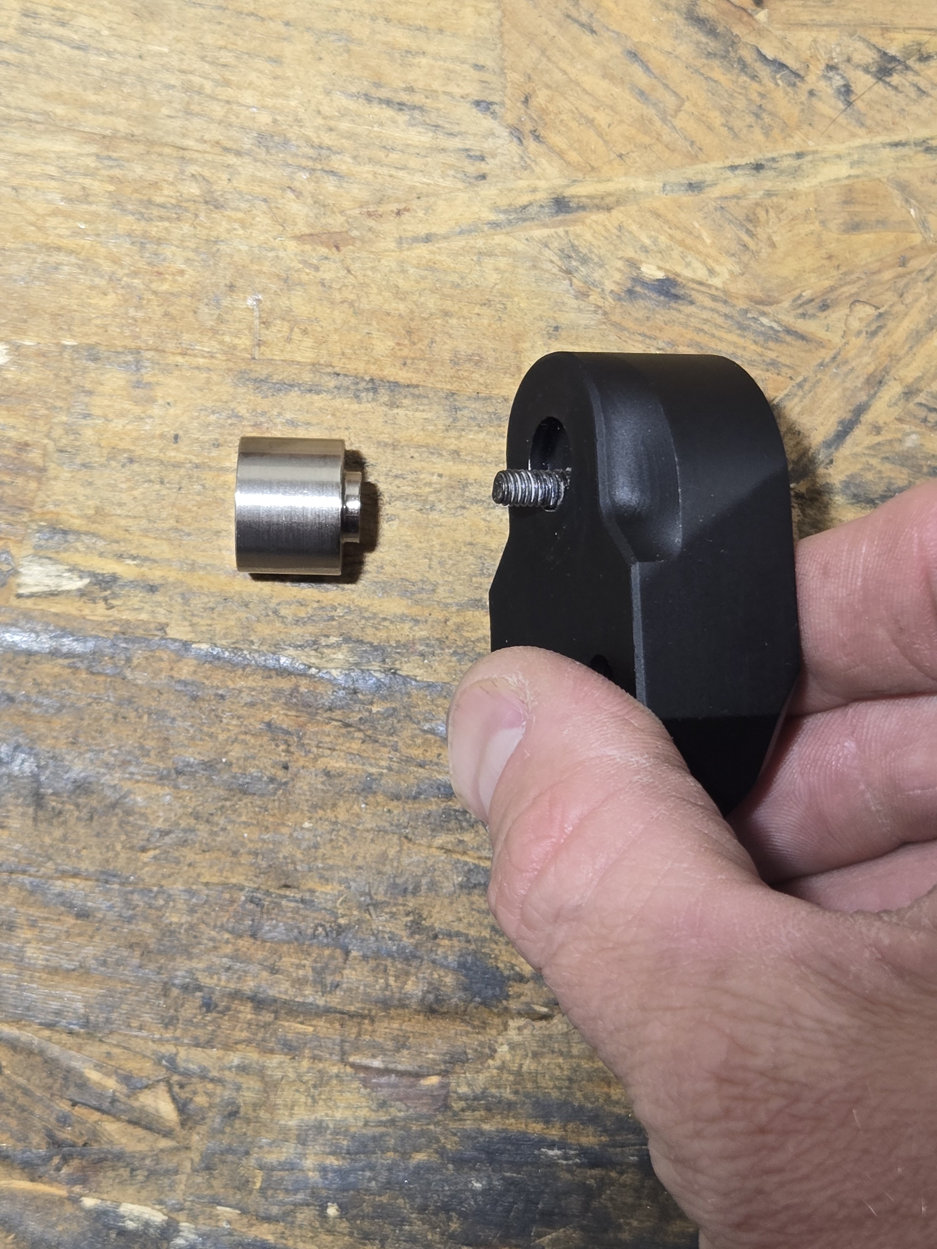

Next, we will drill and tap the buffer tube block, so that we can use a screw to add preload to the spacer/hammer spring. I used a 5/32, or #25 drill bit, for a 10-24 tap. A 10-32 tap would also work just fine if you have one, but use either a #21 or 5/32 bit, not a #25. I went with a #10 machine screw vs a 1/4", because you need the screw head to be small enough to ensure the buffer tube still has clearance to screw in to the buffer tube block with the adjusting screw installed.

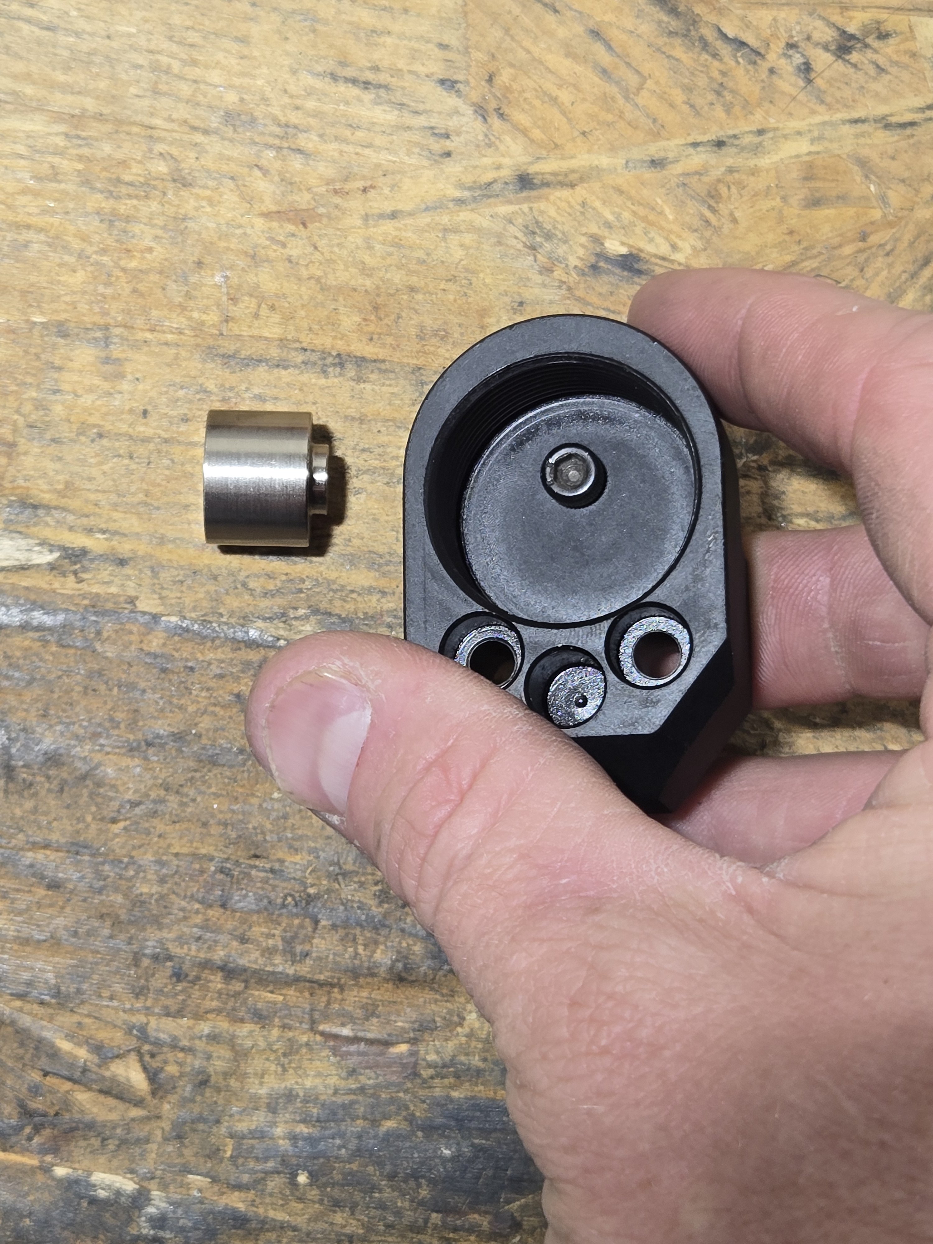

Also, while you could probably drill the hole in the center of the hammer spring spacer depression (seen below), I opted to put the hole closer to the center of the buffer tube hole, again, so I don't have any interference between the adjuster screw and the buffer tube.
This block is aluminum, so it is very easy to drill and tap. A little bit of cutting oil (which may not even be necessary) and it took about 20 seconds to have the tap ran through. Next, get an appropriate screw for whatever threads you tapped, and screw it in. I would recommend a 1" long or so screw, that should give plenty of preload adjustment. I added lock tight blue to the screw, so I wouldn't have it creep out on me.

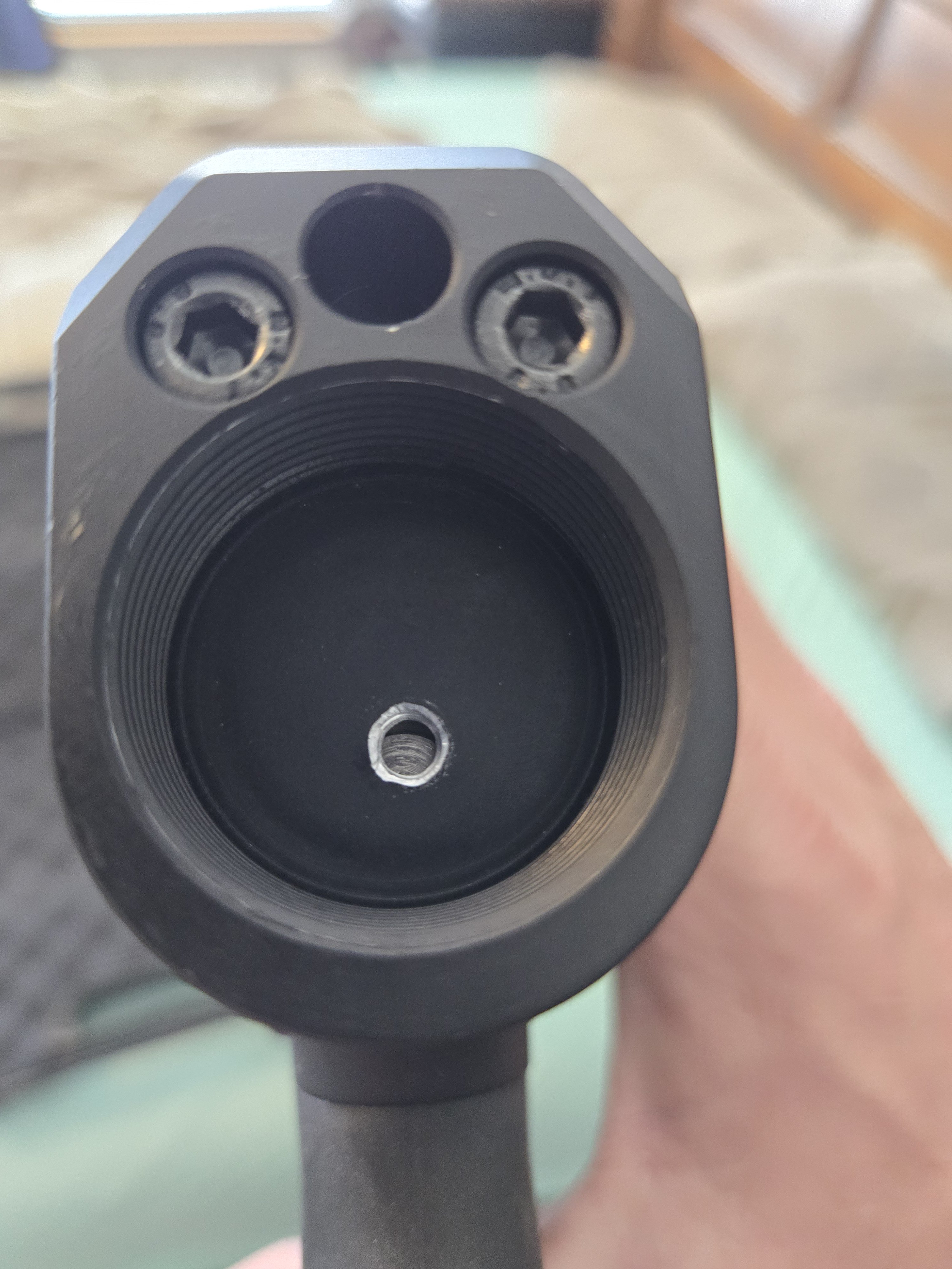

This image is looking through the hole in the buffer tube block, reinstalled, without the adjuster screw in it. The inside track where the hammer spring spacer rides is a snug fit, so the adjuster spacer should not have any binding issues.
